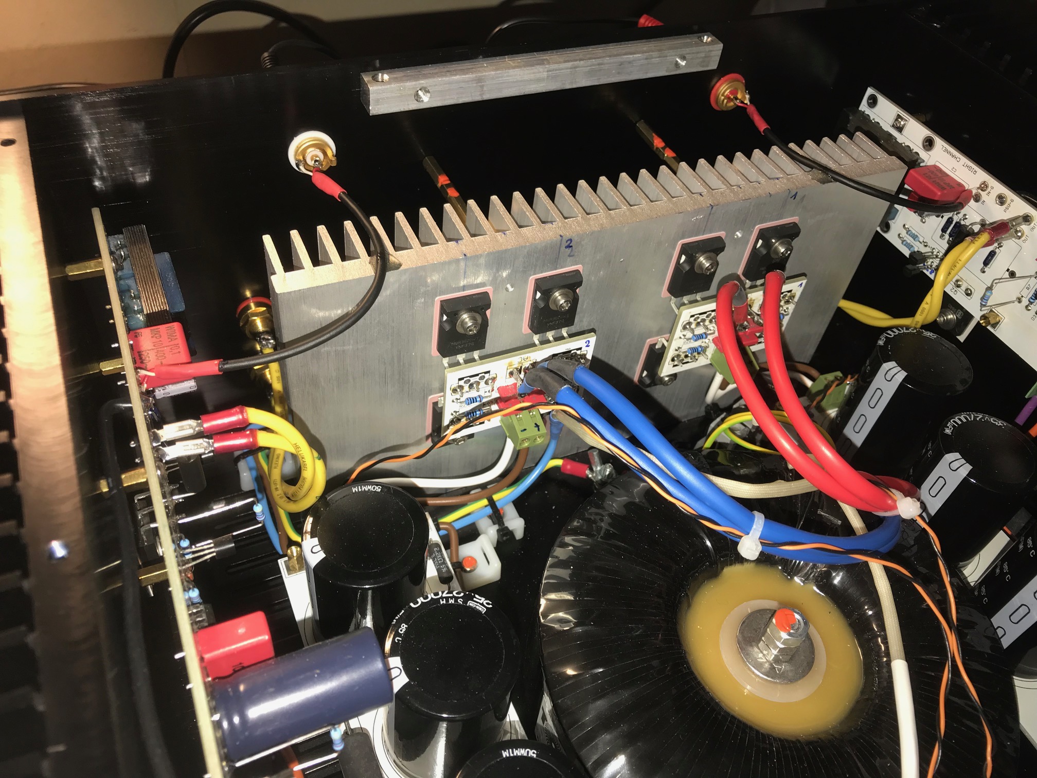

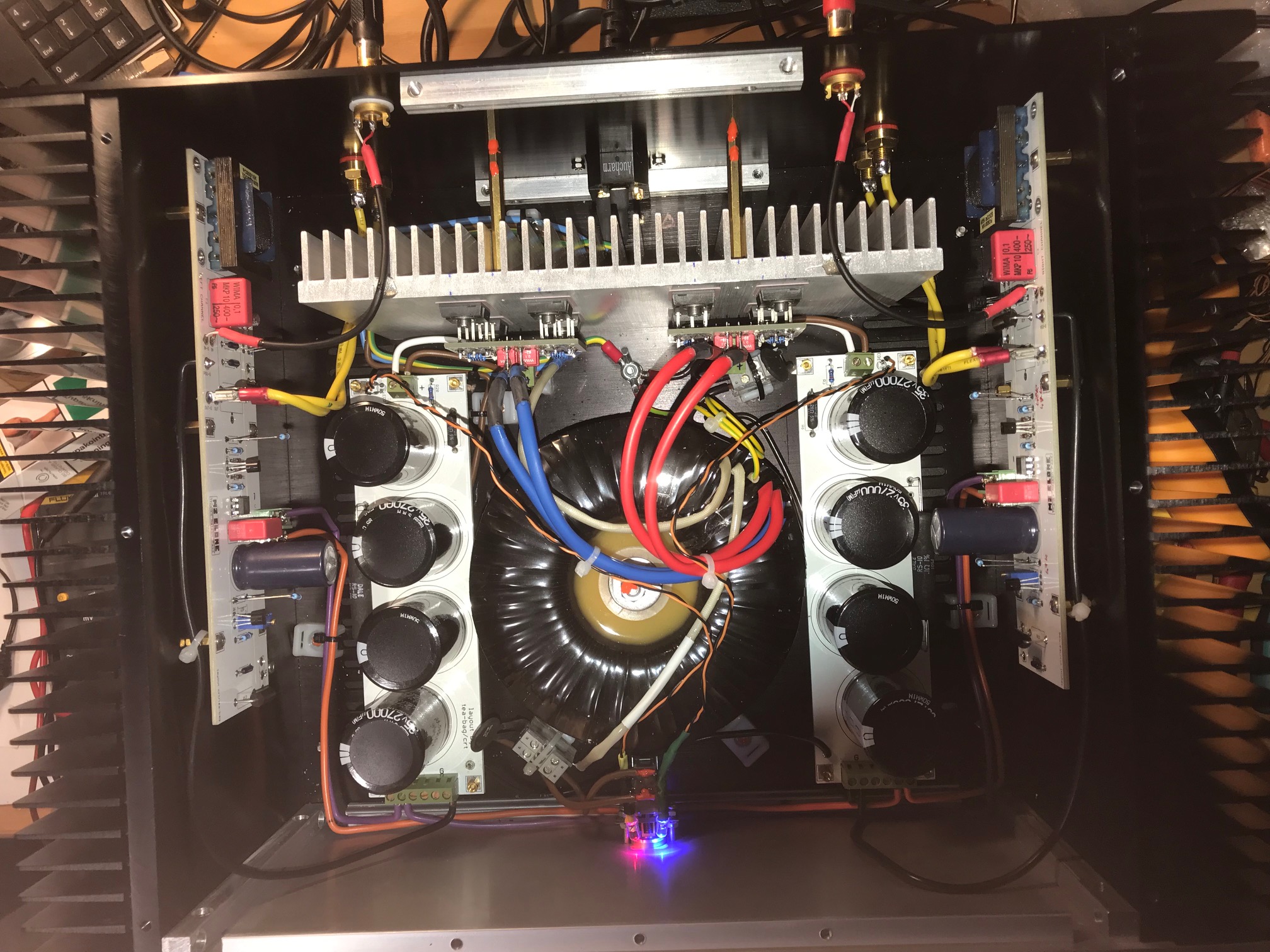

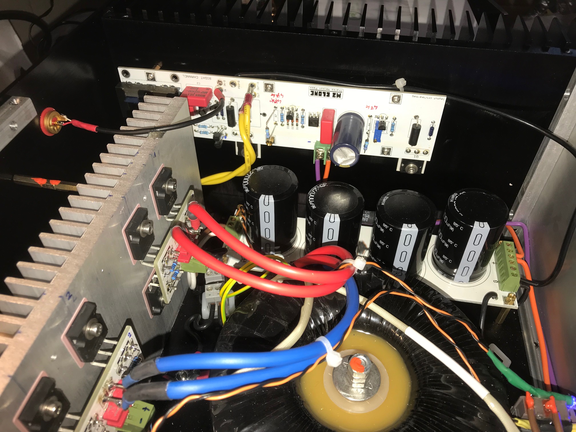

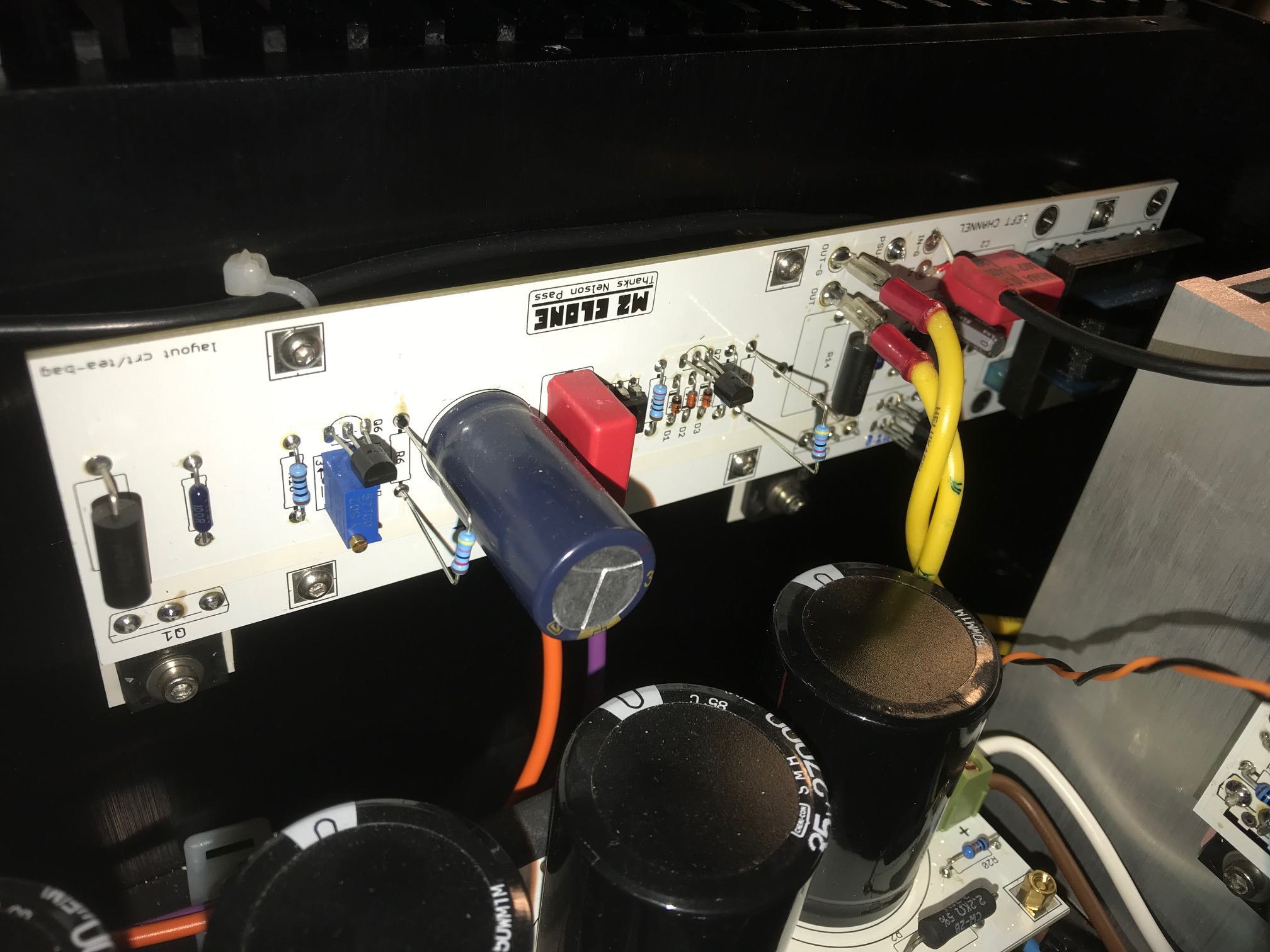

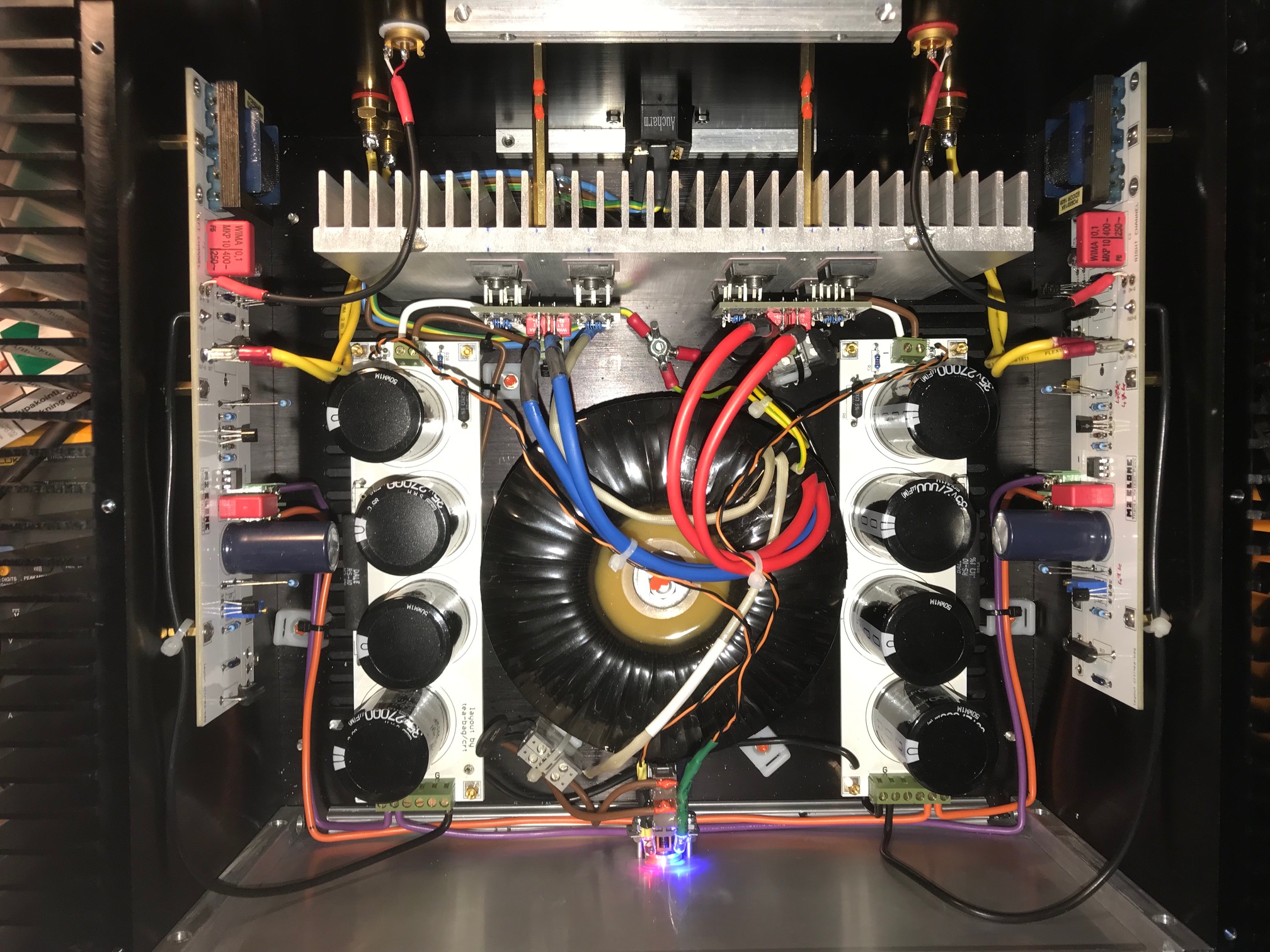

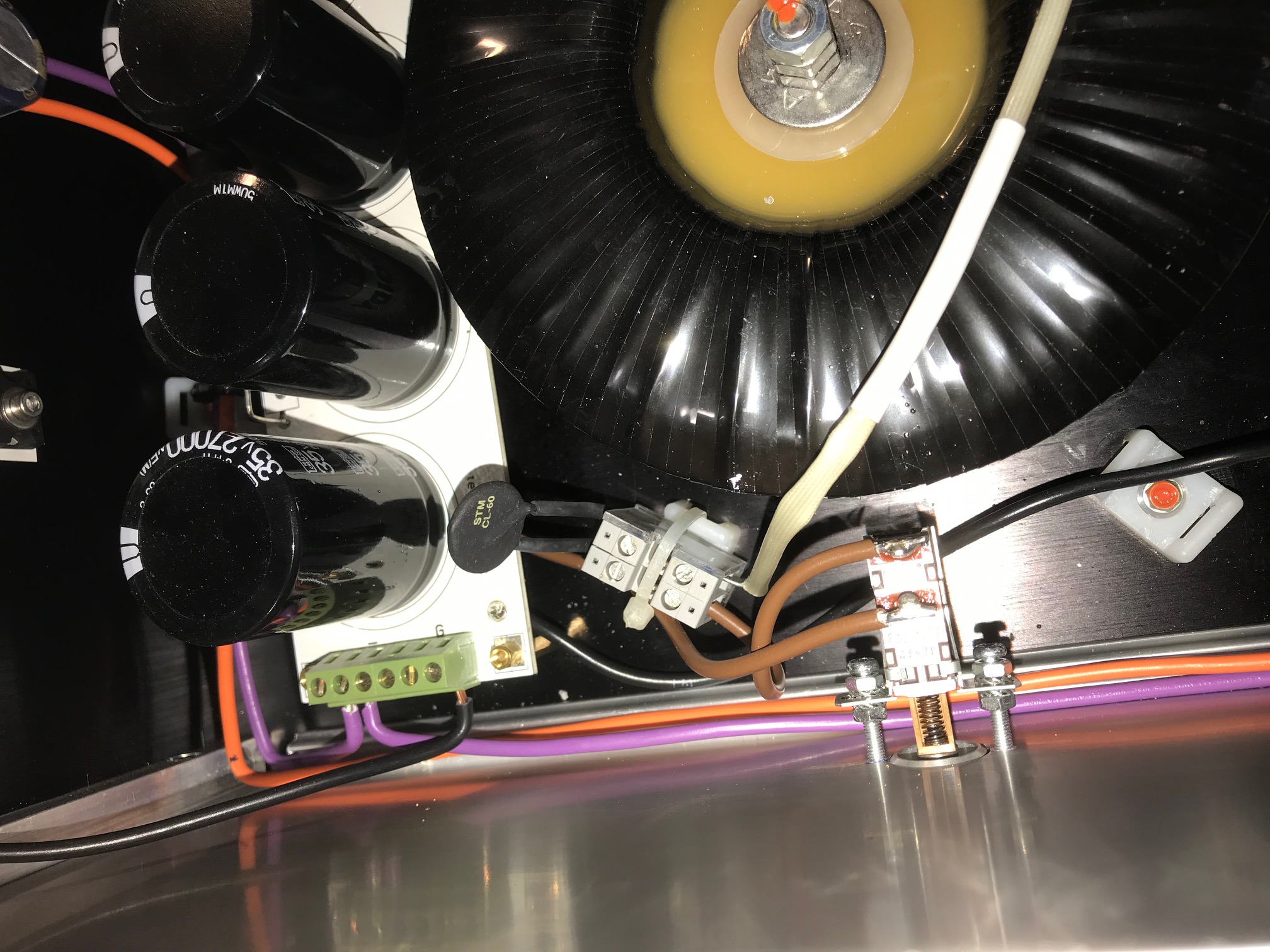

hopfylly now the Pictures are correctly incerted ,
yes i need advices for setting the offset !
thanks in advance
thanks in advance

Hello Syl20m,
for me this sounds like you did no offset adjustment.
To do this:
DMM - you want to measure Volts - millivolts! at your speakeroutput
You put the red probe of your DMM to speakerout + and DMM black probe
to speakerout - (you do this first ONLY! on the left channel)
Now you adjust your trimpot for offset adjustment on the main pcb (left channel!) till you get close as possible to 0,0 mV on your DMM. Turn slow!
You will not get 0,0mV but try to get close. All below 1mV is super, below 10mV acceptable. Up to 50mV is my personal absolut maximum.
Now go to right channel:
same procedure
Greets Dirk

Thank all for your advises!
The amp is not fully warm yet, but I have been able to lower the offset to
On left channel to 7.9mv
And right to 244.7 my
Both now at max of trim pot p1!
I guess next is to replace the 47k resistor I am using in r6 and r7?
Should I increase r7 to 52.3k?

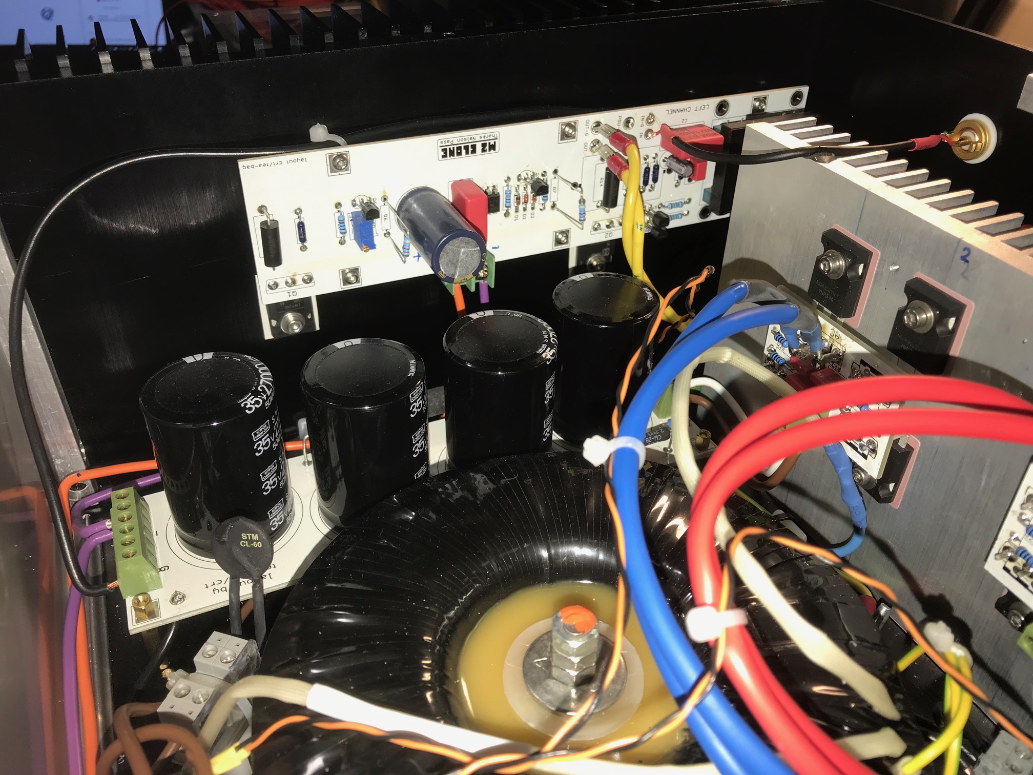

Hi all,
I have replaced r7 to 52.3k on both channels to get more window for tuning the offset.
After running the amp for 20 Minutes, I have set both channels below 0.5mV . It is now occilating between 0 and 0.5!
I will check it again when the amp is fully warm!
I will check temperature of the components again tomorrow!
I have noticed that the amp seems to take about 4-8seconds to load the capacitors when powered up which result of bad sound if the source is already playing!
I supposed the CL-60 inrush limiter i put at primary of the transformer is one of the reasons for this long charging!
Also the CL-60 is quite hot, I was not able to measure , but I guess above 50 degrees
Is that a problem?
You gonna tell the that I should power up the amp and them turn the source On after a while. Which I would normally do!
I have been using a cl-60 also between ground of chassis and ground of power sypply!
The toroidy transformer 500w 2x18vac I am using is not dead silent, there is very small vibrating sound coming form it, it does not seems to spread up to the speakers at least.
Any advises are welcome !
