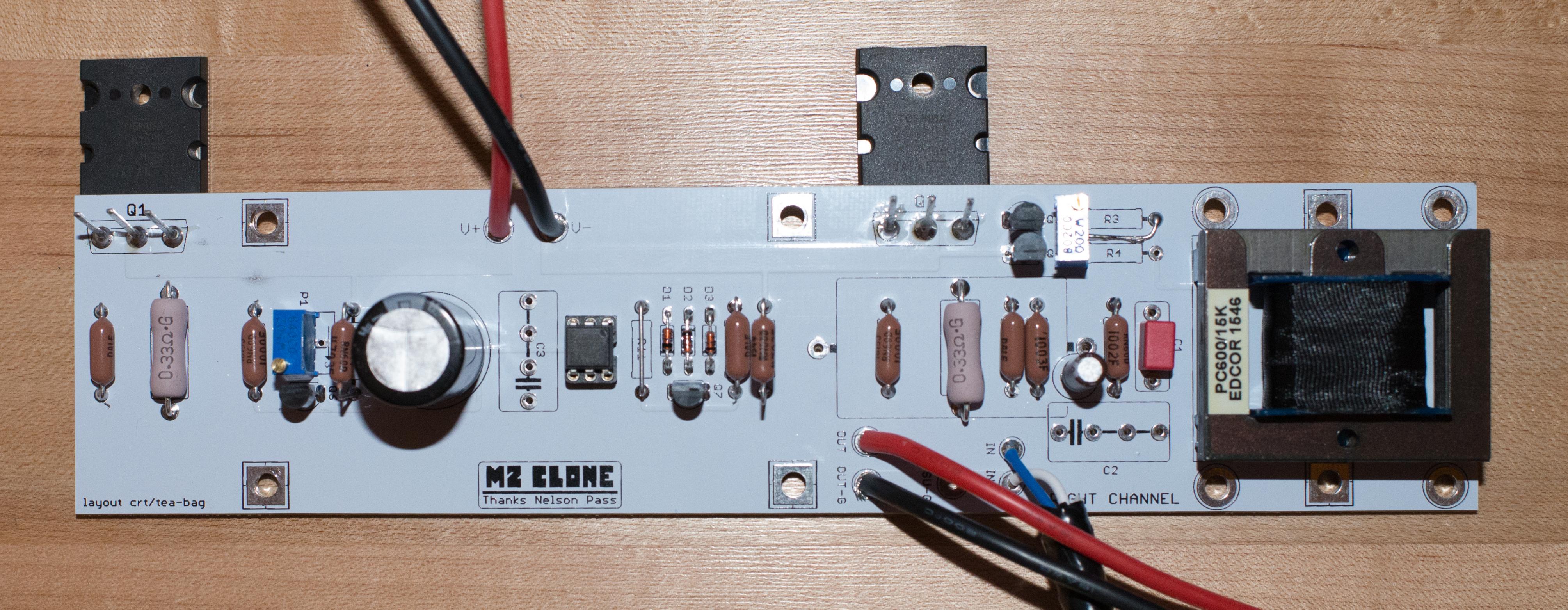

Got the boards soldered up, Tea Bag boards.
Using Toshiba 2SK1530/2SJ201 on the outputs. 2SK1530 in Q1 N Channel, 2SJ201 in Q2 P Channel. Using 0R33 3W source resistors, jumper on R11 as been the go-to values for the Toshiba parts. Using an R20 trim pot for the R3/R4 pair, centered before installing. The 5K trim pot P1 is centered at 2.5K. No short on any MOSFET pin to the heatsink. Both channels do the same thing.
Solder looks fine - I solder everything under a magnifier these days, anyway. Checked all resistor values with a meter before installing them. Verified all part numbers on active devices, socketed optocoupler with dot towards notch on socket/board.
Using a bench supply, the amperage starts off at zero - doesn't move for several seconds, then steadily increases, I set it to stop at 1.25A/21V. DC at the speaker terminals is at 10VDC by that point.
Nothing hot, no smoke, no smells. Something is not right.

I think this is pretty much normal behaviour. My M2 has BIAS about 1.3A. Are you able to trim DC offset using P1?
hope you didn't current-limited bench supply ; besides that , (just in case) I hope that when you said "installed" - you meant - mounted on heatsink
Yes, it was mounted on the heatsink. I didn't set the current limit, but the CL light started blinking as the draw reached 1.25A. I was watching the amp meter and turned it off manually at 1.25A - just as the light started blinking. I think 1.25A is the size of the fuse recommended. What's the upper limit of current draw it can withstand?
And ideas as to why it would have 10VDC at the speaker leads? I didn't try to adjust DC offset with the P1 trimmer, seems like a very long ways from zero and I was concerned about damage to the amp as the current was climbing.

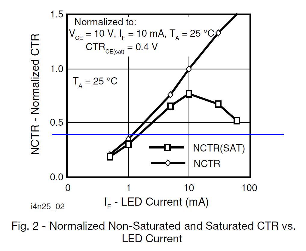

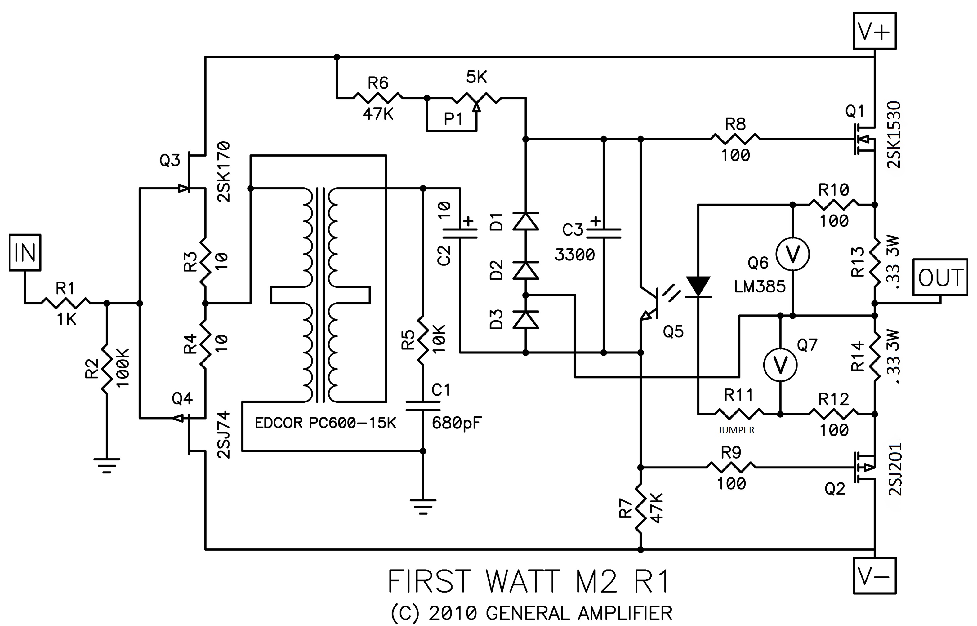

The M2's output MOSFETs operate at a VGS bias of about 5 volts. So with 23 volt supplies, there's about 18 volts across resistor R7 and about 18 volts across resistor R6. (Both are 47K). The current in R6 and R7 is about (18/4.7E4) = 380 microamps. This is also the current in the output half, the phototransistor half, of the 4N35 optocoupler.
The current in the INPUT half of the optocoupler, namely the LED between pins 1 and 2 of the optocoupler, follows the relationship
where "CTR" is the Current Transfer Ratio of the optocoupler. Looking at the datasheet plot of CTR (Figure 1 below), the only way to get I_phototransistor = 0.38mA is to have I_LED = 1mA and CTR=0.4. That's where the blue line intersects the graph.

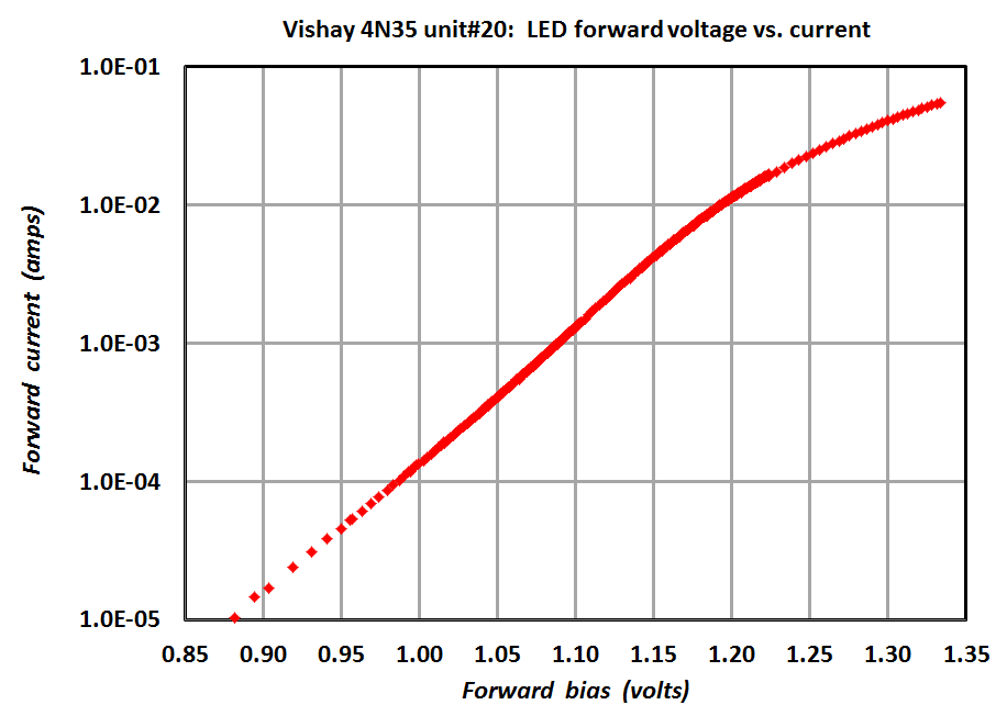

Finally we look at the I-V plot of the LED. Attached below in Figure 2 is some current-versus-voltage data I measured on the input side (the "LED") of a 4N35 optocoupler made by Vishay. With I_LED = 1mA, the forward voltage drop is about 1.09 volts.
Readers can run through the rest of the algebra involving R10, R11, and R12. And can also calculate the bias voltage across the IC reference voltage "diodes" Q6 and Q7. The result might be surprising.

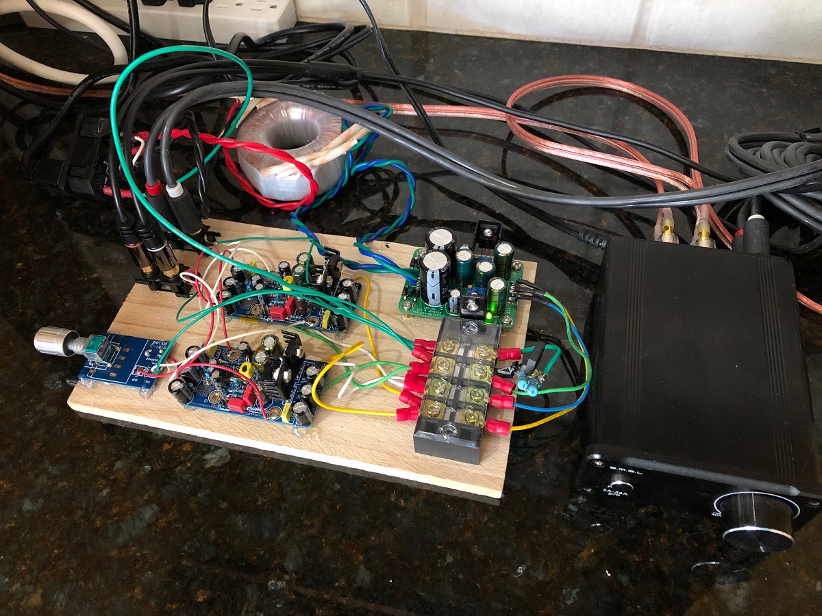

Melbourne tested as standalone preamp, works well. In this wood plank mock up of a preamp, I am using a BJT darlington cap multiplier (layout by Prasi and design by Mark Johnson) to provide +/-17v rails. I am using the built in 2k2 and 220pF input RFI filter in this case. Using star grounding (even audio input and output jacks all go to star hub) which has a 10R/diode bridge/100nF ground loop breaker. System has no audible hum.
- Official M2 schematic
