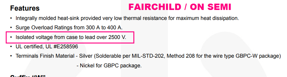

That's the first time I've ever seen a thermal pad used between a GBPC packaged bridge rectifier, and the chassis!
If the M2's DC supply rails are ±23 volts, and if the M2 dissipates 160 watts of class-A power when no input signal is present,
then each rail delivers about 3.5 amperes. Math check: (3.5 * 23 * 2) = 161. Check.
The voltage drop across each of the two bridge rectifiers, is about 2.5 volts max. Datasheet says less, we round up for conservatism.
So the power dissipation of each of the two bridge rectifiers, is about (3.5 amps) times (2.5 volts) which equals about 9 watts. Needs heatsinking? Certainly. Needs thermal pad? Hmmm.
Fun fact: silicon diodes in a bridge rectifier, actually work better and better, the hotter you let them operate. As long as you stay below TjMax of course. Take a peek at the datasheet. Cowabunga!

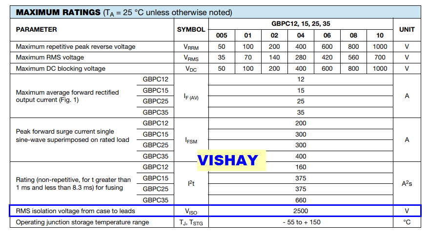

Again, thermal transfer is not chief job for pad, electrical isolation is.
Not in a GBPC packaged bridge rectifier.
The package is electrically isolated from the four pins of the bridge. Datasheet snippets below. They guarantee you can apply 2499 volts between package and pin, and no current will flow. There is no need for an additional insulator between bridge and chassis or heatsink.

Joined 2003
_
My point precisely. Unlike the devices I used on my F5, These rectifier blockss require no electrical isolation, which is the point of the pads, no?
While the block devices could use some heat to be transferred away from them, I think just bolting them to the case is sufficient, (at least it has been for everyone here previously) and think the adding of a pad isnt going to help what heat transfer is useful.

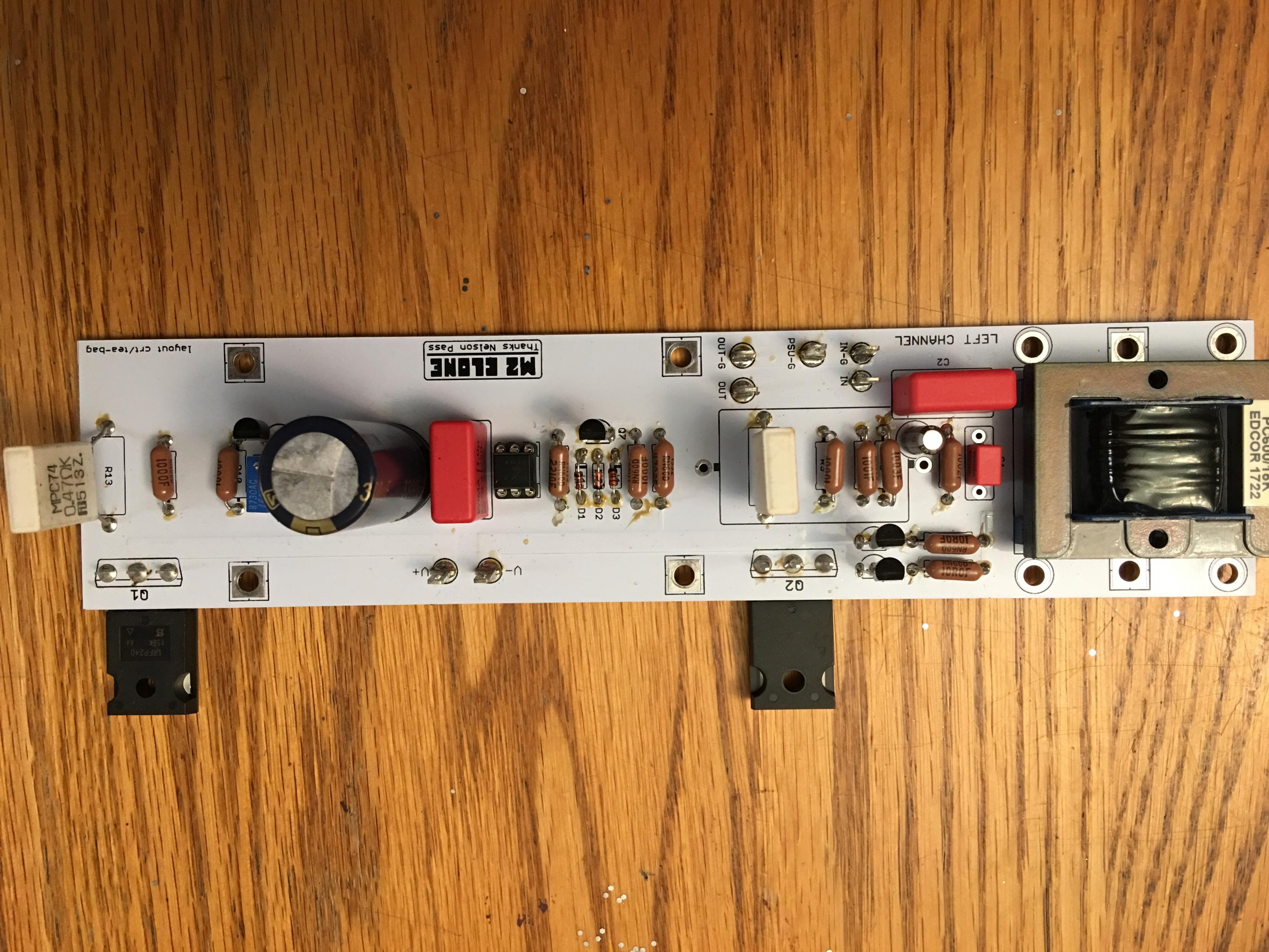

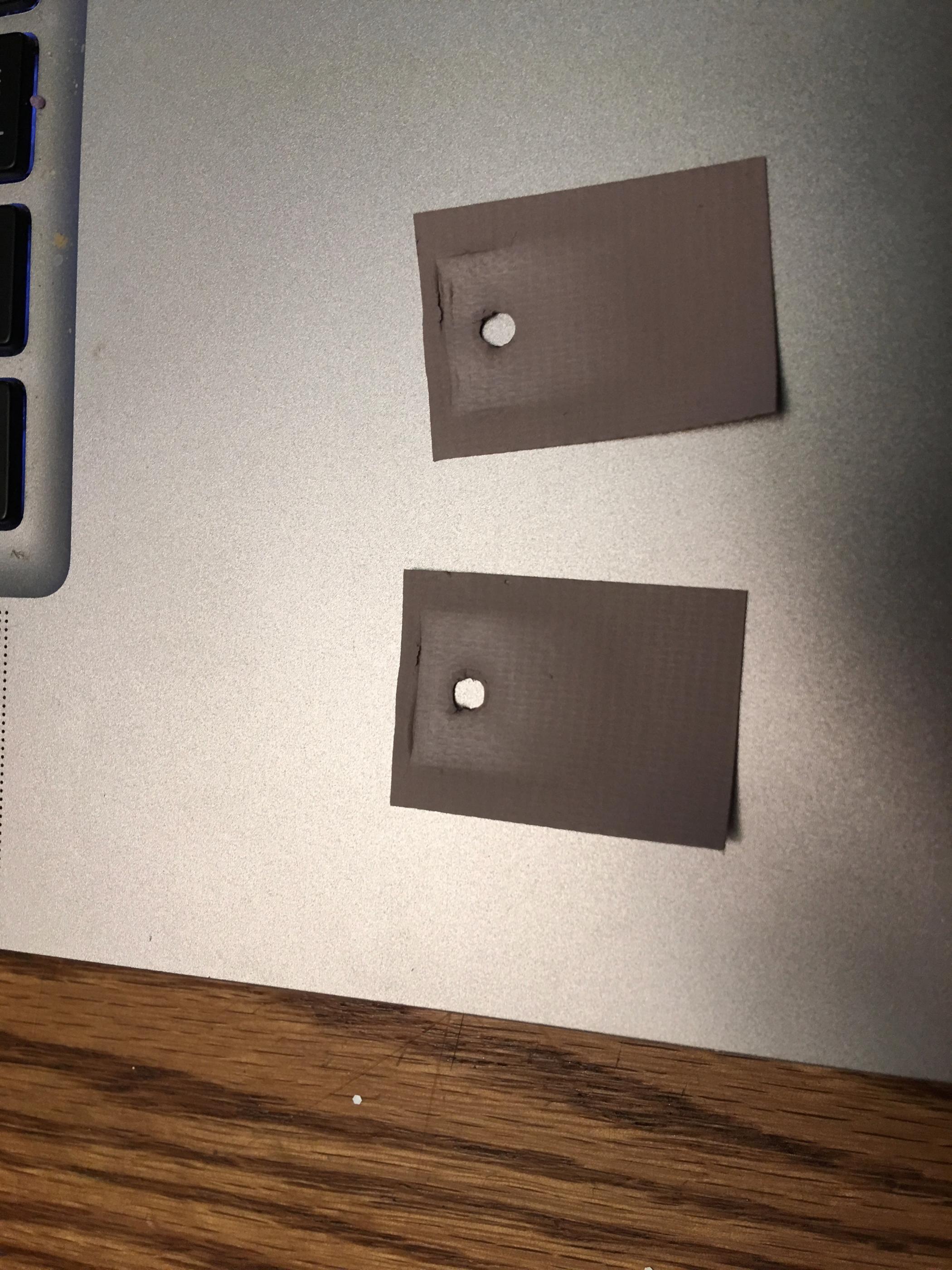

I'm having some difficulty with my 3rd M2 build. The right channel seems to work just fine. But as I bring the left channel up it seems fine at first, I can adjust for DC offset, then seconds later both source resisters get very hot (I mean burn your fingers hot). I've pulled the boards off the heatsinks to look everything over, but all checks out...resistor values, transistors correct and orientated properly, capacitors are fine, I just can't figure it out. One thing I did notice when I released the mosfets from the sinks, it looks like I over torqued the screws and really compressed the thermal pads (maybe to the point they could conduct?) Let me know if you have any suggestions. Thanks
Joined 2011
Resistors too hot suggests a failure of the optocoupler negative feedback loop which regulates bias. I'd look for open circuits in the R10, R11, R12, Q5 current loop. I'd pry the 4N35 DIP out of its socket, straighten its pins, and very very carefully reseat it, making sure all six pins go where they're supposed to. BTW if Q6 or Q7 became shorted, that would play hell with the bias loop too.
You could temporarily remove the 0R47 source resistors and replace them with 47R resistors for debug purposes. Now you can run the amp all by itself on the bench, without a heatsink, and attach probes to your heart's content.
