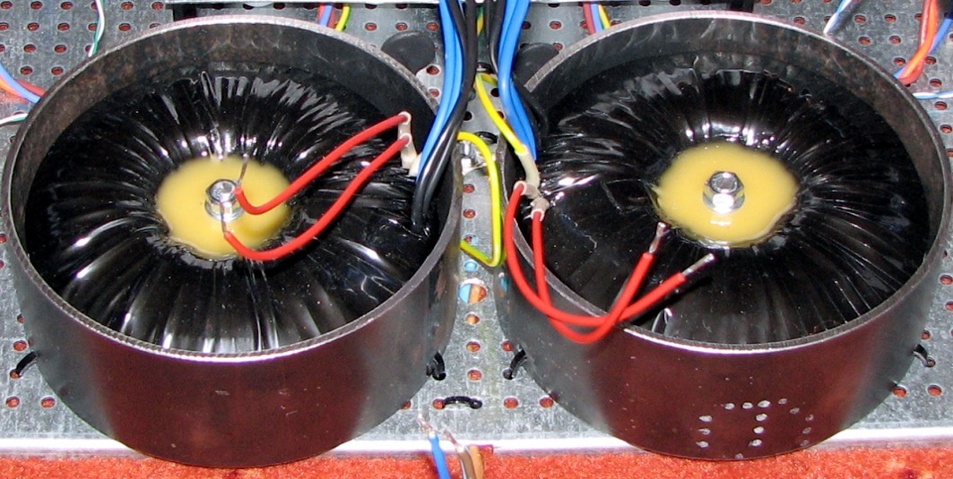

The ones I've seen (Amveco, I think) had what appeared to be a steel strip around the circumference, overlapped and tack welded. I say some sort of steel (?) as it was magnetic, slightly springy, and rusting. The outer steel strips were NOT grounded, unlike the interwinding electrostatic shield- in my case.

The AnTeks are similar but the metal strip around the circumference of the toroid is under the plastic insulation wrap. Not sure if its grounded nor the type of material used (steel, Mu-Metal or ?).

It will be steel, not grounded. I believe the primary windings are interior,
on other side of grounded electrostatic shield.
...ring made of 2 or 3 full windings of metal strip , wound around perimeter of donut...s
It's a GOSS band (Grain Oriented Silicon Steel), magnetic sheilding; I've seen similar used on speaker magnets.
A picture for those who haven't seen one.

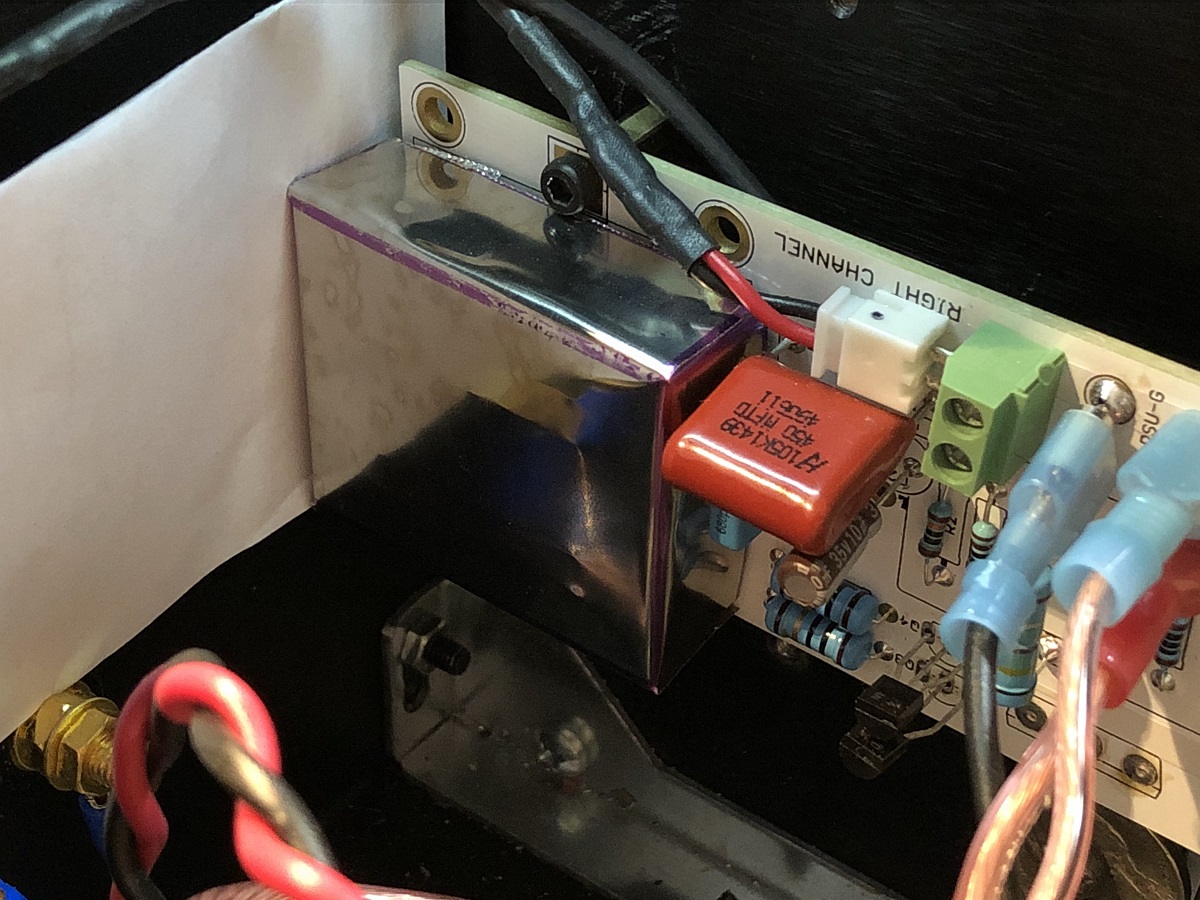

Nitto No. 597B Mu-Metal (Ultraperm 80) sheeting formed into a 44mm L x 35mm W x 16mm deep rectangular cover (self stick adhesive on one side makes construction easy) placed over Edcor brings 500uV rms noise at output down to 300uV. When I disconnect the source, the noise drops to 100uVrms (as measured with Fluke 101). Running unshielded Antek 400VA 18V trafo at front of 4U DIYA store 300mm deep Dissipante case with Edcors near the rear. Using Mark Johnson capacitance multiplier for the PSU (with 2 x 10,000uF caps ea).
Have you just glued the box onto Edcor? Is it grounded?
Glued on using self stick adhesive in inside. Not grounded.

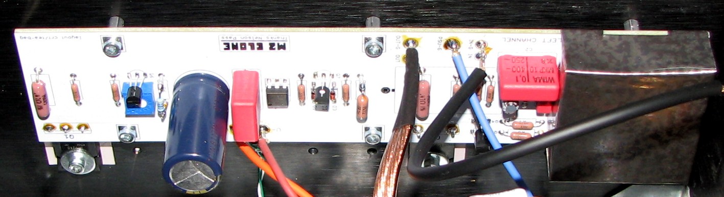

Two U-shaped pieces of foil, rotated 90 degrees from each other, that clip on the Edcor. Reduces hum by slightly greater than 50%. Can now hear hum only within 1 foot from the woofer in a very quite room.
Using the self adhesive corner tabs for a tight seal with mumetal foil, I got 80% reduction.

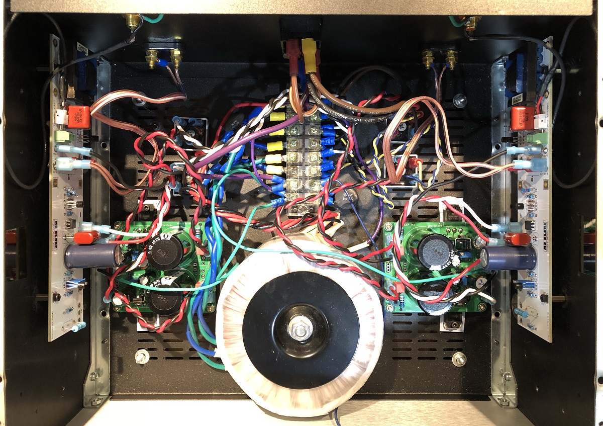

I finally solved my ground loop hum problem with single power trafo and two cap Mx with one pair of bridges cs two pairs. Bridges power pair of cap Mx in parallel. Noise of now 100uV rms on one channel and 300uV rms on the other.

Mu-metal boxes on Edcors and steel tubes around power toroids - noise almost completely gone 🙂 🙂
Nice work - glad the my metal shield worked for you too.

Thanks. To be honest the steel shielding for power toroids didn't make much difference in my case, most noise reduction thanks to mu-metal boxes...
