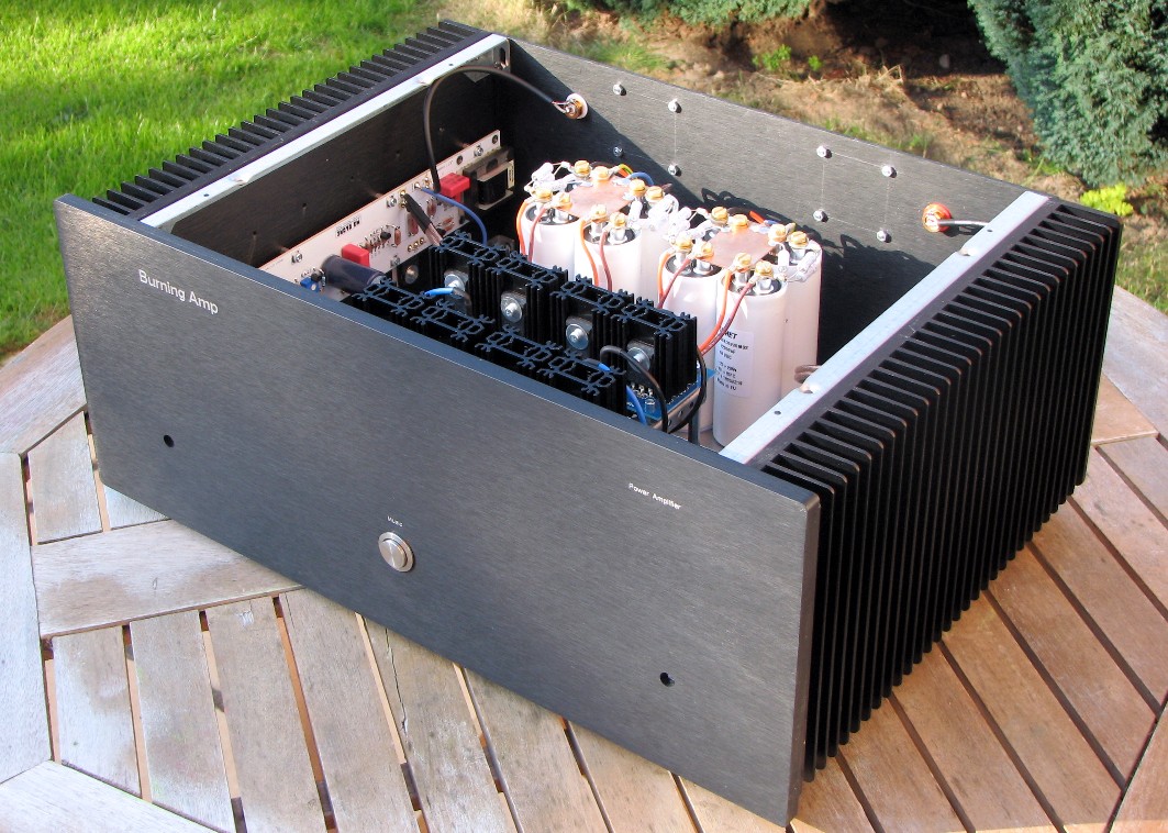

My M2 clone
More images here: Do It Yourself Audio Projects | First Watt M2
It plays music and sounds great, first impression - very dynamic with strong bass. I hear a bit of buzzing with my ear by the speaker, will have to put some screening around transformers...
Nice ! Regarding buzzing, in my M2 I got rid of all noise by turning the trafos. So that the trafo output wiring was as far from the input trafos as possible.
Thanks. Unfortunately I can't really turn the trafors, wires are too short...

Got a part number on your off-on switch there? Nice looking amp!
Russellc
Russellc
Thanks. Not sure, I reused the switch (and chassis) from an older project, but I think it is this one: 693-1241.6821.1120 (Mouser part number)
Thanks! I like the look of it, and I noticed you had the 10mm front panel and it is long enough to go through.
