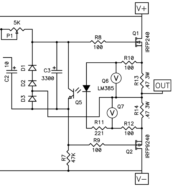

re: Right channel is running away
Maybe a promising first line of inquiry, might be to learn whether the "input side" of the bias control loop is operating correctly. That's R10-R14 plus Q5-Q7, the complete circuit which includes the LED portion of the optoisolator.
It might be extremely revealing, to measure the LED current for the good channel and also for the bad channel. You can get this by measuring the voltage across R11, and then use Ohm's Law: Current = Voltage/Resistance.
In this case, LED current = R11 current = R11_voltage / R11_resistance and the M2 schematic tells us that R11 = 221 ohms.
Are the LED currents wildly different between the good channel and the bad channel? If so that's a giant clue.
It could also provide more insight, to directly measure the LED voltage (positive DMM lead on Q5 pin1, negative DMM lead on Q5 pin2) for the good channel and also for the bad channel. A screwy LED voltage on the bad channel, provides more clues.
BTW you'll want to ask for debug suggestions & recommendations from people who have successfully built M2s using the Tea-bag PCBs. They may have encountered this exact problem already, and can hand you a solution straightaway.

M2x offers the PCB option of installing a 220uF 10V bipolar coupling capacitor (Nichicon UES) in series between JFET buffer and Edcor transformer primary. The M2 circuitry already includes one coupling capacitor, it's called "C2" in the official schematic attached to post #1 of this thread. If you don't mind one coupling capacitor, surely you won't mind two of them??
It also offers the possibility of adjusting the trimpot for just-the-right-amount of 2nd order harmonic distortion (if you go for that sort of thing), having just the right phase, without worrying about the resulting output offset voltage. The new 220uF removes every trace of output offset voltage. Twirl the trimmer however you want; output offset remains zero.
