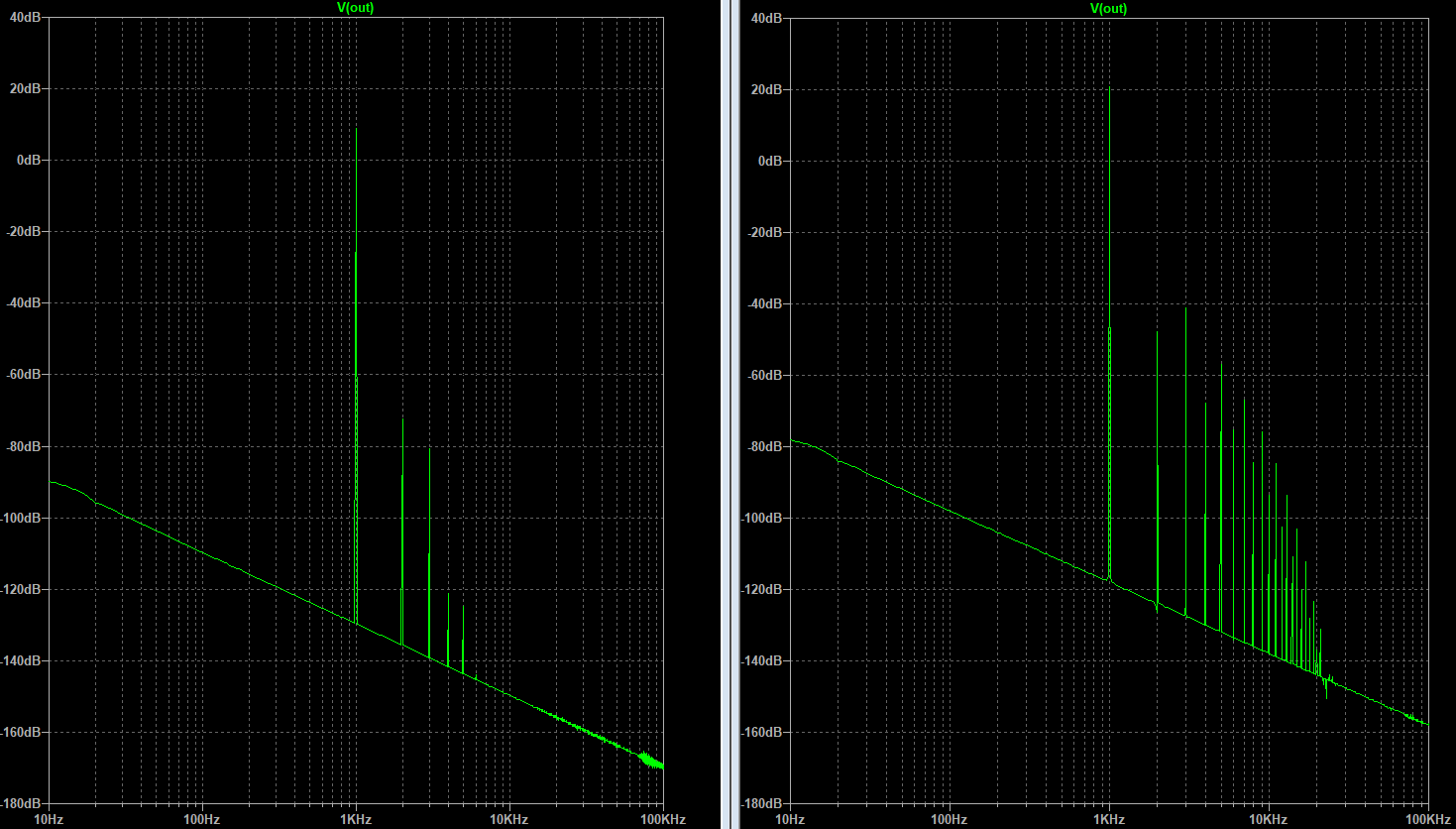

I haven't seen anyone post their LTSpice model so here is my attempt. (use at your own risk, I'm no EE.:p
The way to connect the transformer with 11x gain gives significantly better THD. I'm wondering why Nelson didn't do it like this in the first place ? :rolleyes:
  • M2 attempt 2.asc
Sorry my bad, the one with less gain gives lower THD (I had messed up with other parameters)
Interestingly, increasing the bias does not seem to result in better figures.. so again... Nelson made it right from the start ;)
Below is THD @1W and @15W
Distortion is mainly 2nd Harmonics @1W but seems to get slightly "odd ordered" at higher power (H2<H3, H4<H5, etc..).

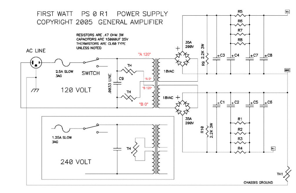

Greetings to fellow M2 amplifier builders. I thought I would mention here, that after doing a bunch of lab experiments, I have decided to substitute a new and different part number in the power supply of my M2. I'm using the same schematic as the First Watt class A power supply (shown below), just with a different part instead of the CL60. I'm not saying there's anything wrong with the design below using the CL60. I just like the new part a lot more. It is my personal preference, with which you are free to disagree. Here is a link, scroll down to post #17 for the nitty gritty details.

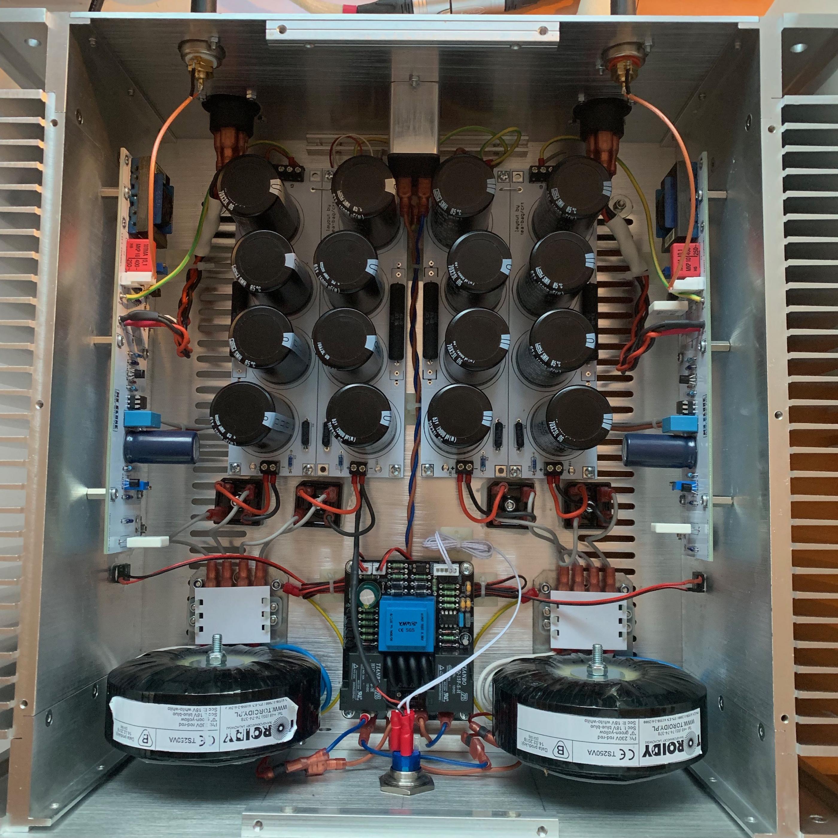

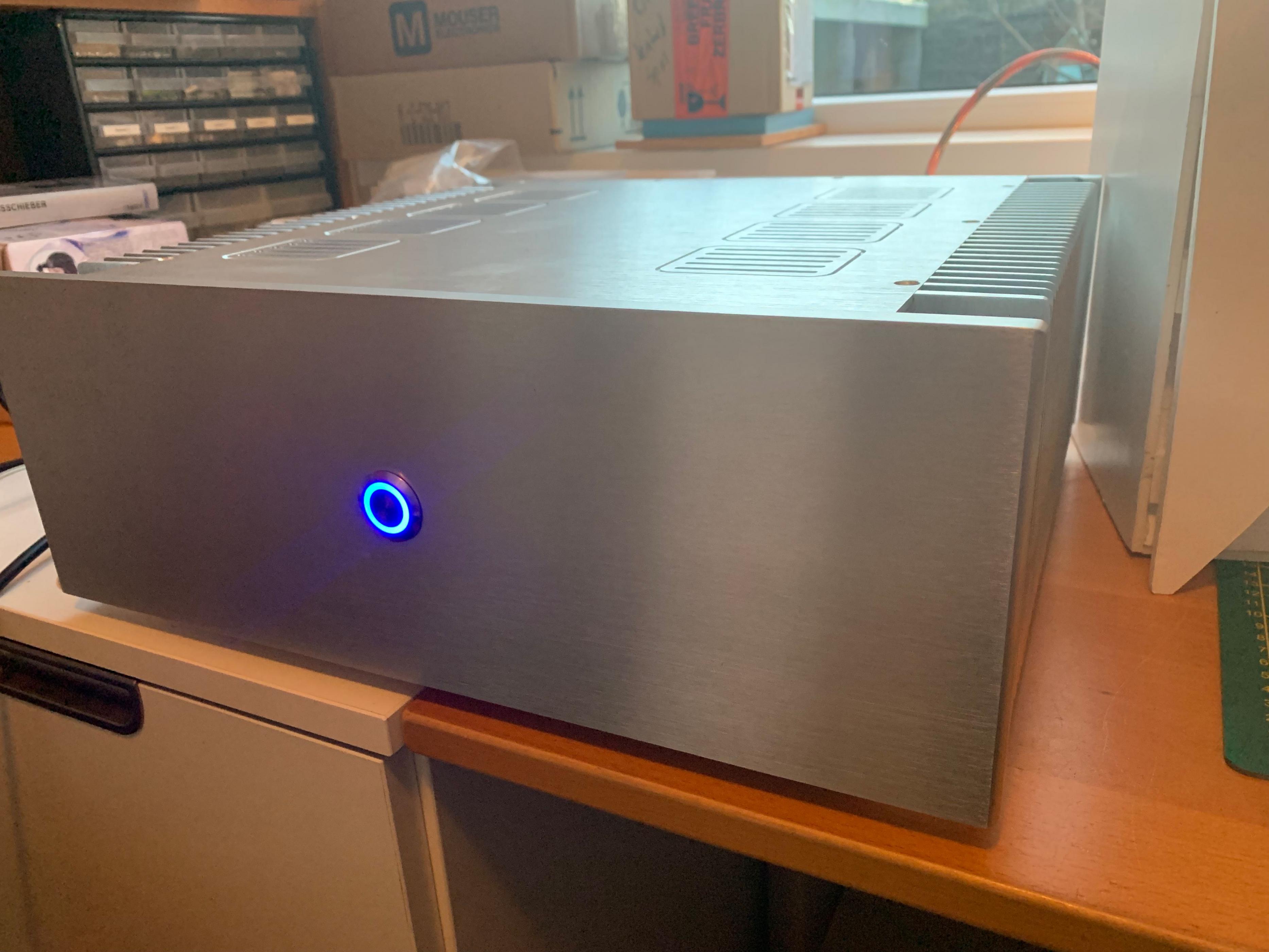

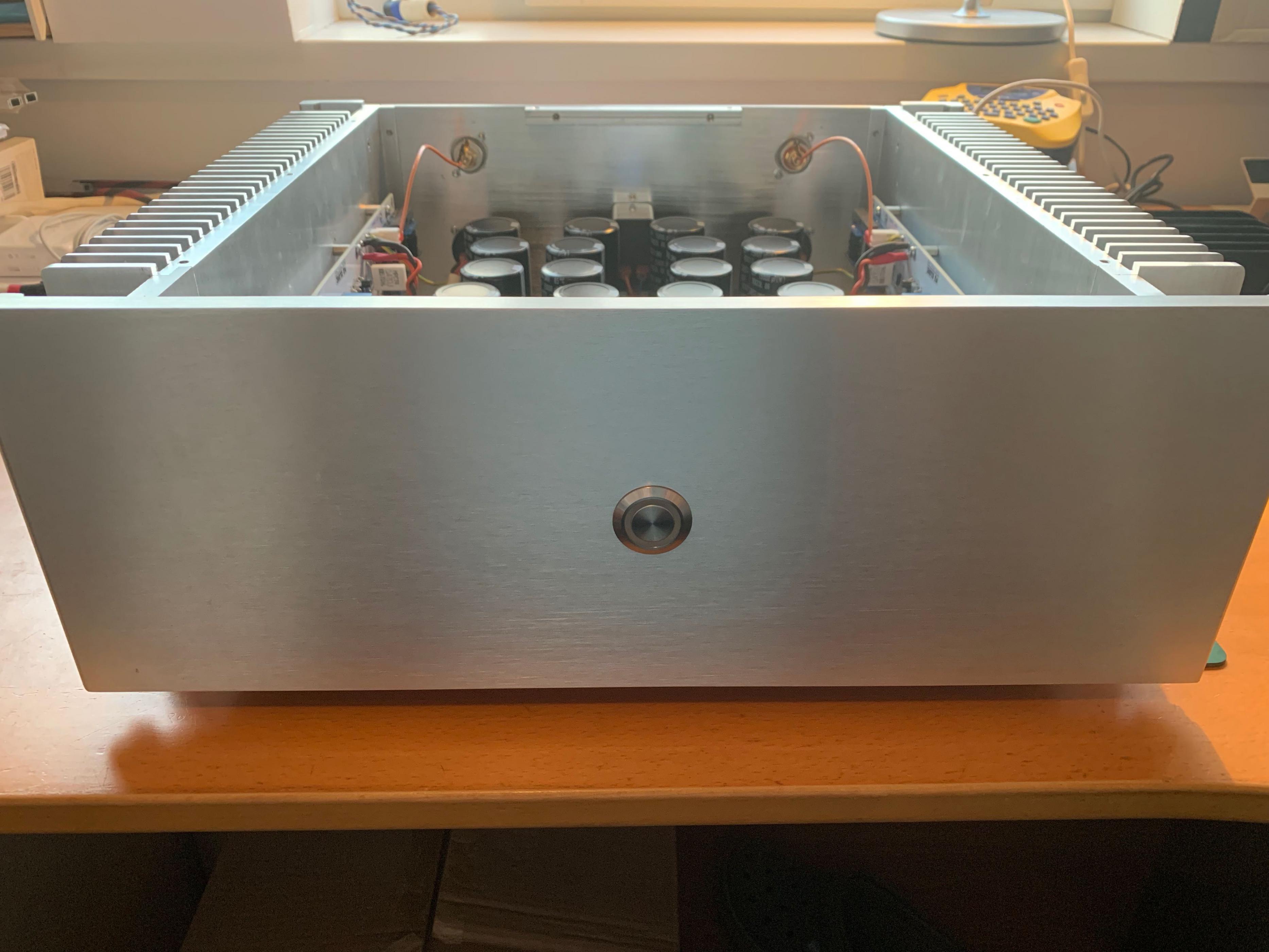

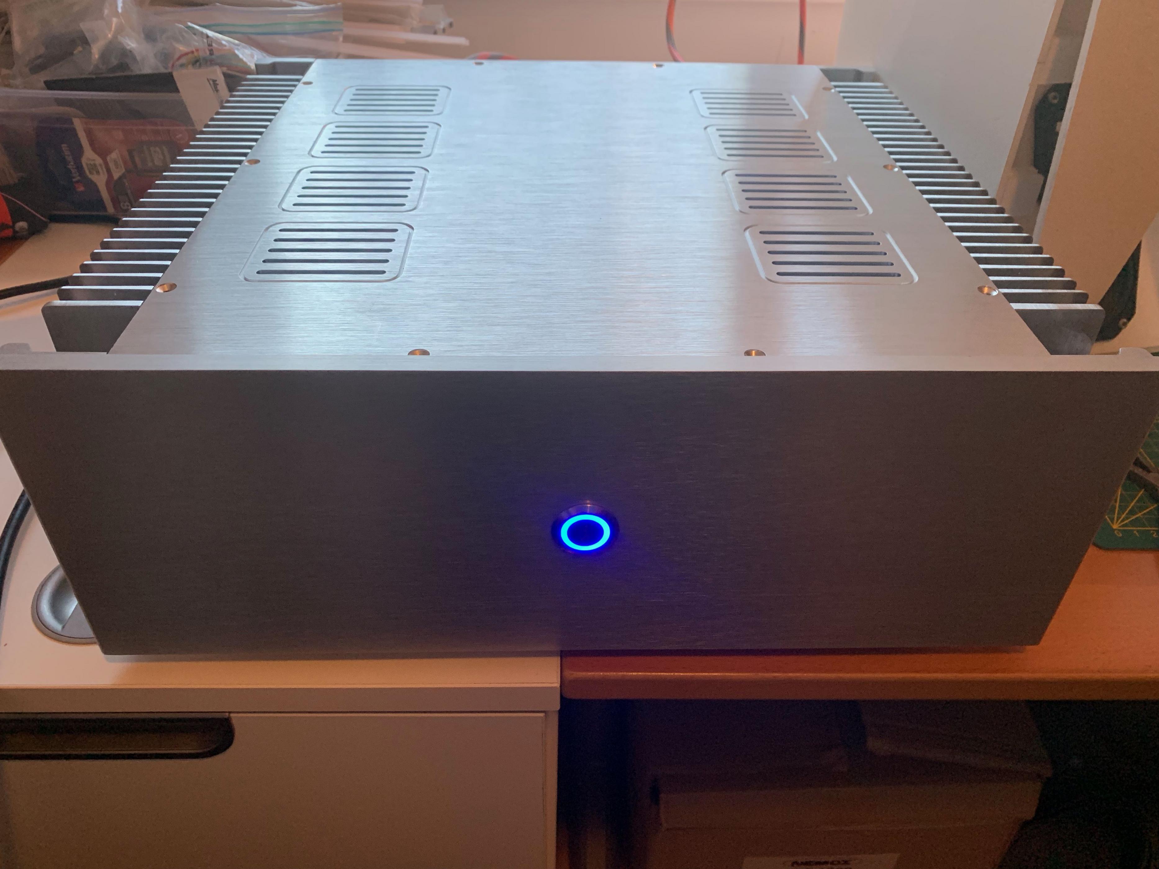

Another one is alive...
Hi all,
Another M2 is alive! Tea-Bag boards, no space for the rectifier boards so used bridges. Case from aliexpress. It is driven by my (also diy) DCG3. Heatsinks get warm but not too hot; I am able to touch indefinitely and measured a tad above 40 degrees Celsius.
Amp is dead quiet on the shown Elac speakers.
Happy!

Nice neat build, looks great! Enjoy your M2!

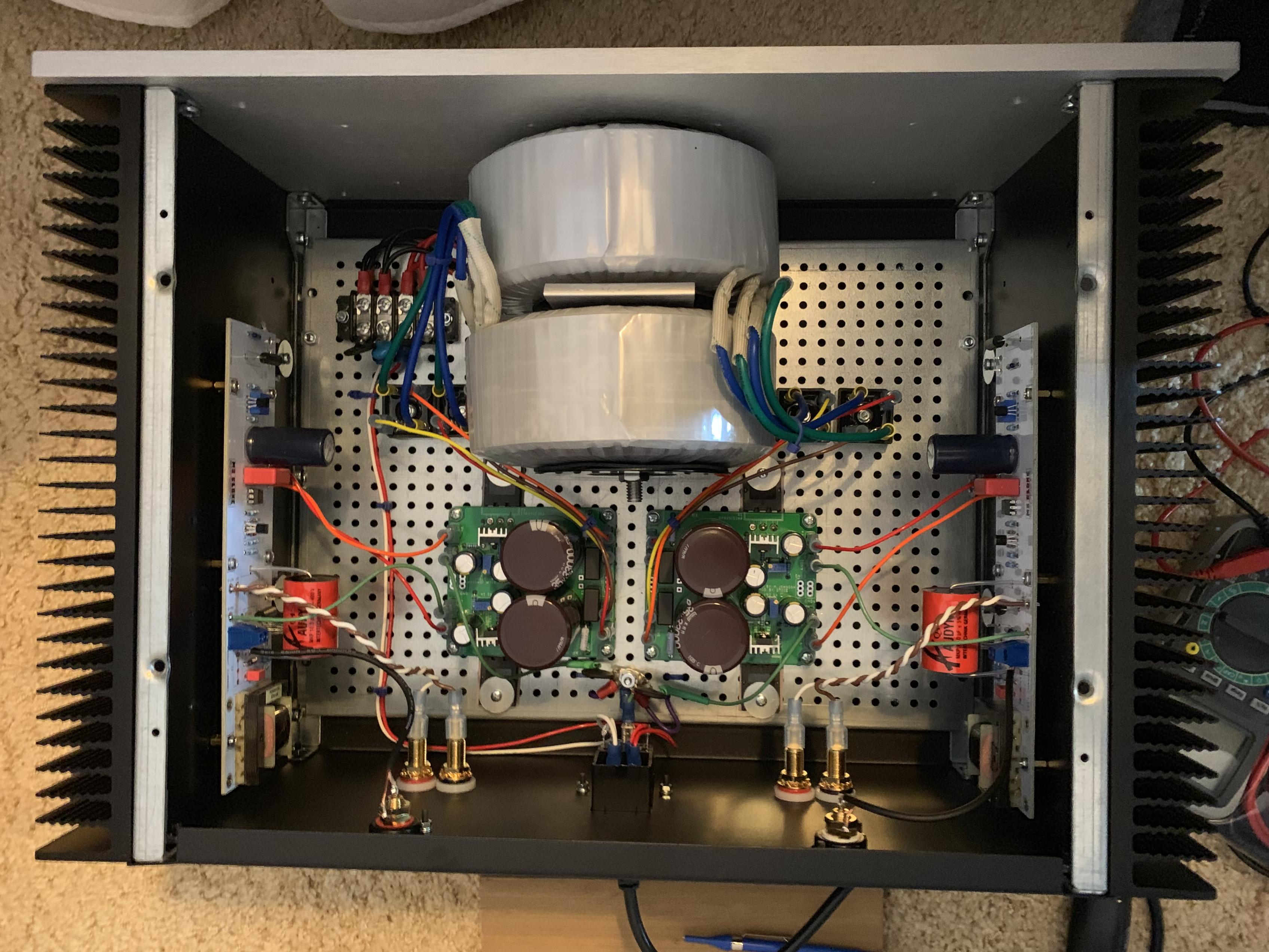

I finally finished my M2C. Tea-bag’s boards are really nice.
I built it with the Cap-Mx boards, one for each channel and dual transformers. The transformers are 20v 400VA, so I can get 23VDC from the Cap-Mx boards. Thanks for the great design and contributions making these available.
I built the amp using the BLASPHEMOUS HERESY offset. I think I my have used a single turn variable resistor, because it is very sensitive, but I was still able to get the offset dialed in with little nudges.
The amp is nice and quiet, with no hum. It also works well with my VTA SP14. I now have more flexibility adjusting the volume and the 100k input impedance on the M2C matches nicely with it.

what is that circuit board in the middle front for?
It is a soft start board with overheating protection. It is controlled by the momentary switch on the front. If one of the two temp sensors next to the amp boards on the heat sinks exceeds 75 degrees Celsius the amp switches off. Seems overkill so far because heatsinks are still indefinitely touchable after hours of playing music.
Only issue so far is that the amp does NOT switch off controlling the momentary push button if the amp has been singing for several hours. :-( I have no idea where to start investigating this. For now I switch off using the toggle on the IEC inlet when this happens
Steef

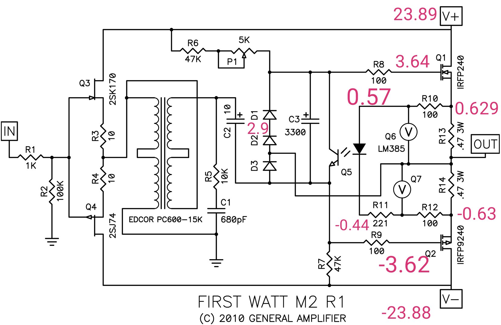

Is it possible that the 240 and 9240 biased at 1.3A+ and ranning without heat?
I have mine measured +0.65V and -0.65V across the two 0.47R, but both of the irfp240 and irfp9240 ran without heat. Not even warm.
But the amplifier sounds distorted and so little. Will it possible for both of the mosfet burned?
Post a copy of the schematic and the voltages that you measured at the most important points.
Hi, Thank you for your feedback, I have swapped 2 pairs of new irfp9240 and 240, swapped new optocoupler, swapped 385-1.2. But still the same, the mosfet does not get hot at all, I can even left it there without heatsink. the sounds is very soft and distorted badly.
The measurements look fine, I can adjust the offset from the trimmer too...

mind to post some pictures ?
that's really puzzling ......
evidently possible two culprits , not just one ........ one problem being problematic Iq (even if i'm more than confused - readings being OK , while there is no heat) ...... and another problem bad sound ..... can be connected , and doesn't need to be
from where you obtained input JFets?
