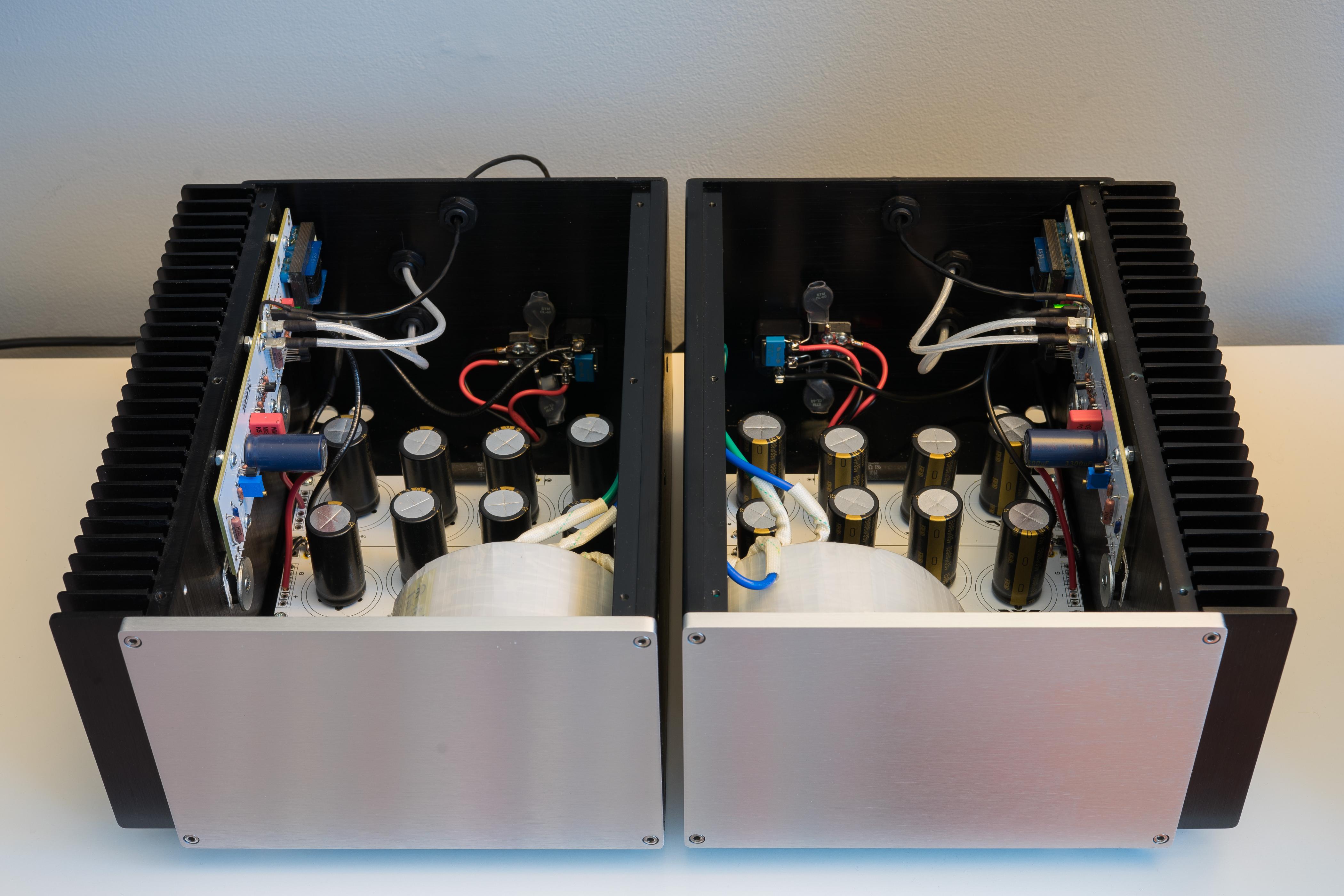

Just finished my pair of mono M2! It's my second firstwatt amp project after a really successful F5. All i can say is that i'm really pleased by how it sound. Smoother and more relax than the F5. Sound absolutely fantastic on my Tannoys 🙂
Thanks to Nelson for the design, teabags for the boards and to everybody that answer all the questions on this thread.

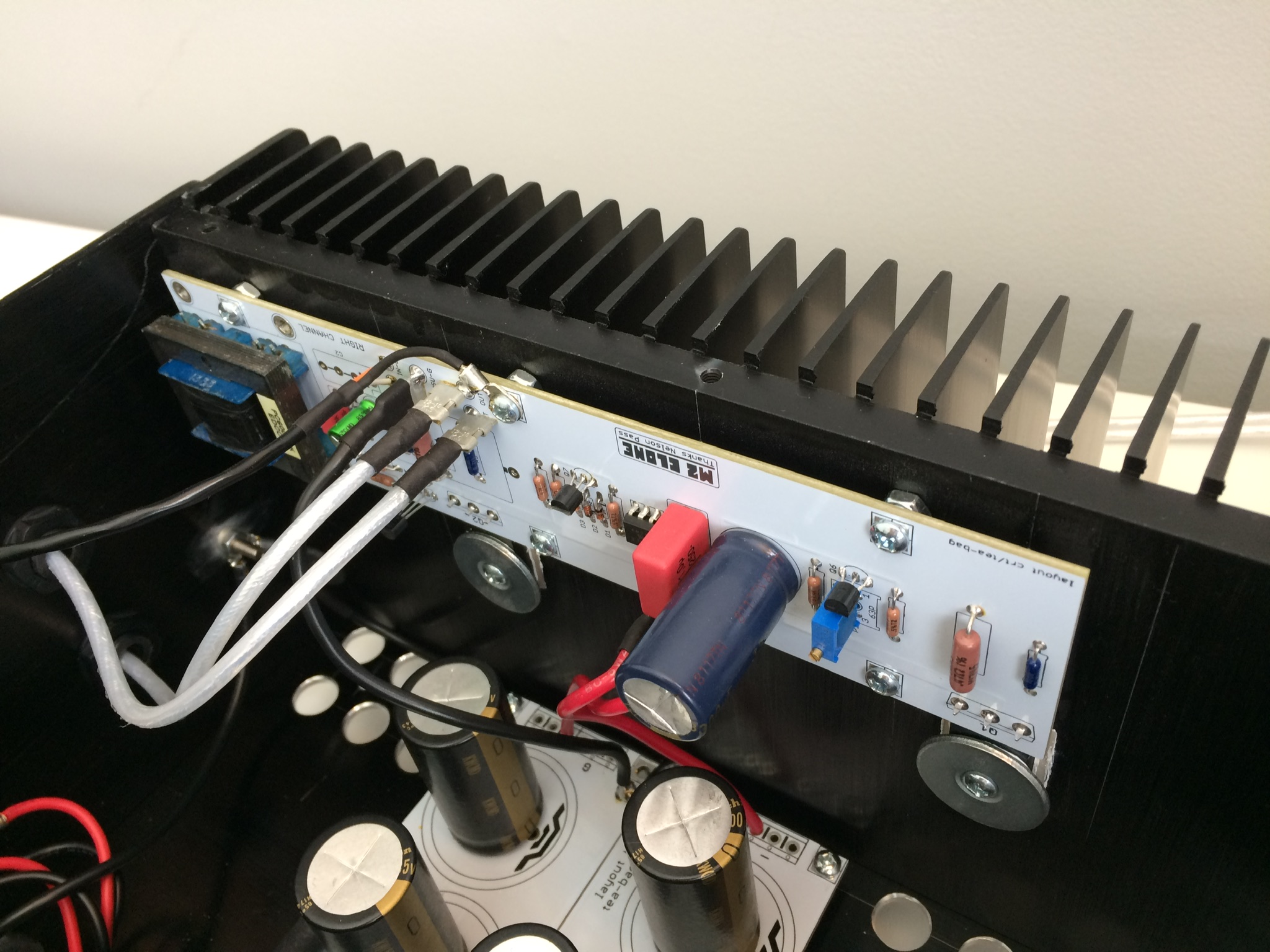

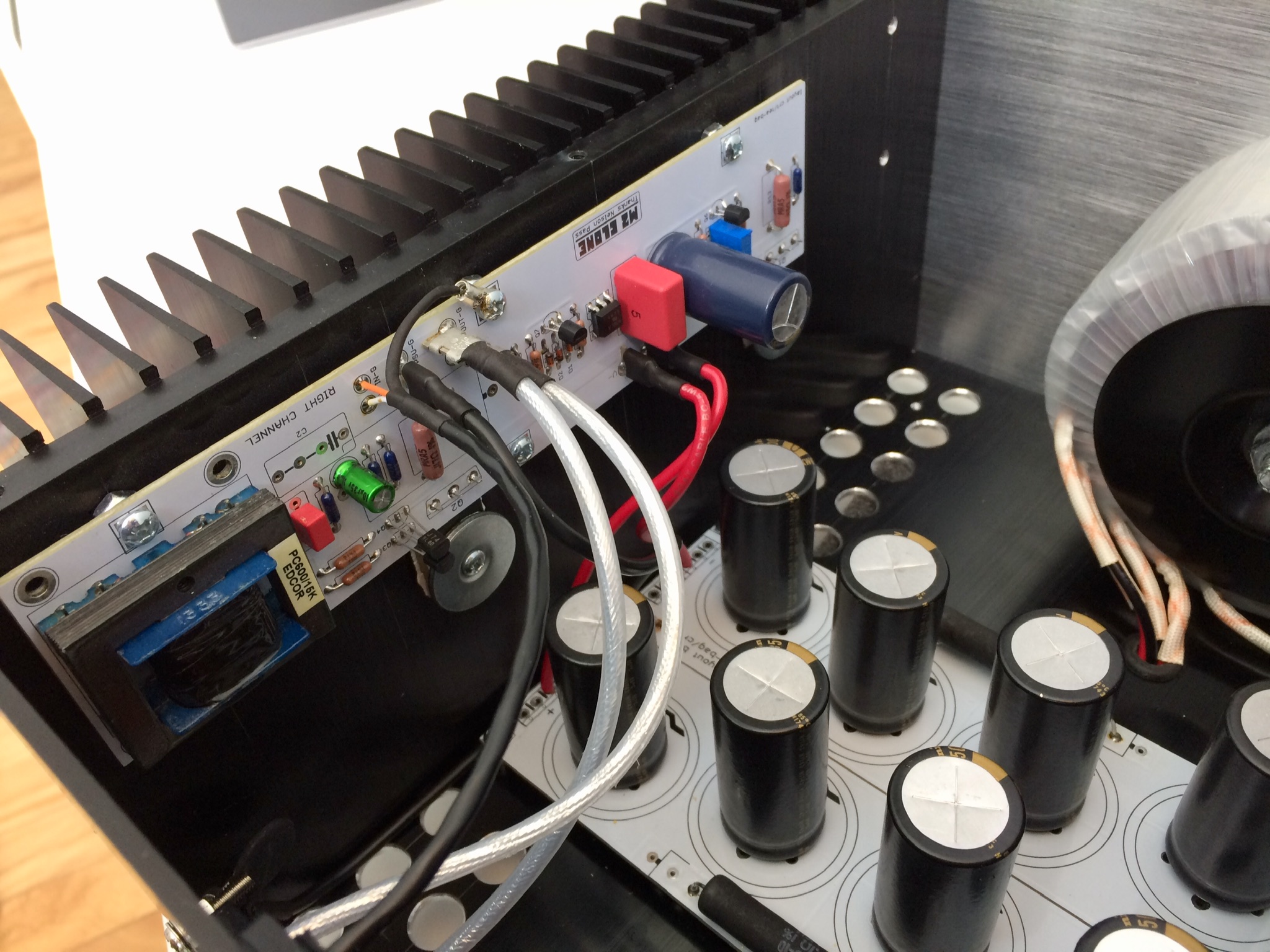

So i have a question for you guys: Checking the voltages on my M2's i have realised that the right channel is biased a little bit hotter than the left channel. I have .61v across the .47ohms resistors on the left channel and .67v on those on the right channel. Any idea what is causing this? The LM385 maybe?? Dc offset is almost 0. Psu voltage is equal on each channel at 24.5v

nice tidy build, congrats! what are the chassis you've used?

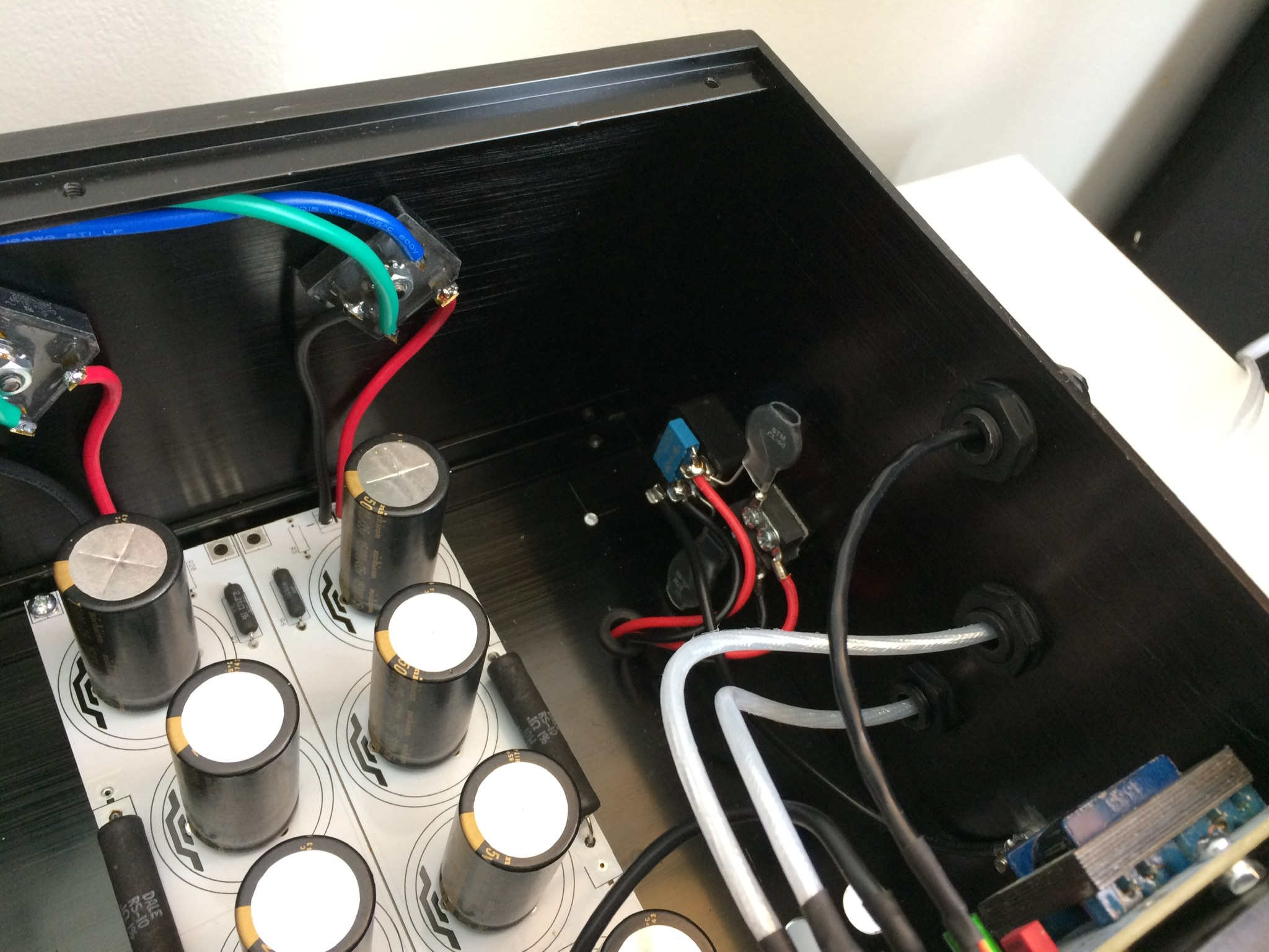

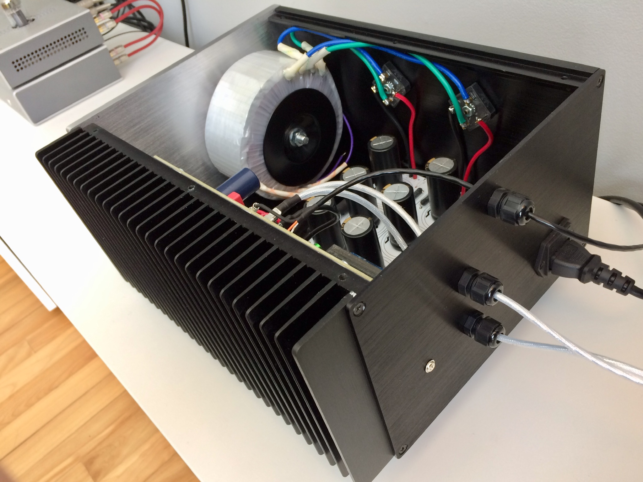

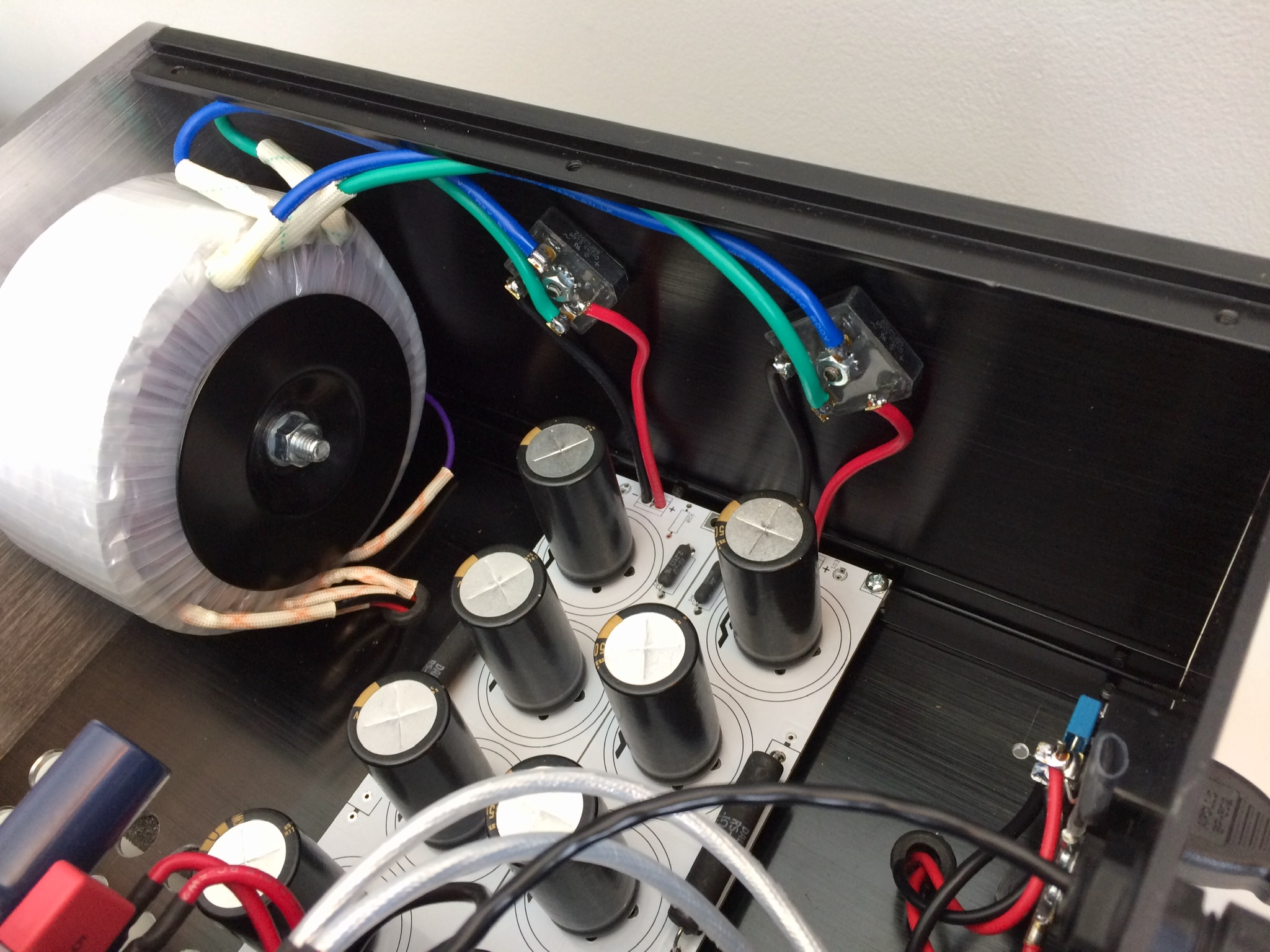

Thank you! I have bought those on Aliexp. They cost something like 80$ each. Search for the model d-041. I have assembled one in reverse so that I can have a right and a left side.
Here is more photos so that I can have a fugly from Zen Mod 😉 And i know it’s irrelevant sound wise but I will still try to find the cause of the different bias point of each side. It’s not the source resistor for sure so I will start by trying to swap the lm385 😀
