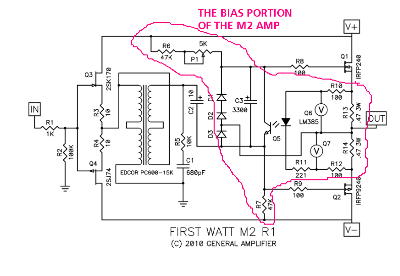

If the voltage across R13 measures spot on,
and if the voltage across R14 measures spot on,
then I would start to consider replacing the super hot MOSFET with a brand new fresh virgin device, and also replacing its thermal pad, and also replacing the bolt and fender washer which secures it to the heatsink.

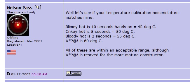

as you know - skin sensitivity is pretty hysterical in short range of temperature (with good reason)
that's why I said - for any objective conclusion , you need to make proper measurement of temperature for all mosfets in amp - ditto on mosfet body , then heatsink area nearby
only then we can make some conclusions
read attached , and think what I wrote in first sentence
