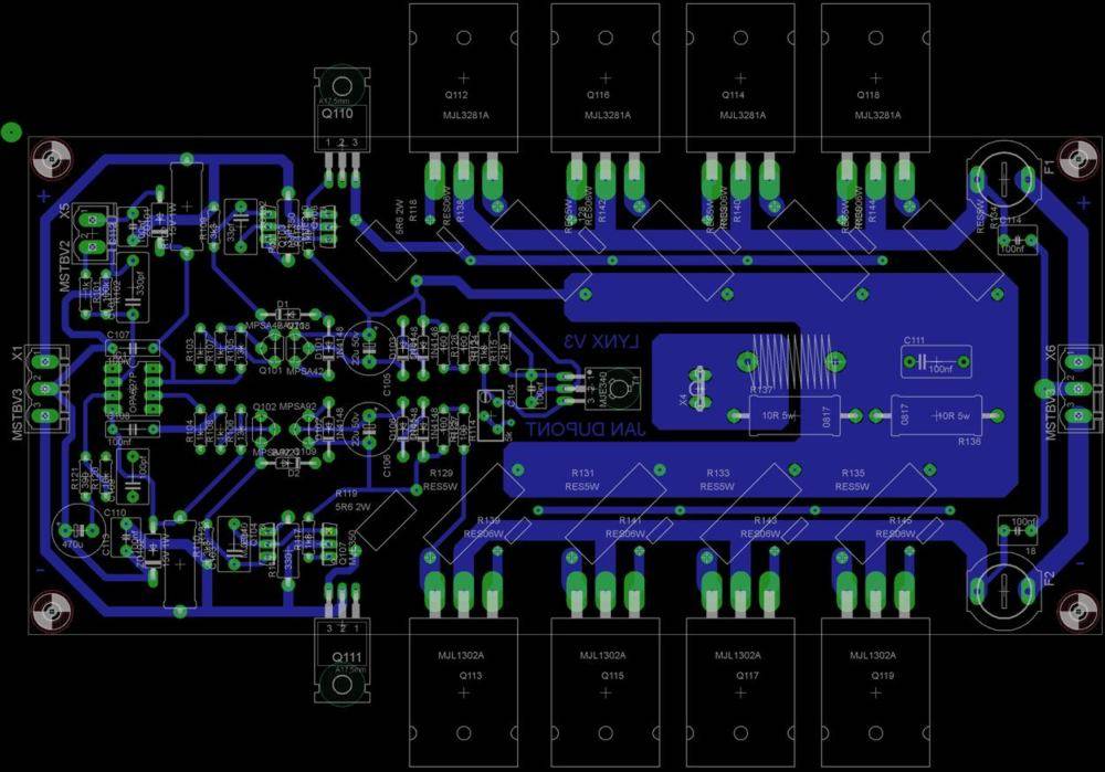

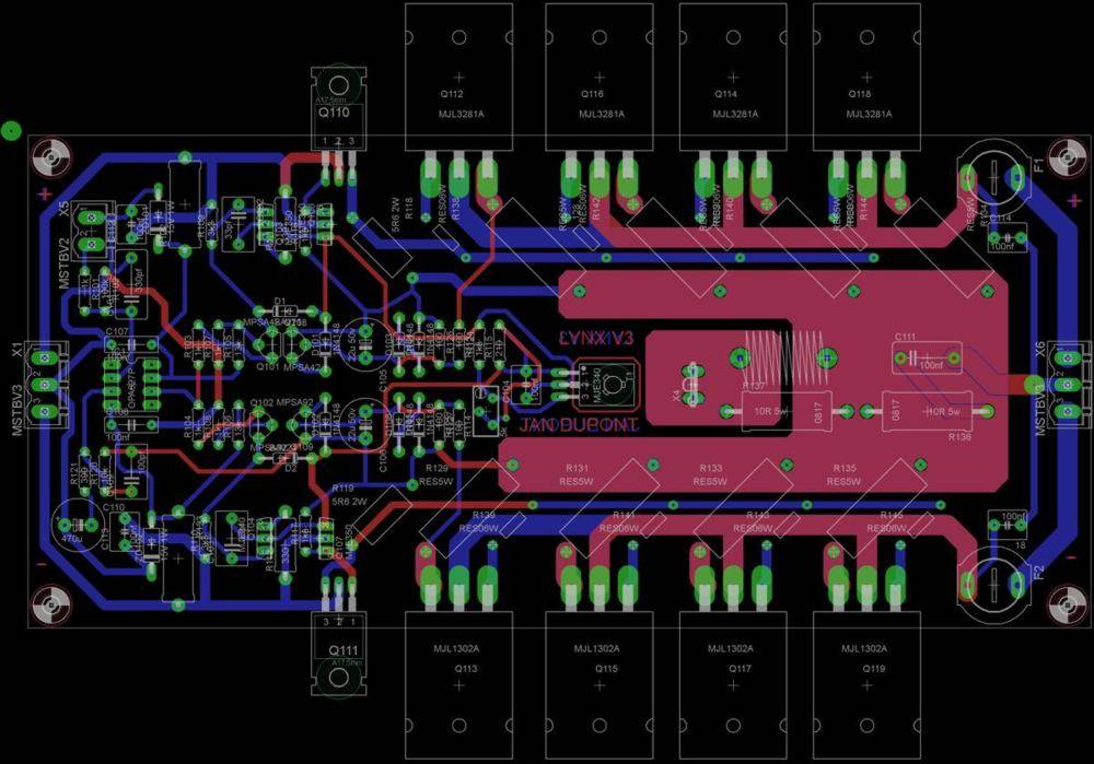

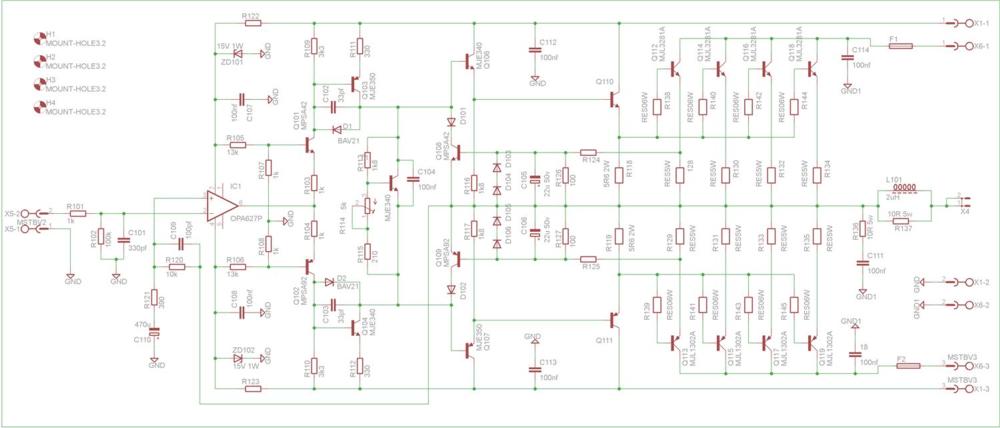

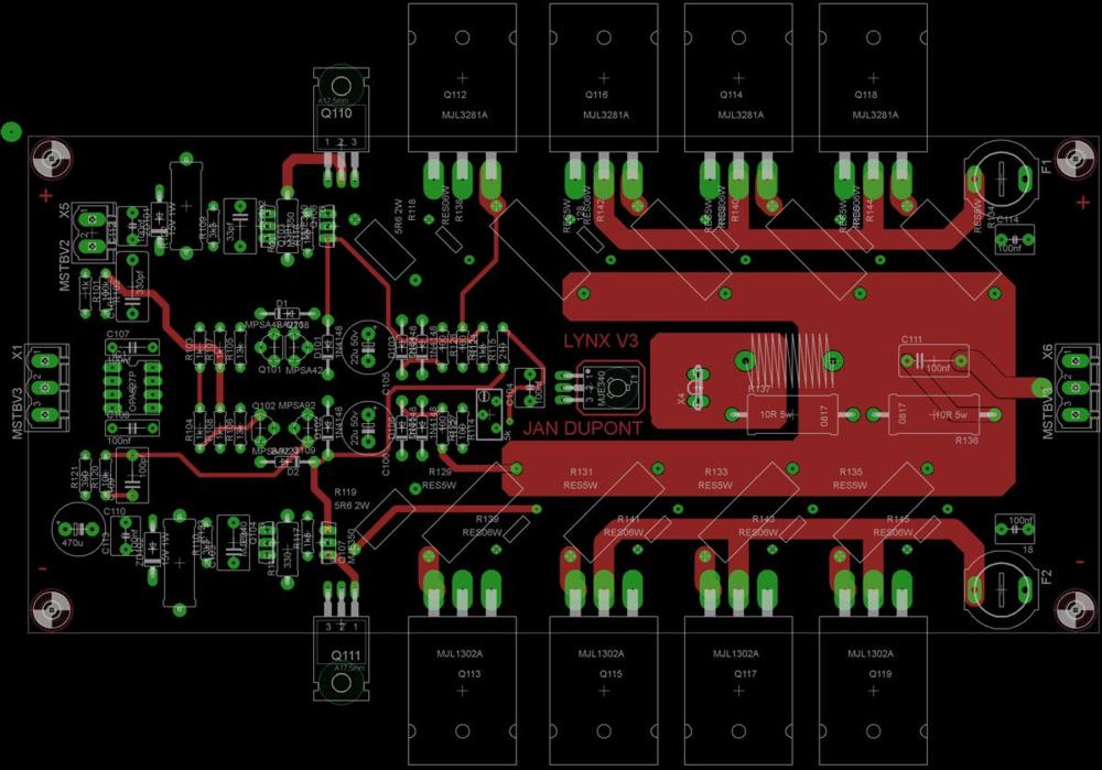

I work last day on redrawn ACD work on Lynx to build localy PCB. I do it with Eagle. For moment this work needs to be seriously verify. I put only image files. Later after testing i will share eagle file with who's interesting.
But note this disclamer :
- The LYNX circuit and PCB layout provided here is only for non-commercial diy build and use! You are not allowed to make and sell copy PCBs! You are allowed to make your own PCBs for personal use, but please accept that in that case Ithat ACD do not provide any support as me! This work is a personnaly work on parts placement with respecting ACD work, i wanted only to avoid the use of metalized hole since i haven't accept on its.
First the schematic redrawn with MJL3281A/MJL1302A output device

ACD said:Idefixes;
Nice work, Marc
Kindly remove my name from the PCB unless we share the same name
No soucy i juste forget It, i see it to late as it was posted
I will remove it on next update.
Marc
