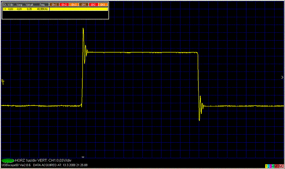

TL071 usually HAS stability issues, especially in a more complex circuit!
Step response to fast rise (under 10ns)
PMA,
Thanks PMA for information this is confirm what I juat try a few minutes ago when I changed the TL071 with another one with different date code and the problem are gone.
I just do not feel comfort maybe its just luck or what ever the basic problem with TL071 still exist. So may I ask what any one else will do if you only has two more choices for op amp LM318 or NE5534
Thanks.
I am hunt mostly for stability right know
