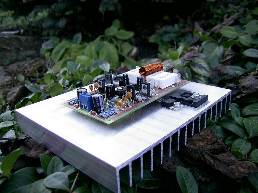

Hi, this is my fifth prototype of modified Lynx.
I sent some pictures and schematic of a third prototype to ACD. ACD called it "Baby of LYNX". This name Likes me . Baby of Lynx have a power supply with symetrical 40V (only one pair of power transistors).
I measured BoL with AP2722:
Output power:
105W / 4 Ohm
75W / 8 Ohm
THD < 0,004%
SNR (A- weighted) > 120dB
Spectrum of output signal:
http://img125.imageshack.us/img125/6199/spektrumal7.gif
This foto shows only prototype. The final amplifier will be done in February.

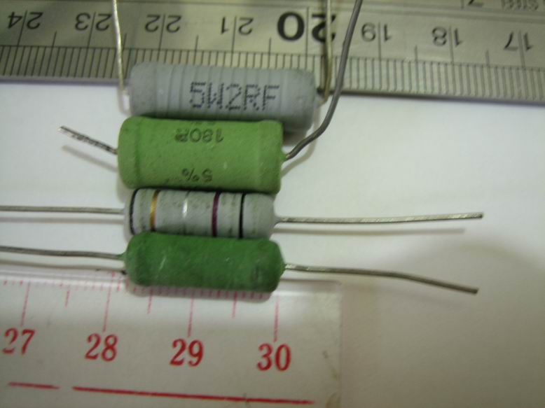

Sorry to disturb again about the emitter resistors
When I look at the spec. of the AC05, they measures 7.5mmD x 17mmL. I had a sample (which is probably not an AC05 and it isn't 0R47 ) which measures 9mmD x 19mmL. Does anybody knows anything about it?
The 1st one from the top seems to be a KNP series (24Lx8D)
The 2nd one from the top is the one I am talking about.
The 3rd one from the top would be a 3w KNP
Correct me if I am wrong, tks

bigpanda said:Sorry to disturb again about the emitter resistors
You should avoid the wire wound resistor = inductance
Metal oxide is fine.
