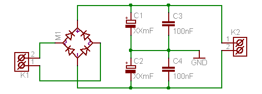

Something very important:
Power supply must contain at least TWO 100nF ceramic or foil capacitors paralell to output!
I recomend to place two 47uF (or more) capacitors to a Lynx PCB between V+/GND and V-/GND.
If you do´t use 100nF capacitors, the oscillations are very probable!
I have these (foil capacitors), but they are not mounted yet. Are they really that important for the amp, even though the output stage is not connected yet?
Yes, that is very importat for most of amplifiers. When I tuned my smaller version of Lynx, i saw on my oscilloscope large differences between supply with and without theese 100nF capacitors. Is posible, your amplifier will oscillate after add 100nF, but oscillations will be smaller and your amplifier won´t blown up. Key to stability are as well C102, C103 and C109.
Adequate sollution:
