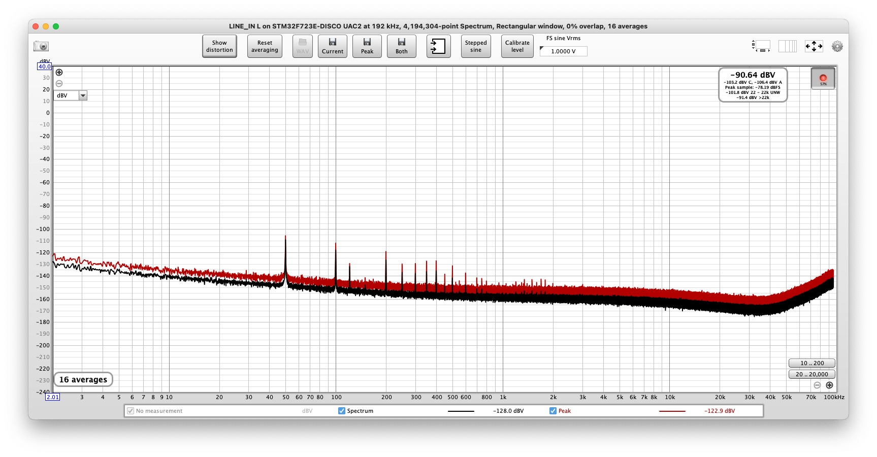

So.. I took the liberty of moving the analyser away from it's usual position (next to a mains connector block) and making the screws of the box bite into the metal through any paint using gripping washers. With no lid and no shorting of inputs:
Better - there's less noise by the looks of it, with the 50Hz mains obviously coming through the SMPS bench supplies. If I can get to <-140dBV then I will be happy.

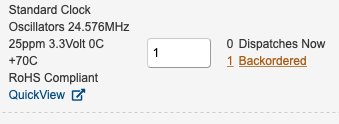

So it appears mouser has shipped a new oscilator and it’s not backordered.

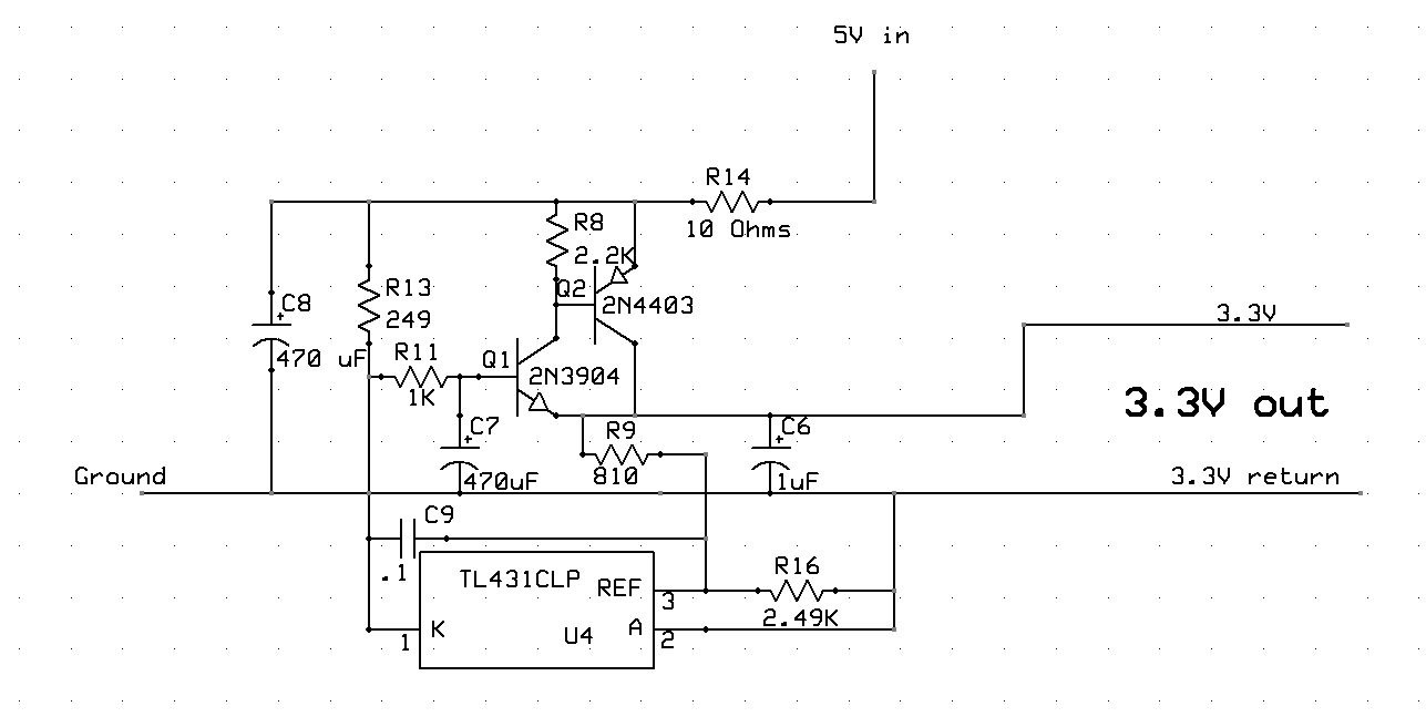

Also, as I’ve have been going through the schema for pefu’s shunt I completely missed it doesnt have a current limiter or resistor in series so it needs something between to limit a 5V supply. Facepalm. i have two sets for simpler 5v to 3.3v which will work.

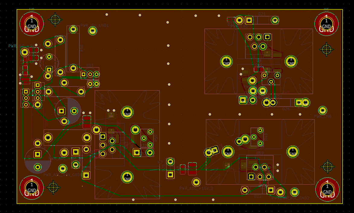

I’ve decided to first attempt a doubled sided etc using the old method of laser print and transfer toner to make a power supply board.

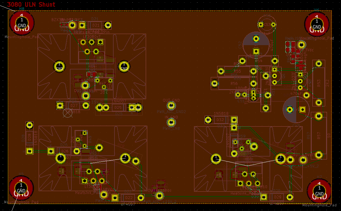

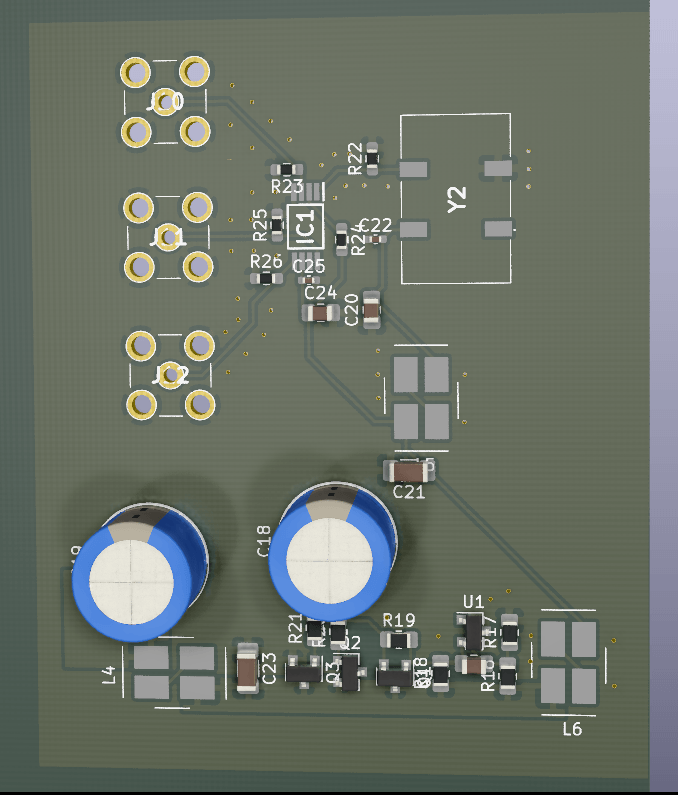

First attempt at the ULN PCB layout.. It's funny how when you think about SMT vs THT, there's differences in the technics you use. I found myself rather annoyed at the size of the THT (the 3080 is the THT HS variant for current).
I have some parts, I have a double sided non-photo etch style PCB. I'm trying to work out if it's simply best if the ground is in the centre as a star ground. That way each regulator return current from a DC perspective will be straight to it. The high frequency will follow the paths back so I've kept the paths separate as much as possible to prevent cross talk.
I still need to have a think if this is a good layout, I'll then worry about the impedance of trace thicknesses.
Power supply shuffled around - the flow seems better around the board and components seem to fit better. There's a couple of changes (that diode under the heating will be piggybacked for example). There's a cap that needs moving too.
