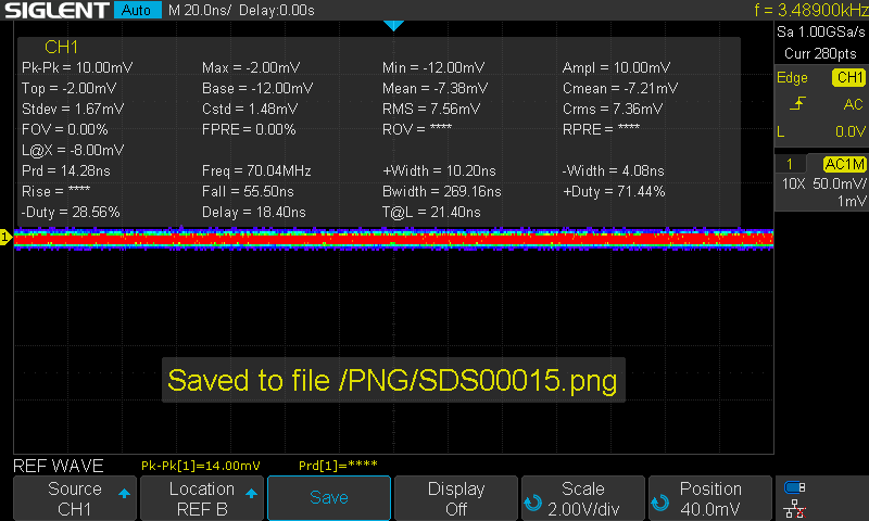

Fixed and remeasured the protoboard shunt - that's now delivering 14mVpp which is better.
I have found that the SMPS itself is generating a large amount of ~400Hz noise out that the scope ground is picking up. I can short the probes without the shunt even in the loop and it's picking that up. I may have to try a couple of batteries and see the difference.
That 600R@100Mhz inductor reduces the scope's FFT to -110dB floor with -80dB smaller number of spikes up to 50MHz. So it may be worth switching to use a chain of those. Only issue is they're not big current (they're really small SMT).

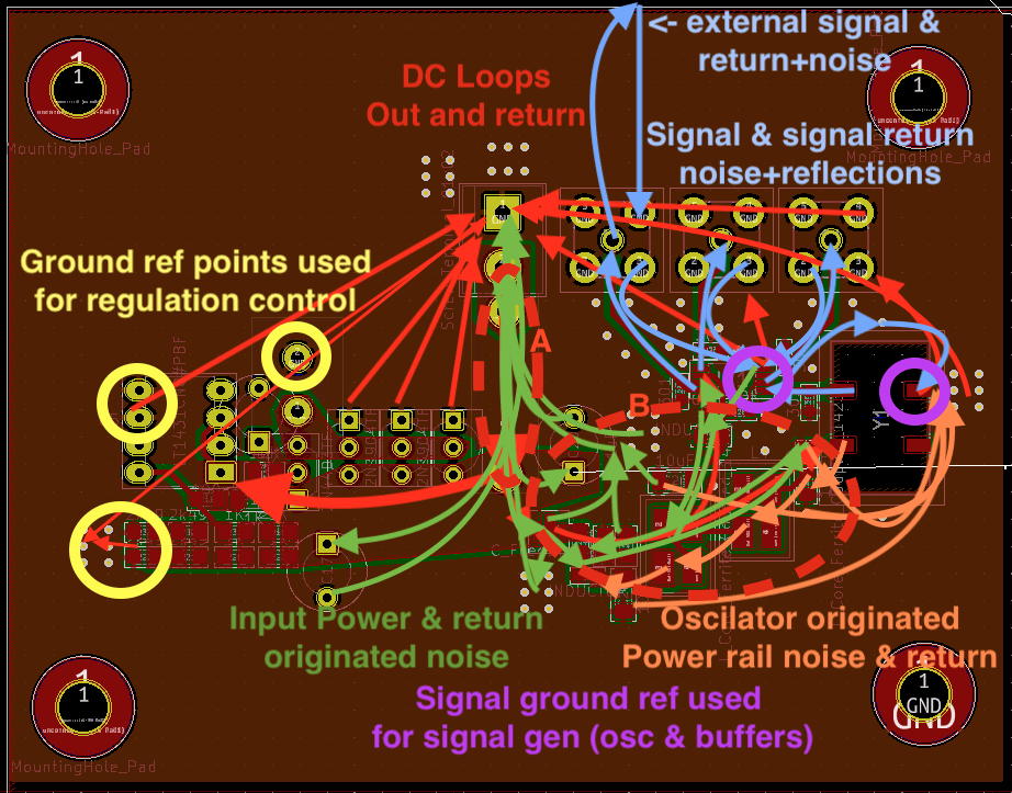

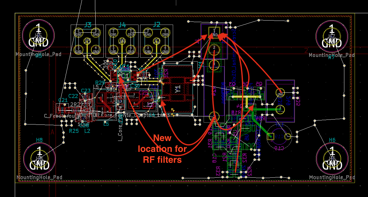

Adding some more thought on this - with the concern point for the regulation (should be out the way of the ground return fields - ie in a quiet spot). The currents through here is very low compared to other areas. These yellow circles need to be outside of the noisy areas - I should really add a curtain of vias around the outside of the board too.
The purple circles highlight the ground point for the signal generation. Here I have a pour hole to prevent capacitive coupling for the oscillator (blindly following recommendations here) however that does mean that the signal return path to the oscillator ground has to find it's way around the hole creating EMI. I would question how much hole is actually needed- the oscillator itself is actually on a double sided board with the back of the oscillator board (on the outside facing the world) is actually a complete copper pour. (see attached images of my previous dead CCHD).
The only thing I can think of is ensuring that there's minimal currents across the ground cage that surrounds. The external signal will have both reflections and noise on the signal return coming through the BNC shield. So this may be better as @1audio has indicated using an isolating pulse transformer to prevent the noisy return from getting to the signal ground reference (purple circle on the buffer chip).
I did look at area A - that area under the THT resistor for the incoming power. I was wondering if a small tongue of V+ as a guard rail would help provide a lower impedance path under the THT resistor for the return current on the opposite side of the board.. BUT.. it's dI/dt and there'd be no change in current only a stable voltage. So I decided to leave that as ground pour. It would have also made a larger island for the noise from right side of the board.
I'm looking at area B and thinking that's hideously complex - it has ferrite chokes in Z form that, from real world testing, that provide some good but mind blowing reduction of noise. The real noise killer is the titchy 600R ferrite bead which really kicks the incoming SMPS noise - so I suspect that is the case for the ~24MHz noise from the OSC and the buffer power rails. I will experiment today with the signal generator and the noise impact on that. If they don't earn their position on the board then they're out. I can also then check the dB attenuation for each.
C17 is looking like a candidate for deletion too. I'd need to look more closely at the schematic.

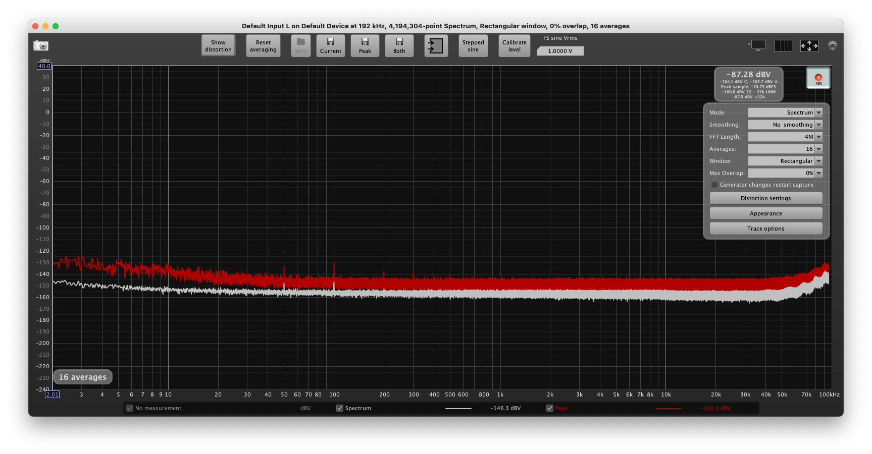

So an ADC update 😀
1. unshielded external Protoboard LT3080 supplies without HF ferrites etc - just between the SMPS and the ADC.
2. Protoboard Digital Isolator with @1audio's original shunt (5V to 3.3V) + isolation IC - this is between the STM and the ADC thus isolating all the i2s.
3. Still using the noisy SDG signal generator for master clock.
4. lid loose closed on top
That's not a bad noise floor drop. I still have some additional thing I want to do (and I want to order the clock PCB this week).

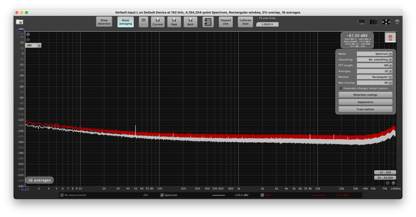

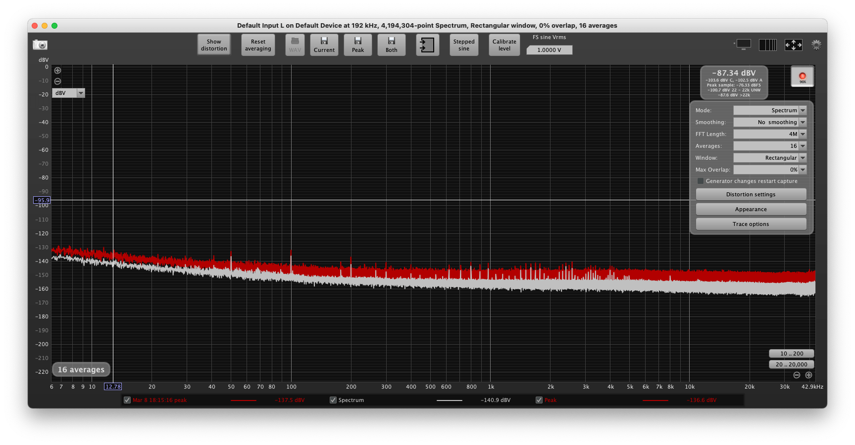

It's just struck me that that's only to 42KHz not the full scale, not sure how I managed that.
I've also explored the grounding - this is just now with the only two grounding points being (a) the BNC to the SDG and (b) the USB shield that may or may not be touching the shell (thin slot for mini usb). First averages from power up look good:
Removing that ground loop has massively reduced the amount of harmonics and spray across the spectrum. I suspect the 100kHz rise being SMPS bench power supply switching noise (rated 120mVpp of ripple). It looks like there's a peak and spurs in that which is why it looks more like a hard signal with a fundamental at 100kHz rather than a rise in a broadband noise floor. I'll look at adding a common mode ferrite choke to the power and possibly a 15mF RC filter to simulate the linear power supply I am looking to put in - I may use a separate box with an umbilical as there's not much space in the box.
Additional to this is that currently the i2s is carried by unshielded ribbon cable which will be radiating all sorts of noise.
Letting the system warm up and stabilise (it's now drawing 110mA and 59mA from each of the two 18V floating supplies). I can see more detail:
Without that obvious ground loop and the extra detail I can now see the 100kHz peak is really nasty. I'll try putting in a CMC however the ones I have available are targeting the 24-25MHz at maximum impedance rather than 100kHz. The LT3080 will have rolled off in their PSRR by that point too.

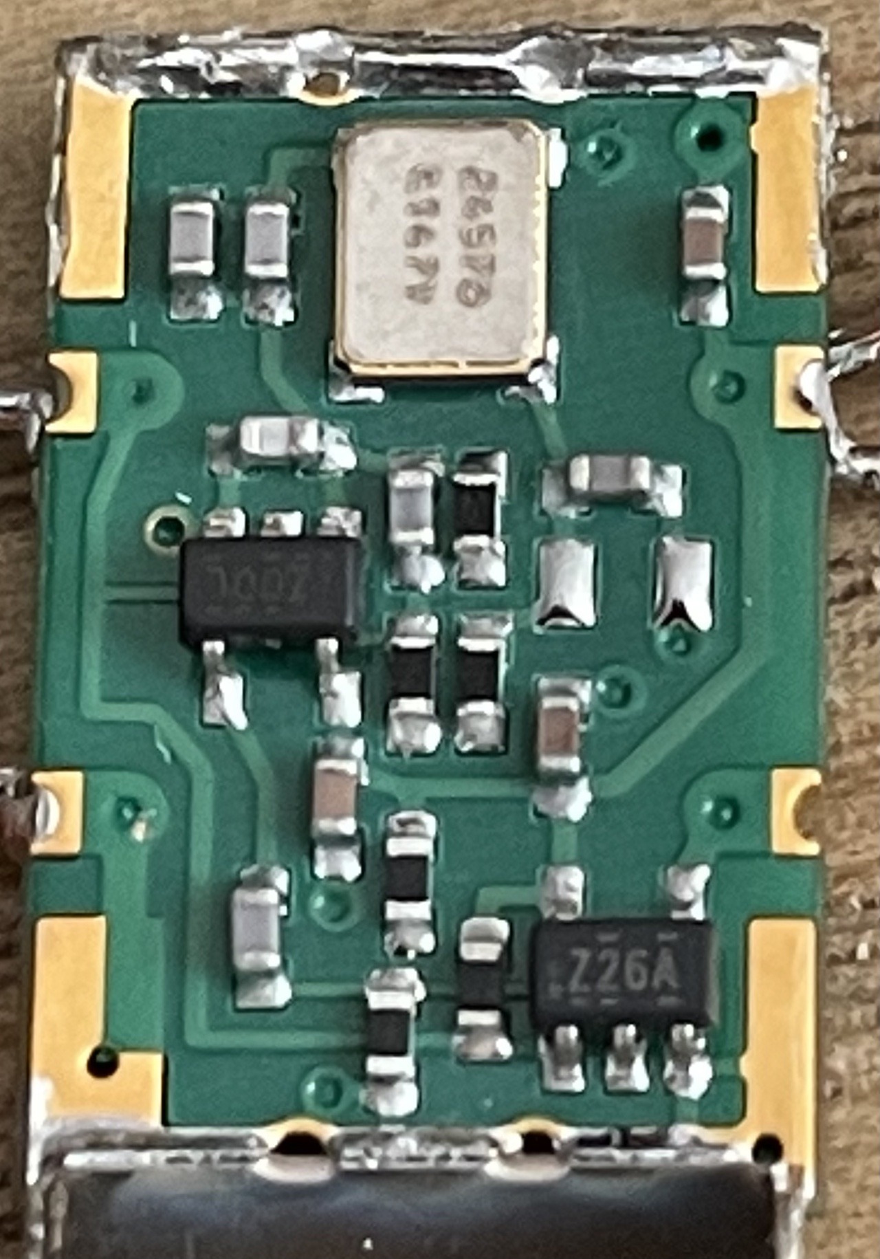

So the the clock - I've started on a new PCB layout using a 4 layer stack and using microstrips for the signal path. I've also switched the THT components to their SMT SOT23 equivalents along with many of the other components to reduce the loop sizes. The power dissipation for the SOT23 packages is 200mW but the LTSpice sim seems to show about 14mW each which would be acceptable. The 4 layer should reduce RMI and the enclosed microstrip should slow the transitions too.

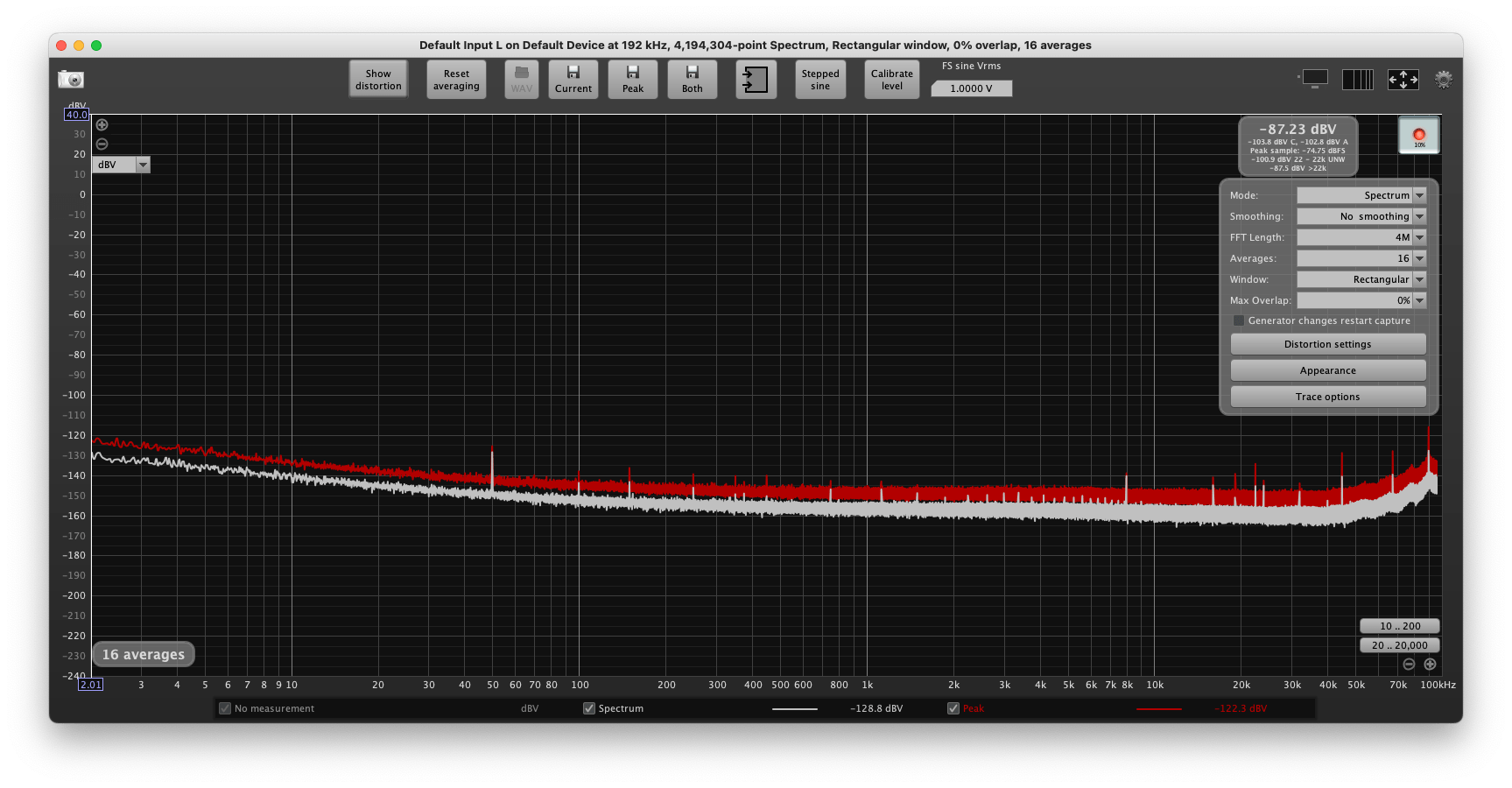

Hehe putting the 15mF caps across the input for the regulators (between the SMPS and the regulator) has resulted in this lovely display:
That's a considerable reduction in LF noise which is good.
That rise of the noisefloor towards 100kHz is due to ADC noise shaping. The 100kHz peak is something else.
Agreed - I think there's a 100kHz fundamental which is then comes into the noise shaping and results in further noise. I'm ok with the noise shaping but just want to get the entire noise floor under 140dBV (my target). I'll have to check the power supplies and the SDG and see if I can spot anything on the scope FFT (setup so it's focuses on that region with the sensitivity turned up.)

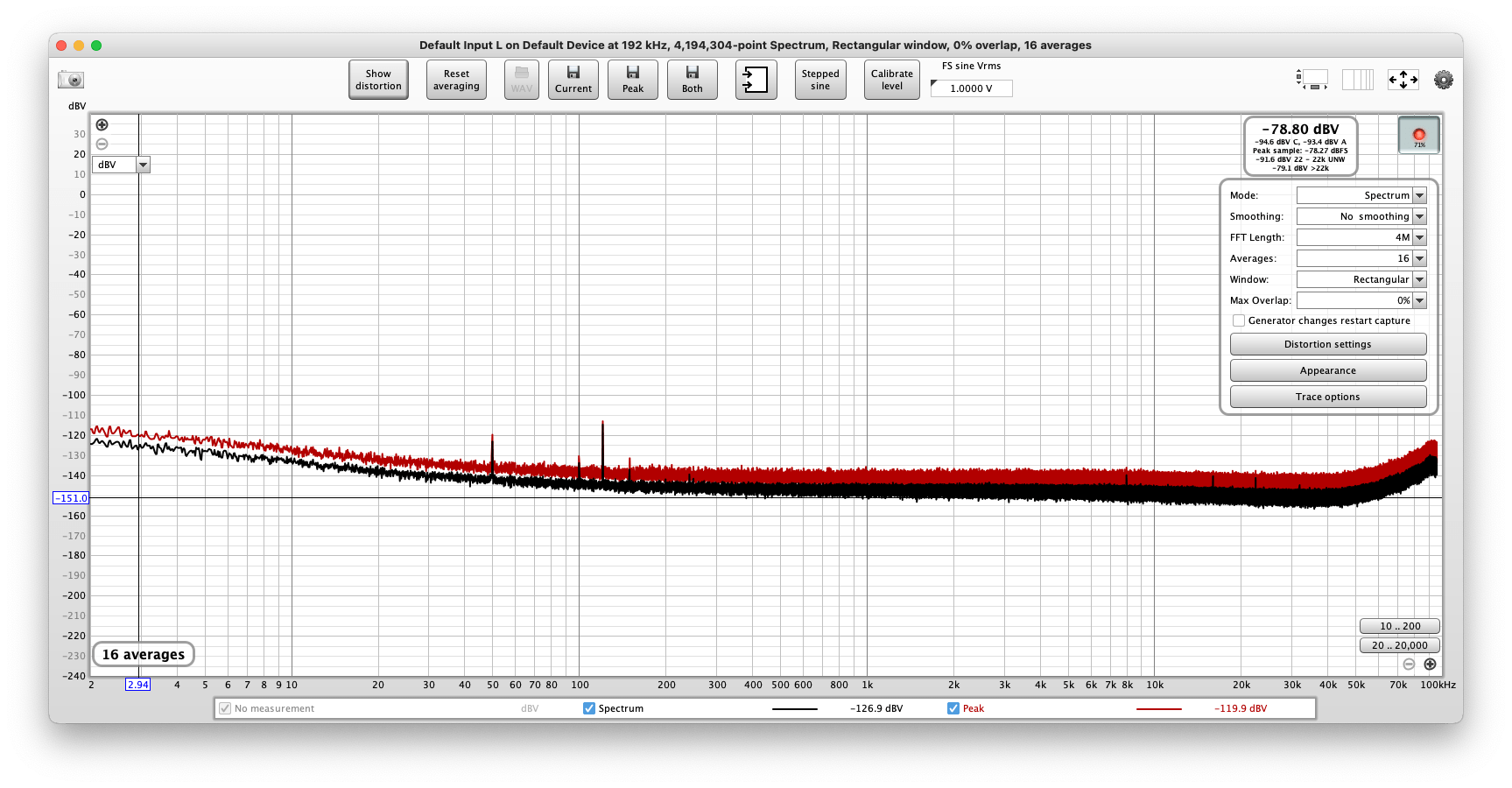

Using the THD distortion settings with a LPF and HPF, the harmonic filtering means the noise not associated with a harmonic is rejected. The result is 16x average:

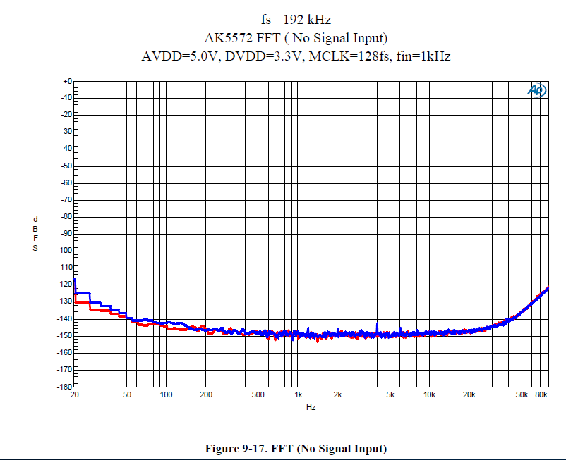

Although we're getting closer towards the AKM figures, I would still like to get the clock PCB and PSU finished so that the device is basically standalone with the host.
I think it’s almost quiet enough now for my needs (but still tweekable!).

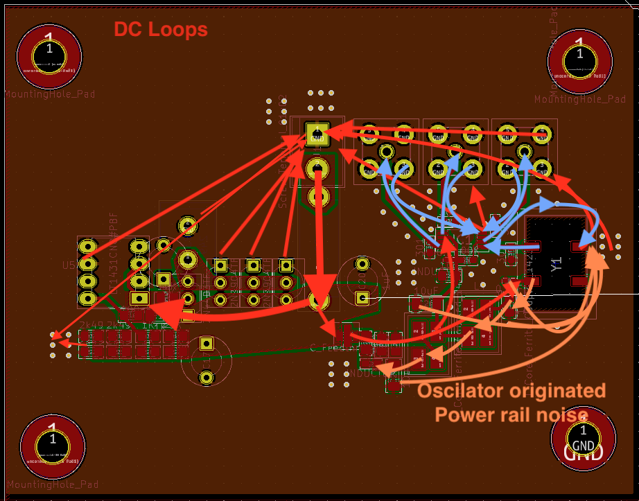

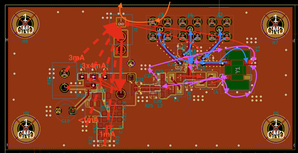

Ok, So I made a 4 layer board which I'll oder from jclpcb. I may add a couple more cap pad. 100mm x 50mm. All vias are through hole to all layers, the signal path for the clock is running on a strip line between two ground layers.
Thinking about this more I think there's a more optimal form - move the mirrored shunt to the right side and shuffle the HF area over to the left. This would mean that there is a short DC loop for the oscillator that doesn't span the SMB connectors and any associated ground current from that.
I could easily cut this down now to a 2 layer too which I may end up doing.
This change could actually be beneficial - I flip the DC shunt on to the back so that it faces up when it's installed, the RF clock side sits on the underside against the metal chassis (making a box) with only the SMB connectors pointing up on the back side of the board.
Red arrows showing the DC loops.
