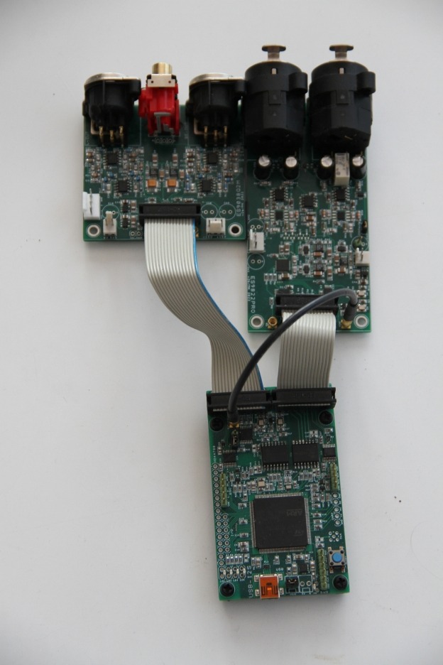

Nick's audio test system (AK5572 ADC 129KHz 32bit stereo balanced input)
Now with added LP5907 + 1uF caps OR resistor + shunt. I may move the DC side right a little as that ground via matrix next to the oscillator is getting claustrophobic.
Like most LDOs it will still need ferrites etc to cope with HF.
I've essentially finished the design - I need to double check the pins against the data sheets for the ICs etc. These can be populated by either a PL5907 with two caps or the shunt. There's also edges free of mask to make box. I've included a multi-turn borns pot for initial testing that way if the initial 10K resistor isn't right it can be trimmed then replaced by a new value.

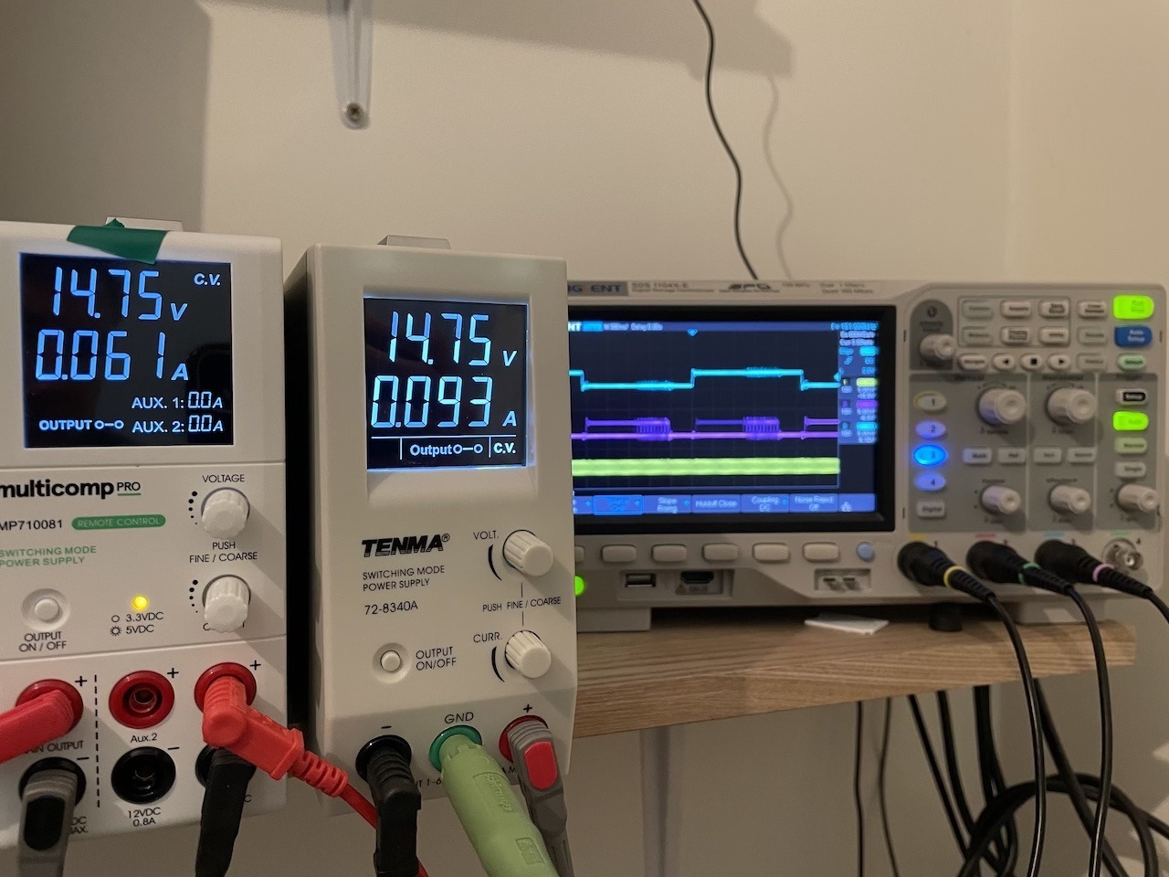

So this is without the 15mF caps on the SMPS power supply - but this is running on my clock and isolator (the wiring needs cleaning up too and a few other things as the 3.3V is using the SMPS too at this stage). That's cleaner than the original SDG without the caps etc.
I need to verify that the clocking is equal too but it looked good from the scope.
Hehe putting the 15mF caps across the input for the regulators (between the SMPS and the regulator) has resulted in this lovely display:
That's a considerable reduction in LF noise which is good.
So I'm not running the 15mF caps on this first run but it's the first run of my clock PCB and isolator PCB hooked up to the 3.3V on the SMPS supply instead of the 3080 with a second dropping that from 5.0 to 3.3V. Not bad for its first run with a patchwork of wires, sat next to the mains cables (literally next to the plug blocks). It seems less noise peaks are present looking between the two images.

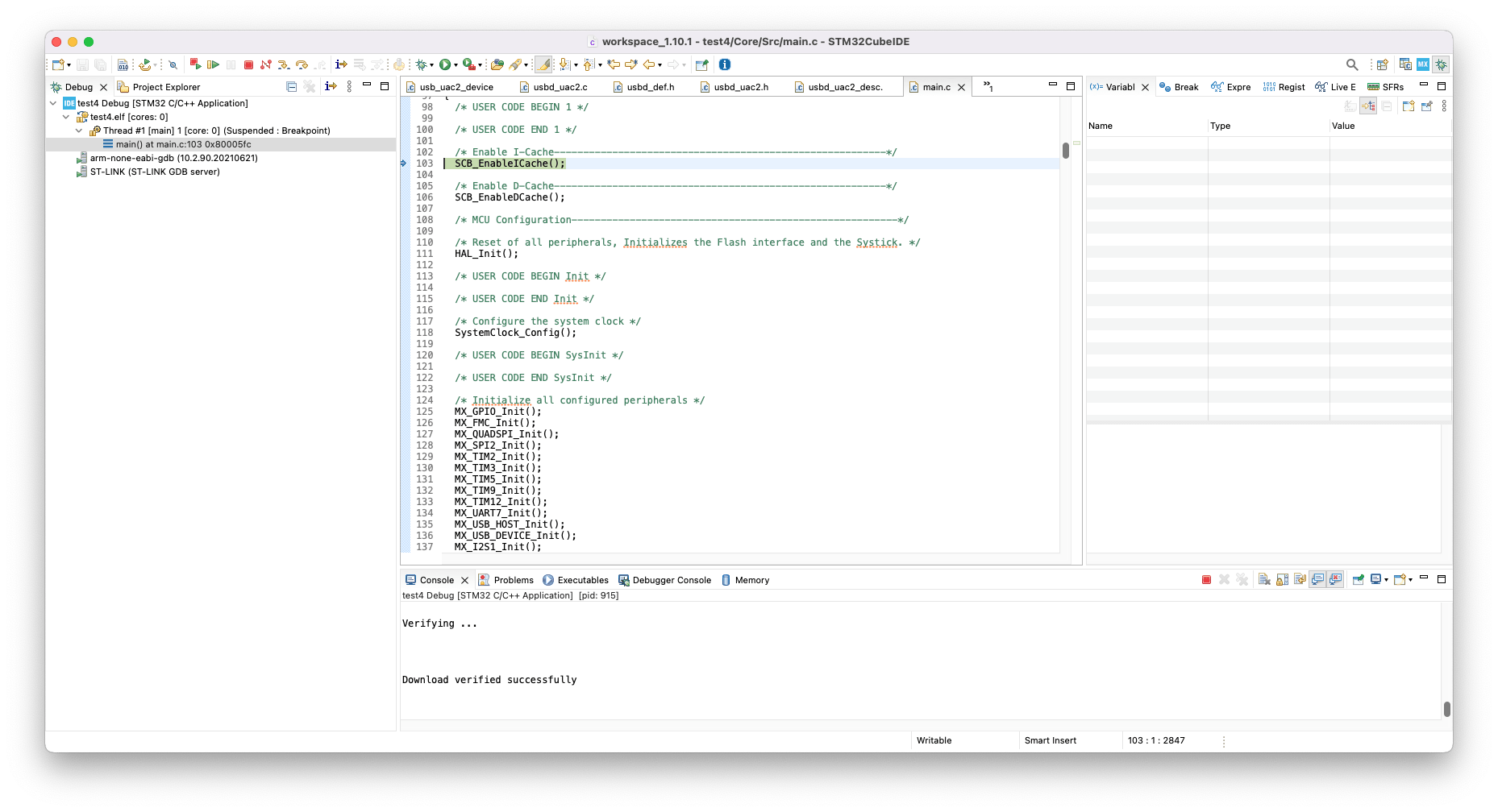

The next steps for me are to add the bits and bobs I need to finish off the power supply, neaten and mount the internal boards etc in more secure way and then finally it can be a standalone unit. After that it's adding the i2c configuration and reset into the STM code and that's it basically done.
