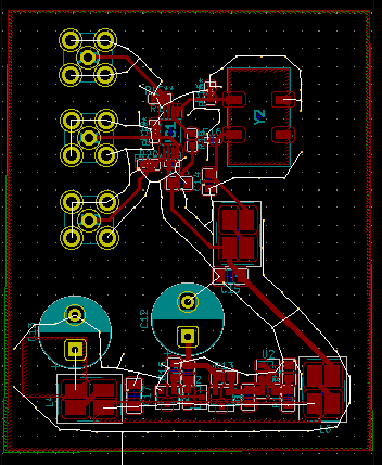

So I'm happier with the above - I've tried to give the power wide low impedance tracks area to run through, the majority of the back is a ground referenced plane. The only specials are the SET pins of the 3080 that need have a guard ring, and, in this case I use both a guard pour around but also a out referenced pour to provide a reference plane instead of the ground.
Looking at at the board above from an RF noise perspective, I think the majority of the low impedance return current will through the ground plane under the wide tracks. The DC and LF return will be point to point. The optimisation is more around RF than DC given the pull through the board will be a direct result from the clock pulses. However given the previous points about the average of the clock is DC (ie the clock is AC and so cancels out on average), I'm not sure if I should be optimising for DC return current.

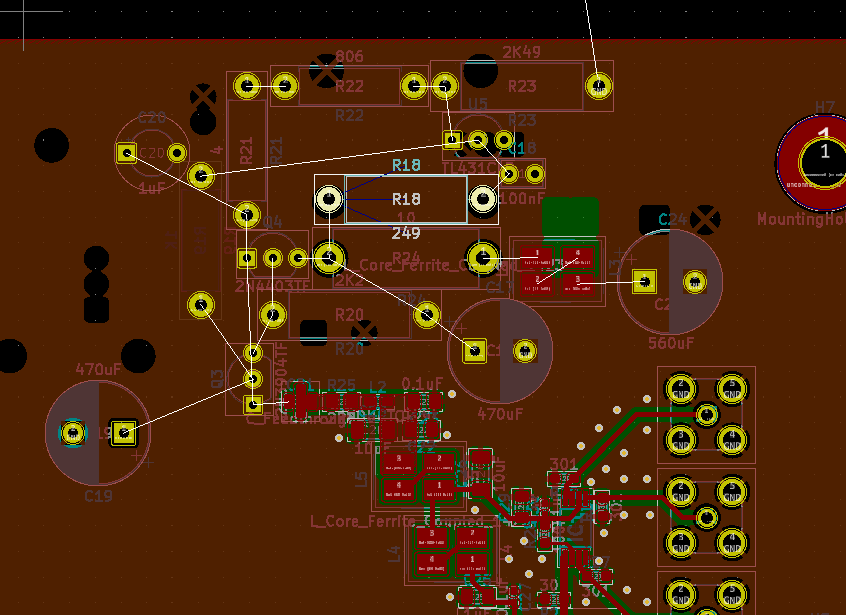

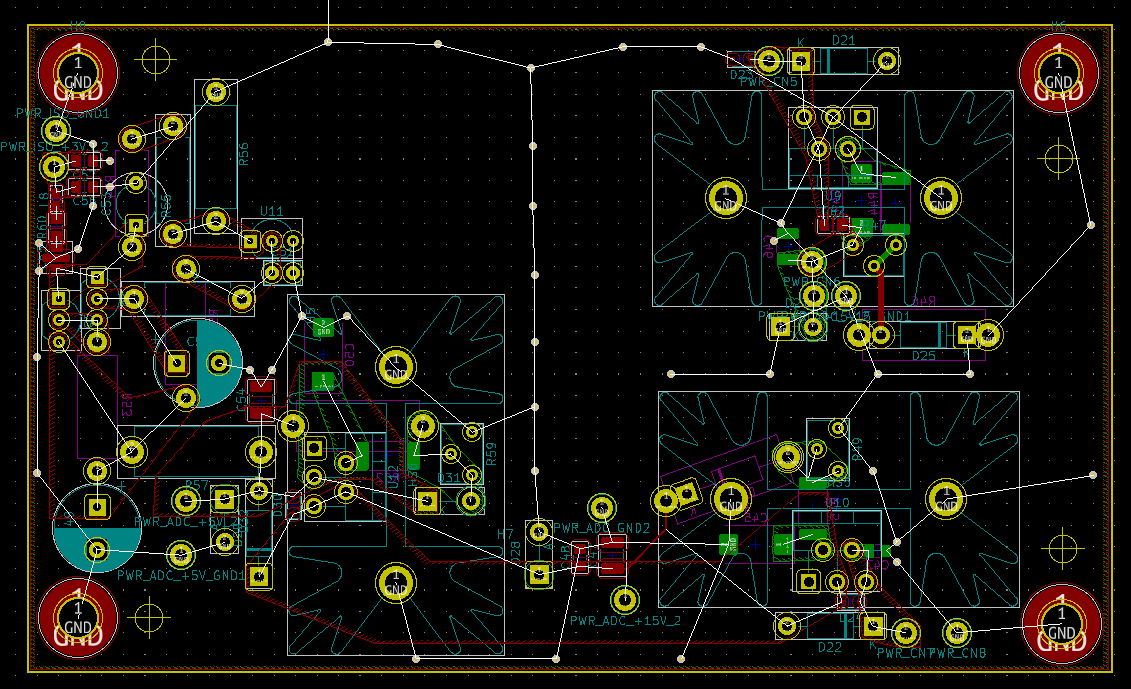

As I'm redoing the PCBs, it's occurring to me I'm making some rookie mistakes around grounding - specifically the analogue (±15V) vs digital (5V,3V) and also some other areas. I've been reading some these: https://www.powerelectronicsnews.co...t-2-power-supply-design-tutorial-section-3-2/
Currently I'm trying to minimise the loops - DC as well as RF. Power comes in on C24. Not finished yet - but I'm trying to place the shunt loops as small as possible (using THT) and provide a fast path of RF return. I'll also add some additional SMT pads for termination etc.

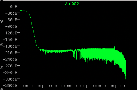

Spotted some errors in my pin connections (due to using footprints and different symbols between Kicad and ltspice). Fixed those and ran a ltspice simulation of the shunt to see if my thinking about where the main currents will be and the where the DC and RF will route.
With a 24MHz switch on the load and a 120mVpp ripple on the power source, there's absolutely no switching noise reaching the power source in the simulation. However ripple, it's not resolving the 120mV, so a LDO ahead of it will be required to remove that. This is what the power supply sees with only a few 50Hz cycles:

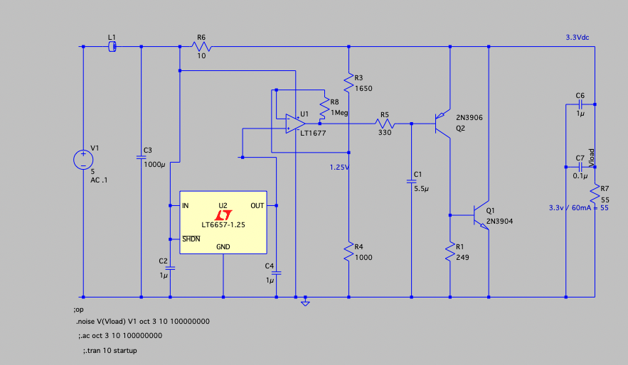

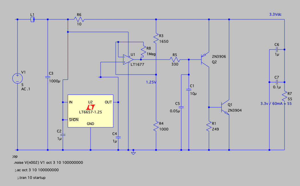

So I'm getting 4V IRL out rather than 3.3 but that not a problem. I'm also reverse engineering this so I can modify to suit the purpose - I see the TL431 is used as a comparator, then we have a the NPN controlling the PNP for current control. I have an LTspice sim providing 60mA and 3.3V at the load with adjusted resistances.

I was confused since its not a shunt regulator. I have a sim of a shunt version I'll post later.
It’a simple enough to create a current shunt following this and use the LT431 to control an NPN, although there’s a tnt audio thread that compares different shunts and even battery types for noise.

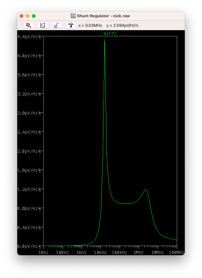

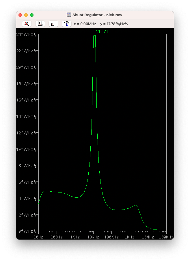

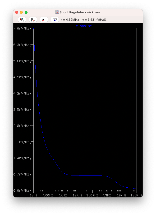

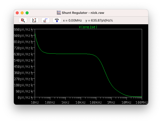

The TL431 has little impact on the noise in the circuit above .01 Hz. The trick is to operate the NPN at its optimum for noise and the PNP handles the necessary current gain. I had to build a special test ficture with a geoformer to measure the noise. It was in the range of a 5 ohm resistor I seem to remember. Really low. The RC at the base of the NPN sets the reference noise. You do have a long turn on time. For reference attached is a shunt variation. The problem with it would be the slow turn on will mean overvoltage at turnon.

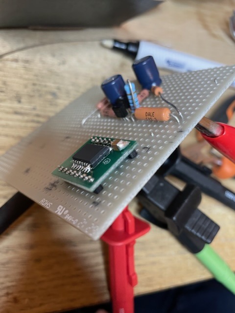

I’m using the digital isolators as a testbed - they don’t care if it’s 5V.
Good point about the turn on overvoltage - this first one is feed a digital isolator which is happy with 3.3 and up to 5.5V but it will not operate correctly with the logic input being 3.3V (input only so no over volt output). The other side is powered by the stm 3.3V so there’s no issue. I dont thing it matters if it’s shunt or series for that.
The second digital isolator does have output to the adc, but that could be handled by a relay delay (waiting for the voltage to drop, detecting below 3.6V and then enabling) as the data transfer rate will be alot slower.

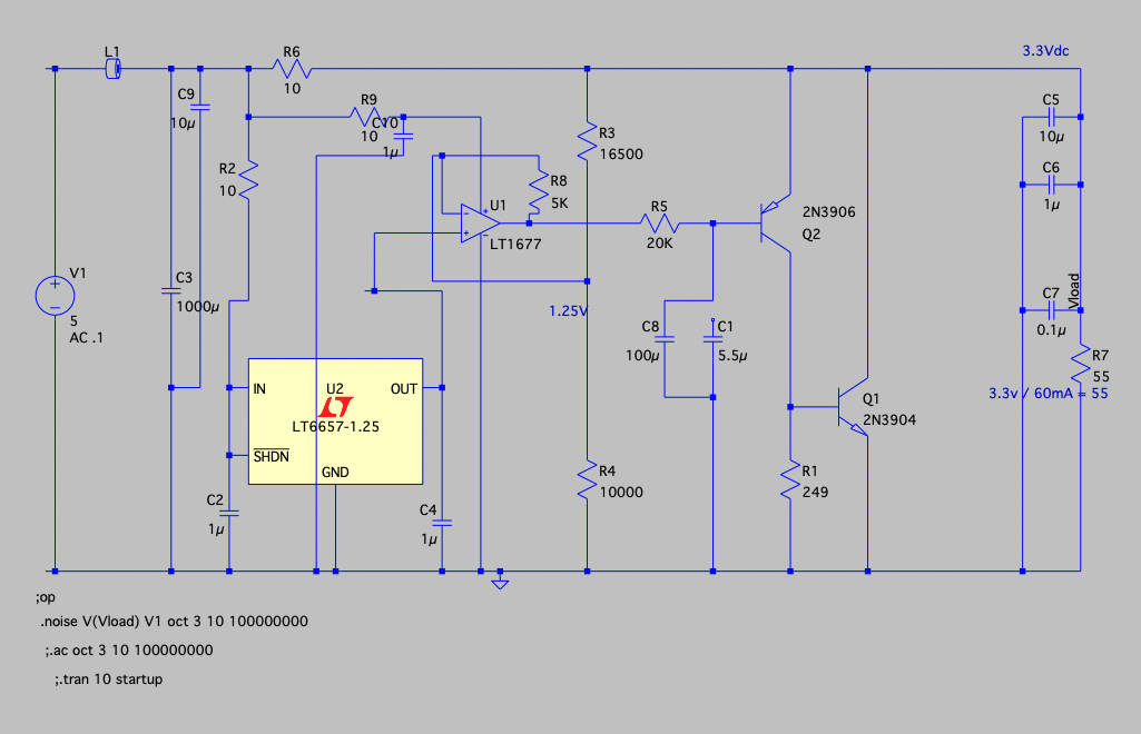

May separate completly the opamp & reference power as a separated 20V path.Also updating R5 to 10K again reduces the noise from the PNP.
Finally, add some cap switching as a load on the output, as equal on SDM ADC/DAC references (AKM) and show the switching impulse result(s) 😀
