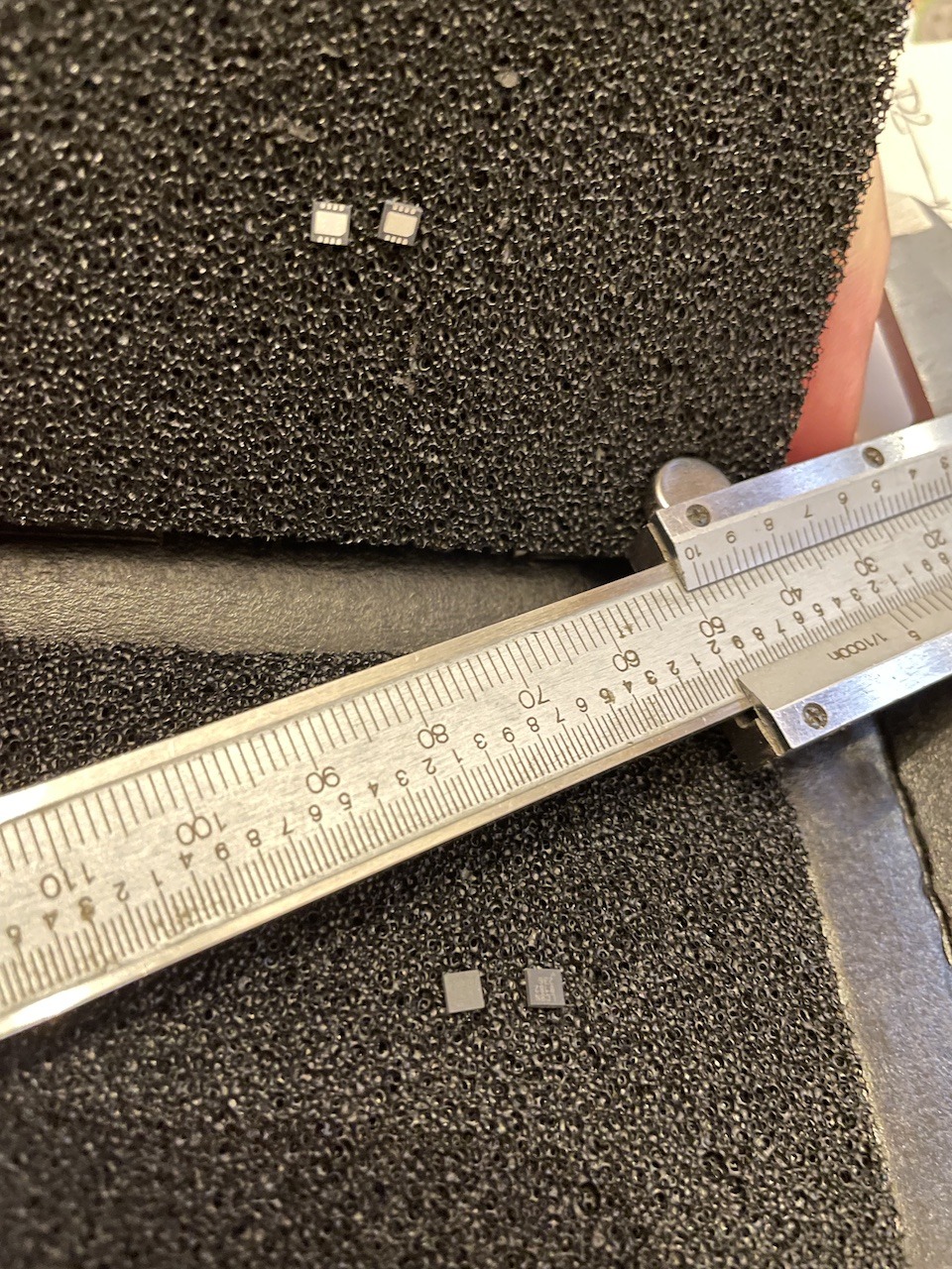

The LT3080DD are micro small and with the copper PCB with some fine solder based vias to copper on the underside to distribute heat. I reckon that the 1oz copper PCB may get up to 2W of dissipation so the input to output voltage difference will need to be quite small (ie around 1-2V max). If I switched top aluminium clad PCBs that could get to 5W. So for the 15V supply, the input may be 16V max with these packages - I'll add a couple of voltage protection diodes on the front end for this (may be over engineering) and I also want to add some pad spaces for ferrite beads and caps for optional pi filters on the power lines.

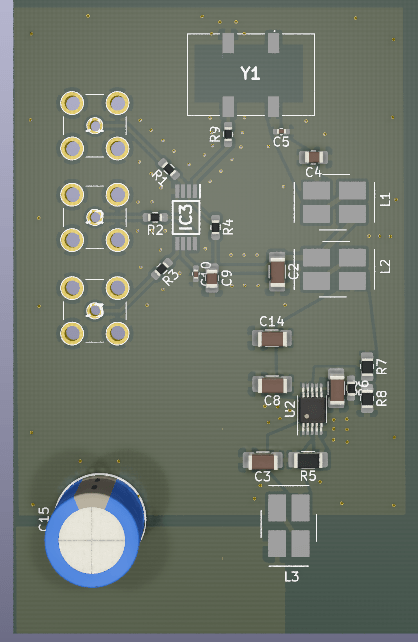

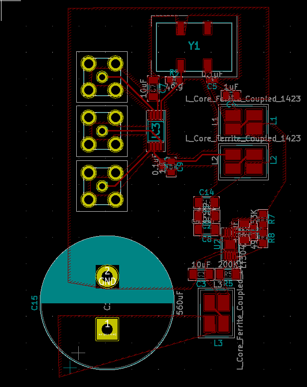

Mark2 board. Not finished by a mile but I'm feeling happier with the basic layout where I'm trying to minimise the return current loops.
The idea is to use a big centre ground in the middle. The voltage will come from pads on with the 560uF so that the ground between the ground and the SMB grounds are close so it doesn't end up flowing across the board.
I still need to model/test the ferrite bead arrays I'm intending to use but the data sheet shows a decent impedance at about 24MHz.

A solid back ground plane will be put in, vias to transfer heat from the regulator as well as along the signal path to to make them coplanar.

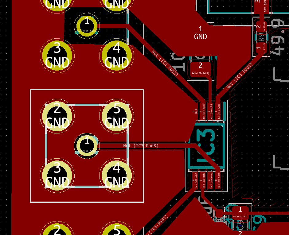

Playing a bit with kicad on the clearances and pours (this is still work in progress)

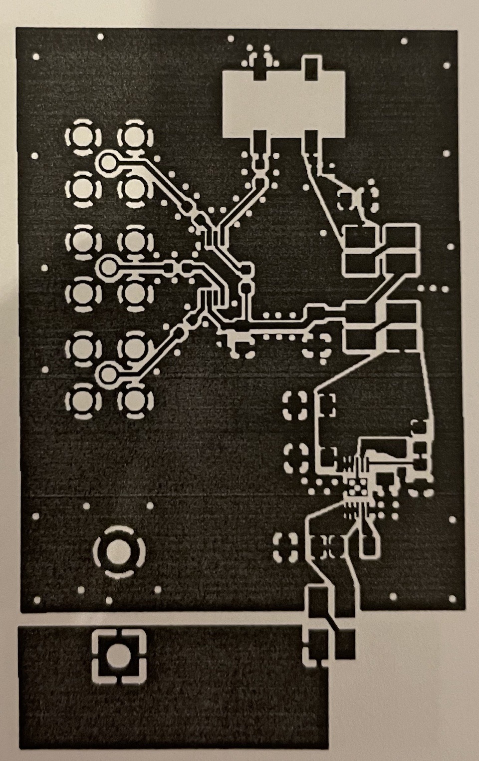

One thing I want to check is if the laser printer will actually print a 6 mil spacing between track and ground plane.

Well the laser printer almost worked with the 6 mil spacing. I've also setup a 0.5mm drill via which also looks too large, although the smallest I can get is an HSS 0.30mm which should work in the Dremel but slow drilling to prevent it from snapping. The vias under 3045 are for heat rather than simple grounding.
So it looks like possibly a 8 mil or 10 mil may be the limit of the printer (my toner is low but I have a new cartridge).

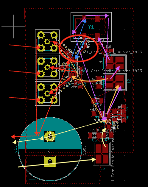

I've also mapped out the most "likely" low impedance routes across the solid backplane for the signal (and power) return currents. My concern is the circled area given the pink return. If I rotate the oscillator 90 degrees clockwise and move the components down that reduces the current return loop size due to the hole required under the oscillator (assume that is required in the same way that crystals require a low capacitance).
If I move the components of the power and ferrite first providing the filtering for the orange path, then it would reduce the current loop.
There's not much I can do with the red current loop - that's either coming back with the BNC shield or possibly the ground power cable depending on the impedance. That will then have to come through to the ground pin on the clock buffer.
What I'm trying todo is minimise the currents flowing across the signal paths and keep the power supply and return as close together as possible.
The HP laser printer seems to not like having some shapes close to the edges (centre of the SMB for example) and the registration seems not to follow the design - for example the signal path is closer to the pour on one side and not the other but in the design they're the same distance.

Ok, I think we're almost there for V1 of the PCB (some vias have been repositioned already). I also made the footprint of the cap the right size.
