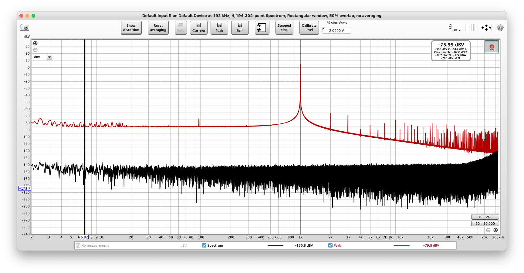

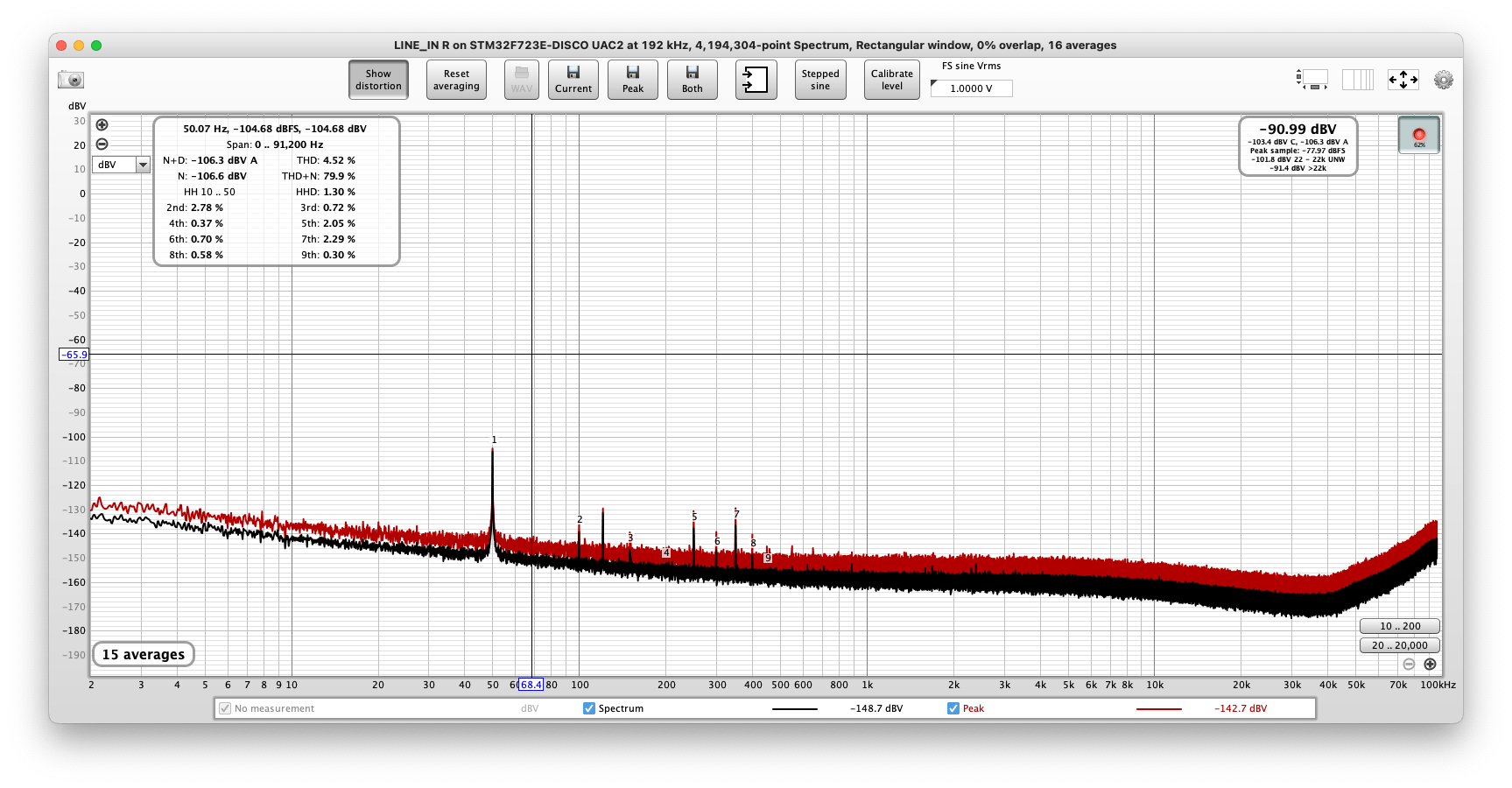

I'm starting to see the need for some additional power filtering:

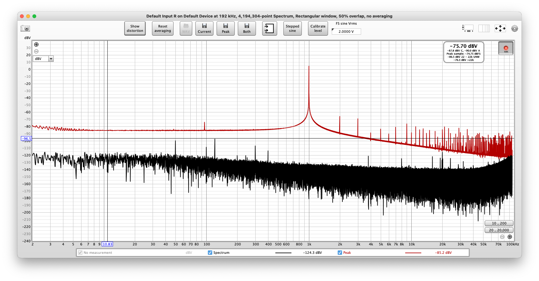

Also with a 10uF film cap (the device is to be AC only), the input seems to show quite a bit of noise from the signal generator, including a larger noise floor caused by the digital generation of the sine wave.
So I think the next steps are really to target the power supply/ground noise.

IMO the steadily rising noise floor towards LF is more of an issue. What are you using as DAC in your measurements?
Regarding mains related noise some of that may be "environmental". Try moving the devices to another location in the room. LT3042 may not help against radiated noise.
Your ADC has quite adequate power supply already. LT3042 has lower LF noise than ADP7118 but PSRR is similar.
STM32 should work fine with USB power. I've never had to use anything else.
I'm currently using an SDG1032X to provide the 24.576MHz clock signal currently, I suspect that some of the noise is from that (my thinking that the noise affecting the clock and thus some of the LF ADC noise).
The ADC needs a power supply (currently it's using both my cheap bench SMPS so I'd like to get them back!). The ADC and the STM both sit within a hammond instrumentation case (solid metal) although the top needs secure grounding.

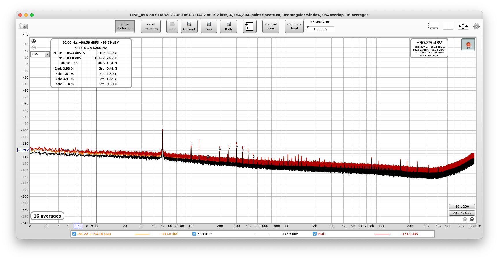

I just did a disconnected input (only connected for the master clock):
I don't think that's all 1/f noise either as it's too shallow. My gut feeling is that the SDG as a master clock is injecting phase noise so replacing that should help reduce noise. Same with better case grounding etc.
It may even be input noise playing with the antialiasing filter in the ADC. I'll investigate over this week. It could be the SMPS noise coming into the OPAs that's then causing 1/f noise increase but it seems very shallow compared to any of the images I've seen of that.
SDG1032X may well be the cause of rising noise floor towards LF.

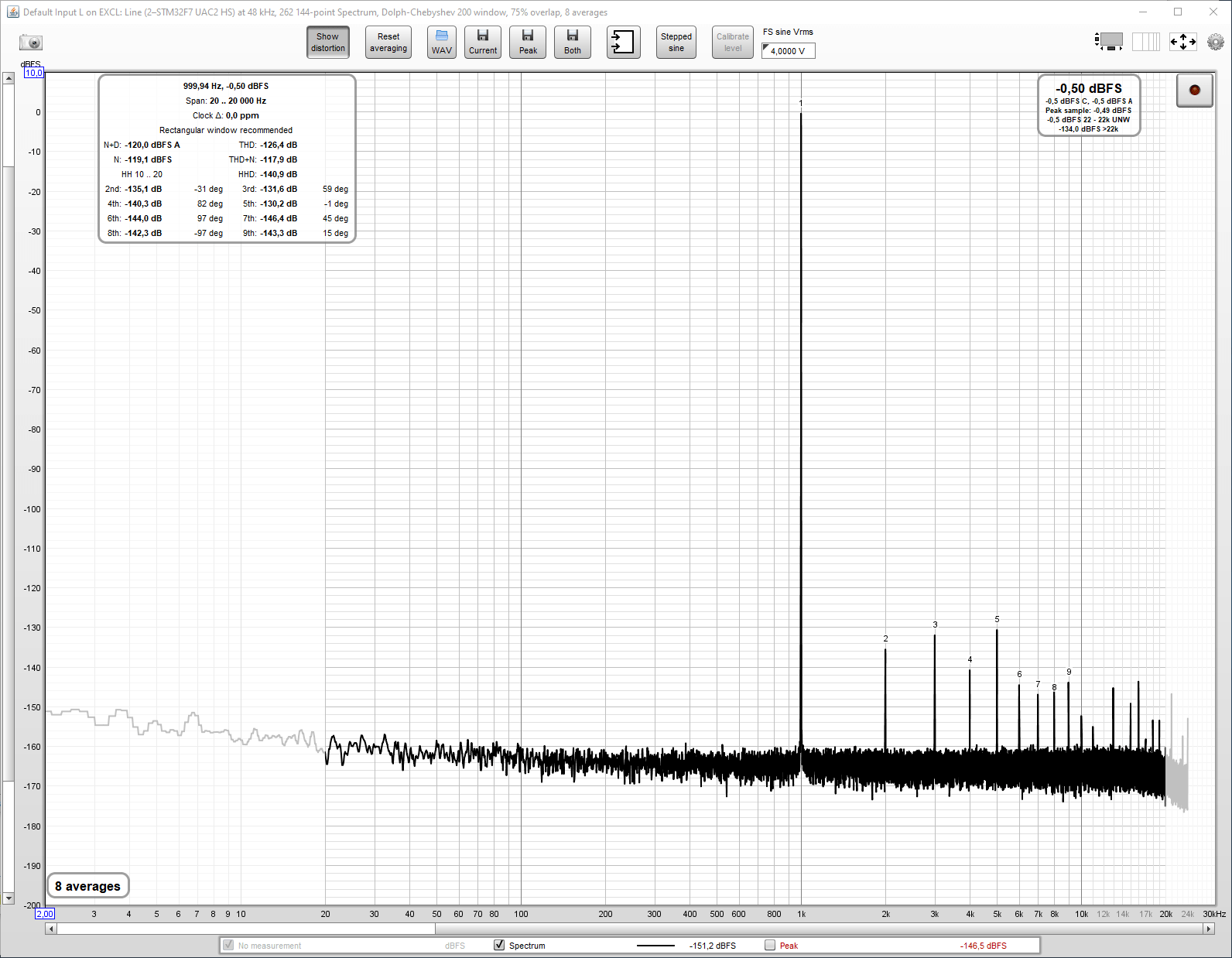

Just as a comparison here is a loopback measurement of my DAC/ADC/STM32F7 combo. DAC (AK4493) & ADC (ES9822PRO) mains powered, STM32 USB powered. All boards naked in front of my LCD screen.

Are you running a dual-mono ADC configuration?
I think the 8922 probably has the edge on the 5572 but it will be interesting to see once it's some of these issues are resolved.

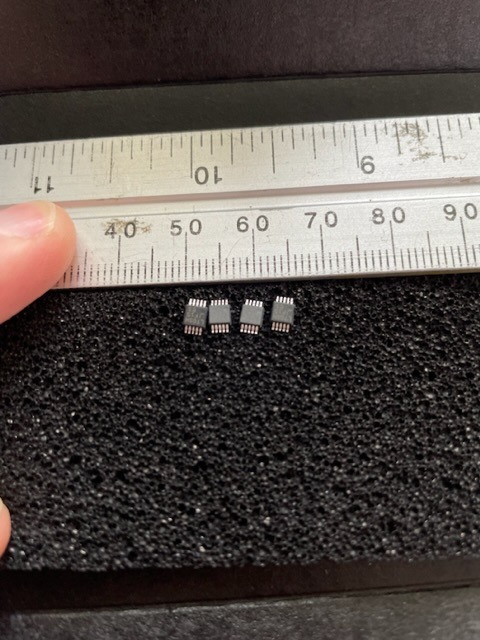

So I've designed myself a master clock with a fanout for driving up to 3 50ohm devices and I've ordered those plus some additional voltage regulators (ouch!). 99% of the components are SMT. These should be with me next week. So let the fun begin!

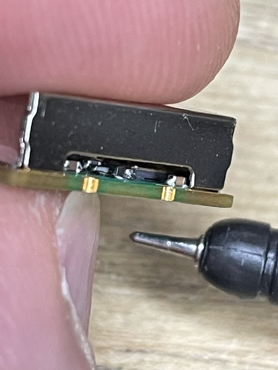

Hm. I think I may have bust my CCHD-957. After checking the supply (3.3 ±0.3V) and pin outs I thought it would be safe to have a quick test ahead of the weekend session to attempt to make the circuit board.
I applied 3.30V from the SMPS power supply (I also hooked the Brymen to the probes and it shows it's only ±0.06V) and put a probe on from the scope and the signal appeared 🙂 I compared against the SDG1032X. The important point here is that the scope can't really test this level of phase noise but it can show noise on the waveform. It appears the CCHD has less noise than the SDG1032X.
However now it seems to only output a floating DC voltage. I tried shorting over to E/D pin to trigger output but nothing it simply sits high.
Incidentally the inside (looking through the gaps) seems to have a ceramic crystal compared to the old 957 that appeared to have a separate crystal enclosed in it's own metal can.
The only thing I can think of is that it needs some current limiting.. which seems daft to some noise caused a transient. I assume that it's an amp inside the oscillator that decided to die hence providing a semi short. There's no power draw on the meter and connecting the E/D pin to Vcc doesn't seem to enable output.

It does have an enable pin - disabling results in DC of about 0V and enabling results in just a DC offset of 2.37V on a 3.3V supply but no oscillation (using the scope). I really think it's an ex-oscilator unfortunately.
