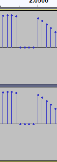

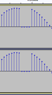

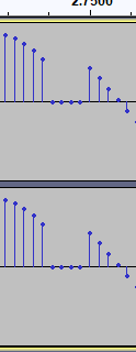

Just tested the win10 driver with a simple wasapi exclusive capture written in rust, stored to wav, checked in audacity spectrogramAs I understand it the maximum packet size variation of +/- one audio slot means that e.g. for 48k the nominal is 6, min is 5 and max is 7. For 88k2 the nominal is 11.025 so min is 11 and max is 12.
44.1kHz, bInterval=4 i.e. 1ms frame.
USB Packets captured in wireshark in my linux PC (the win10 running in a virtual machine there), processed with tshark:
Code:
tshark -r a.pcapng -Y 'usb.src == "1.14.3" and usb.transfer_type == 0x00 and usb.endpoint_address == 0x83' -T fields -e usb.iso.iso_len | tr ',' '\n' | sort | uniq -c
async 100% rate - capture in win10 bitperfect
6667 packets of 352 bytes
740 packets of 360 bytes
async 99% rate - bitperfect
3164 344
6113 352
async 98% rate - bitperfect
7284 344
2031 352
async 97% rate - some samples corrupted
1534 336
5342 344
360 bytes = 45 audio frames
352 bytes = 44 audio frames
344 bytes = 43 audio frames
336 bytes = 42 audio frames
I.e. for 44.1kHz the nominal frames are 44 and 45, with 43 accepted, while 42 already causing problems. IMO the allowed minimum is the lower nominal value - 1 which does make sense for a usable async control.
In linux USB-audio driver any number of samples works bitperfect, tested down to 75% rate.
I did not test the upper limit as the gadget module async control has a hard-coded upper limit at 100.5% (since that limit determines the max packet size which consumes the overall available USB bandwidth) and I did not want to recompile the kernel module.
I do not think the problems with 42 audio frames (n - 2) were caused by dropped packets, but as if the driver somehow kept track of time and filled in "time-missing" samples with zeros - all the discontinuities were like this, every 100ms which does not correspond to the 42-frame packet occurences:
The behavior of the input stream really seems like the driver or wasapi layer monitors the incoming stream rate and if it falls below some limit from its view point (measured probably against system time or maybe some hardware timer if available), it periodically (seems every 100ms) adds zeros to the stream to make up for the "missing" samples to raise the rate up to the minimum level. The lower the async rate, the longer the sequence of zeros inserted. Probably a reasonable behavior which can avoid potential timing problems in applications which can rightly expect a close-to-nominal-rate data stream. Falling deep below nominal rate is a faulty condition anyway.
To test the hypothesis I set the rate to generate just a few of the n-2 packets:
async 97.5% rate - bitperfect
32 packets @ 336 bytes (n-2)
12640 packets @ 344 bytes (n-1)
The result was a bitperfect capture in win10. That IMO confirms the hypothesis that the driver accepts larger variation of the packet size, but stuffs zeros if the overall rate drops below some minimal level.
