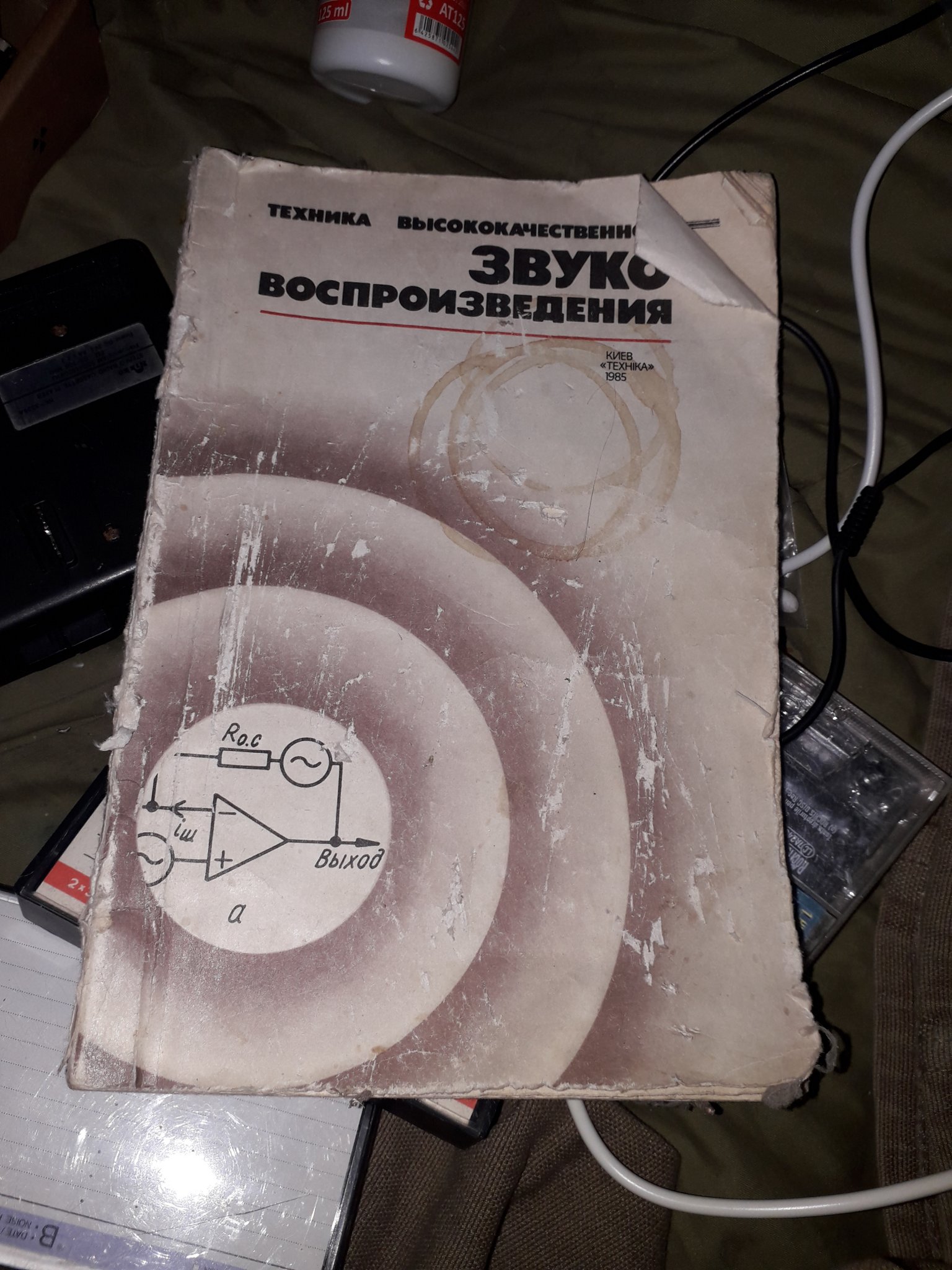

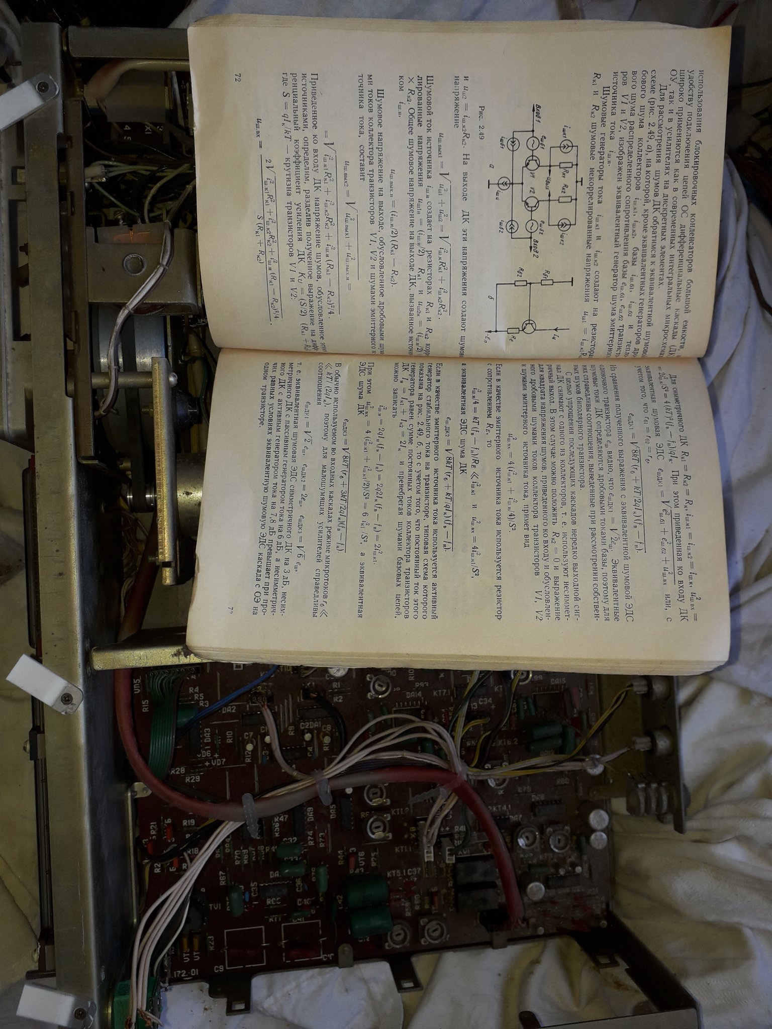

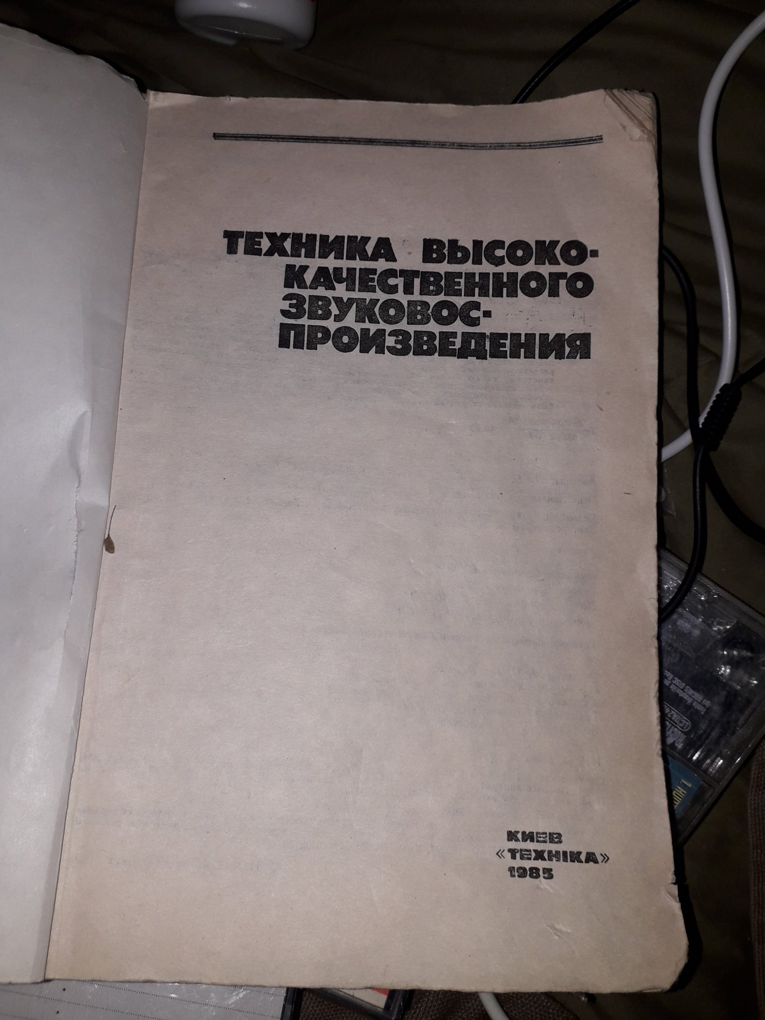

Page 72-73And there is also on page 73: the input-referenced noise of the differential stage with an active uncompensated current source is 4.8 dB higher than that with a compensated by the next differential stage.
Yes, it is. If you have a trouble with translation from russian, I can try to translate these pagesPage 72-73
Given that's your book and you probably have it in electronic format it may be easier for you to make a translation for the whole book as it looks quite interesting.Then you could choose to share it with everybody or sell it .Unfortunately none of my laptops can support installing image recognition for the moment to make a trandlation quick and easy.I'll try doing it on my phone if possible one day.
