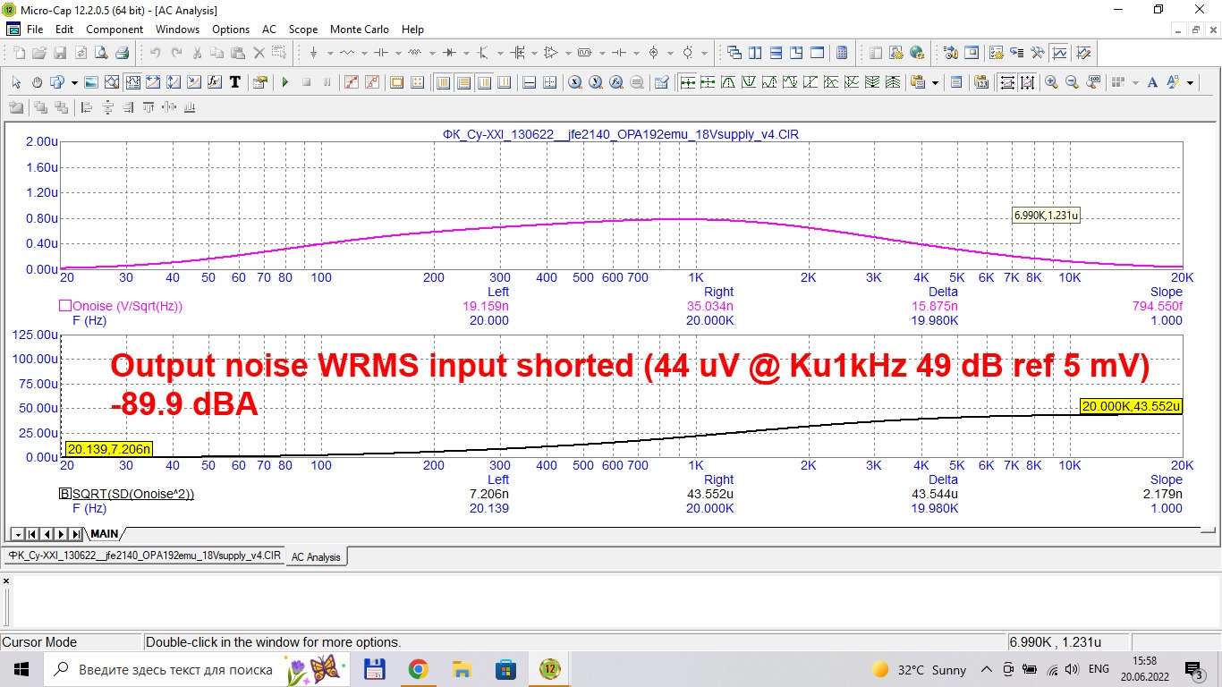

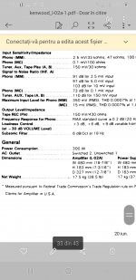

-90 dBA (see attached screenshot). But input shorted noise is absolutely meaningless and inadequate for ММ cartridge with an inductance of 500 mH and a resistivity of 1 kOhm.And what's the noise when the input is shorted?

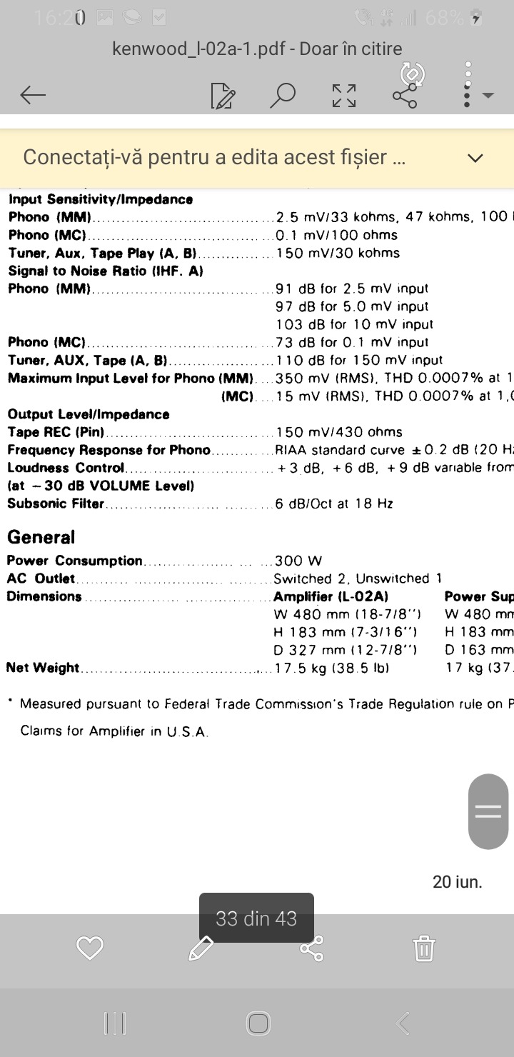

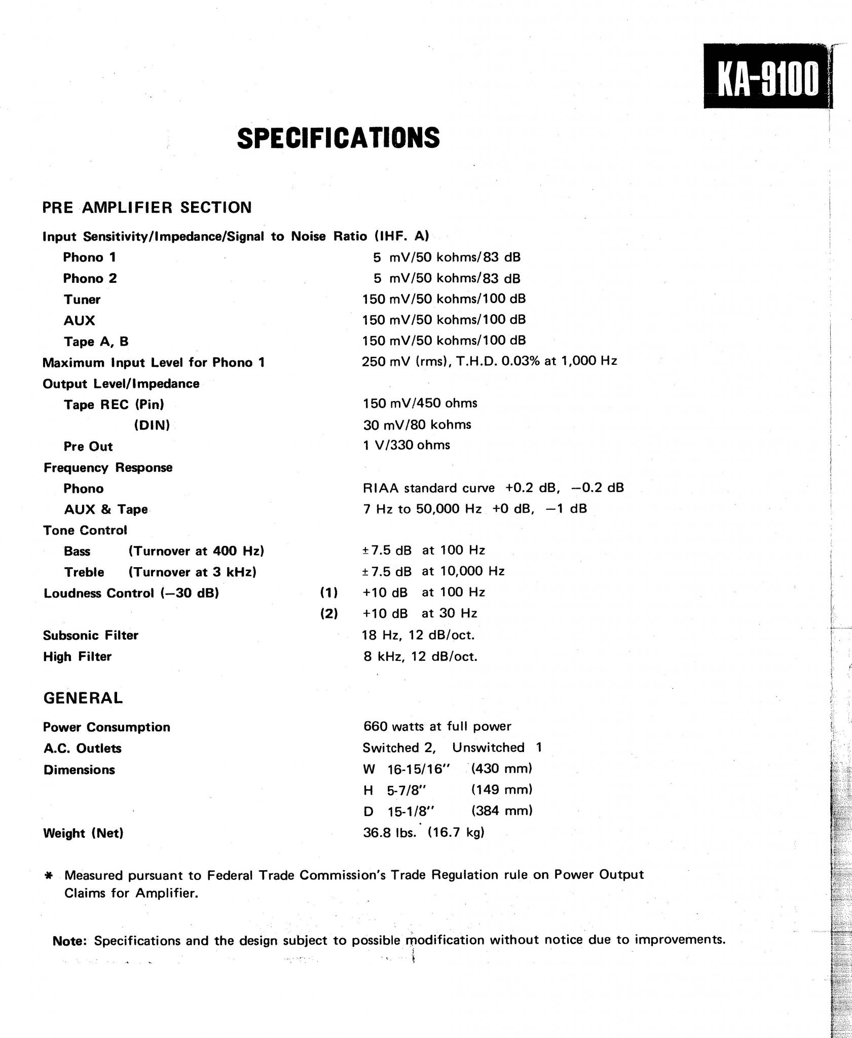

Are you sure L-02 with 3 dozens of transistors per channel and 2SK240 input from 1980s is the same as 6-transistors KA9100 and 2SK68 from 1970s ?Sorry my friend:

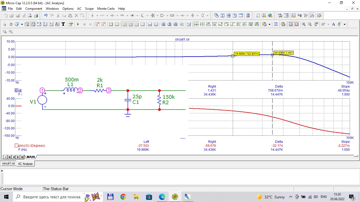

my cartridge loading scheme (I call it Aperiodic) with 150 kohm and 25 pF input is indifferent to cartridge inductance and resistance. You can test my model in Microcap XII circuit simulator [ the circiut file is here https://www.patreon.com/posts/68010671 ] , - the maximum peaking is no more than 1.5 dB @ 35 kHz - see attached screenshotalways interested in looking at how people approach different cartridge loading schemes. Sadly the trouble makers have already started to mark their territory here...

You need to couple the preamp straight at tonearm's terminals to get 25 pF.We just have a big problem with the aforementioned resonance at 14-16khz which is nowhere to be found in cartridges with normal loading.Is that range of resonance caused by the unusual light loading and then corrected by your unusual feedback network so that we can say you changed the usual mm cartridge resonance range then damped with overall results being the higher SNR? I can believe something like that , but then we can't use your preamplifier in a normal setup using cables between the tonearm and the preamplifier as 1m of the best cables cables present well over 50pF of capacitance.my cartridge loading scheme (I call it Aperiodic) with 150 kohm and 25 pF input is indifferent to cartridge inductance and resistance. You can test my model in Microcap XII circuit simulator [ the circiut file is here https://www.patreon.com/posts/68010671 ] , - the maximum peaking is no more than 1.5 dB @ 35 kHz - see attached screenshot

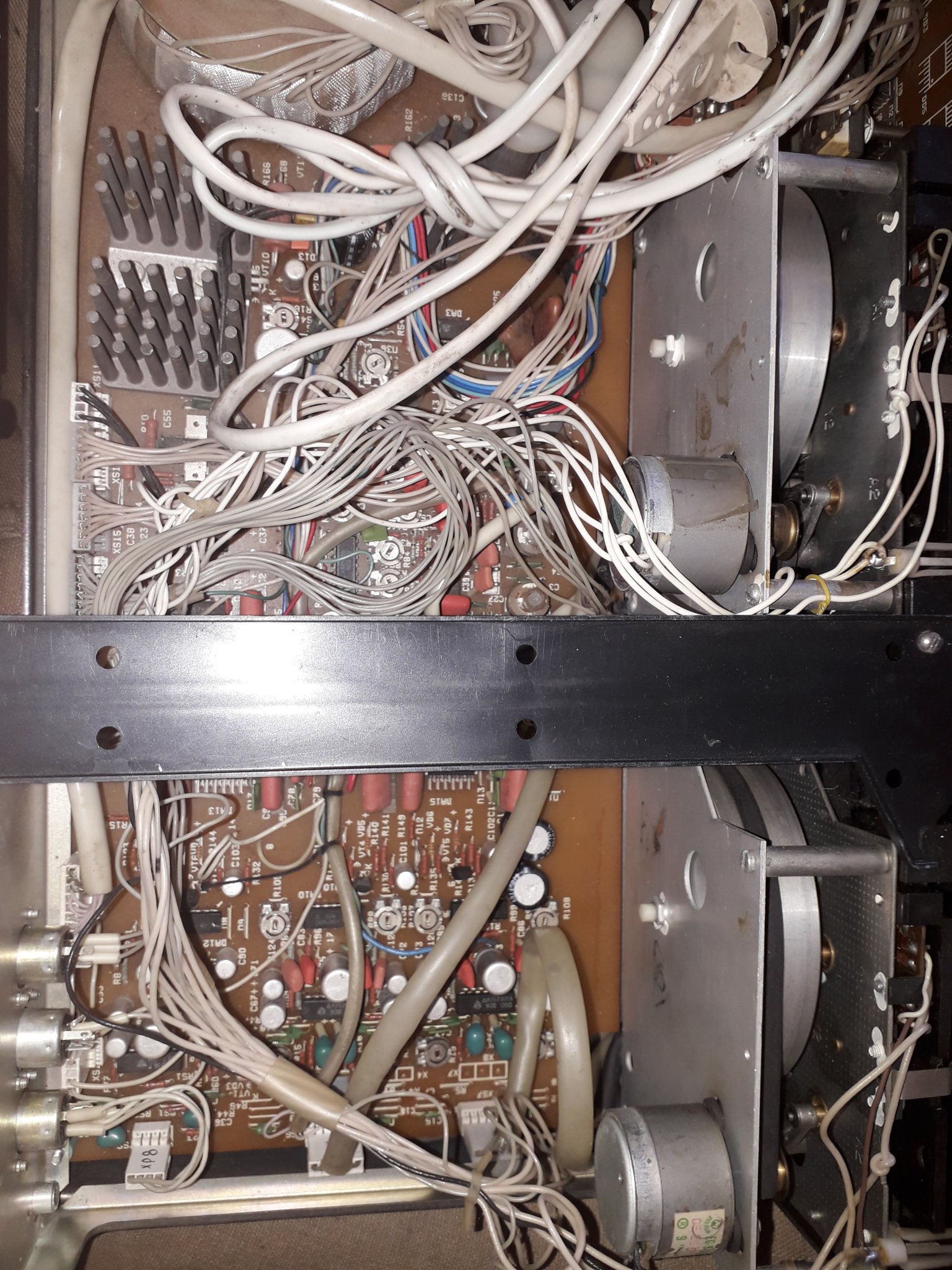

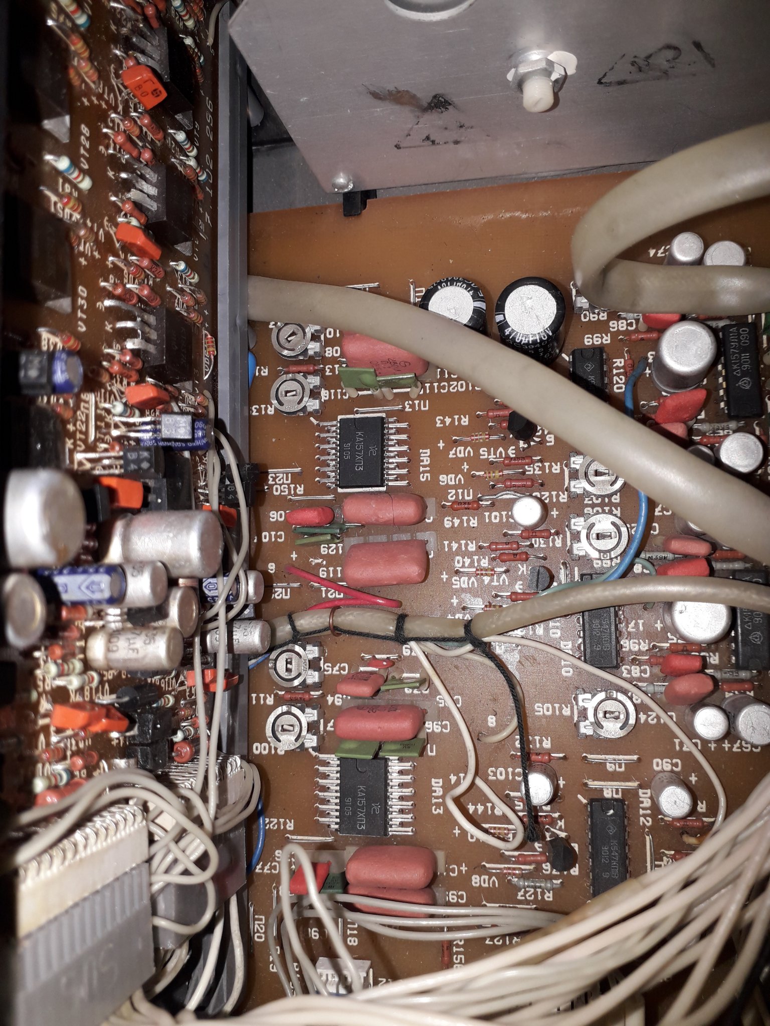

Also found a Karat MP_202C double deck which i was impressed of,(i know there are better decks than this...) but it's defective (probably thr regulator section ...and wjo knows what rlse?) and I couldn't find a schematic for it.Could you help me with that so that i can give it a new life? It has these chips whic look like some sort of dolby processing but no clear ideea: https://kiloom.ru/spravochnik-radiodetalej/microsxema/k157xp3-ka157xp3.html

What model have you used for the cartridge generator? I have found that manufacturer specs are woefully inadequate (and commercial MM designers don't seem to have considered loading properly for about 30 years 🙂 )my cartridge loading scheme (I call it Aperiodic) with 150 kohm and 25 pF input is indifferent to cartridge inductance and resistance. You can test my model in Microcap XII circuit simulator [ the circiut file is here https://www.patreon.com/posts/68010671 ] , - the maximum peaking is no more than 1.5 dB @ 35 kHz - see attached screenshot
Isn't 150k too much? If the load resistor is smaller, the damping of the resonance is better, and the 1/f noise is lower. I would try 10k instead of the usual 47k.
There is no 'damping of the resonance' going on. You are just changing a filter roll off. more R less C is generally IMO the way to go. I use STP from the tonearm to minimise C.
Any MM head has an inductance, isn’t it? Any preamp has an input capacitance, right? They make up a circuit tuned to this resonance frequency of a particular headHow many examples would you like. I've yet to find one WITH that resonance.
