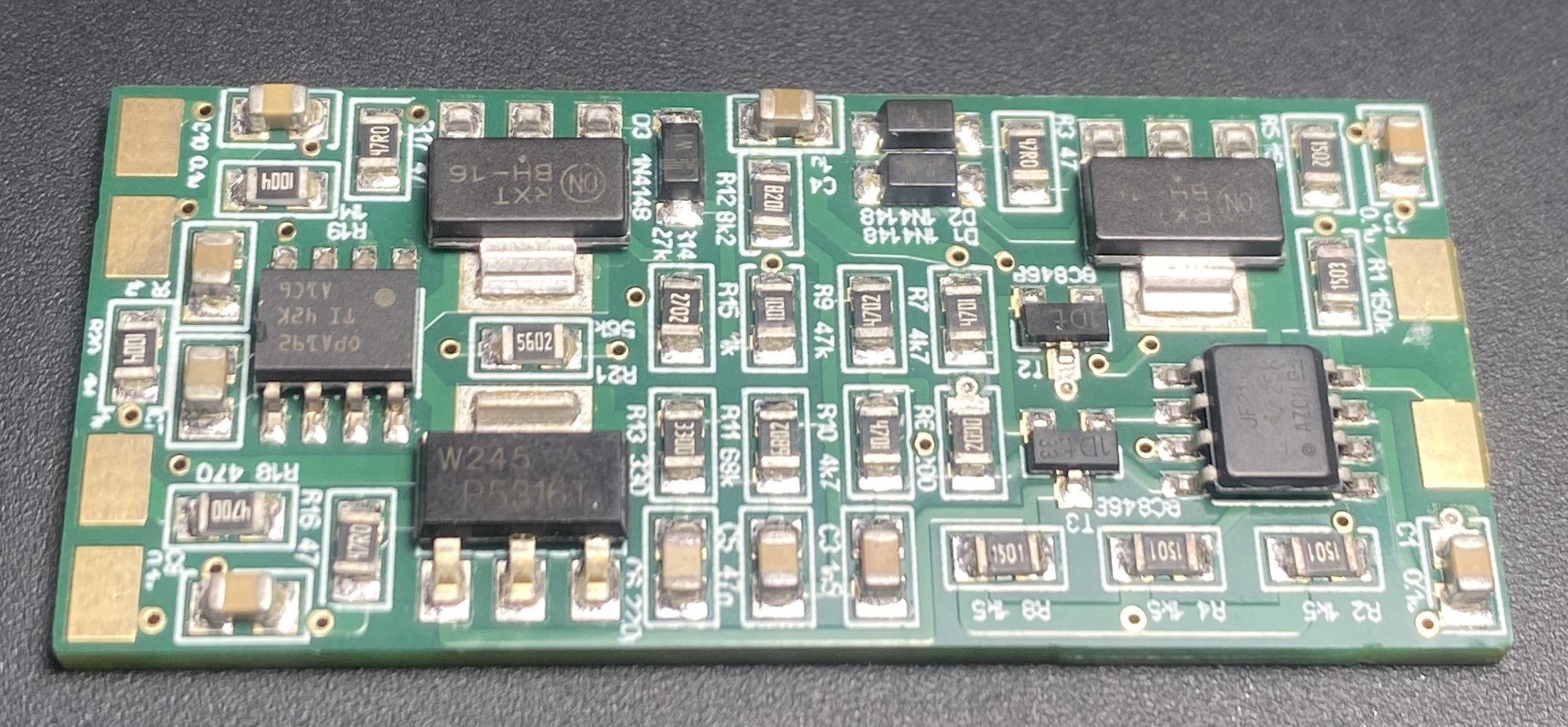

I just wrote as it is, if you find that offensive, you gotta work on your soldering skills rather than take it the hard way 🙂
In my opinion, something that is being sold as a product should be done proper, and last for a while, not something riddled with cold solder joints. The latest picture here is done proper, as it should be.
I'm sure i can distinguish by looks what something is going to fail on me because of a human error. I'm also sure that would not pass any QC as a product suitable for market. I failed to mention sound anywhere, why focus on that which wasn't mentioned, instead of accepting and working on your soldering skill? Ego is a peculiar beast.

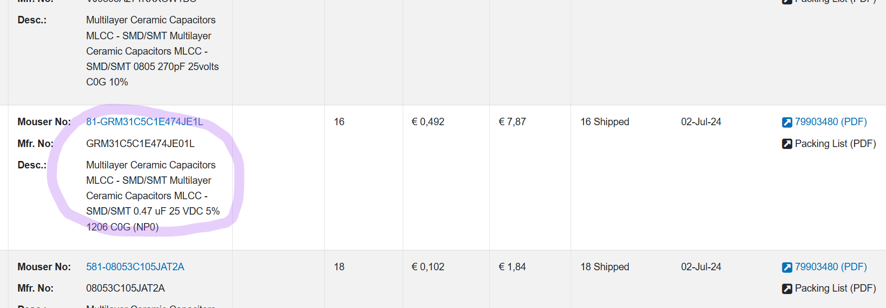

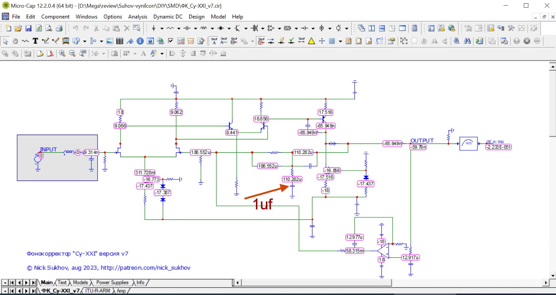

I installed good NPO capacitors and a 1uF film capacitor.
Me too. I couldn't find any NPO capacitors for one microfarad. I put two of 0.47. I must admit that this particular capacitor doesn't decide anything about the sound. Well, the rest of the capacitors I used NPO of course. Even if I remove this capacitor, or shorten this chain, the result will not change in the rest of the frequency range.
This photo shows X7R capacitors.
Absolutely right, these capacitors are in the factory assembly, I wrote about the manual assembly shown earlier, there was a nominal value of 2 x 0.47.
as I wrote before, it is this capacitor in the feedback that does not affect the sound quality, so it was decided to leave it X7
