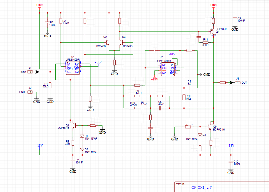

When supplying power from the power supply unit to the phonocorrector, plus minus 15 volts. And if you pick up, say, a speaker at the output, then this voltage disappears. Is it normal?
My circuit has fine DC servo with eTrim opamp OPA192 and guarantees < 5uV DC (not mV but uV ! ) output offset (no need electolytics caps at input, inside or output) both with idle output and with any load up to short circuit. Instead of 500 uV offset of 5532 Pearl 3 output. See here
(video with multilanguage subtitles).

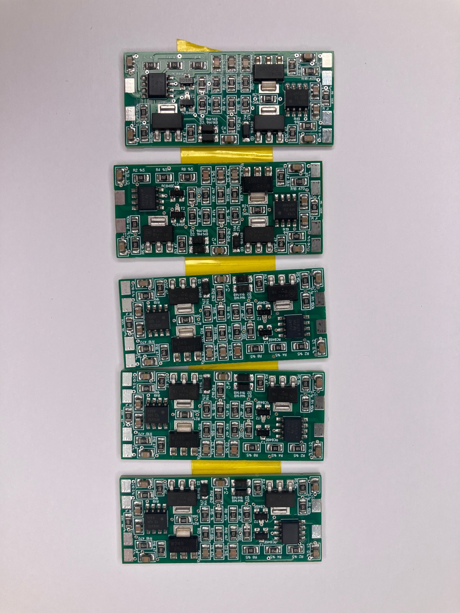

How is your scheme fundamentally different from this ancient Kenwood ka-9100-9150 ?
I don't see such elements as JFE2140 and OPA192 in Kenwood. I also see many electrolytic capacitors in Kenwood.
All circuits have similarities. Because they consist of common elements. These elements are called resistors, transistors, capacitors. It's like music. It also consists of sounds and notes. Only in one case we get a symphony, and in the other case, cacophony.
We cancel all patents - since the presence of transistors is a sign of the same circuit - because “Because they consist of common elements”!
But seriously - the question was about “fundamental” differences, and not about different markings of parts
as for OPA192 - this is the use of Kenwood circuitry (Kenwood - Sigma-Drive Technical Guide) -
https://www.diyaudio.com/community/threads/kenwood-sigma-drive.135517/
https://ru.scribd.com/document/411868140/Kenwood-Sigma-Drive-Technical-Guide
Changing the resistor or capacitor value leads to fundamental changes in the transistor's operation. Even a schoolboy knows this. In one case, the transistor works as an amplifier, in the other, it is excited and works as a generator.
I think it's time for you to calm down. And engage in constructive creativity. Come up with your own scheme and get to work. No need to hype and parasitize on other people's developments.
