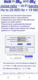

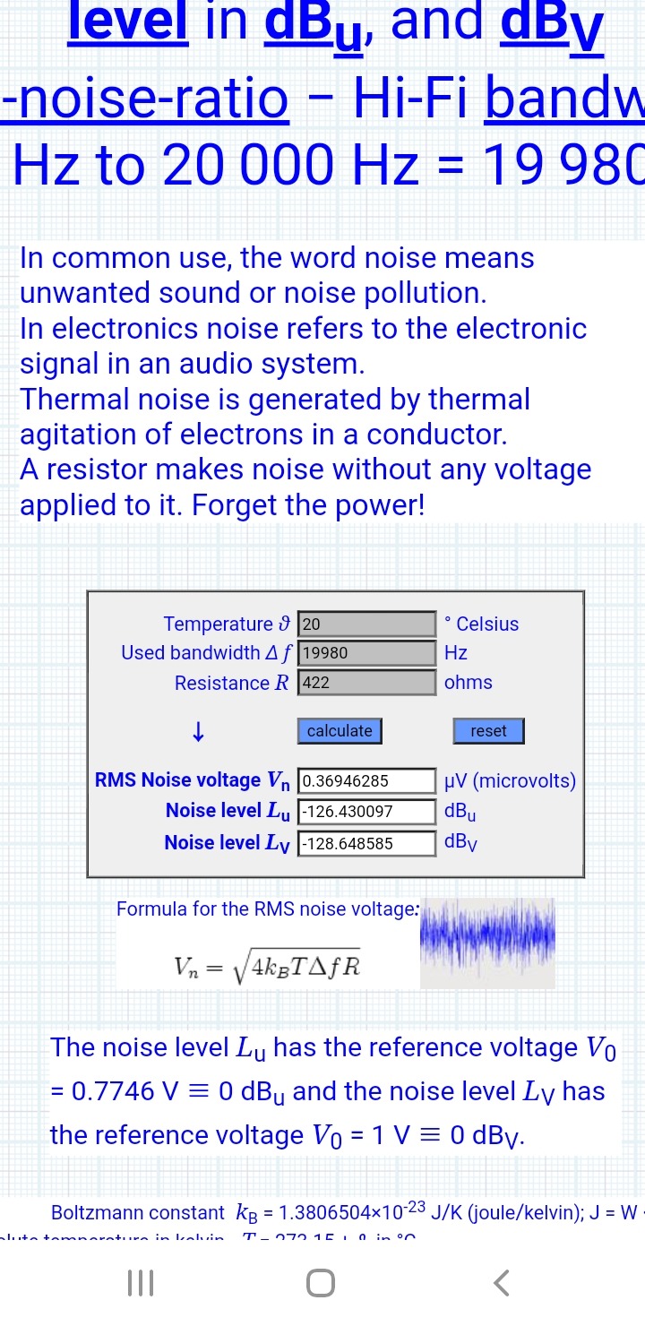

Actually it's not that noisy...but you can use 2sc1845 instead...I think that a Wireless World article need to adress a wider audience and outline the principles of operation. That differential is actually a true differential as in the famous APT Holman just not symmetrical if judged by input impedance . As for the 422 ohms running 6.5 mA through it sounds better than 330 ohms run at 17mA...

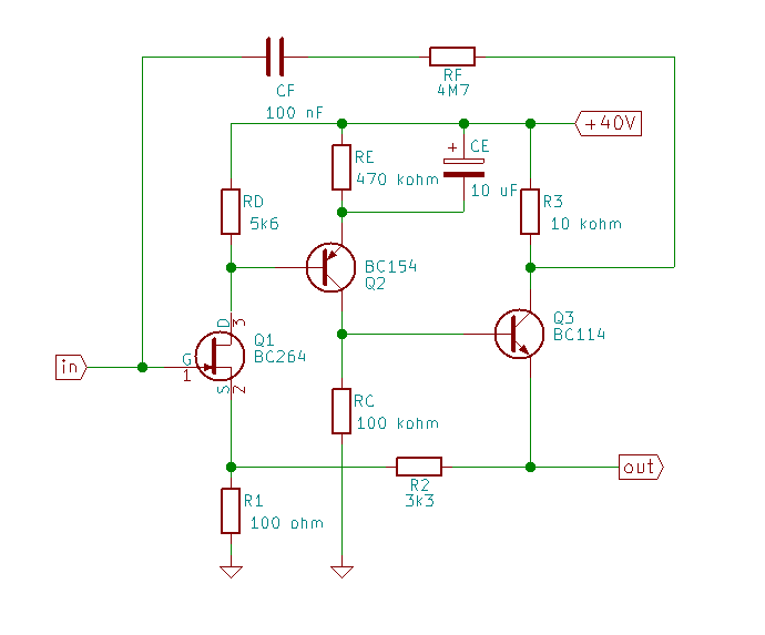

Marcel proposed an original circuit Fig5, but the non-differential signal pickup from the input stage adds noise of the current generator transistor BC550 and the 422 Ohm resistor in its emitter. It is too noisy and his fine idea on active inpur resistance is far from being fully implemented.
There is an error in figure 5, one section of the 30 dB/40 dB switch is drawn in the wrong state.
The noise of the tail current source is effectively in parallel with the channel noise of the JFET. I designed it in the mid 1990's and I don't remember all the details, but I'm sure I must have chosen the tail current degeneration such that the JFET dominates.
In any case, it's good enough for me, but if you or anyone else wants to improve it further, be my guest.
The circuit is just my implementation of the Hoeffelman and Meys configuration from around 1978, so it is not that original. Electronic cooling even dates back to 1939.

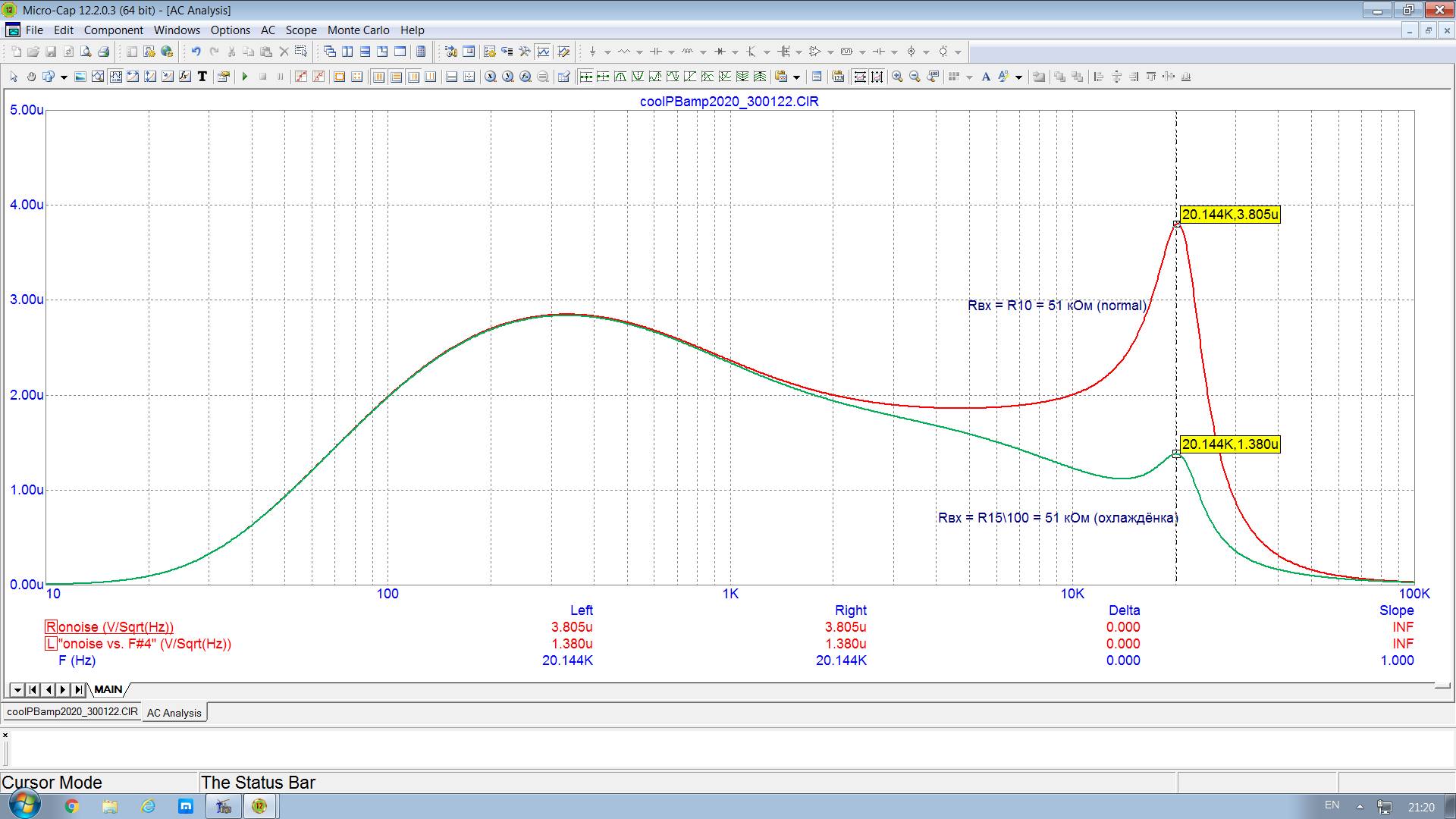

As a radio circuit engineer by education, the principle of cooling has been obvious to me since the time of studying the Theory of Radio Circuits, but it was your work in 2003 that gave impetus to the activation of its use in sound engineering. I also studied the cooling circuitry in detail, and came to the conclusion that it is not very effective for phono preamps due to the fact that the RIAA frequency response has a 20 dB drop at high frequencies, i.e. where the cartridge inductance impedance is at its maximum, input resistor noise current causes the most trouble, and cooling should have the greatest effect. But in reality, this same frequency response drop of 20 dB eliminates the benefit of cooling - the real SNR IEC-Awtd advantage is only 1.5...2 dBA, according to my observations. But as for the use of cooling in the playback amplifier of tape recorders, here the frequency response does not have a decline at high frequencies, but even some rise (compensation for the loss of the playback head gap) after alignment with time constants 120-70-47 µs. Therefore, the advantage of cooling is more significant - see the spectral noise densities of my 1987 playback amplifier [ http://archive.radio.ru/web/1987/06/034/ ] later attached with cooling on the screenshot (with х100 cooling resistor of 5.1 Meg vs standard 51 k). It is output spectral noise densities IEC-A weighted, input with BC560C. PB head equivalent 120 mH + 240 Ohm (Nakamichi S4720).

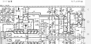

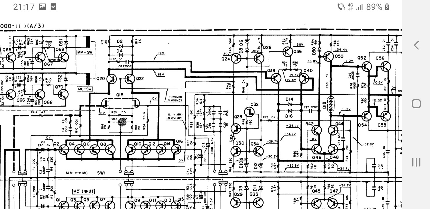

I do not think so. Because in Kenwood L-02 the current generator noise of Q30 Q28 is distributed as equally correlated currents to the input differential stage Q18 Q20 Q22 and then it is perfectly compensated as a common mode signal by the second differential stage Q38 Q40. In Marcel's circuit, the noise current of the current generator is not compensated in this way and is added to the input transistors noise.
The source impedances to each transistor, idle currents and respective transconductances are the ones determining the overall noise, not the resistors or the balanced distribution of currents through the differential stage.
I agree with Nick, the tail current source noise almost completely cancels in his circuit. I don't think it is a big deal, as you can dimension the tail current source such that its noise doesn't dominate anyway.
In my book of 1985 [ freely here: https://www.patreon.com/posts/67628599 ] I have strictly mathematically shown on pages 72 and 73 that the input-referenced noise of the differential stage with an active uncompensated (via next differential stage) current generator is 1.8 dB higher than that with a resistive supply of the differential stage
