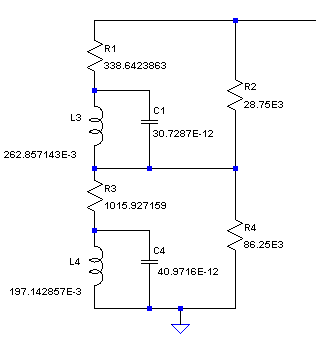

Can you show us your model? This is very interesting, especially from the point of view of the real quality factor at a frequency of 15-20-25 kHz (a decade ago I have measured Q of Shure M44 @ 20 kHz and AFAIR it was less than 0.5)I once tried to model the impedance of a Shure V15-III with frequency-independent resistances, inductances and capacitances and didn't get very far with just one series and just one shunt resistance. Instead I had to split up the inductance and give each part its own parallel resistance
Here it is. Don't ask me about the physical meaning of the components, I've just been tweaking the circuit until it came close to Richard Visée's Shure V15-III impedance measurements.
By the way, you can see in table 2 of my October 2003 article that the shunt conductance G is about 14.5 uS to 12 uS between 10 kHz and 20 kHz, so that's equivalent to a parallel resistance of on average about 75 kohm that represents both the copper and the iron losses between 10 kHz and 20 kHz. It's calculated straight from the magnitude and phase measured by Richard, without the inaccuracies of trying to manually fit it to a lumped model.

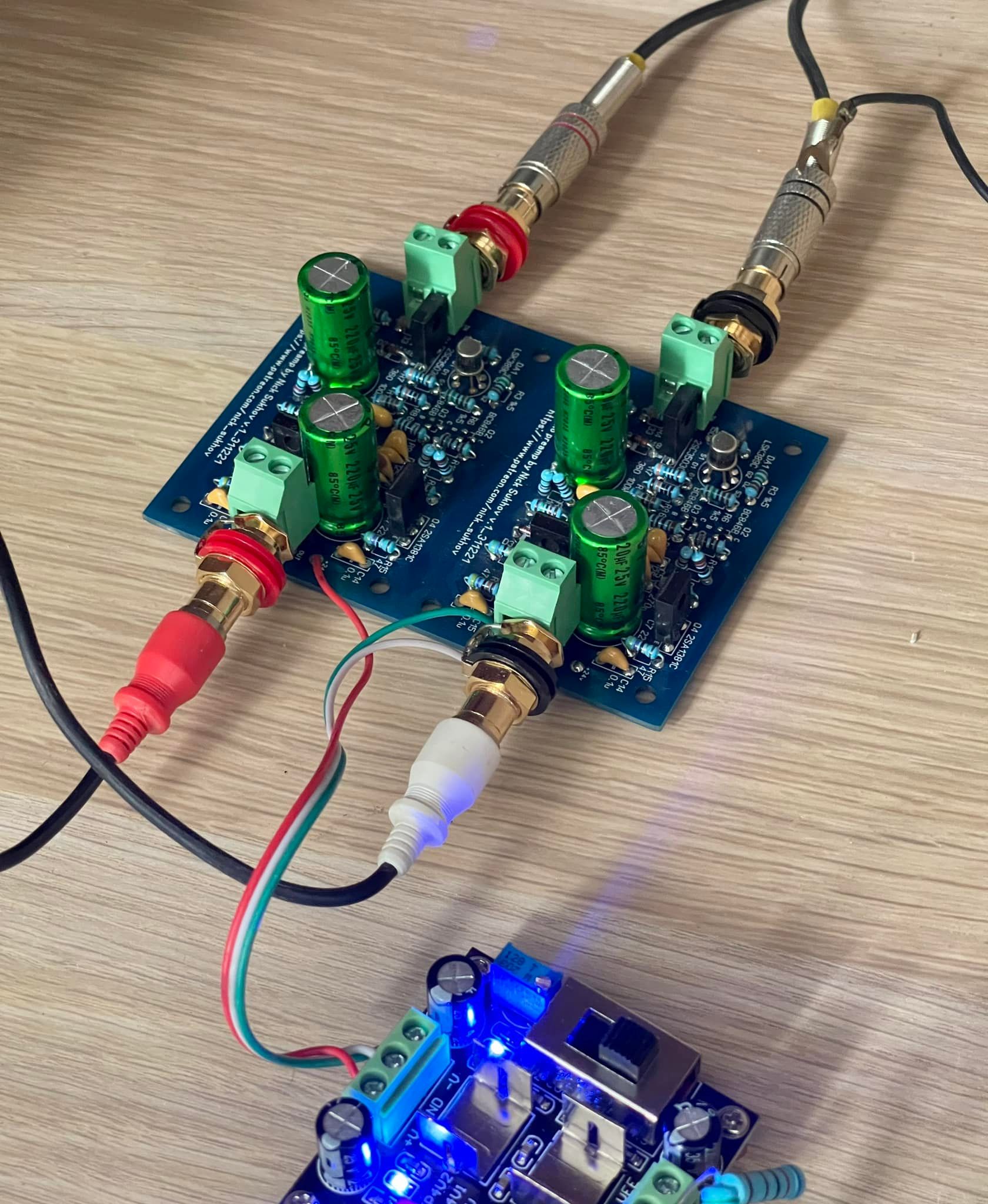

Greetings to all participants! I assembled a test version, please do not kick the connectors and ceramics in the correction - the assembly is a test one. I’m sitting and listening… the tweeters are amazing, even though I’m listening now with the most ordinary Ortofon OM-5 head, I’ve never heard such tweeters from her, although I had the opportunity to listen with various correctors, both industrial and self-made, including tube ones…
In general, it’s amazing to pour epithets about the sound, I don’t know how and I’m not going to, even in this form - the sound is crystal clear and the highs just blow their heads, while there are no problems with the bottom either, everything is plump (unlike those cases when some proofreaders are incredibly detailed, but as a rule, due to the missing bottom, so it's hard to listen to them)
In general, I sit and re-listen to a bunch of material again and, like a child, I rejoice 😉
The design is definitely worthy of attention!

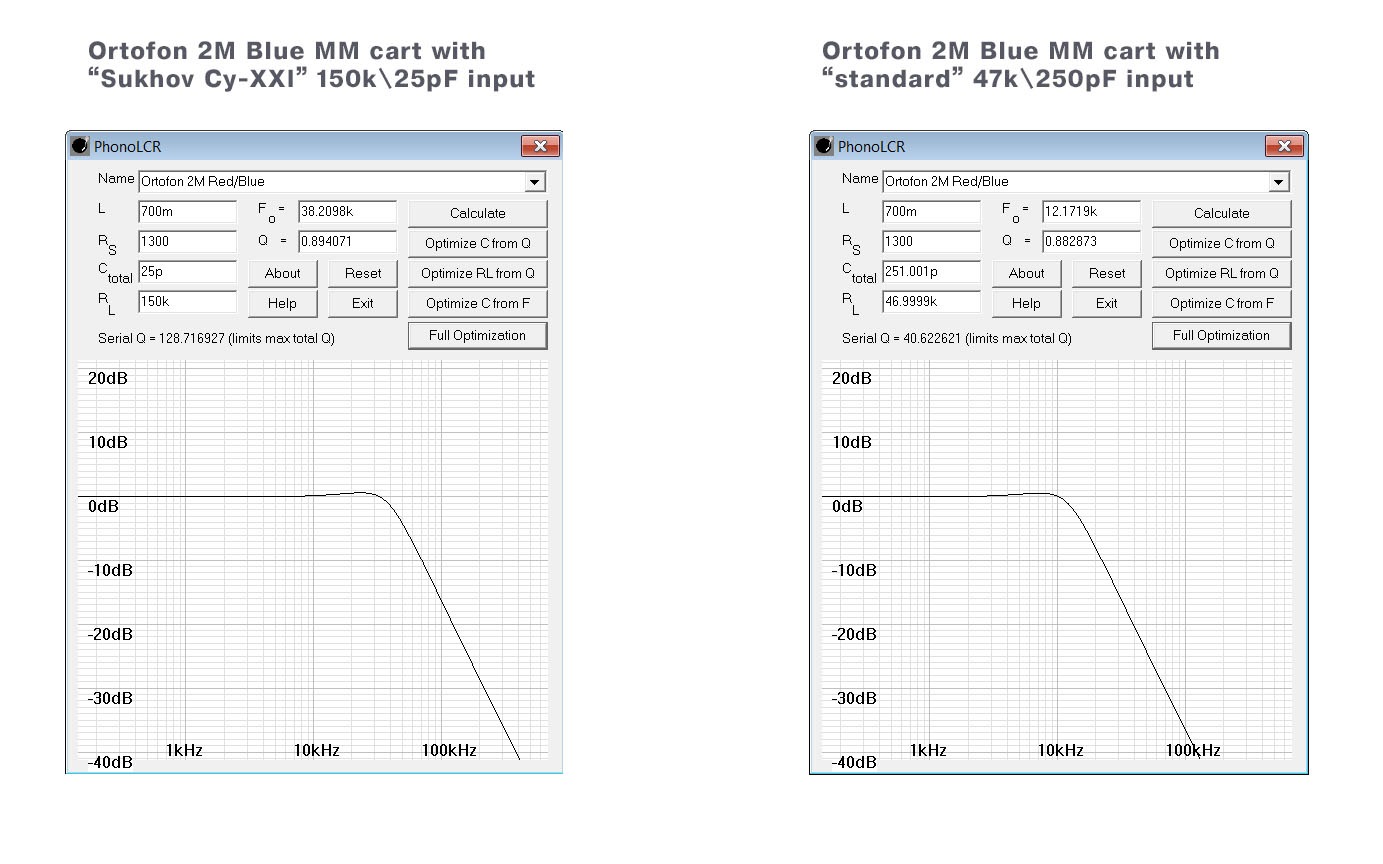

Isn't 150k too much? If the load resistor is smaller, the damping of the resonance is better, and the 1/f noise is lower. I would try 10k instead of the usual 47k.
Only for a single frequency. BTW which capacitor is C in the formula?I looked in an old book of mine and found that you can convert a resistor in parallel with an inductor into a resistor in series with the inductor using the formula Rs*Rp=L/C. The product is a constant.
L is the cartridge inductance and C is the load capacitor. This is the simple model that consists of an inductor, capacitor and resistor. The resistor can be in series with the inductor or in parallel with it. The book doesn't say anything about the formula being valid at only a single frequency .

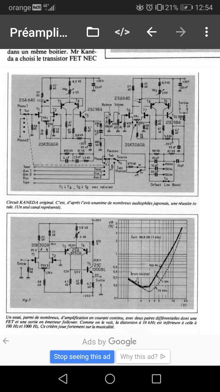

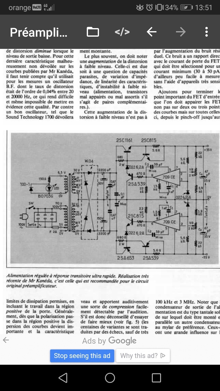

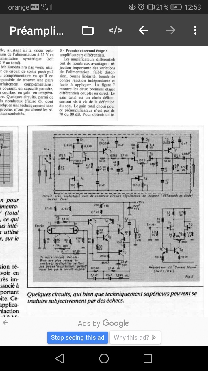

I am no expert in advanced electronics but love to learn new things. Actually i found this type of schematic described in the L' Audiophile nr.3/1978 under the name Kaneda. The concept was originally published in Radio Experimenters Magazine in 250 variants from 1973 to 1977 so way earlier than Keenwood or Kaneda. It has at least 60 articles from '73 to' 77 wich describes the functionning principles and judicious selection of the passive/active components. Its sound signature is very sensible to the PSU choice. Bellow are just a couple of example of this approach.The riaa eq is different but the amp schematic is totally the Kenwood from 1981.
The 150k will raise the top end
I am curious what are the differences between Kaneda and your version Mr Sukhov? How would you compare your variant? PSRR? Measurements and pairing and maybe sound? Did you tried the Kaneda? I am very curious in your response.
