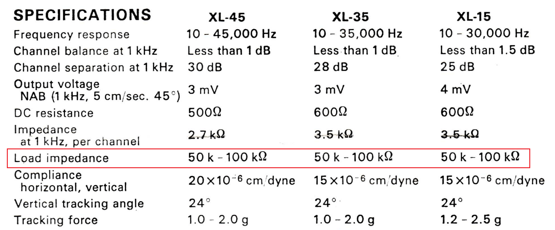

I have 2 turntables (70s and 80s of release). And both have a cable capacity of about 80 pf ( together with the capacity of the wires in the tonearm ) . I measured it . In addition , many cartridge manufacturers indicated the load range for their 47k - 100k cartridges . And I have such cartridges .Cartridge manufacturers are forced to make load recommendations based on cable capacity. With a typical capacitance of about 200 pF, the resonance shifts into the audio range, and 47 kΩ is needed to dampen it.

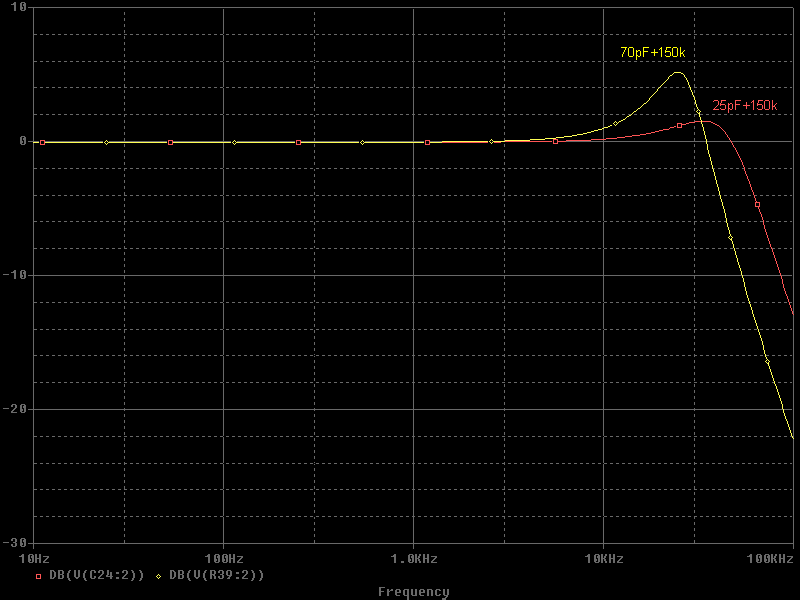

Increasing the load capacitance from 25 pF to 70 pF gives a peak in the frequency response of 5 dB and shifts it down in frequency. Of course, nothing will be noticeable by ear, few people hear above 16 kHz, but from a technical point of view, this is ugly. It is not possible to reduce the capacitance of the cable, except for exotic solutions with a twin shield and active capacitance compensation. It remains to place the RIAA preamplifier inside the turntable. This requires its disassembly, which is not acceptable to everyone. From this point of view the "Phaedrus PHLUX active phono cartridge" solution looks beautiful. It only requires a shell replacement. The printed circuit board can be made very light, the frequency of the main resonance of the tonearm will not change much.
5 dB with or without iron losses?

Yes, without taking into account the loss in the iron. I took the primitive model schematic from post #89 just for comparison purposes. Obviously, it is possible to increase the input resistance, but this must be done in accordance with the input capacitance. If it increases (for example, due to the addition of a cable), then 150 kOhm can no longer be used. The cartridge manufacturer offers a simpler (but not the most optimal) option: always take 47 kOhm and add a capacitor at the input. So you can match the input for any reasonable cable capacity.5 dB with or without iron losses?

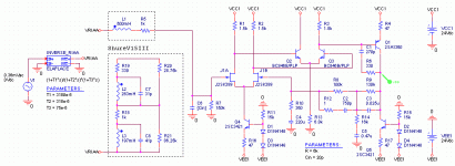

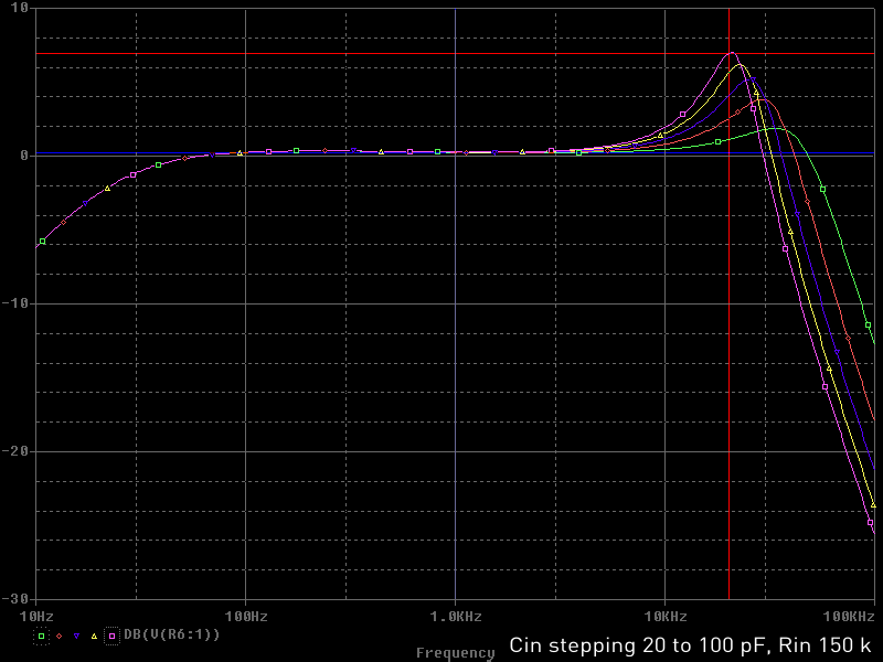

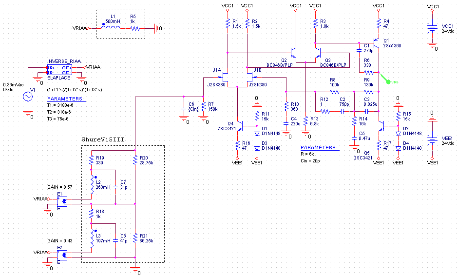

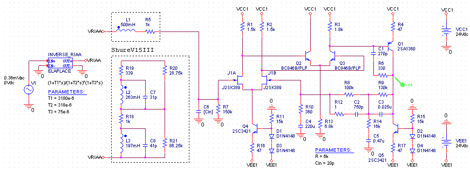

...with an unrealistic cartridge impedance model, the more realistic one is disconnected according to your schematic, and with no model at all for the mechanical response.Stepping parasitic Cin from 20 pF to 100 pF (at Rin 150 kOhm).
In the end I realize that people in their 70's might enjoy more highs anyway...so why not having such a response?!

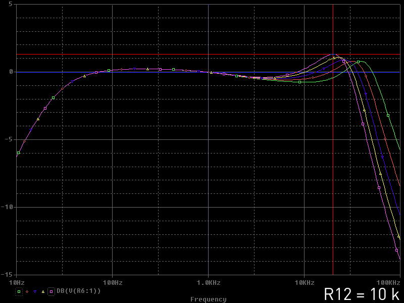

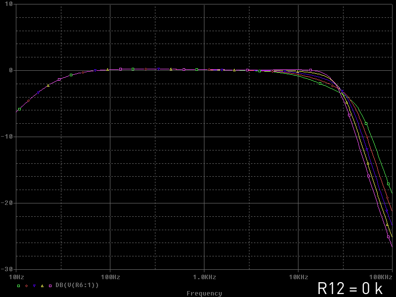

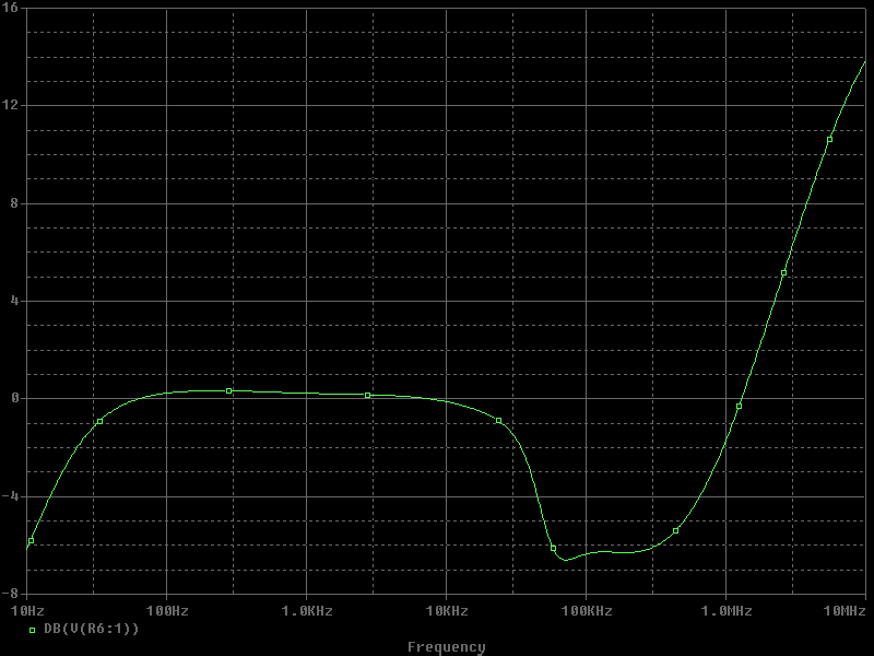

The "realistic" model from this circuit gives strange results in the HF region, while this is not clear. Regarding mechanical resonance, the issue is debatable. We discussed this with Nick Sukhov, he is of the opinion that for most cartridges the influence of mechanical resonance is insignificant and it is enough to make the "electrical" frequency response flat. In any case, this is the second step. By adjusting R12, it is possible to compensate for the effect of mechanical resonance, but this can only be done with a reliable test disk.
I see. The problem is that I only modelled the impedance, not the impact of the parasitics on the Thévenin voltage (open terminal voltage). I made the model to check some noise optimization calculations, not the transfer with unusual load impedances. Chances are that the capacitances cause a roll-off of the Thévenin voltage as well as a reduction of the impedance, but only the second effect is in the model.
If the EMF source is connected in series with this model, then the result is logical - at high frequencies, the impedance decreases due to shunt capacitors, therefore, the signal increases. In reality, the EMF sources are coils, if an external source is connected in series with the coil, everything becomes normal at high frequencies. The overall frequency response when changing the input capacitance from 20 to 100 pF has a drop of -0.8 ... -2.5 dB at 20 kHz. If you try to increase the "aperiodic correction" resistor R12 to 10 kOhm, the frequency response deviations are +/- 1 dB at 20 kHz. All this with a 150 kΩ input resistor. It looks optimistic, this phono stage can also be used with an interconnect cable. If, of course, the cartridge model is correct.
Addendum: this model with the recommended load of 47 kΩ + 400...500 pF gives very poor results, -6...-7 dB roll-off at 20 kHz.
Yes, putting it in series with the inductances makes sense.
Regarding the roll-off with the recommended load: that's why I expect this cartridge to have a strong mechanical resonance, otherwise it would not make sense that the manufacturer recommends such a high load capacitance.
