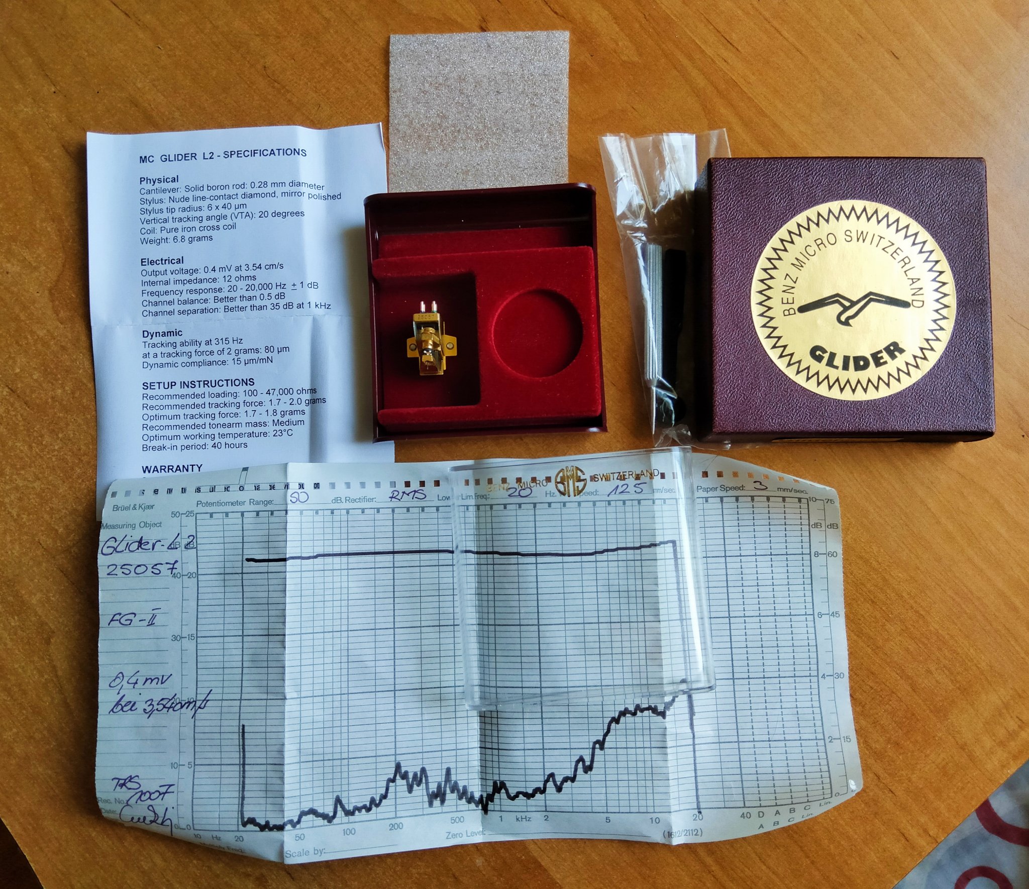

And I must also add to your research some measurements of MC cart Benz Micro Glider L2 (0.4 mV, 12 ohms, 75 uH, - see here https://www.patreon.com/posts/anonsiruiu-su-v-70963138 ), confirm the assumption that there are no any meaningful mechanical resonances for more or less modern cartridges with a boron cantilever.

How do you know if you can extrapolate that to moving magnet cartridges, particularly the high-inductance ones with a large recommended load capacitance?And I must also add to your research some measurements of MC cart Benz Micro Glider L2 (0.4 mV, 12 ohms, 75 uH, - see here https://www.patreon.com/posts/anonsiruiu-su-v-70963138 ), confirm the assumption that there are no any meaningful mechanical resonances for more or less modern cartridges with a boron cantilever.
You can determine if there is any significant mechanical resonance in the MM cartridge by comparing the frequency responses of the test LP CBS STR120 ( 10 Hz to 50 kHz sweep - IEC60098/2020 table D.1 recommendation ) playback with a successive decrease of input capacitance from C=500 pF to 15 pF and comparing the resulting frequency responses series with the calculated ones for the electrical LCR input equivalent. With mine Shure M44MB, M97HE I see nothing suggestion of measurable effect of nonelectrical resonance. In reality modern boron cantilevered MM cart has almost the same tip mass as MC (in contrast to the fairy tale suggested to us by marketers) and even less recommended tracking force (MM typical 1.5-2 g, MC 2-3 g).How do you know if you can extrapolate that to moving magnet cartridges, particularly the high-inductance ones with a large recommended load capacitance?

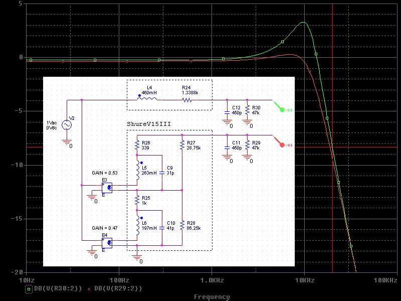

Perfect response? 😵 Your FR have a giant rolloff at 20kHz.500mH and 1350 ohms series resistance damped by 5..600pf and 47 kohms was the value I used in all my phono simulations and the antiriaa network used in lme49710 datasheet gave perfect response with the traditional 10 khz peaking ... so I don't really know what all the fuss is about
Simulation in absolutely ideal conditions for a Shure V15 III with a load of 47 kΩ || 450 pF gives a roll-off of 8 - 9 dB @ 20 kHz for both the primitive model and the complex one.
You can also just calculate that from measured impedance values, see post #159, https://www.diyaudio.com/community/...ono-stage-85-dba-sn-ratio.387375/post-7105107 That eliminates the inaccuracies associated with the step from the measured impedance to the lumped model.
