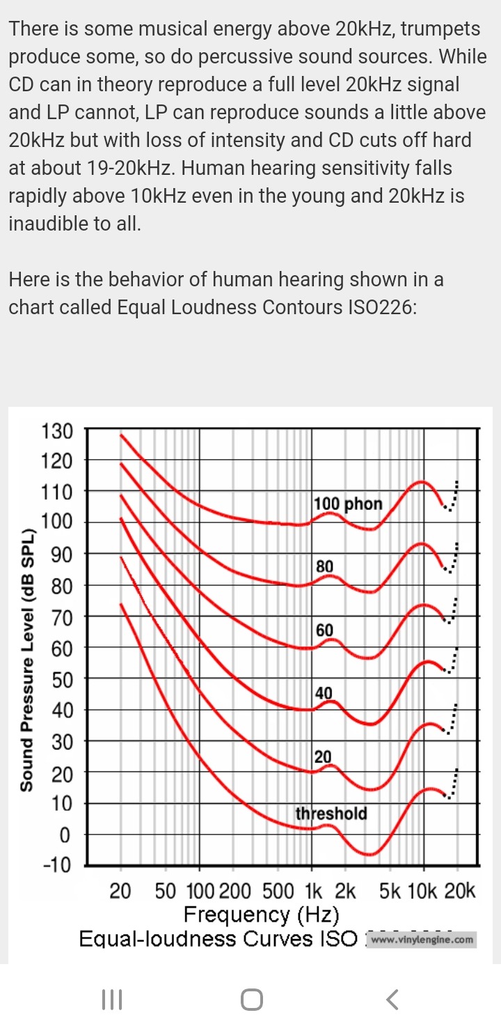

Besides I thought quadrophonic recordings are encoded recordings not ones with extended frequency ...
https://www.vinylengine.com/turntab...sid=6a339e1b25d1ad4d5bc8855375c545fb&start=12
From the picture I get that we hear 20hz much much worse than 20khz...so when we make a hearing test we probably hear 20hz speaker's own harmonics more than 20hz fundamental....

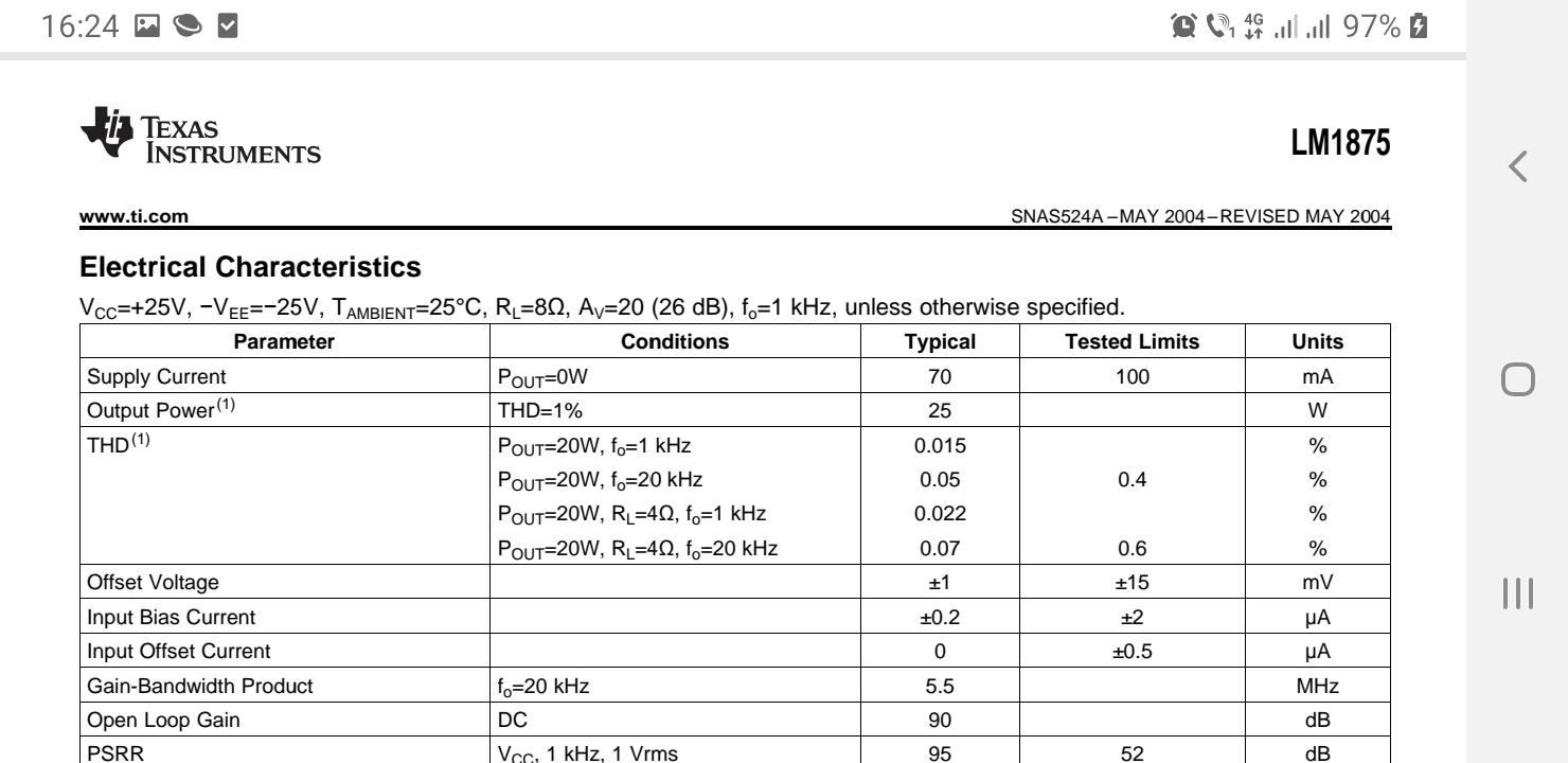

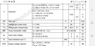

I'll be sort of off topic here for @ejp but he's a good engineer and I hope he'll be interested in making a clear scientific abx test with these two chips.
Here's a video with the old tda2050, who's thd was specified at 10khz in its datasheet, against the 20 years younger lm1875 and not only that tda2050 was 3 times better in both thd and imd tests , but lm1875 datasheet was simply telling lies about their product.
That's what a competent engineer at National Semiconductor or Texas instruments should do: telling lies about a 2 decades newer product.
You can check the rest of their datasheet and see for yourself how relevant the 20 khz measurements are.
Now what was really expected was that the higher thd amp was more stable and indeed , lm1875 was a bit more stable, but they didn't care about showing off with stability, instead they lied about distortions in the whole 20hz...20khz range cause that seemed to be the main market pressure and concern in the early 2000's .
By the way the idle current of lm1875 is double than tda2050 while tda2050 has 7% better efficiency and thus power than lm1875.That should tell a lot to an engineer! Of cource integrated circuits can give a better thermal coupling and provide for a better class B amp but who'd be able to appreciate that the class B amp was actually lower distortion although a bit more unstable?Of course, a smarter ST engineer from the 80's! They used to filter the inputs, to zobel the outputs and get that damn sound out! I've seen and heard the best implementations of tda2040 and 2050 in B&O and Telefunken TV sets made in the 80's and early 90's and they were nothing like the datasheet, because good engineers know how to squize a good product of everything it's got.
Some tradeoffs can't really be taken lightly!

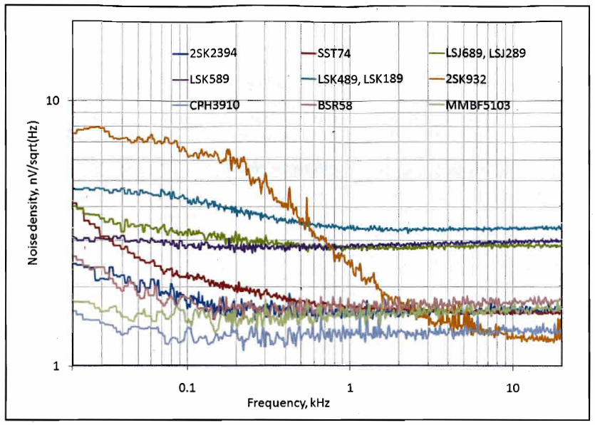

There is also a good JFET with an even lower capacity from Onsemi - CPH3910. There is not much data on noise in the datasheet, but in Audioexpress 12/2018 there was a noise comparison of transistors (at a drain current of 1 mA), where this transistor showed the best results. Horowitz and Hill also spoke well of this transistor as being low noise. There is also a dual version - CPH6904. And most importantly, these transistors are much cheaper than LSK or JFE.25 pF (LSK389) or 12 pF (jfe2140) }
Pity that the sources of the dual version are tied together and that there is no offset spec:
Is there any specification on the matching of the two transistors in the CPH6904? |
We do not monitor matching between two transistors. There is a possibility that there will be a difference within specifications of the two transistors. |
Yes, it's a pity that the match is not monitored. But the price (MOUSER) of 0.72 euros for the CPH6904 vs 4.77 euros for the JFE2140 makes you forgive a lot. It can be expected that two crystals placed in a common case will be from the same lot. The main drawback is the increased zero shift, but the servo can handle it.
