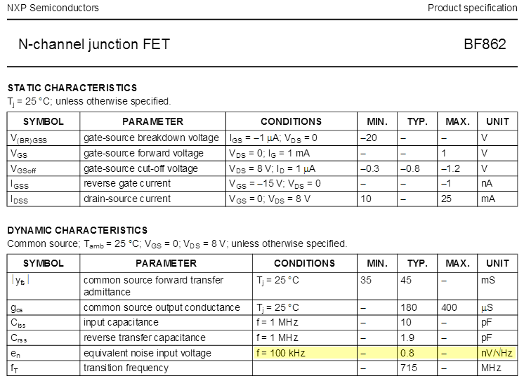

The Mote part looks very nice and it’s cheap. I have a preference for single ended JFET MM stages (lower noise). If you parallel the two JFETs in the dual package you easily have 0.5uV noise device. If it’s for low noise HF applications like AM tuners it’s probably low noise - like the old Philips/NXP BF862 (now discontinued) spec’d at 0.8uV typ.There is also a good JFET with an even lower capacity from Onsemi - CPH3910. There is not much data on noise in the datasheet, but in Audioexpress 12/2018 there was a noise comparison of transistors (at a drain current of 1 mA), where this transistor showed the best results. Horowitz and Hill also spoke well of this transistor as being low noise. There is also a dual version - CPH6904. And most importantly, these transistors are much cheaper than LSK or JFE.
The differential stage in theory has a 3 dB higher noise level. But if other sources of noise are taken into account, the degradation will not be so significant. For applications such as phono stage, the signal-to-noise ratio will be sufficient. On the other hand, the differential stage has good linearity, high PSRR, and it easily allows you to set the operating current using a current source. For my transimpedance phono stage, I haven't decided yet which input stage to use. It is possible to use a single JFET at the input together with a BJT in the form of a cascode circuit. Even better is a folded cascode to allow different transistor currents to be set for optimum gain. But it is not entirely clear how to adjust the operating point. I would not like to add something to the source circuit, it is better to control the supply voltage of the load resistor in the drain. But the initial drain current is too high. While a diode in the source circuit might help...I have a preference for single ended JFET MM stages (lower noise).

It is RF component, - noise is specified @ 100 MHz and no DC offset data... I don't want to buy a pig in a pokeThere is also a good JFET with an even lower capacity from Onsemi - CPH3910/CPH6904. There is not much data on noise in the datasheet

As you like. For example, BF862 is also an RF device. But this did not prevent its use in low-frequency circuits. The noise graph of the CPH3910 is close to that of the LFU2140. The only drawback is that the match is not normalized for the CPH6904 pair.It is RF component, - noise is specified @ 100 MHz and no DC offset data... I don't want to buy a pig in a poke
The BF852 is spec’d at 0.8uV typ. It has very low noise at LF and a low 1/f corner. They get used in mic preamps quite often. Scott Wurcer was very impressed with it.
The BF862 datasheet only says a noise density of 0.8 nV/Hz^0.5 at 100 kHz. There is no data on noise in the audio range, and there is also no cutoff frequency of 1/f noise.The BF852 is spec’d at 0.8uV typ. It has very low noise at LF and a low 1/f corner.
They’ve been measured - one of the guys active here on the forum published measured results for a number of JFET’s in IIRC ‘Electronic Design’. The BF862 came out tops by a good margin. It’s an ‘industry secret’ BTW - the go to low noise JFET for audio.
The measured nV/rt Hz figure for the BF862 is 0.9 nV/rtHz - not 0.8uV.The BF852 is spec’d at 0.8uV typ. It has very low noise at LF and a low 1/f corner. They get used in mic preamps quite often. Scott Wurcer was very impressed with it.
I know that BF862 has been used successfully in audio, but their production has been discontinued. Horowitz and Hill name the CPH3910 as a replacement.It’s an ‘industry secret’ BTW - the go to low noise JFET for audio.
