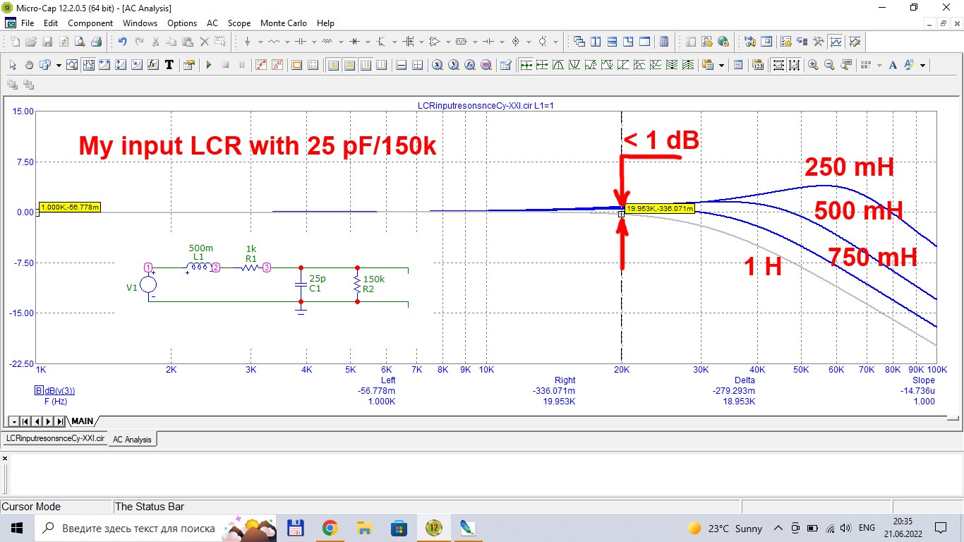

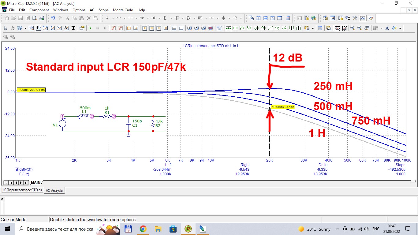

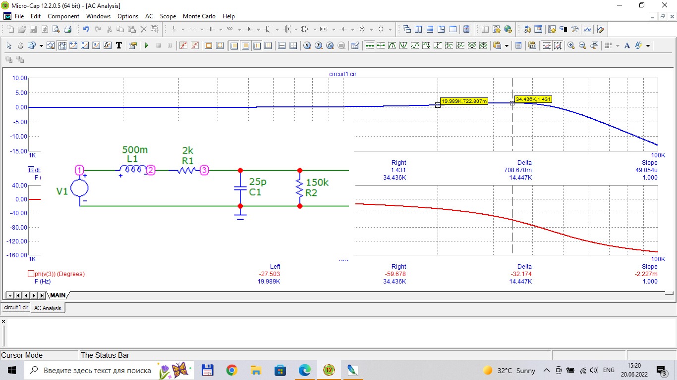

Yes we can, and not only better SNR but also better real freq response at HF for almost any MM cartridge (i.e. with any inductance) and without any adjustment like C-matching while test-LP playing. See the attached two screenshots where cartridge inductance is stepped 250-500-750-1000 mH but one with mine "Aperiodic" low input capacitance and 150k, and other is standard 150 pF and 47k. I have less than 1 dB negligible delta @ 20 kHz and standard is 12 dB unaccepatable delta.
Are we struggle for "setup" or for a good sound? I have not any problem to insert my preamp inside any turntable, bit I have made a good sound for it. And thanks to such a construction I have only 5...7 pF capacitance of the wirings inside tonearm (plus approximately 20 pF of LSK389, total 25 pF). Isn`t it a reason for MC sound from MM cartridges?I can believe something like that , but then we can't use your preamplifier in a normal setup using cables between the tonearm and the preamplifier as 1m of the best cables cables present well over 50pF of capacitance.

I use standard IEC equivalent of MM = 500 mH in series with 1 kOhm. For testing I use stepping of inductance from 250 mH to 1 HWhat model have you used for the cartridge generator? I have found that manufacturer specs are woefully inadequate (and commercial MM designers don't seem to have considered loading properly for about 30 years 🙂 )
150 kOhm is not too much. It is enough for a good damping if you have low input capacitance. See the attached screenshot or even test my circuit file [ freely here https://www.patreon.com/posts/68010671 ] in Microcap 12 circuit simulator [ also freely here http://www.spectrum-soft.com/index.shtm ]Isn't 150k too much? If the load resistor is smaller, the damping of the resonance is better, and the 1/f noise is lower. I would try 10k instead of the usual 47k.
And you are wrong with resistor noise: if input resistor is smaller, it`s current noise is bigger. As input resistor is paralleled with cartridge, we must summarize not noise voltages but noise currents.

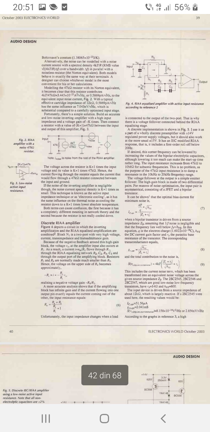

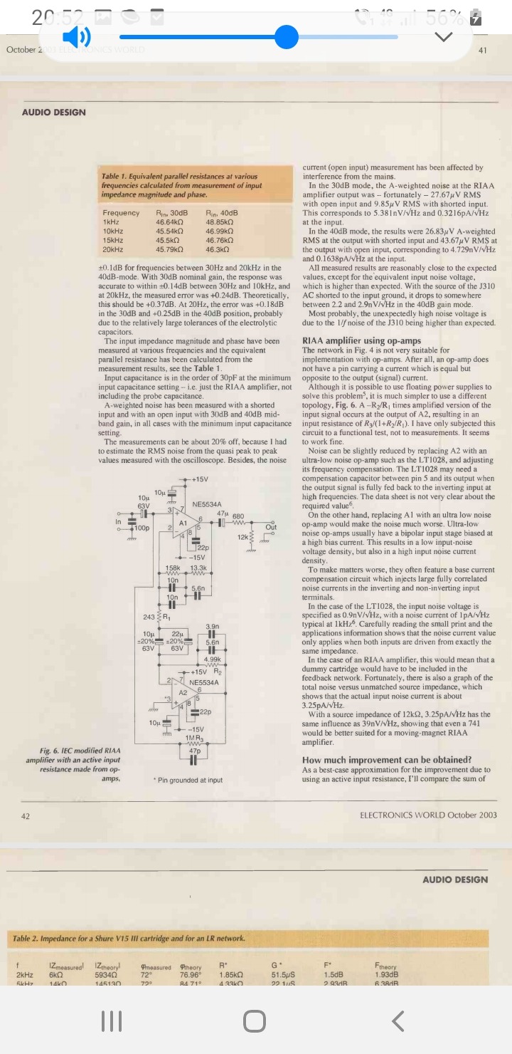

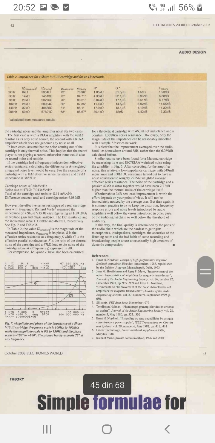

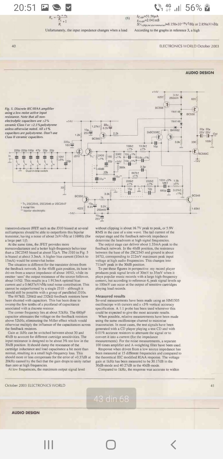

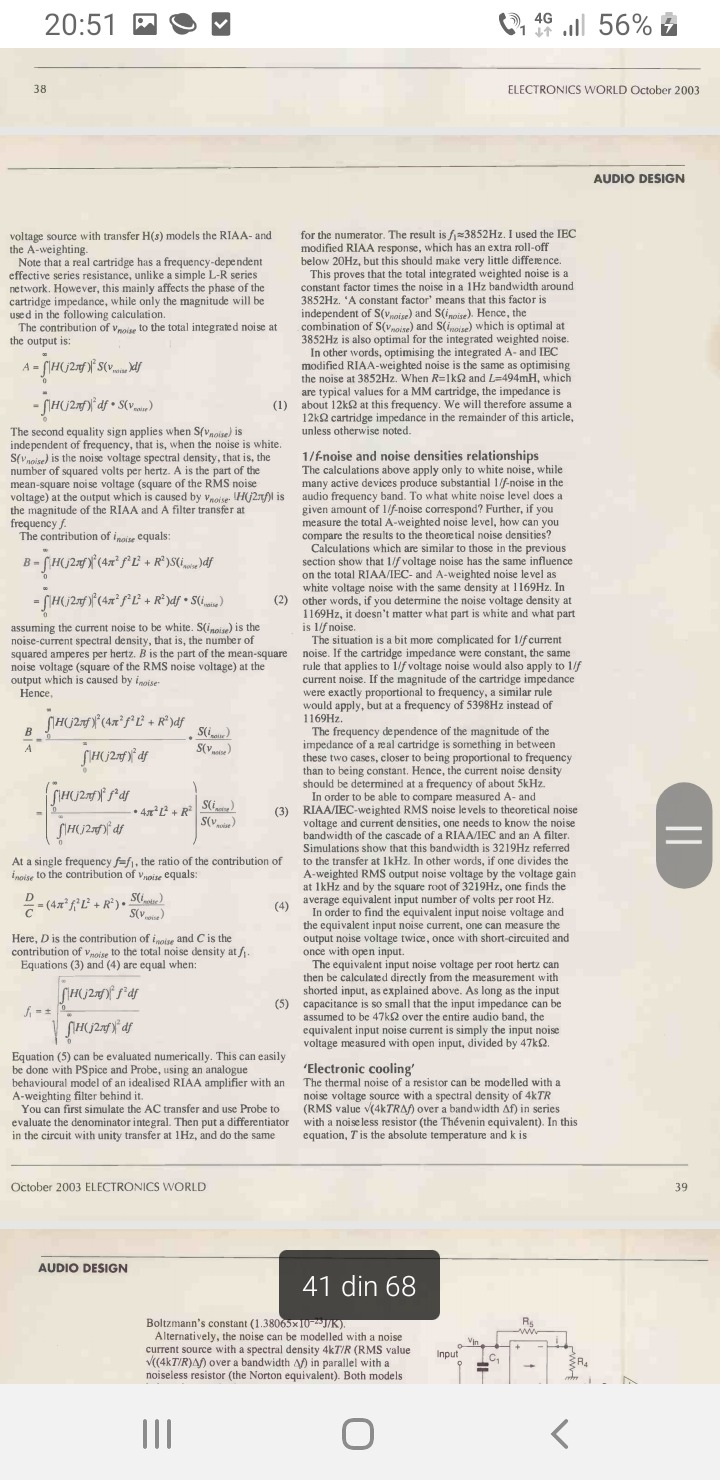

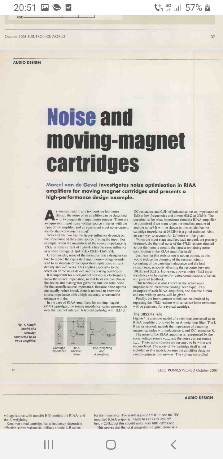

Richard Visee measured the impedance of a Shure V15-III decades ago, but not the mechanical response. The results are in my article in Electronics World October 2003.
Damn...I wish I had access to these sources 20 years ago...Richard Visee measured the impedance of a Shure V15-III decades ago, but not the mechanical response. The results are in my article in Electronics World October 2003.
