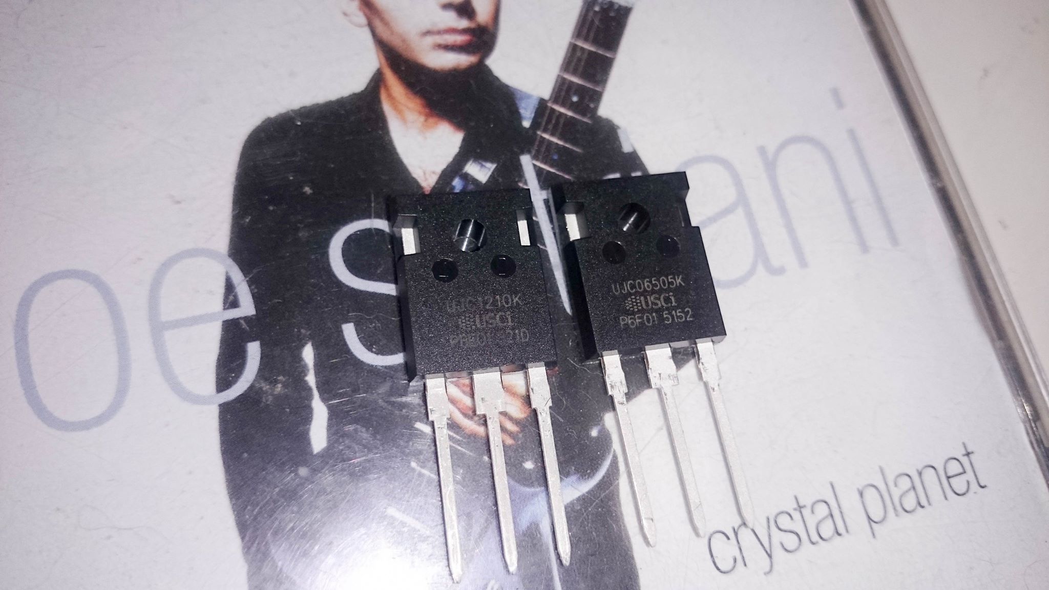

You might be surprised at what I have on my shelf. Even if it's the same,
it would be good to have them available.
I wouldn't be at all surprised if you had a 10MW Gyroklystron!

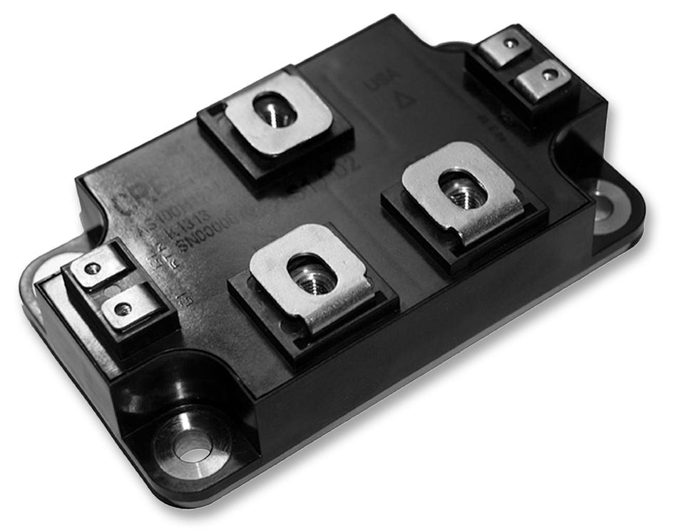

CREE CAS100H12AM1
Reminds me something 😉
CAS100H12AM1 - CREE - Bipolar (BJT) Single Transistor, Dual N Channel, 168 A, 1.2 kV, 0.016 ohm, 20 V, 2.6 V | Farnell element14 Israel
Could one replace the two IRF's in the F6 with just one of these?
I do not know I got them as a gift
I got one of each
Too bad it's not a pair of each. But for such a gift I do not complain
I have found a interesting project to take advantage of them
( I probably use them on one of my projects on power supply)

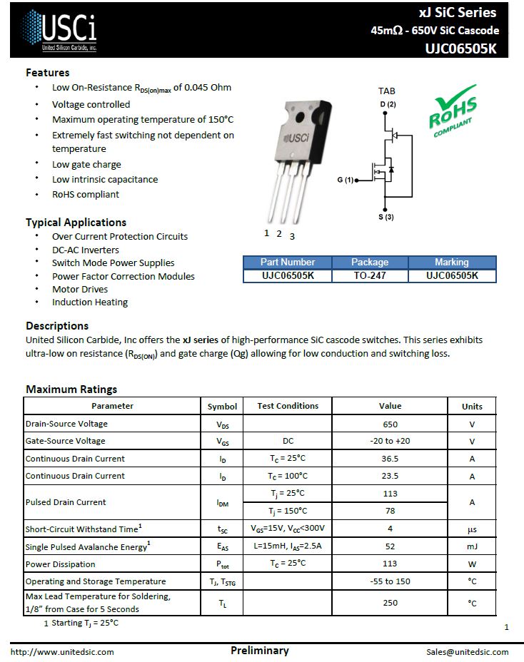

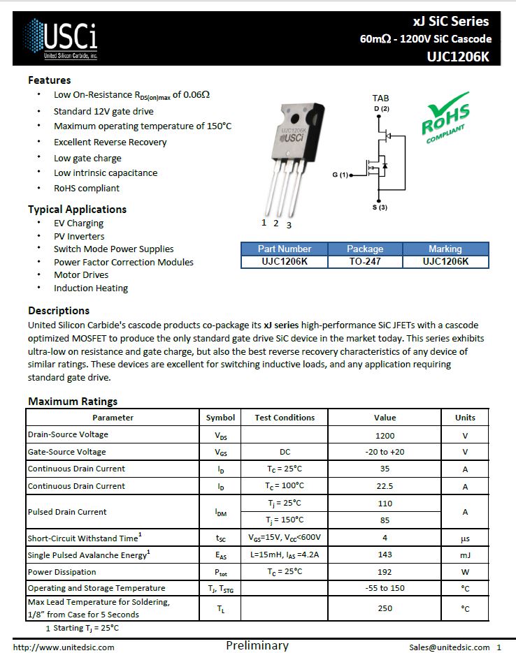

jfet SiC Cascode
I couldn't import the spice model of c2m1000170d. while importing this shows an error while compiling. could anyone help me in debugging the error.??
