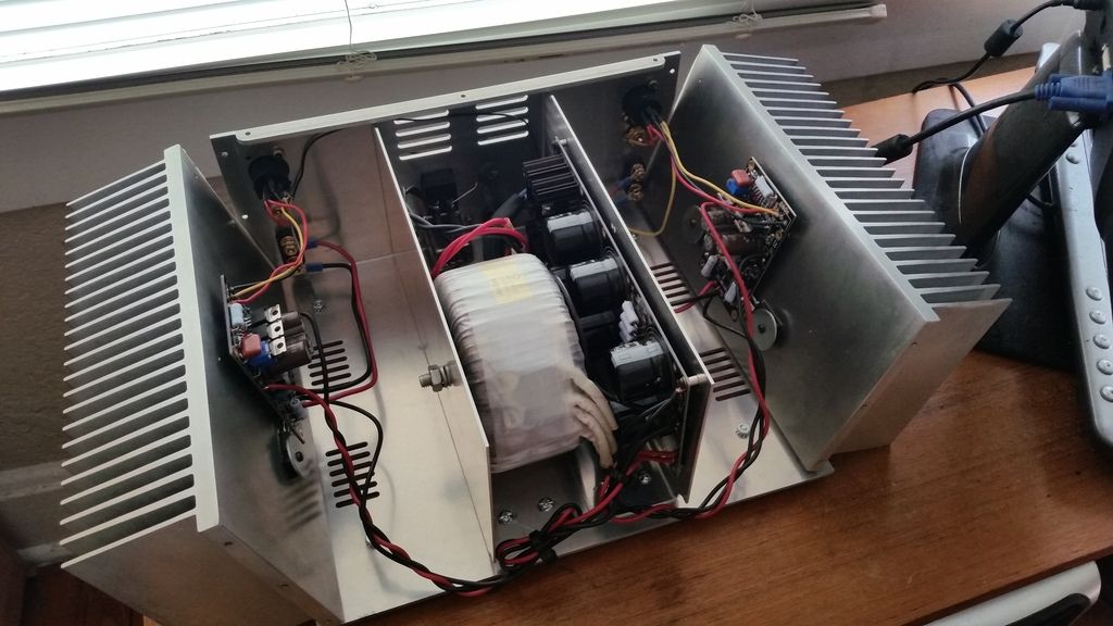

Had the day off today and a lucky coincidence... a Mouser package arrived at the door. How does it get better?
Anyway, received a pair of C3M0065090D Cree, Inc. | Mouser and proceeded to drop them into the bottom half of a Mini Aleph. After powering up I checked the bias (same as usual), I let the amp warm up before cracking a beer and listening to some tunes...
I don't have any measurement equipment so I can't relay any data there. But I have run through some familiar tunes and my first impression was "man, this sounds a little bright" and it certainly wasn't placebo.
The Cree datasheet says these have 660/60 pF input/ouput cap.. so maybe it's just the highs that were muffled from the IR devices.
There doesn't seem to be any free lunch however; the amp definitely does voices better, the soundstage deeper, realism officially enhanced, but that loosey-goosey Aleph bass that I've come to live, learn and love (or was it just big and bloated against those mids/highs this whole time?) seems to have disappeared. I'm going to have to live with this for some more time to figure out whether or not I like it. I generally listen to a lot of dub/reggae and like the sound to be 'warm'.

Do 3 pairs and you should get your bass back.
Not an option on those sinks 😀 I think I'll let them burn in for a while before casting final judgement. So far they do details really well, it's just.. well, you know.
I have four of the C3M awaiting some kind of build... Was thinking about using them in an F6. Glad to see someone else using them.
What voltage/current are you using in the Mini-A?
Mine's at 18.5V, 1.55A.. I actually think Pico is on to something (beside the obvious). It might be the case that this particular device finds nirvana in multiple pairs where it gains authority without losing all the crispy crisps I'm hearing right now. Unfortunately, I don't having any use for those big amps in my little home..
