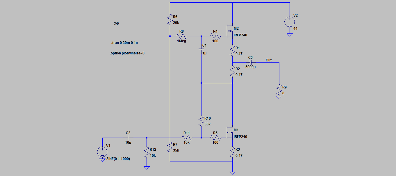

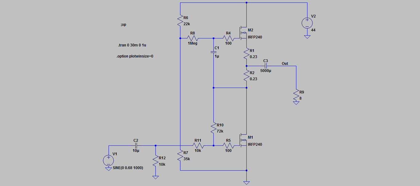

First basic version it will need adjustments to work with C2M1000170D
R3 is probably totally unnecessary
R6 and R7 adjust bias point of M2. So you will need a pot.
R10 and R11 schade feedback loop adjust bias point of M1.
Changing source resistor values will also aid in adjusting bias points.

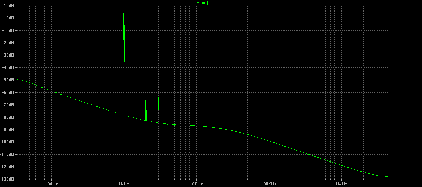

Here is distortion of circuit above. Obviously with IRFP240 bandwidth will be limited but with your device it should be fine
I'll try and do one for C2M1000170D (having issues with models), but hopefully this will be enough to get you building something.
