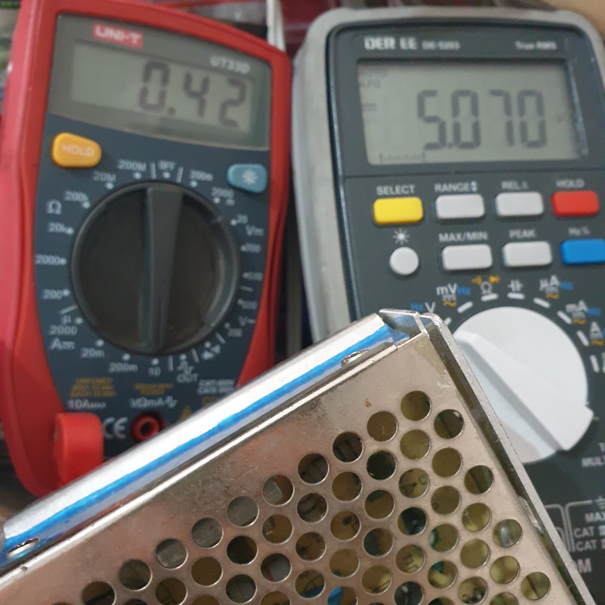

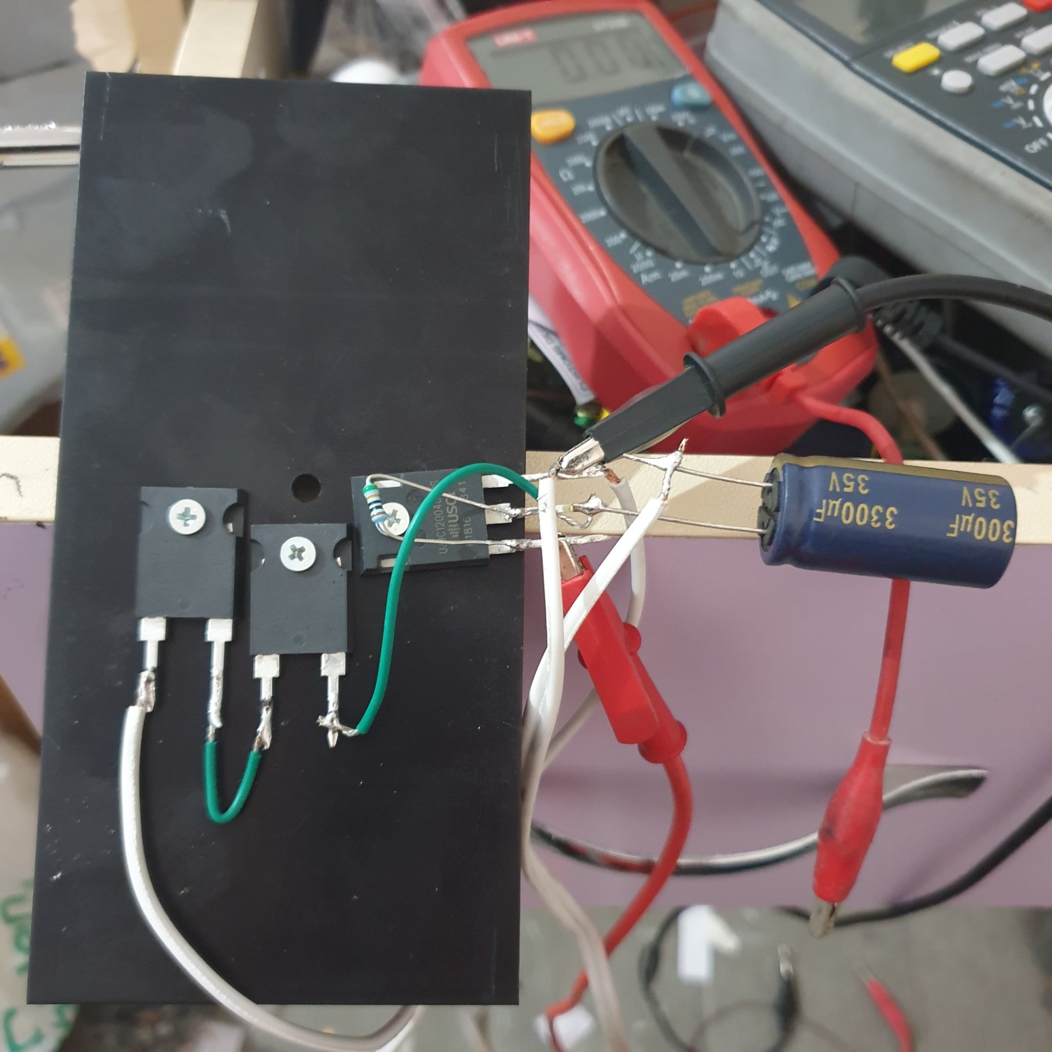

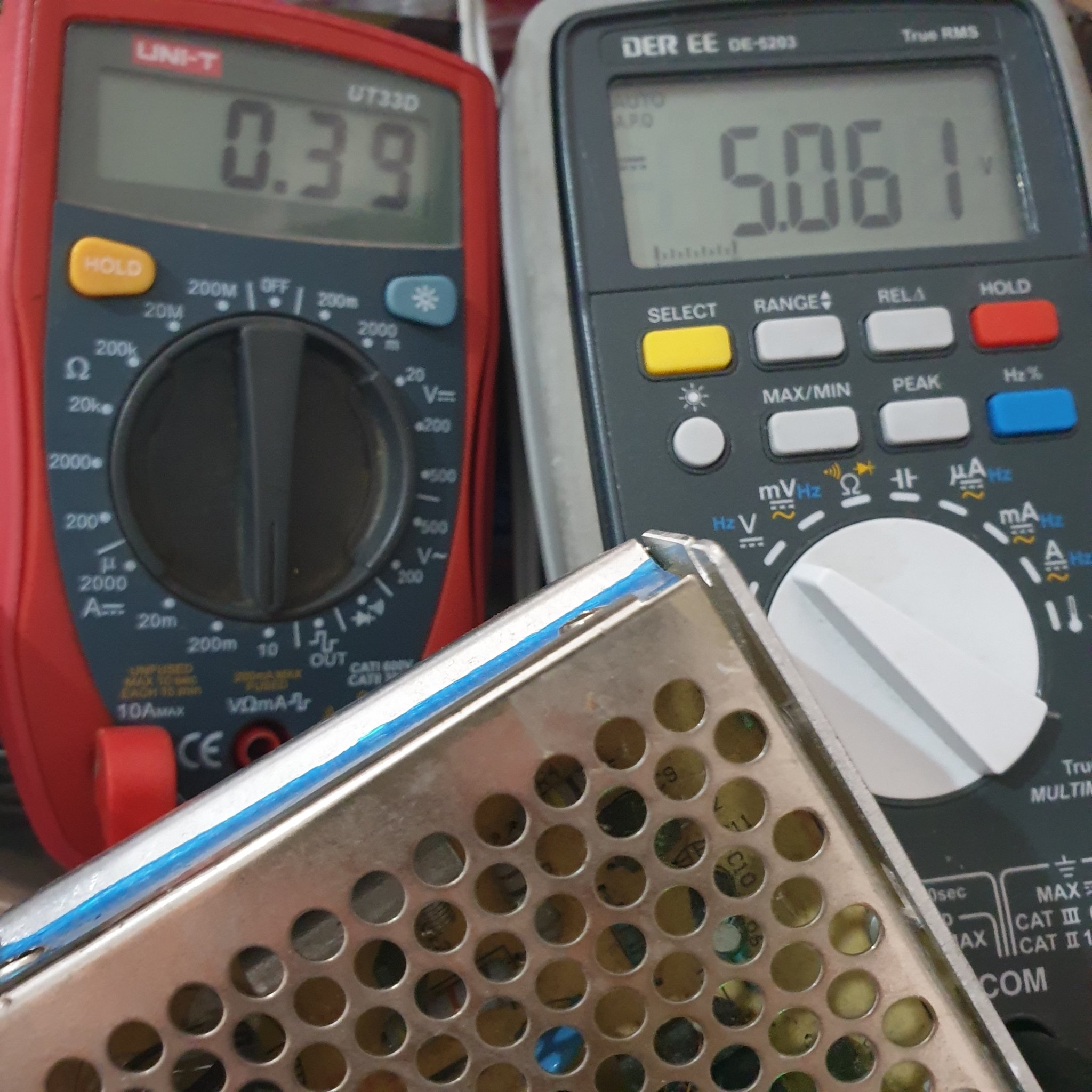

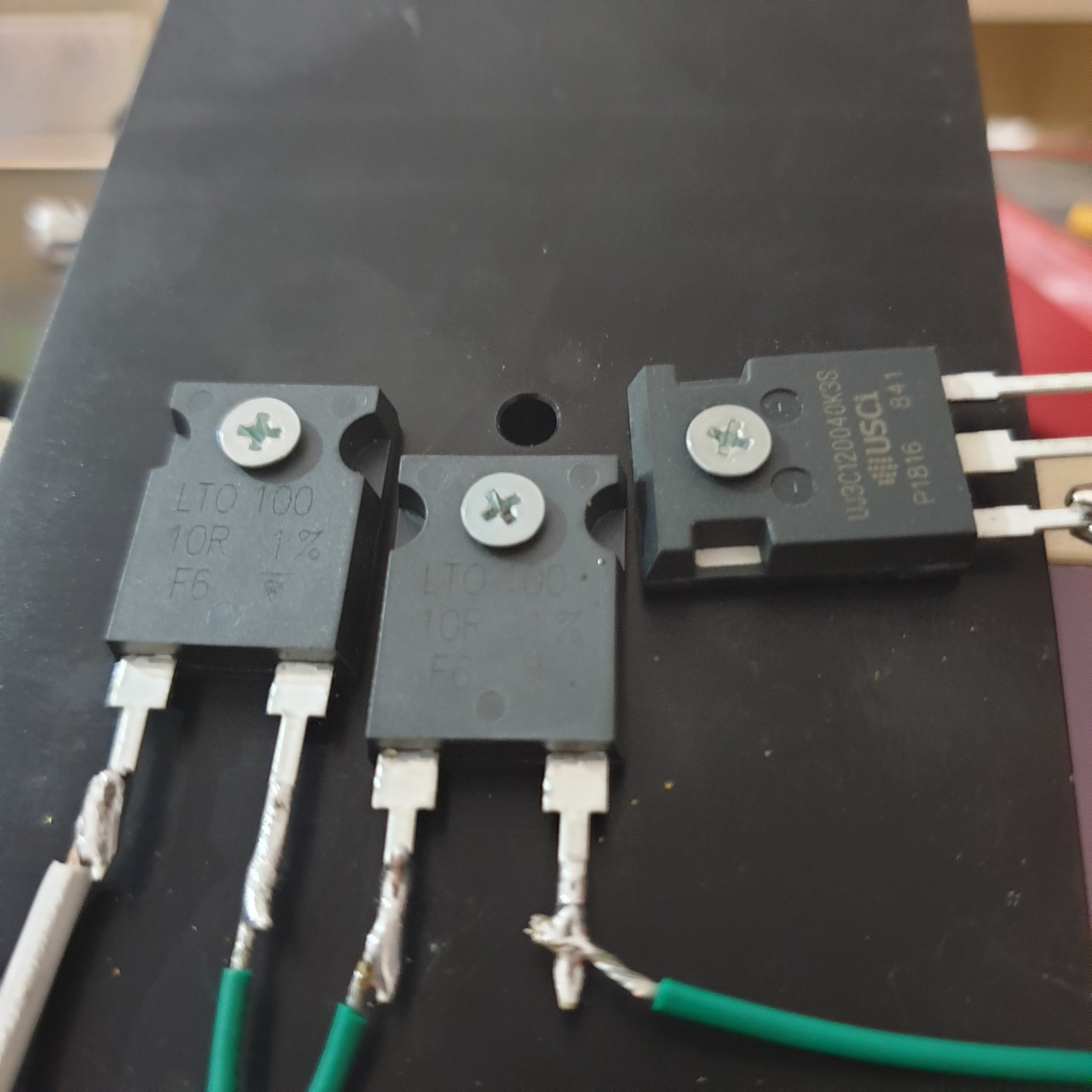

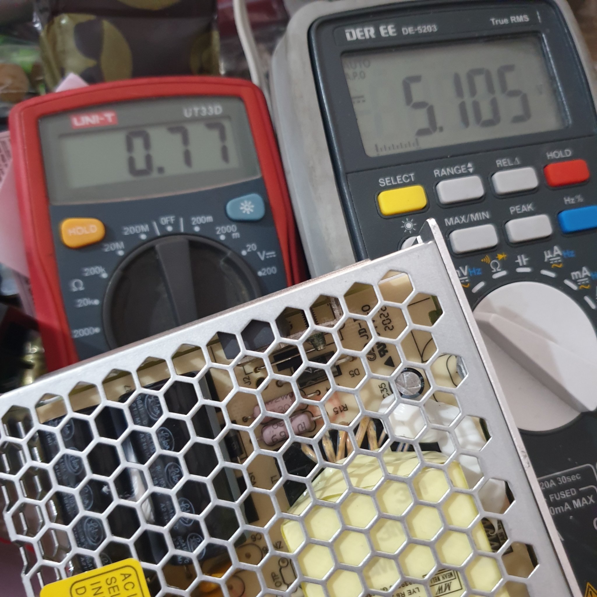

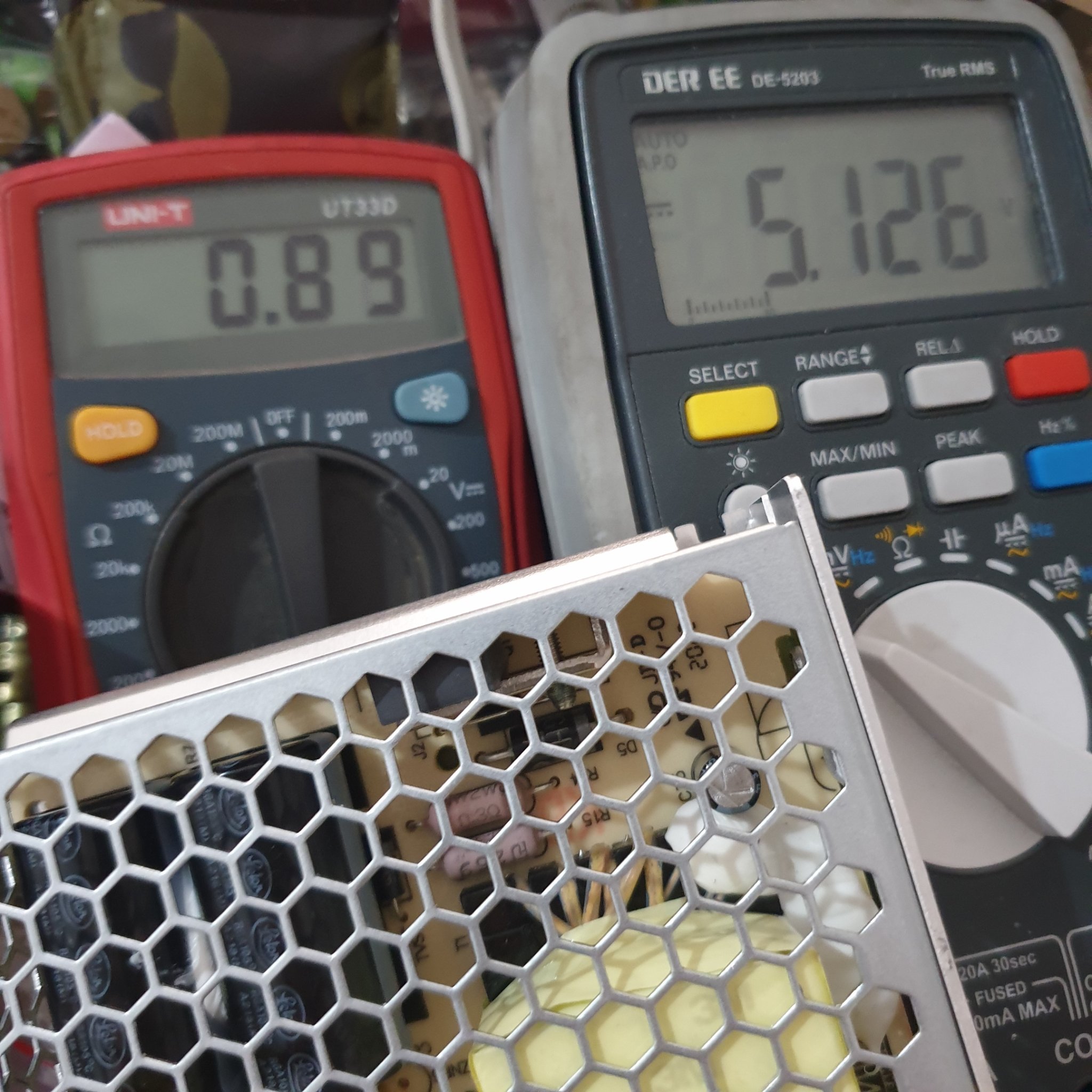

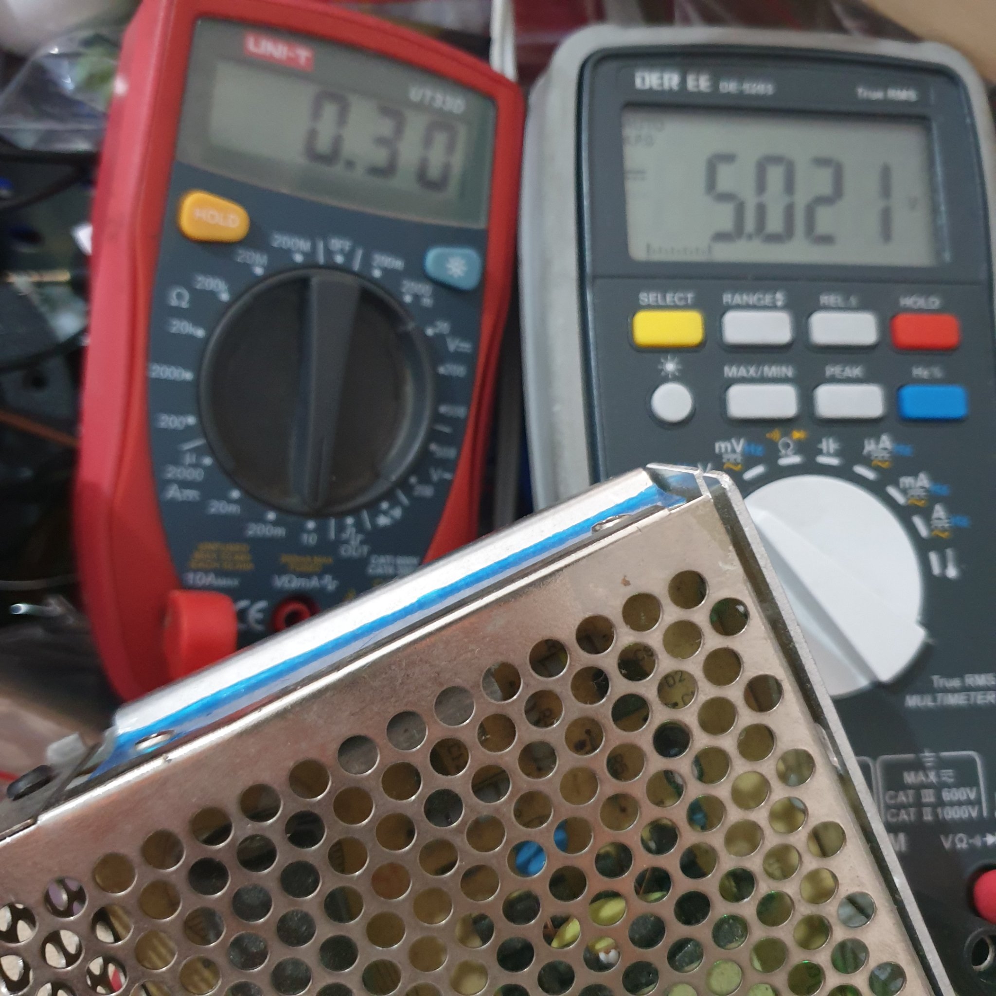

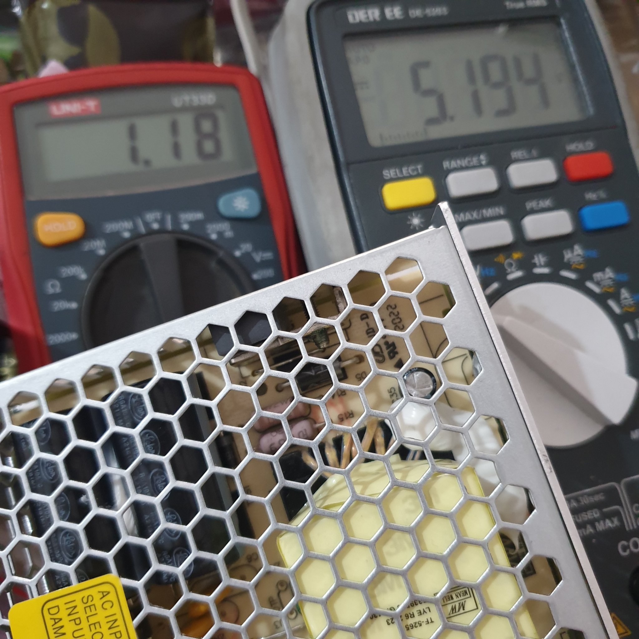

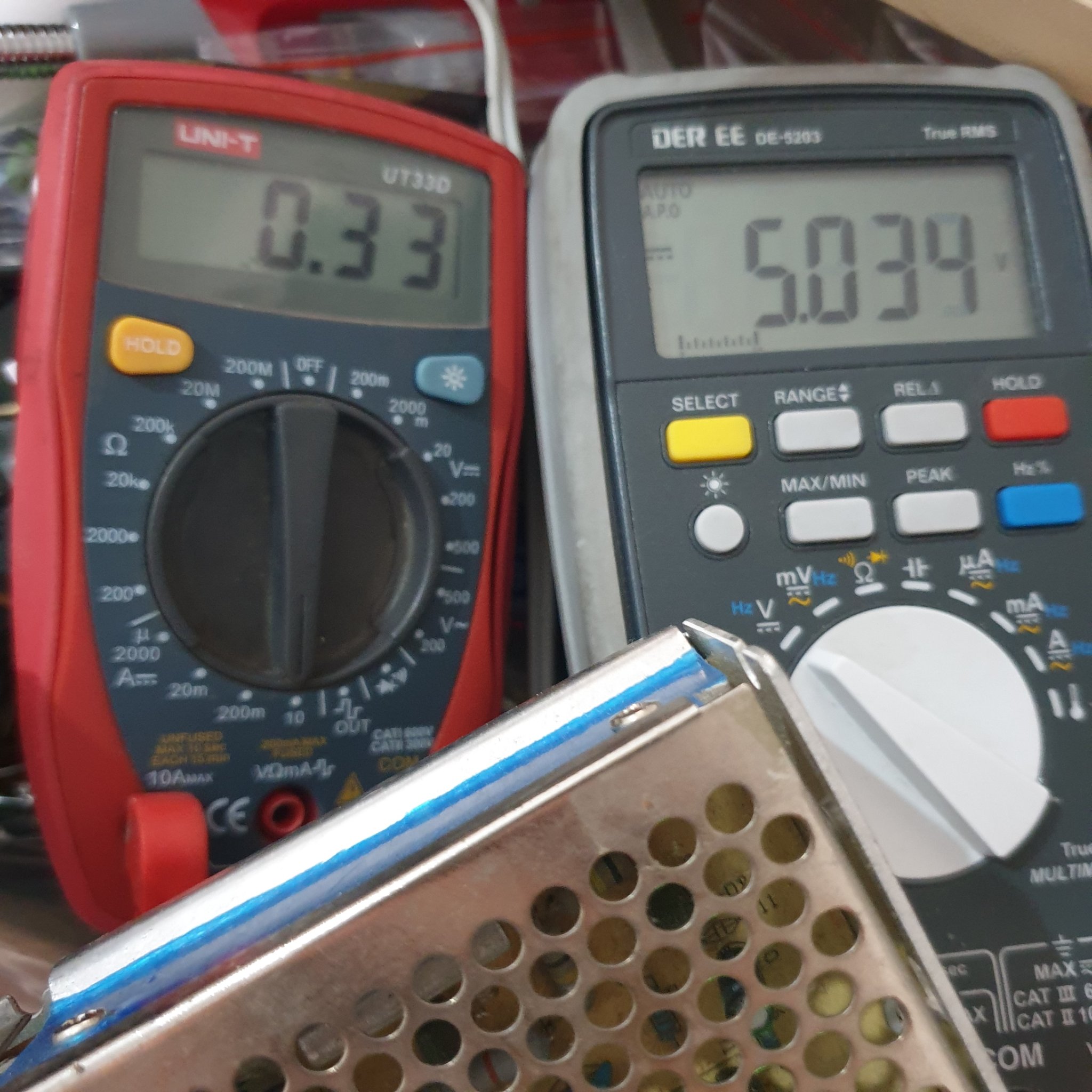

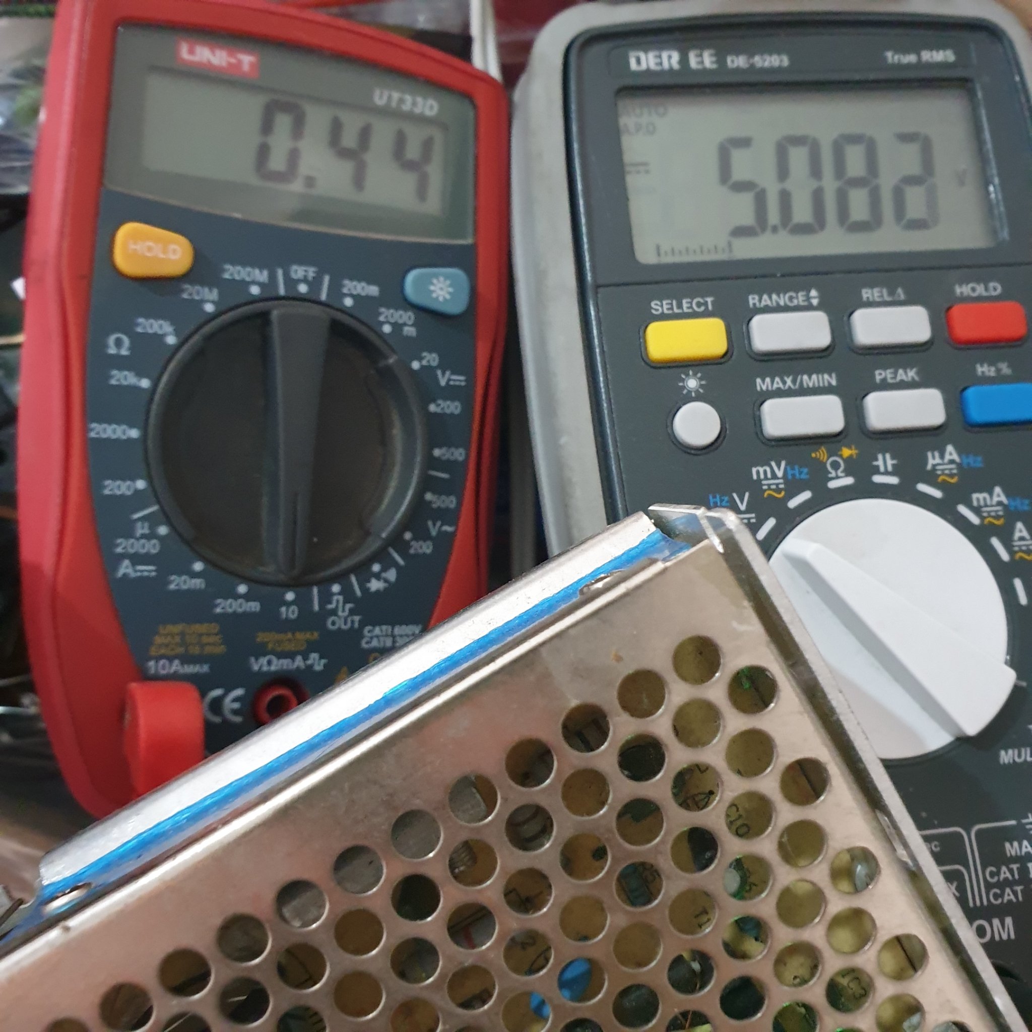

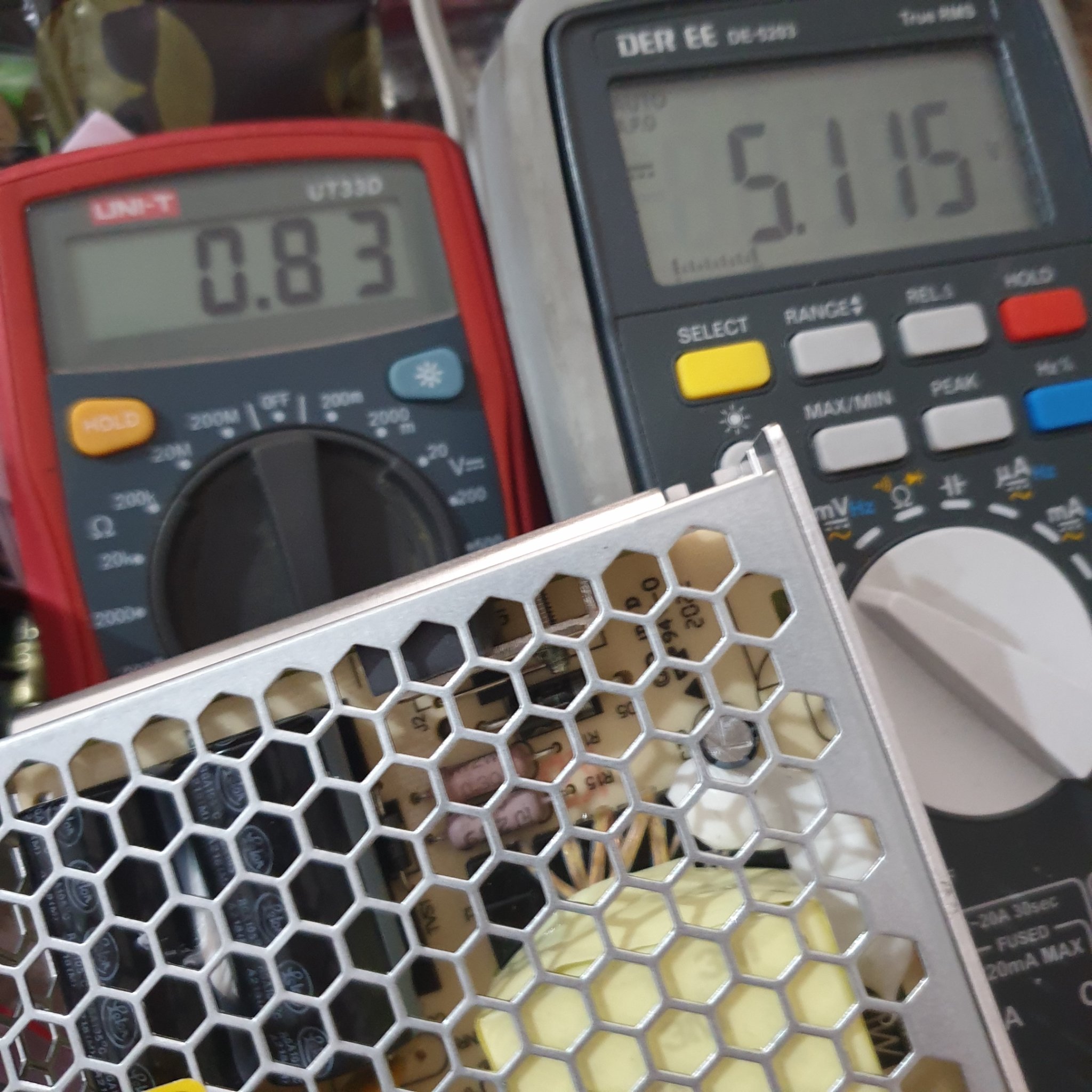

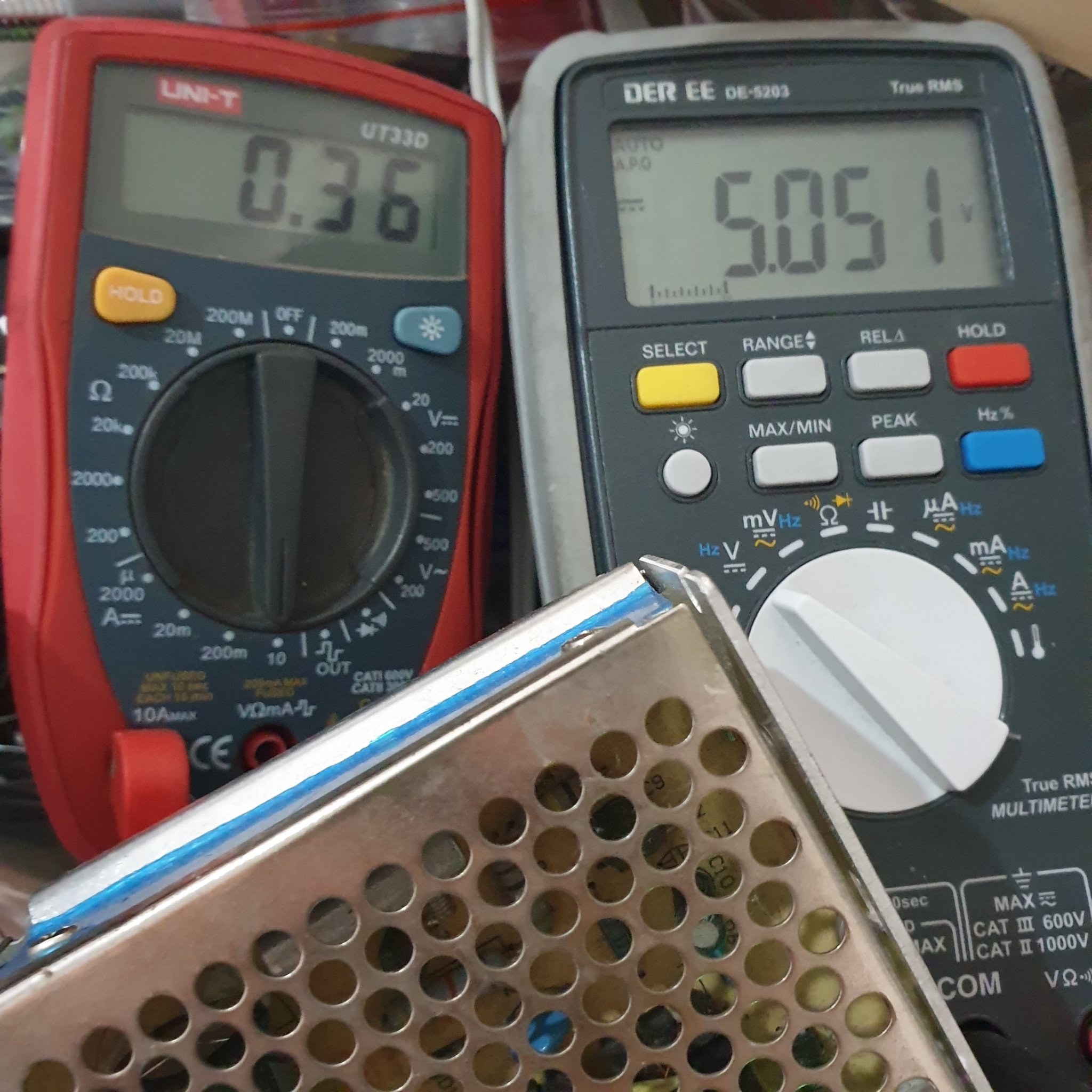

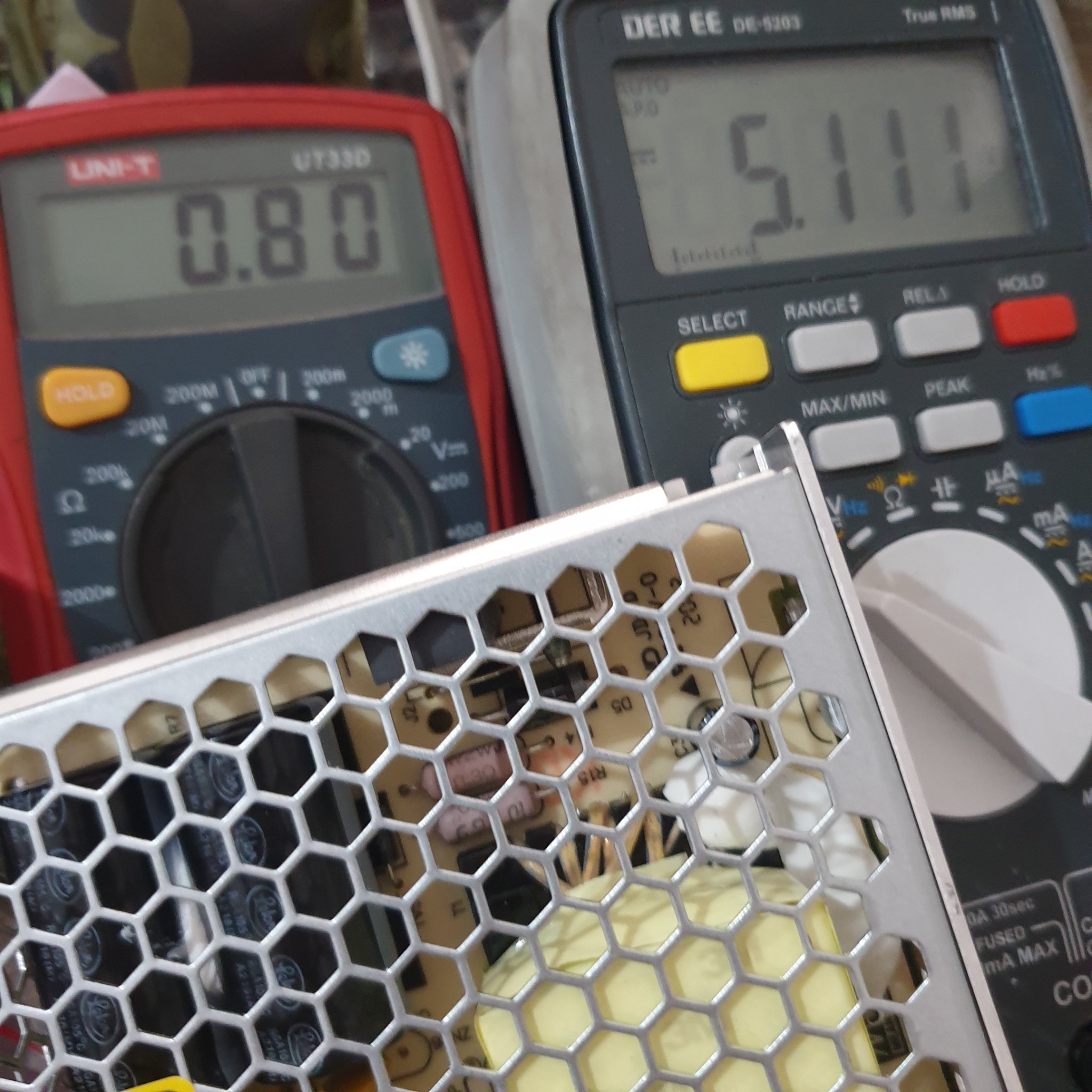

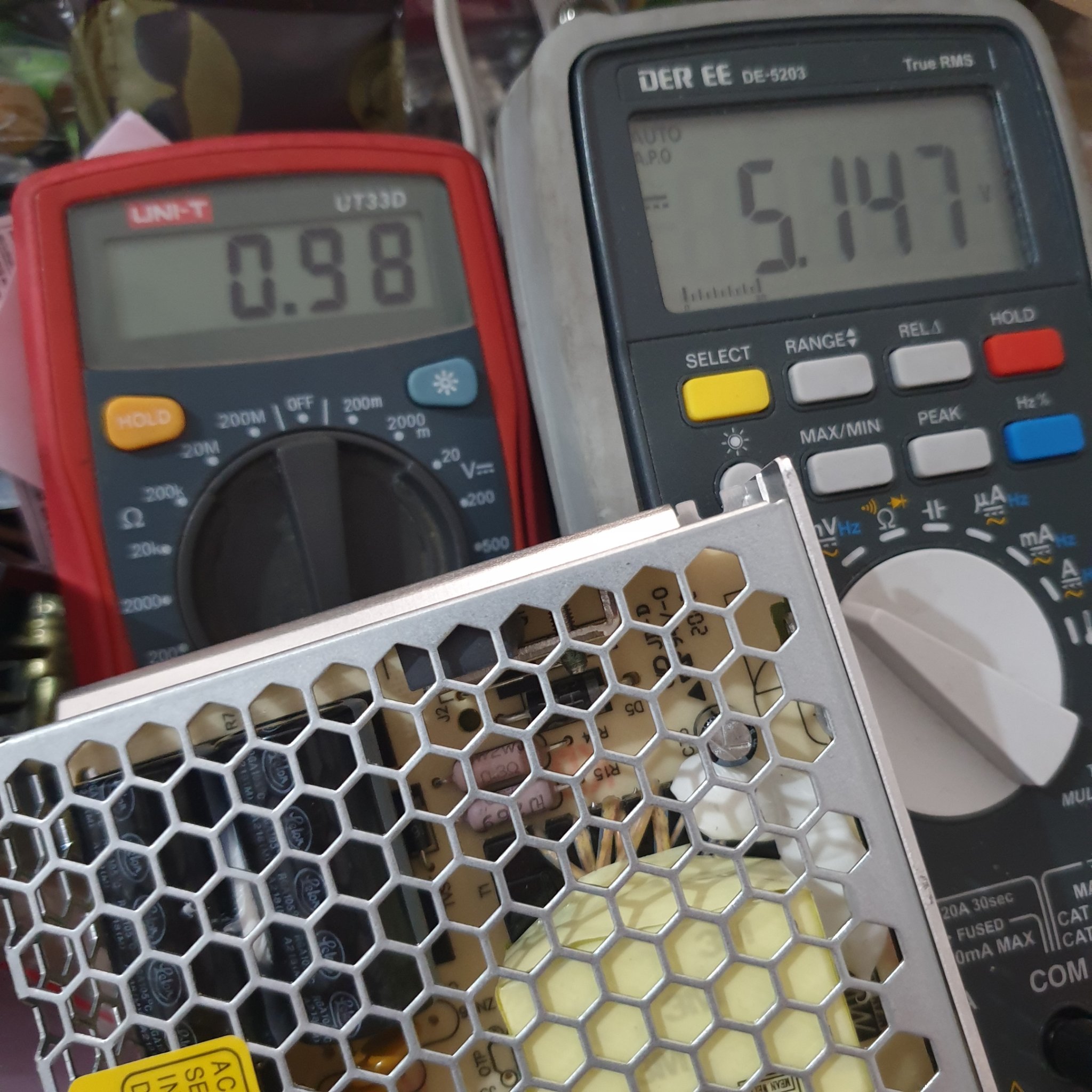

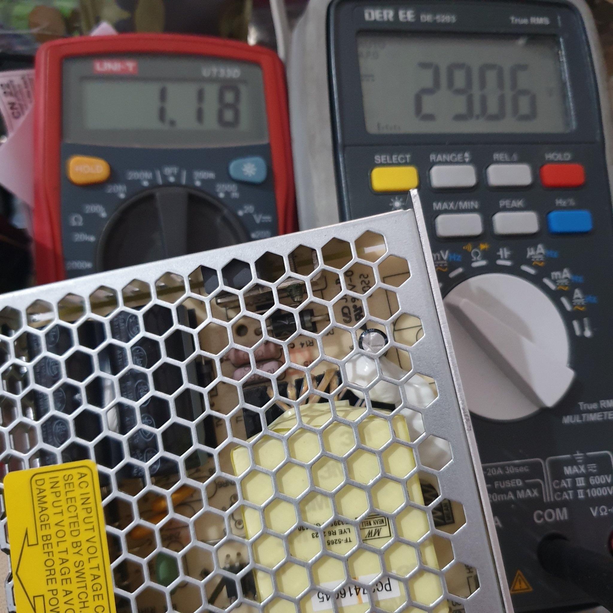

Hi. I had some free time and give them a try which I forgot them in storehouse 🙂

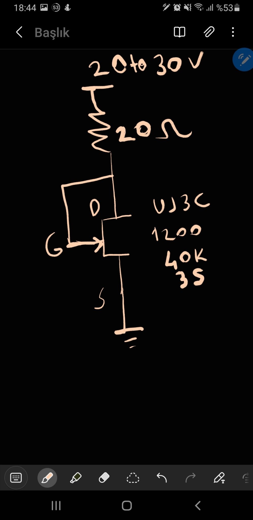

I also tried to make an amp it sounded a little but only when I made my hand in series to gate and phone headphone output . It sounds a lot when I put my finger on gate but does not play when I connect it to phone directly.
I tried with 12v and 24v power supplies by trimmer of them. Sorry for many photos

Here's something using the Semisouth SiC JFET. Something similar similar could be done with the United Silicon Carbide/Quorvo SiC JFET. The amp emulates a classic two-stage Class A tube amp with pentode inputs and outputs with both "Schade" and global feedback.
https://www.diyaudio.com/community/threads/sic-puppy-se-amp-using-semisouth-085-jfet.192450/
Thank you for your answer. What about low voltage one? 24-30v one will be good because I have meanwell 150w
For the low voltage option, you will have to search elsewhere - I never tired that one. I'm sure there's a thread in the Pass Labs forum if you search.
see original Zen amp , FW site, articles page
can't be simpler
principle is there, adjust values for your needs
can't be simpler
Since Electra-Print is no more, I think you can get a suitable transformer for the low voltage option from Edcor.
Edcor makes a 150/8 ohm transformer in their lineup of largest single ended transformers. This calculates out to a turns ratio of 4.3:1. Max current rating is 400mA. If you work out the numbers, that means you can get 1.73 A peak secondary current running at the highest rated primary current. This translates out to 11.76 W RMS max output power with the output device of your choice. Assuming you can arbitrarily bottom out the driver, that means you'll need about a 60V bus (it was 58V, but I rounded up a bit) to to get that much RMS power into your speaker. A little bit higher bus voltage will keep things farther away from chipping if you crank it up, but also more dissipation in the output device.
