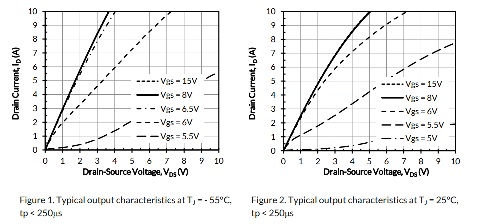

The whole interpretation of the mis-fit in use for audio lies in the intepretation of the graph; but that graph is made for the intended switching purpose.
Better: make the Michael Rotachcher test rig for SITs and test them [& adapt the bias supply??], as long as you have his XY-input scope.
I would not be surprised that at the 300mA-1 amp area there is a very interesting operating area - just like the low end of the lovoltechs -. At least when I looked into the datasheet I provisionally made that interpolation: potential benefit.

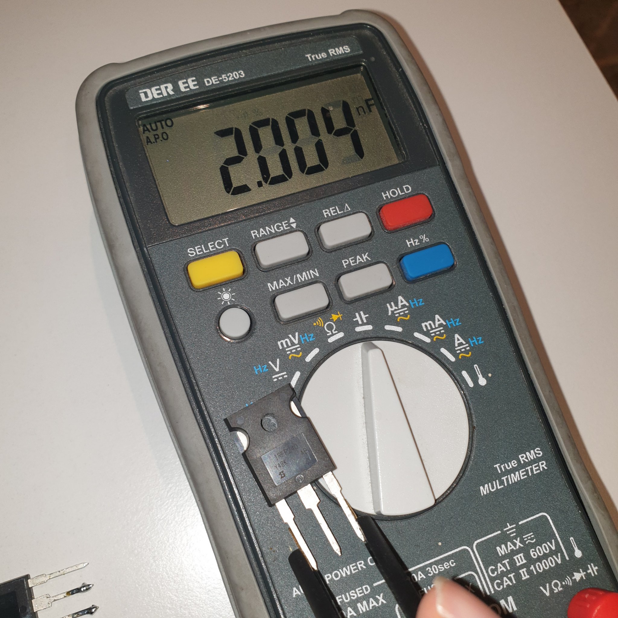

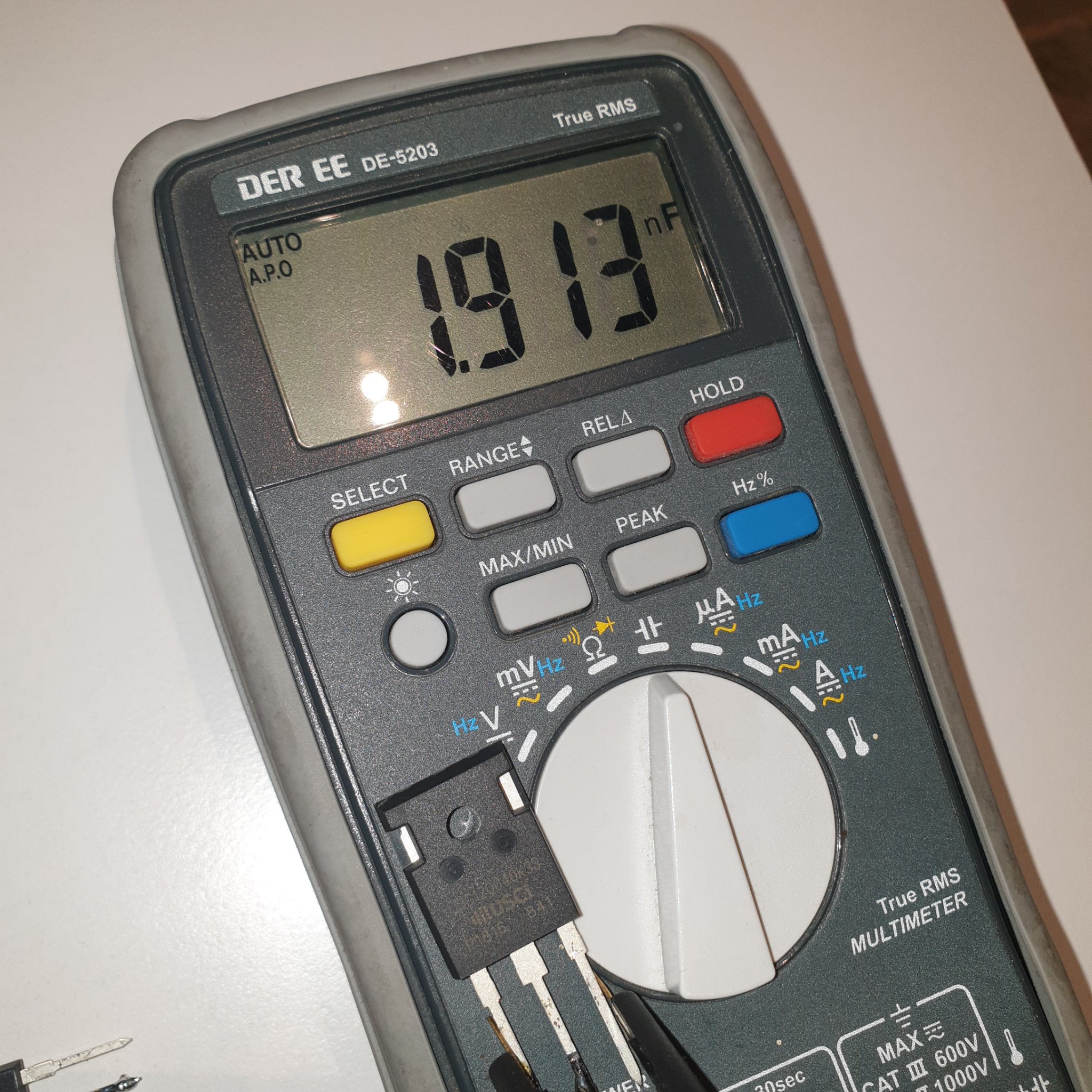

Sorry for poor circuit picture
I am not sure capacitance of GS can be measured like that but it may give an idea maybe. UJ3C120040K3S gs capacity seems about 5% lower than IRFP240.And power is about 3x of IRFP240 according to datasheets

Datasheet for UJ3C120040K3S - it's a cascoded SIC fet but normally off device (enhancement), not depletion so not candidate for DEF
UnitedSIC Datasheet - UJ3C120040K3S
Expected Vgs(th) is between 5V (range from 4-6).
