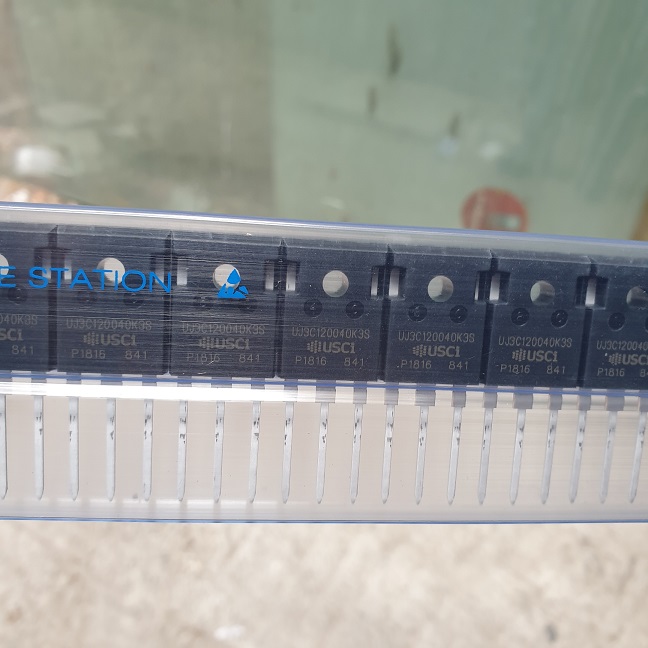

Hi.I have found some Sic mosfets UJ3C120040K3S from local distributor.Can they be used for audio? J2 amp maybe? Any advantages over IRFP240? Maybe i can use a pair of them instead of 2 pairs of IRFP240?

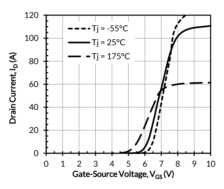

it seems as Treshold Ugs (p.5) is in range of 5V, so smidfe higher than usual mosfets
also SOA graph (Fig. 17) is showing that part is good for DC, our normal range of currents and voltages

They have a high price in Mouser/Digikey.I have already bought them in a good price.Is it worth to build amp with them,any advantages? Or should i sell them?Regards
The SOA looks good but there is no transconductance information. How good is your price? 🙂
Look at it this way - if you figure out they can be used to build amps with AND they sound good and measure well, you can get better $ perhaps.

Hi.Mark on ACA forum wrote:
""Because their transconductance dIout/dVin is not constant unless Iout > 10 amperes, which is well outside the range of standard bias currents in audio gear, and well outside the range of standard heat dissipation capability of audio enclosures. It's laughably beyond the max possible current of the ACA power supply and howlingly beyond the max possible dissipation of the ACA heatsinks and chassis.
Here's the transconductance plot from the manufacturer's datasheet ""
that's academic until real test
