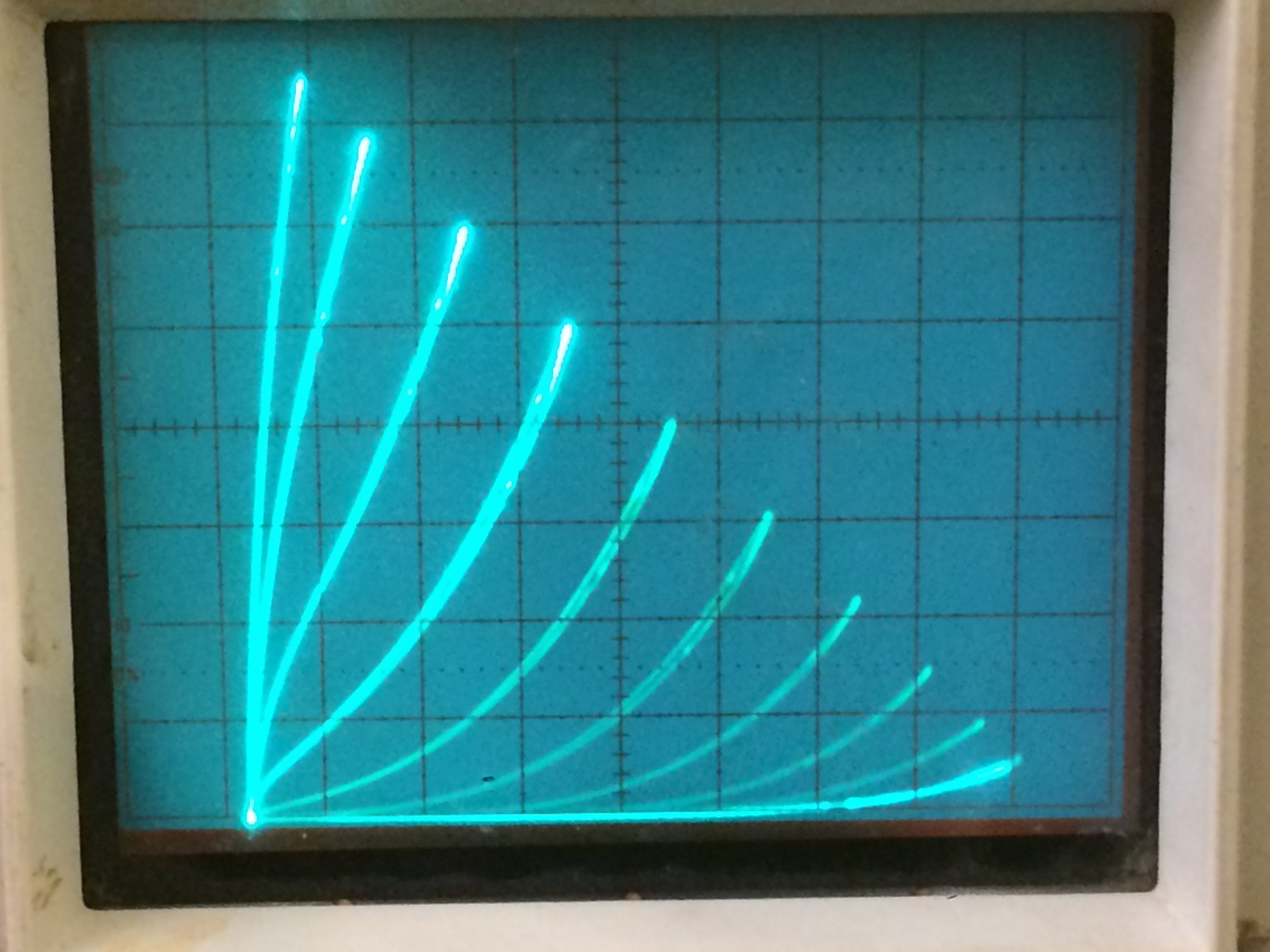

I have been reading the excellent thread by wrenchone in which he talks about Schade feedback. Out of curiosity I built the little IRFP240 example Schade circuit that consists of a 10K feedback resistor drain to gate with a 1K input resistor in series with the gate. I got almost exactly the same curves on my curve tracer that were pictured in the thread. I got to thinking that it is too bad that the input impedance is low ( equal to the input resistor I think), so I thought I would try a similar circuit with one of my C2M1000170D low capacitance SiCMosfets. Since the capacitance is about a factor of ten lower, I figured I could get away with increasing the resistor values by ten also. So I built up the new version and hooked it up to the tracer. I think the curves are very interesting. Not as linear as the 240 curves and quite different in shape. The settings for the photo were as follows:
5 V per division horizontal
100 mA per division vertical
1 V per step gate drive
50 ohm load limiter
50 ohm load limiter
Initially i felt the curves are all for women but now even for the SIC Jfets...😛.
