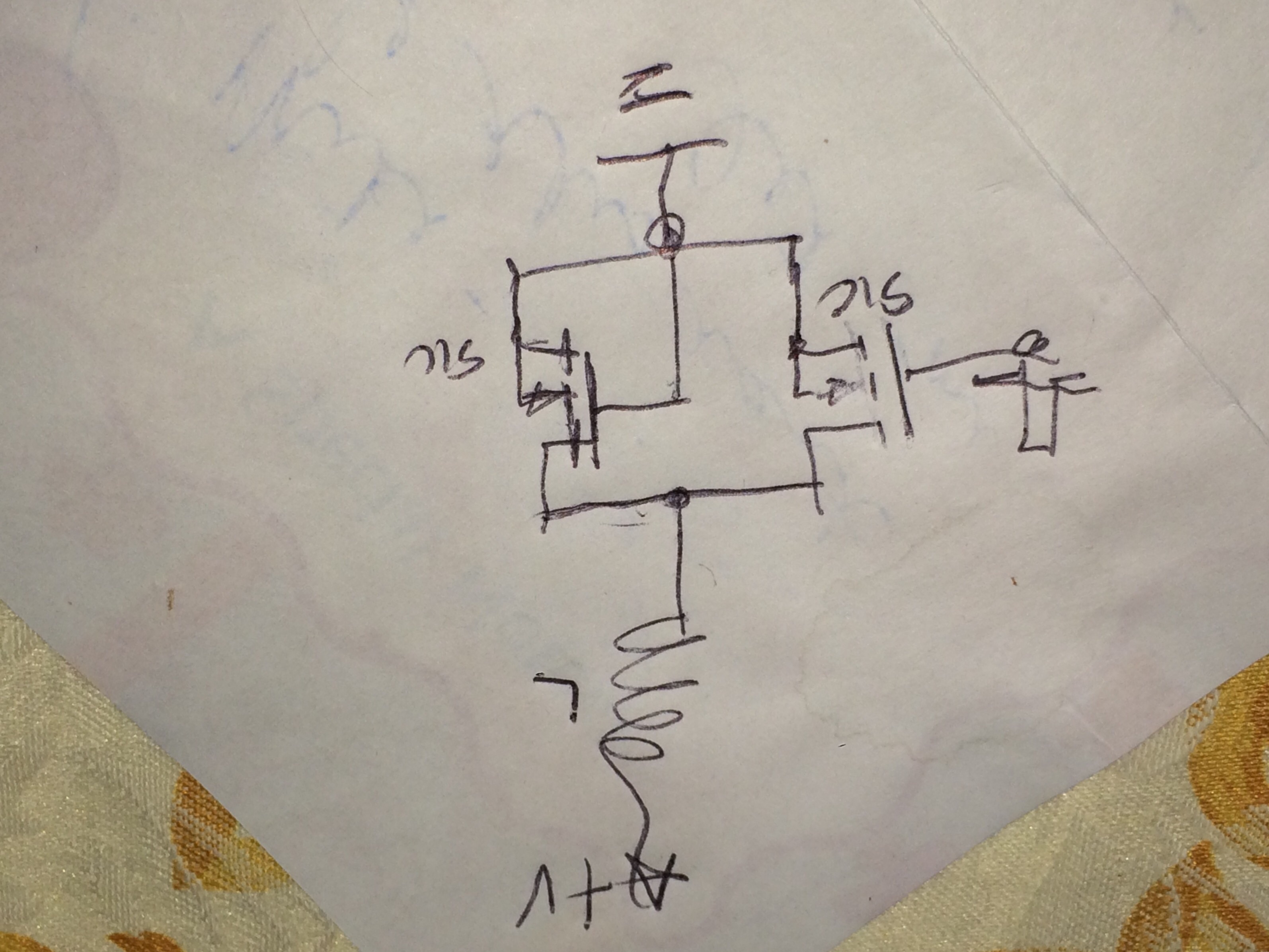

My interest is driven SICFET parallel with a permanently OFF silicon superjunction.
I actually want the most non-linear DS capacitance curve possible (IE: Infineon C7).
And a SICFET by itself just won't give that to me...
Goal is ZVSwitched audio. But the most non-linear Superjunction MOSFET I can buy
doesn't switch fast enough, and the fastest SICFET I can buy doesn't have enough
capacitance for soft turn-off. Adding more linear capacitance aggravates cap discharge
losses at turn-on, or necessitates leaky transformer aggravating turn-off. Thus I want
most severe C(TR)/C(ER) as my figure of merit. Most voltage rise time delay for least
stored energy at full charge.
I think parallel of these dissimilar FETS might achieve it. Also offers the silicon clamp
voltage -0.7V rather than SIC -4V. Zero voltage switching is a misnomer that should
be called "Negative Zero Point Seven Volt Switching". Not worried the Silicon body
diode recovery, because that freewheel diode is shorted into recovery by the driven
SICFET long before freewheeling ends.
Just a little weird that I want a Silicon Superjuction, only to wire it OFF and abuse
as high voltage non-linear cap and diode. This is not behavior any sane individual
would want in a normal audio amp.

The silicon superjunction is shorted gate to source, permanently OFF.
Only the SICFET gate is driven, drain and source otherwise in parallel.
Both types offer similar RDSon. Both in parallel tempts twice conductive.
But they want considerably different gate voltages and timing, and the
Si could only come into play for a small part of the longest duty cycles.
Not so much return for the added effort of driving it, just leave it off...
I just need to trap SICFET drain to a reasonably low voltage till the gate
has been driven completely off. Remember an inductor is hammering this
drain with stored current and trying to shoot voltage to the other rail.
Which is exactly what I do want, just not right away...
The superjunction drain can absorb 5uJ into many nanofarads below 20V.
Above this knee, capacitance drops to a hunded picos or so. Very similar
energy storage to SIC, but the curve of the voltage rise is way different
and very usefully delayed at the low end.
A linear capacitor might allow soft turn-off, but stores too much energy.
Need more inductor for soft turn-on. Need more cap for soft turn-off.
Its not endless, you eventually do win for both edges. But resonating
so slowly you didn't gain any switching rate, what was the point???
A nonlinear capacitor offers a way out of that dilemma while staying fast.
They don't make or sell such a non-linear capcitor, except they do, and
its called a Silicon Superjunction MOSFET.

Well, it didn't start as an audio project. Plan was 2KW inverter
for Google Littlebox Contest. But I blew the deadline to have it
all working and documented... Can make any waveform, so why
not an audio amp? Most of it is still in simulations, aside from all
the magnetic cores I've glued up and wound and measured in
attempt to train myself the mysterious black art of magnetics.
Only then to discover I had to train up from complete ignorance
about soft switching. It was contest requirement 95% efficiency
at all loads that could not be realized with ordinary hard switching.
Not even with Cree's best, or any of the GAN from unmentionable
sources that was teased my way but never delivered. I had to
build my own unobtanium from whatever Digikey had in stock,
thus the wacky plan to combine Cree SIC with Infineon C7...
2KW sine into a resistor varies from 0W to 4KW at any instant.
Just about impossible to assure ZVS over such a huge load range.
So, yeah. I was massively late getting a viable plan together...

Yes. H bridge of four units such as you drew.
The choke is center tapped. Ask me why in another thread.

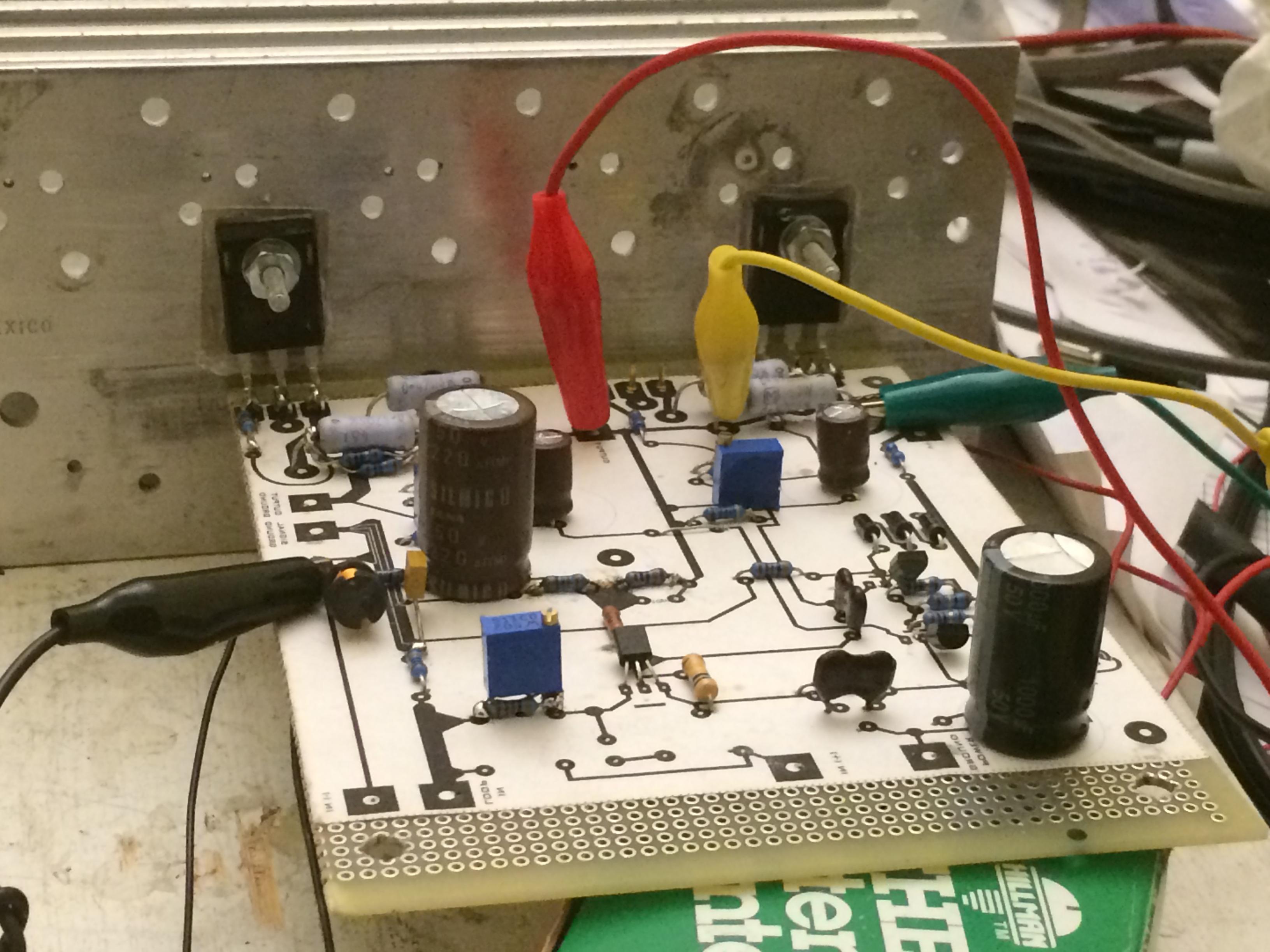

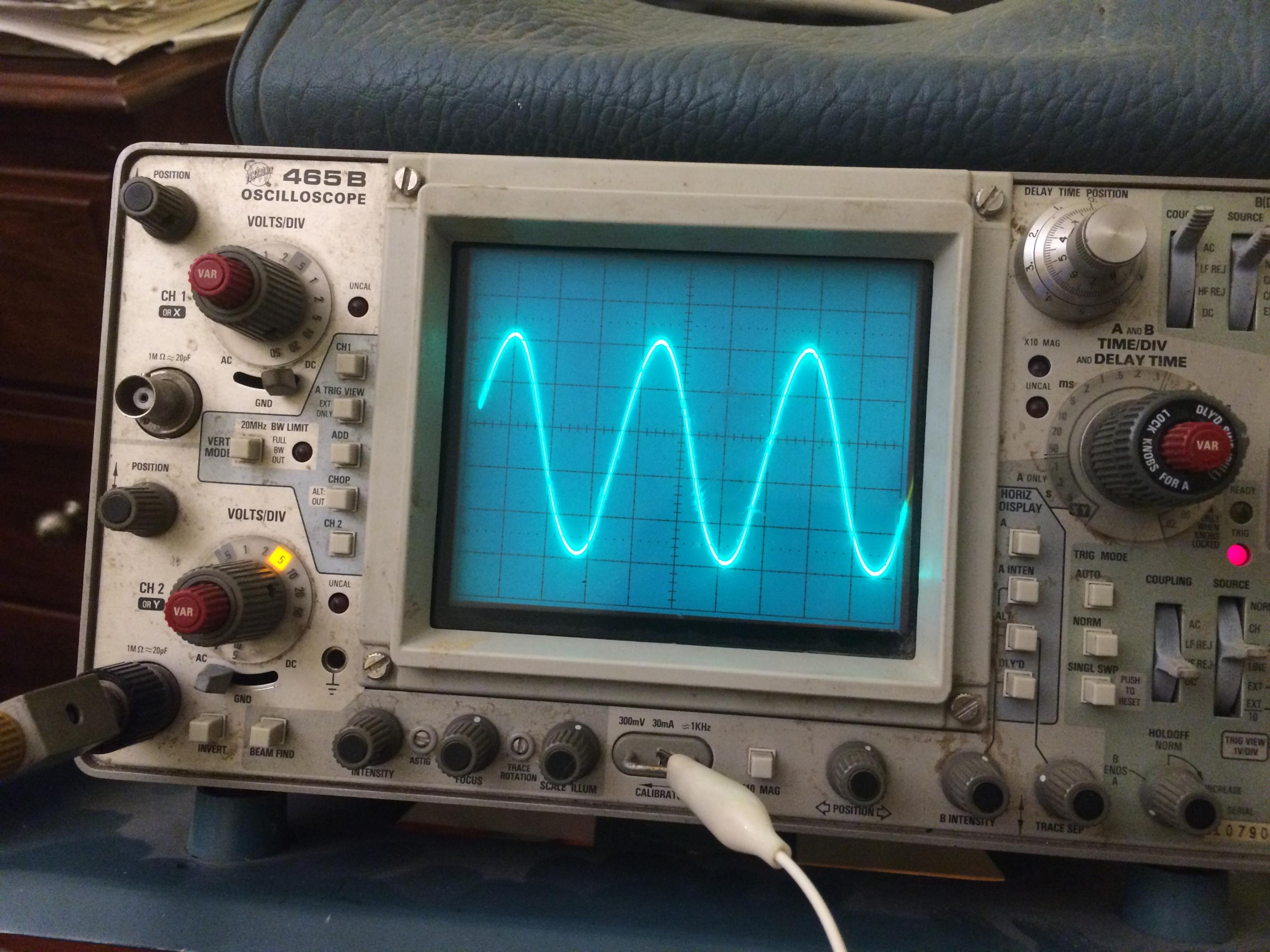

I finally got around to building an audio amplifier with the CREE C2M1000170D SIC mosfets.
Only on the bench so far, driven by my sine generator, but they bias up like a dream and look great on my scope. The photos are of the output of a 30 volt peak to peak 20 kiloHertz sine wave, a 3 volt 1 kiloHz square wave, and the circuit in action. The 150 kHz sine is down about 12 percent from flat response portion of bandwidth. I was worried that the low capacitance of these devices would be a problem for me in this circuit, but it is very stable. Bias is rock steady after warm up stabilization. I'm relieved and very happy they are out of their tube and in operation.
