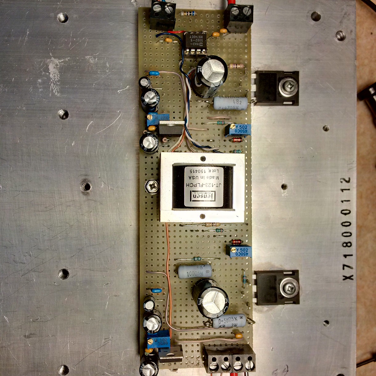

OK Ladies and gentlemen the results are in for the Cree C2M0160120D versus the IRFP240 used in a partly built F6.
I'm using an HA5002 high speed buffer chip as the front end instead of the matched JFET's driving the Jensen transformer and slightly higher supply voltages +-29VDC as I had access to a large dual secondary 24VAC 1500
va transformer. I have been using this power supply and heatsink with the IRFP240's for a couple of months now and it has been rock solid Bias and zero offset and it sounds fantastic.
I have been running about 1.1 to 1.2 AMP bias and as you can see in the picture the same for the Cree's.

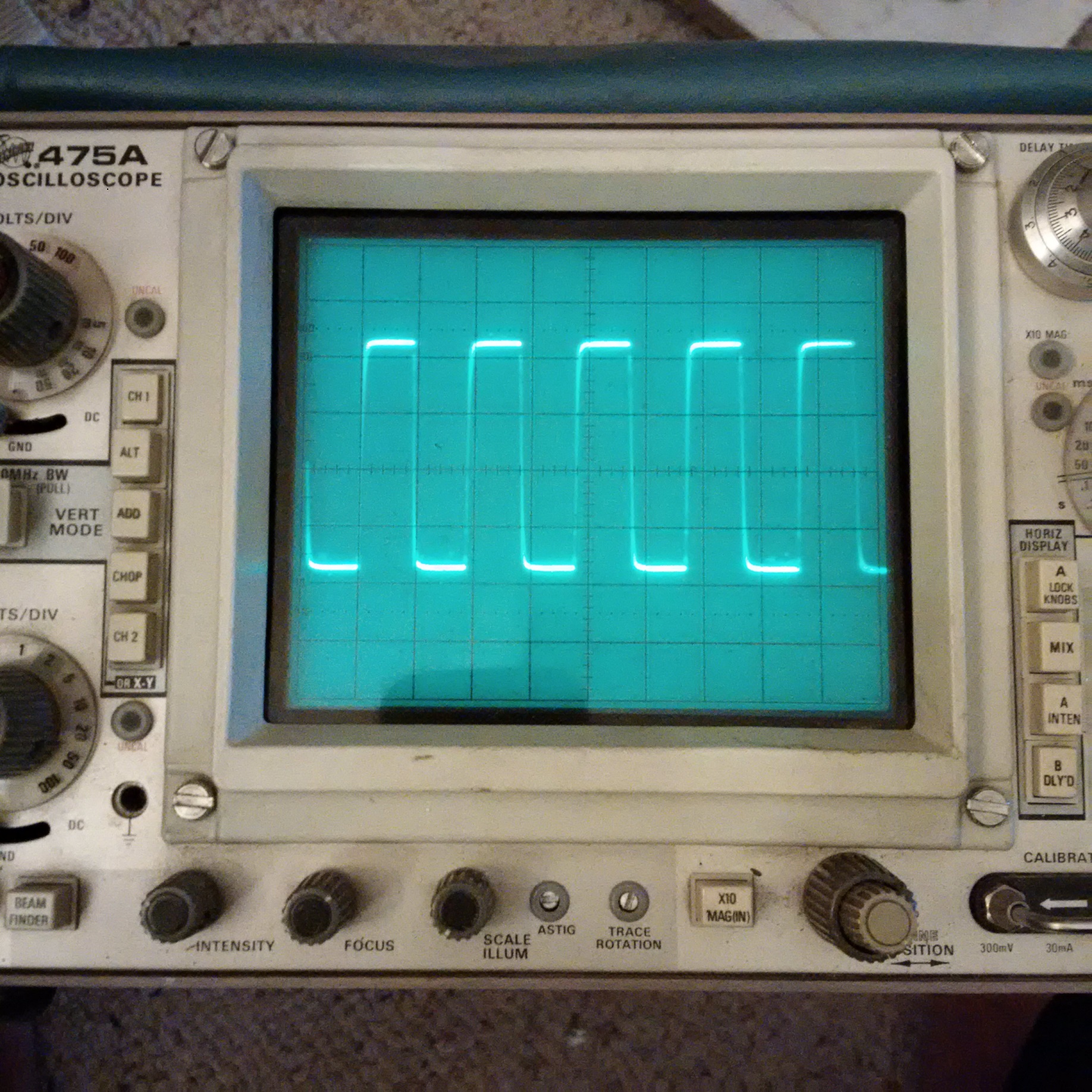

The next is the IRFP240 with a square wave at approx 5KHz as Nelson had shown in the F6 article.

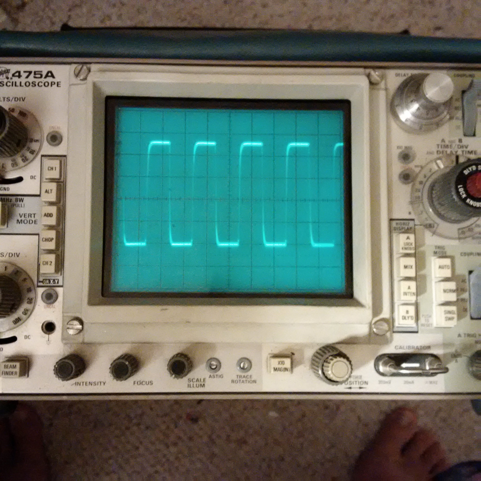

The next is the same but with the Cree.
Unfortunately there is not much difference very slight less rounding on the leading edge but I can only put this down to the Jensen and the associated circuitry as the spec's for the Cree are at least a 1/3rd input capacitance. I think that other amplifier topologies might be better suited for this device. One thing of interest to the tube crowd looking at the curve traces on the previous posts and when the triangle wave was driven into hard clipping it formed a beautiful sine wave much more so than the IRFP240 it just flat topped.

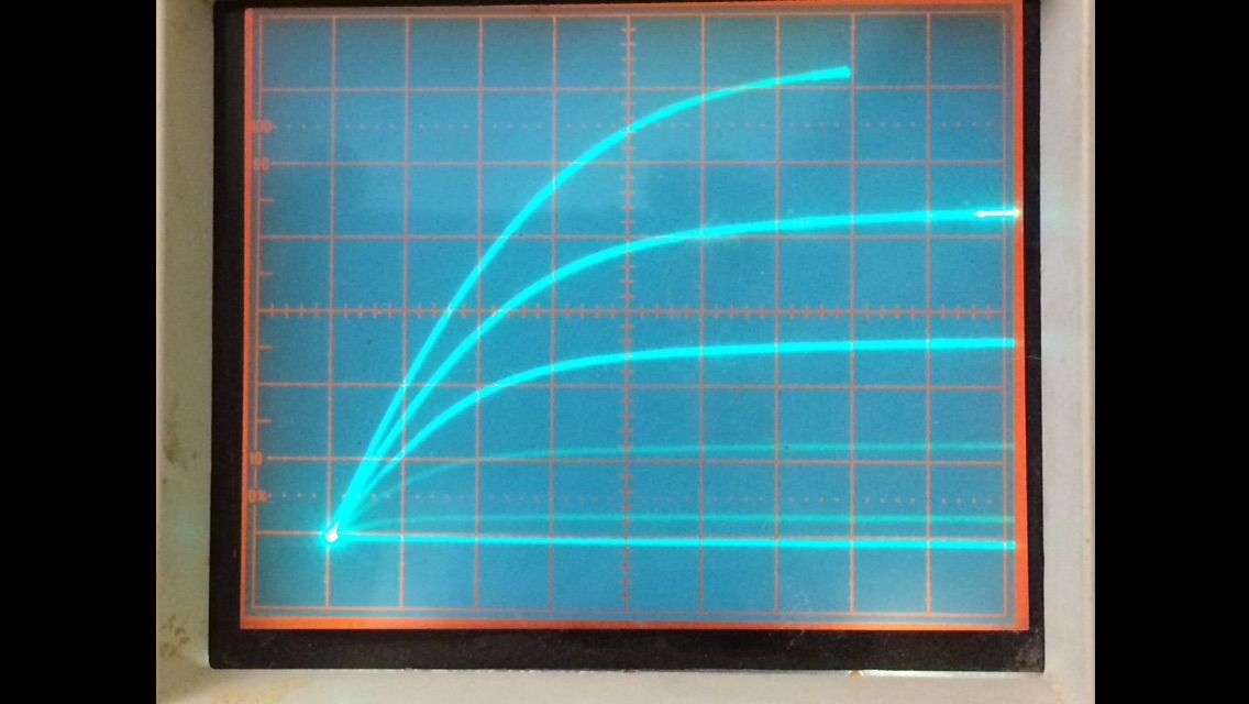

The SiC curve looked really familiar. Here are the curves for
a 2SK170 compared to the Cree 1700 volt part. Many similarities in shape and distribution (at least to my eyes). By the way I forgot to mention that I used the 10 ohm drain resistor load to make the Cree curve set. So as I understand it the end points of the curves describe a 10 ohm load line.

This one is for the Cree

I think there is a significant difference in the square wave comparison. To me it looks like your bandwidth has increased. Can your audio generator be swept higher? If you could increase it to the point where the square wave becomes a sine wave, that would give you an idea of the bandwidth.
Also very interesting that the overload characteristics are graceful rather than abrupt. I bet that it sounds much less bad when overdriven than the IRFP240 version.

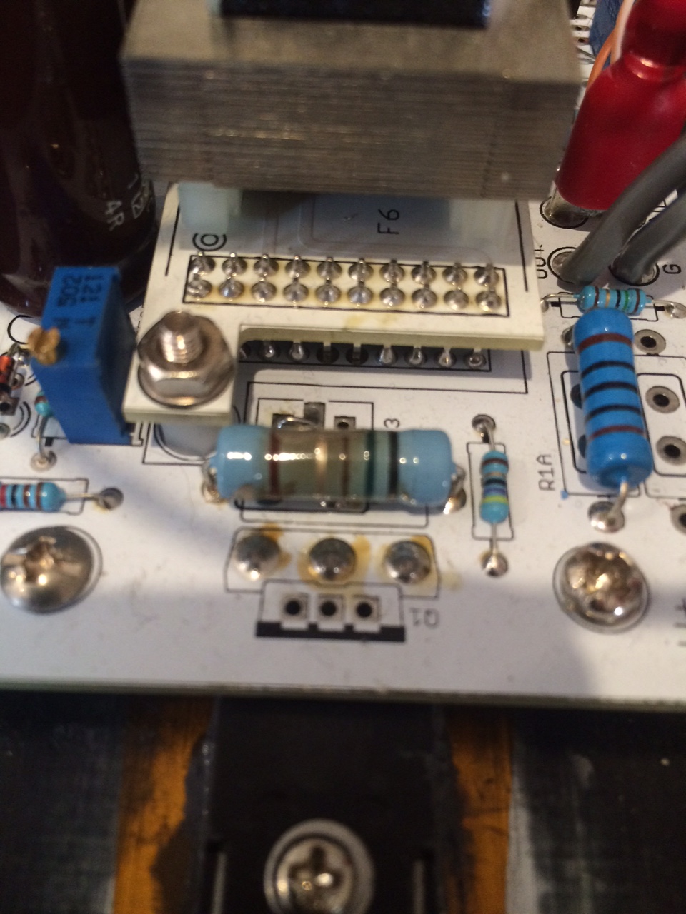

Hi asbrinv I would love to hear about you experience with the biasing maybe I got lucky or it is just a very clever simple design. Wait a minute it is a clever simple design!🙂🙂
No major issues - I was just impatient when I built it originally. I used a single turn trimmer for the bias and offset and given the zener i used was 10V the range of adjustment on the trimmer was tiny/touchy. I stripped the whole build back yesterday and changed the trimmers to multi turn parts so I should be all good now.
Burn Burn Burn
...or not, perhaps. I used a value of 0R68 for R1 (instead of the listed 0R56) mainly because thats what I had on hand at the time.
Unfortunately, after biasing up to about 1.7A it now looks like the below.
Guess I'll need to replace that wee guy as well 😱

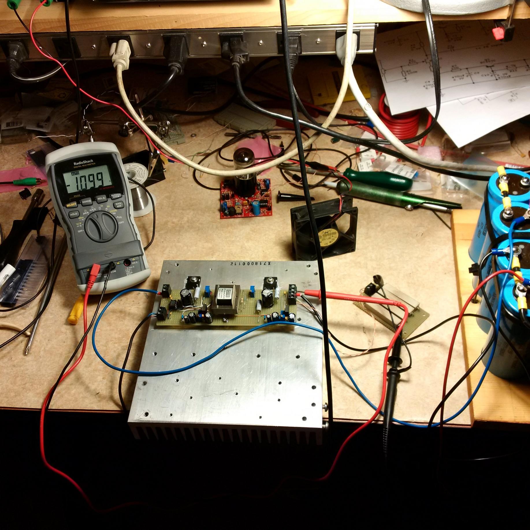

Formantjim,Here is my current test bed F6 with the HA5002 front end driving the Jensen with a 47ohm in series to limit the current. This is using the Cree SiC FET's bias 1.2Amps.
Very nice testbed! Are you still liking the Cree sound??
Thanks for the picture, and for keeping us in the loop.
