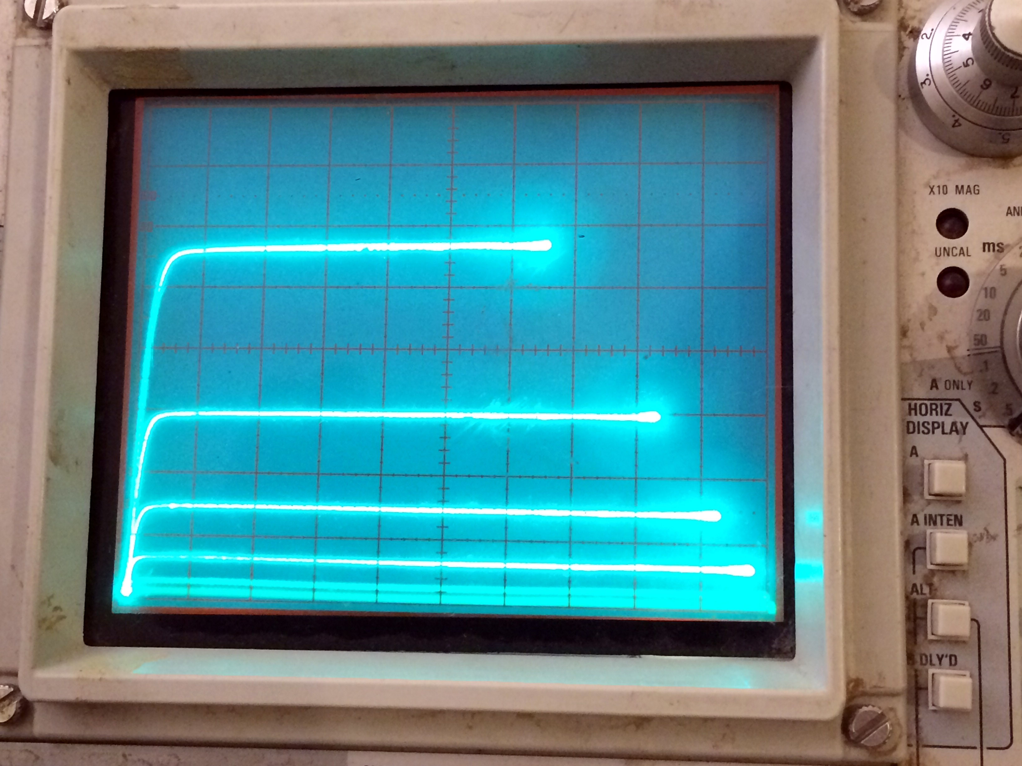

Package arrived. Mosfets put onto curve tracer and I compared the curves to one of the venerable IRFP 240's. Photos attached. The first is the 240. Much higher transconductance (expected) and pentode shape curve. Ma imum vGS of sweep was 20 volts. Horizontal was 2 volts per cm. Vertical was 100mA per cm .

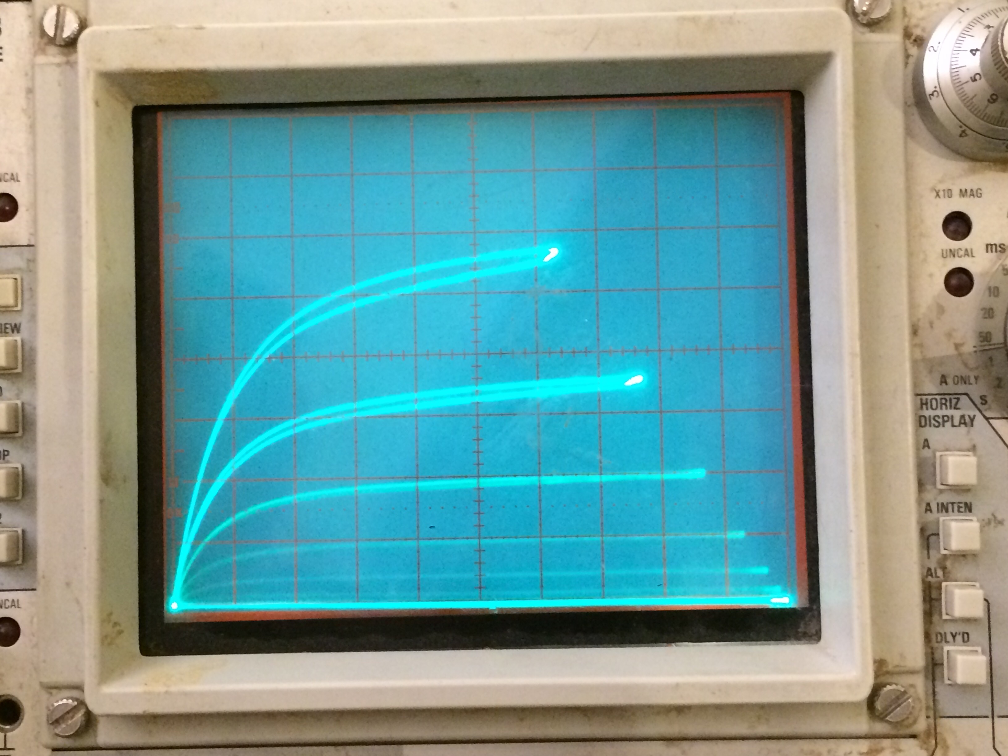

Second curves were from 1700 volt Cree SIC mosfet. Same settings except for gate drive voltage was higher to put in same current range. Very different shape.
Nice work mate. Is there anyway for you to plot the results in an excel graph and post up.
Not quite sure how to do that! I will try to figure it out ....Nice work mate. Is there anyway for you to plot the results in an excel graph and post up.
That would be very informative if you can do it. If not then no worries.
All good, and thanks for posting them.

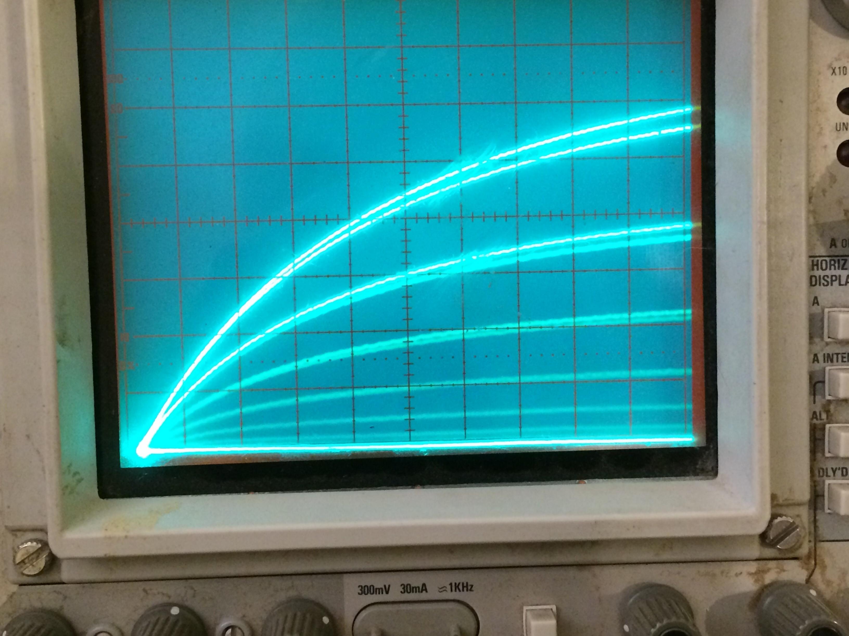

Here is a zoom of the low voltage triode region. Horizontal scale Is 0.5 volts per division.
