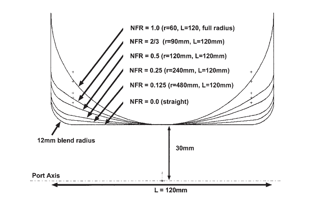

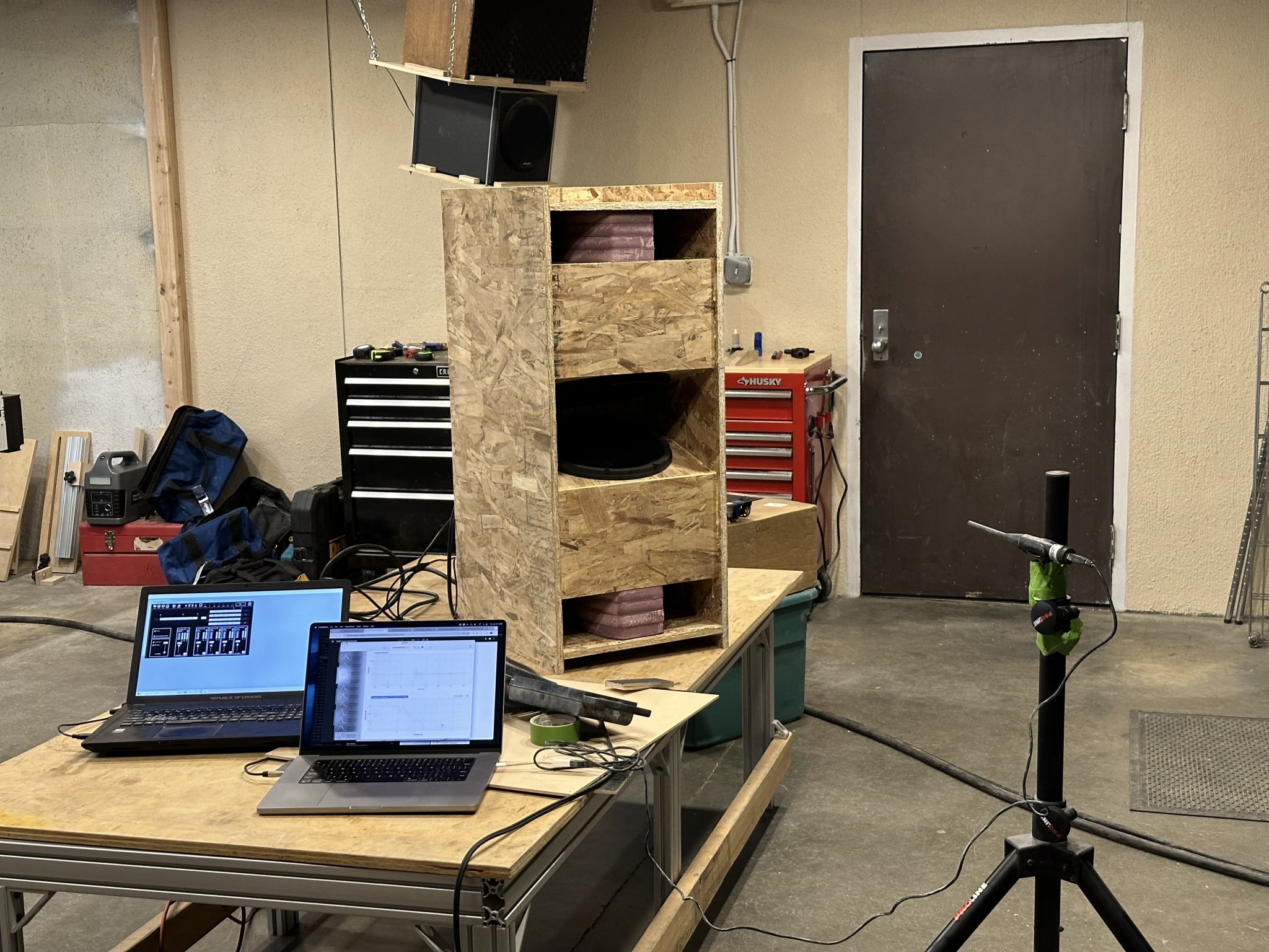

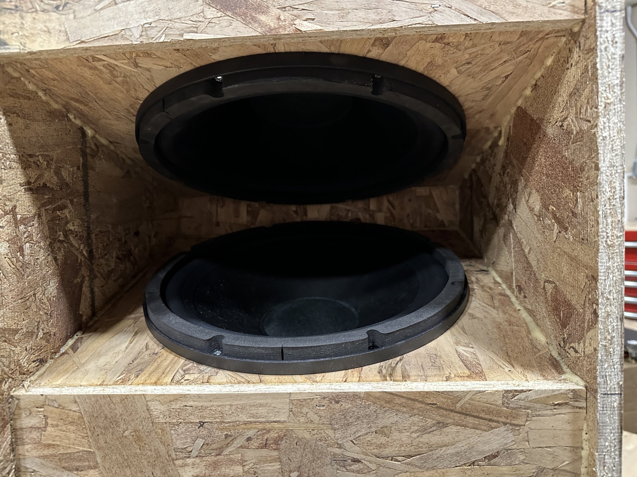

Just received two of the 12RS430's and are currently prototyping a V-configuration BR box with a roughly ~3.4 L volume. We are playing around with Aero-ports for the first time, so still getting our box tuning figured out. Our ambition is to have a configuration that is tuned to 40Hz at higher SLP's but can extend down to ~30hz with port extenders. A bridged Pascal S-Pro2 amp powers each driver. Just got them mounted and making sound last weekend and am excited to see what they can do!
It's tough to see the ports, but we are using CNC-cut pink foam inside of them. The sides of the box are removable which allows us to chop away or add foam to change port dimensions fairly easily. Not sure if you all have seen some of the white papers floating around about these port styles but I am eager to see how they perform (we chose the NFR=0.5 port shape pictured below).

Interesting port design ! Contrary to the usual flared ports these can be made without a 3d printer.

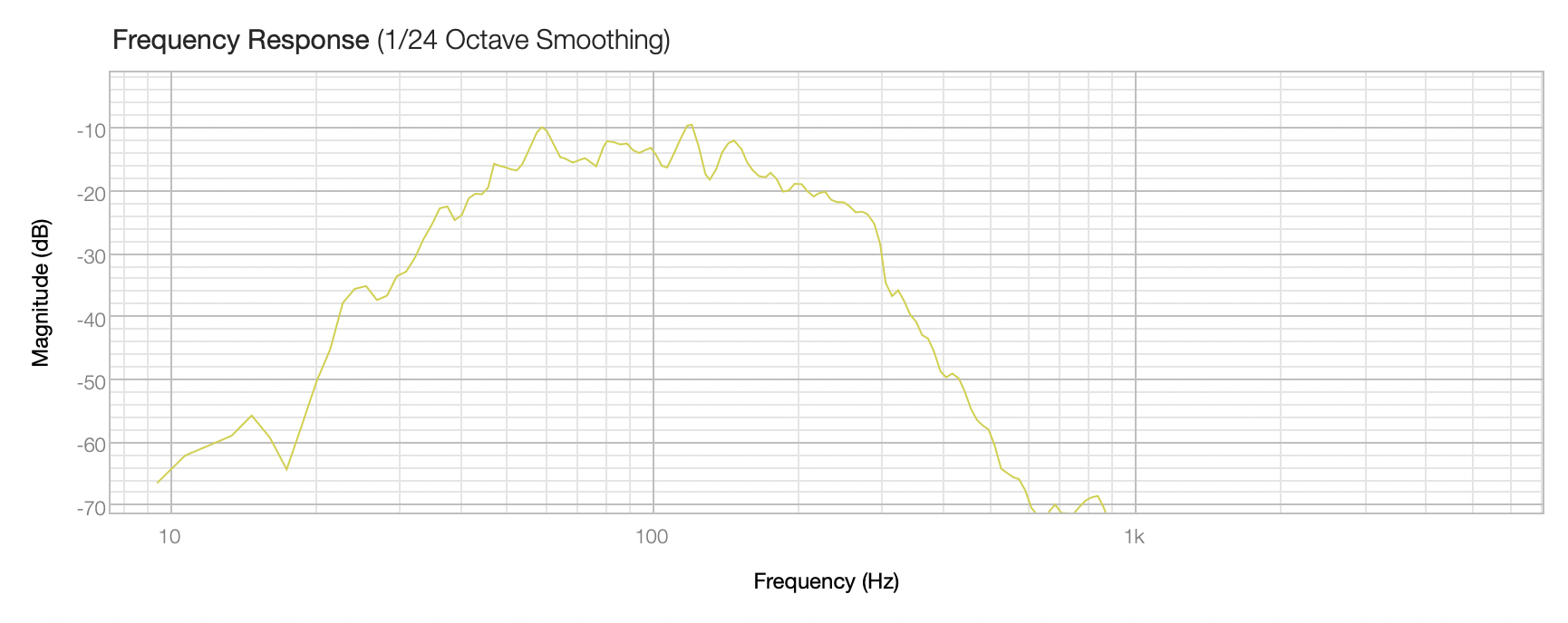

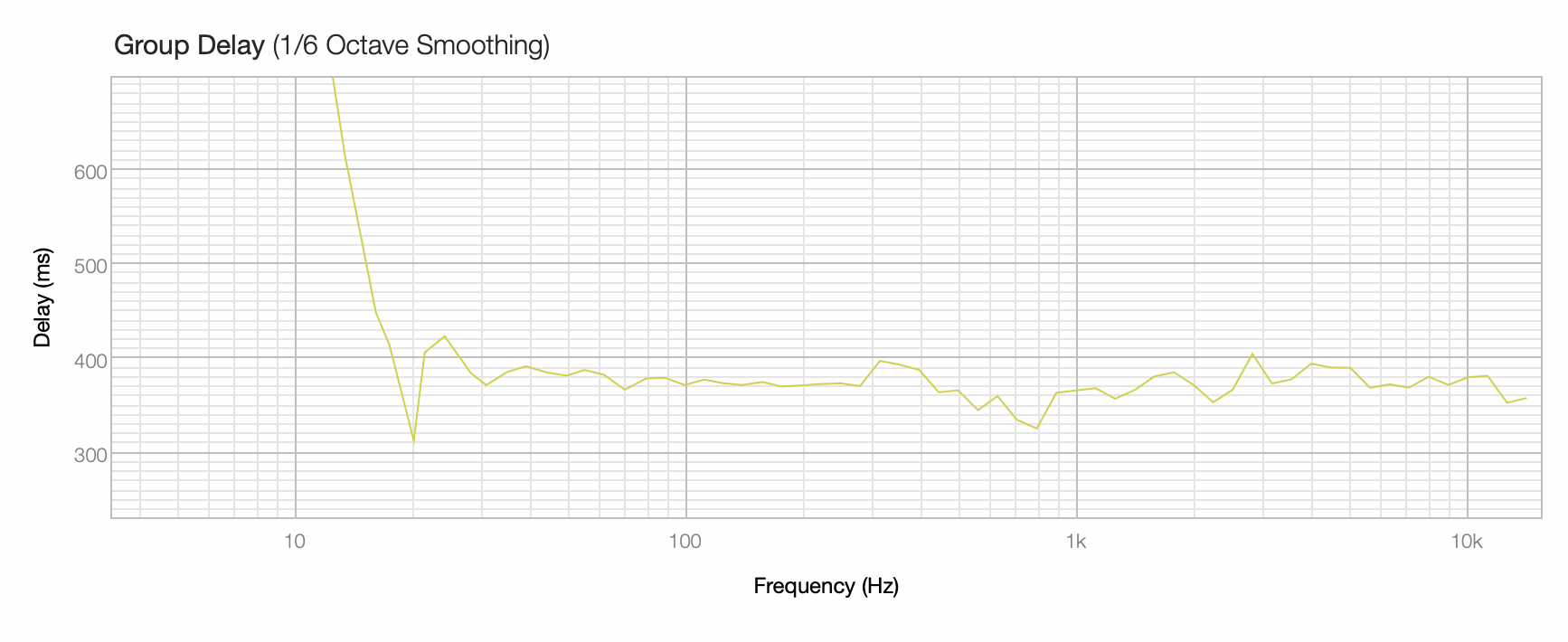

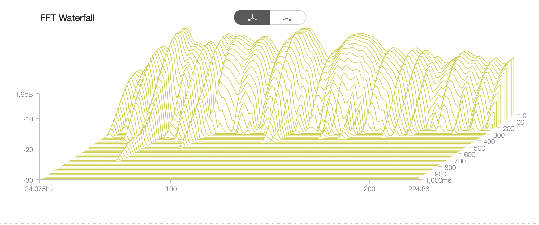

A few project updates:
The RS430 are pretty fun drivers so far. We put a lot of power through them last night and they nearly rattled our OSB prototype box to pieces. I could only get a couple of attachment screws into one of the drivers and I was genuinely worried about the woofer tearing out the wood. Our next design iteration will be ¾ BB ply with lots of bracing, threaded inserts and dado construction. We wanted to push them a little harder but the prototype box sounded like a 1994 Honda Civic with 7 million miles on it. I attached some test results below.
We are still refining the port tuning and will do some more tests soon. It's our first time working with this configuration so there is still a lot of trial and error. We started way oversized and have been removing layers of foam as we test. Does anyone have advice on modeling Aero-ports with extreme flare rates (NFR 0.5+) in WinISD or Hornresp? Our target is F3 @ ~40Hz, and then with some port extenders a target of F3 ~30Hz. We are still missing the mark on our port tunings so our next design move is to recut the flares and add some port length.

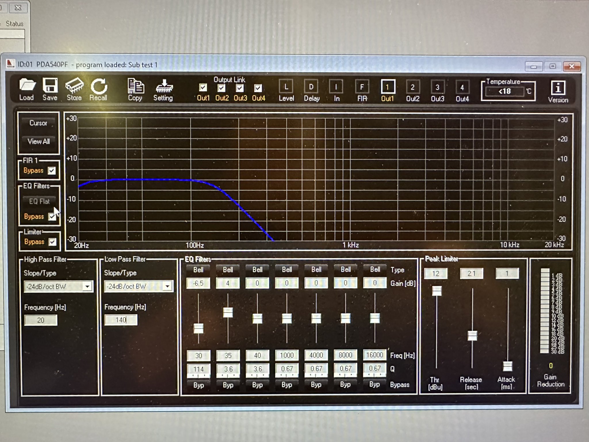

We will also keep you updated on how the results of using DSP PEQ low/high shelves with shallow slope BW crossovers -instead of steep crossovers- for the high pass filter works out. The goal is to increase LF output without greatly increasing group delay. I am trying to get accurate readings on group delay using FuzzMeasure, but I think the overall latency of the Marani DSP makes it a little difficult to understand the results.
So far I really like the V-Opposed woofers. I ran this sub nearly wide open and the cabinet movement was much lower than a classic BR box (minus the shoddy, rattling box construction).

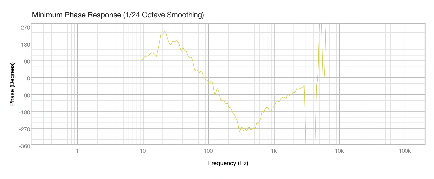

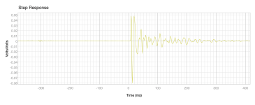

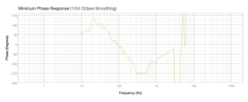

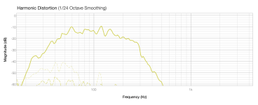

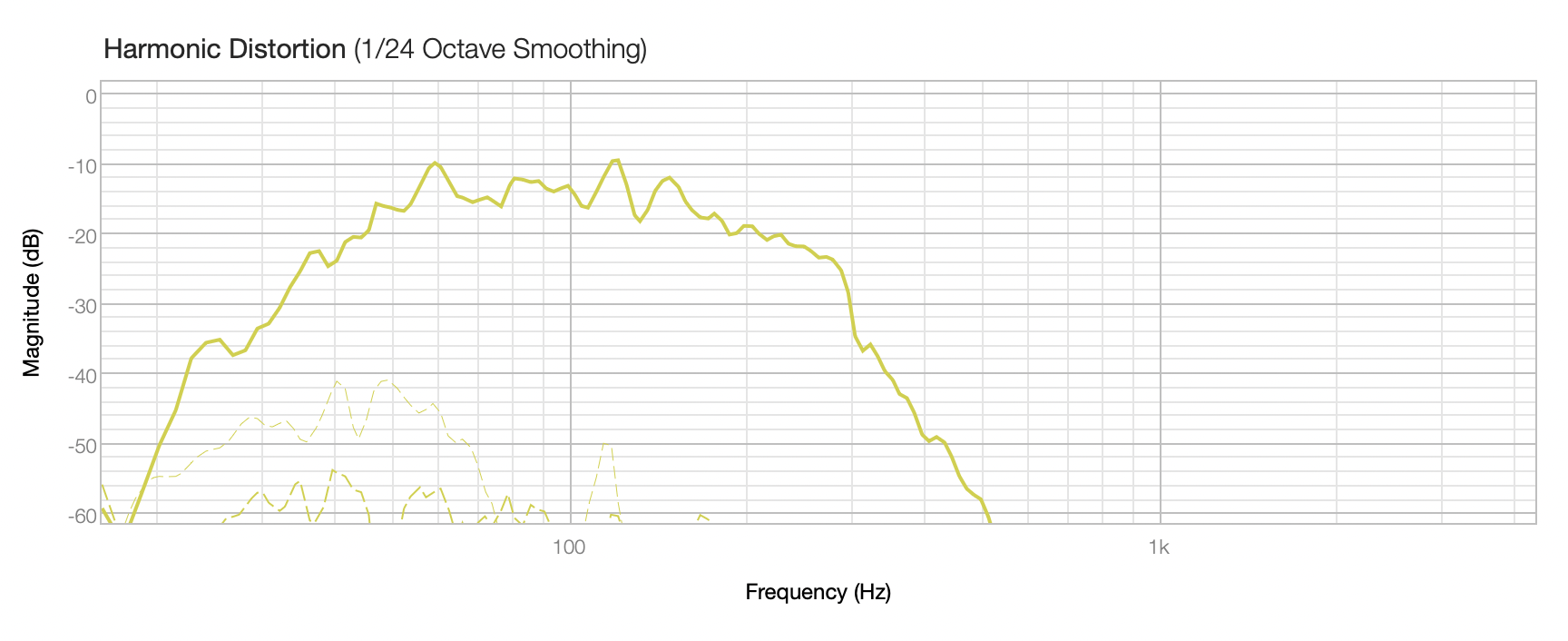

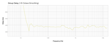

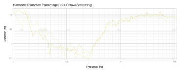

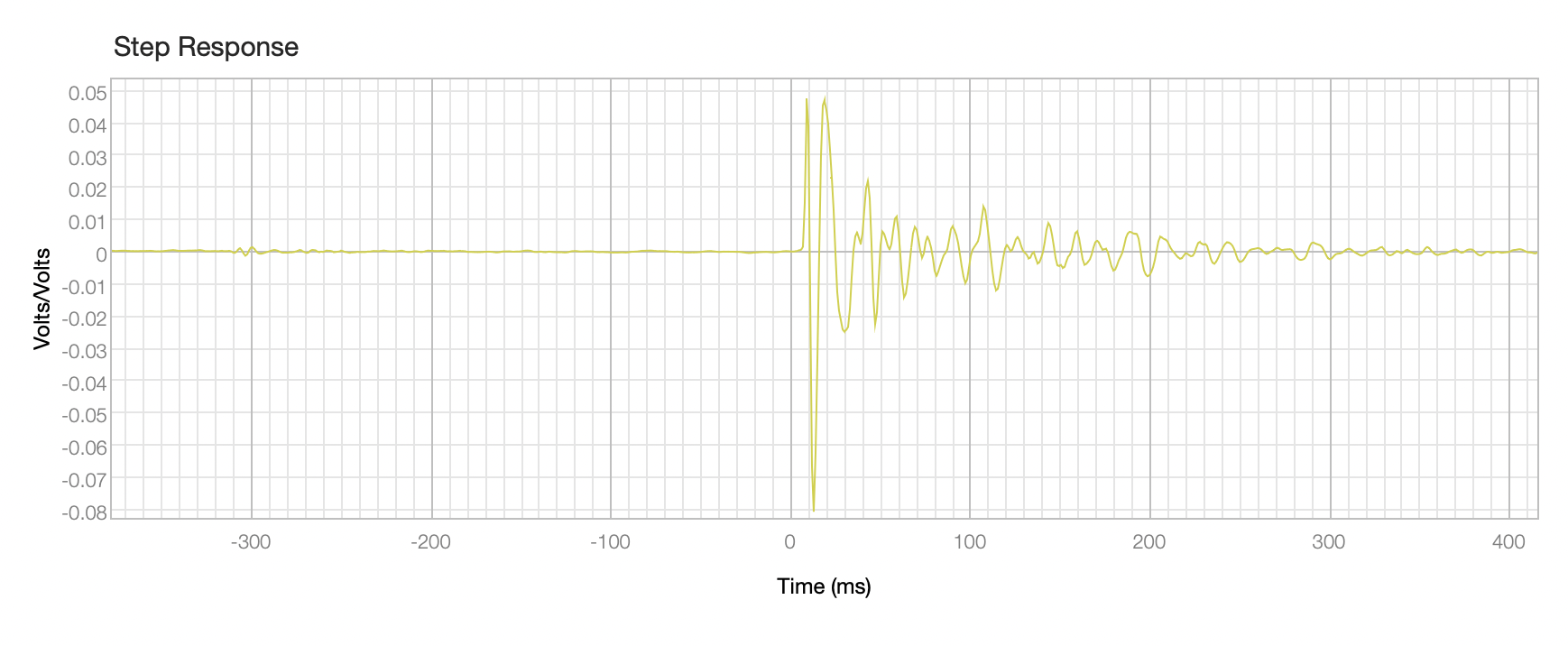

Anyway, here is a snapshot of our DSP settings along with some raw measured responses, with no EQ applied.
DSP: Marani
Measurement Mic: Dayton UMM-6
Software: FuzzMeasure V. 4.2.2 (39) on MacOS
DSP: Marani

I will post some results when we redo the ports on this enclosure.
I have REW, so I can also take some measurements using that, though I usually prefer FuzzMeausre just because it's so simple to use.
Once we are happy with our port tuning and box volume we will start on our final construction run.

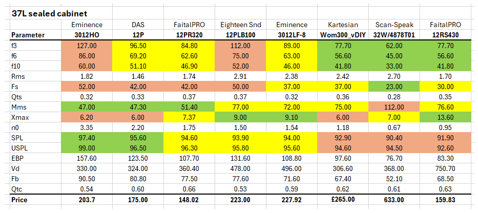

Price might be wrong, not checked. Here's a quick table comparing some 12" drivers for a 37L sealed cabinet, inlcuding the 12RS430.
$297 in the USA. No buenoHas anyone given these a go or know anyone who has?

The ScanSpeak 32W/4878T00 would have a 36mm long coil - +-14mm Xmax. Same price.Price might be wrong, not checked. Here's a quick table comparing some 12" drivers for a 37L sealed cabinet, inlcuding the 12RS430.
12RS430 only has 2,5" coil diameter, 30mm length and 8mm gap -> +-11mm (still impressive!) Most PA companies have a lot of "phantasie" in their Xmax definitions ... as much as half the gap length. Eminence Xmax is for sure also not correct. B&C 12PLB100 has 10mm gap and 23mm coil -> 6,5mm!

Scanspeak 32W is nearly 700 USD a piece here, not in the budget!The ScanSpeak 32W/4878T00 would have a 36mm long coil - +-14mm Xmax. Same price.
