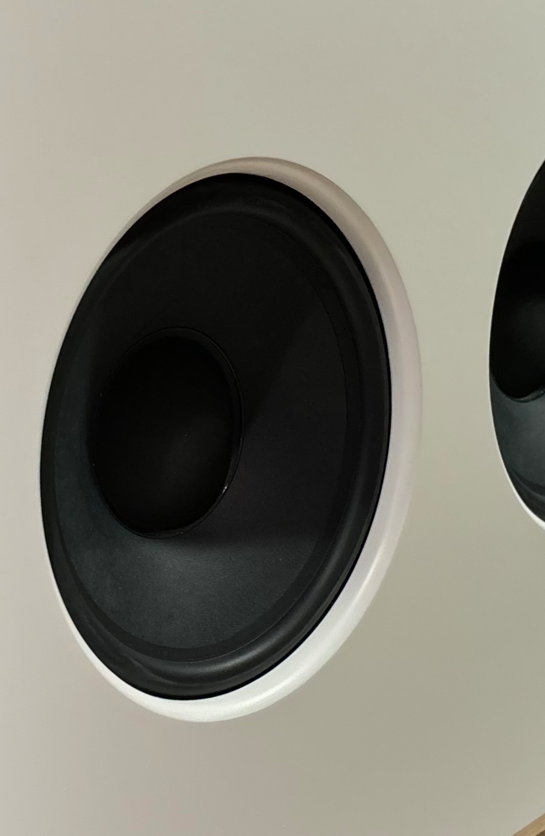

I agree with others on the front gasket design with these Faital drivers. The look of the cheap gasket really brings down the visual appeal. Alot of other brands do the same. It just looks like 💩.

Rear mounting solves that 😉The look of the cheap gasket really brings down the visual appeal.
I personally don't like the look of rear mounted LF drivers. Its just looks less "refined" to me. Its also harder to access the drivers from the inside of the enclosure, so you need some form of removeable rear panel. This sacrifices enclosure rigidity among other things. Lastly, you lose a little enclosure volume, depending on how critical that is to your design.
Sure. Anyone can cut a sloppy hole in some wood. It takes some time and experience to do a nice clean round over. Plus I think looking at bolts is less refined.refined" to me. It’s also harder to access the drivers from the inside of the enclosure, so you need some form of removeable rear panel. This sacrifices enclosure rigidity among other things
Everything can present problems when you don’t know what you’re doing.

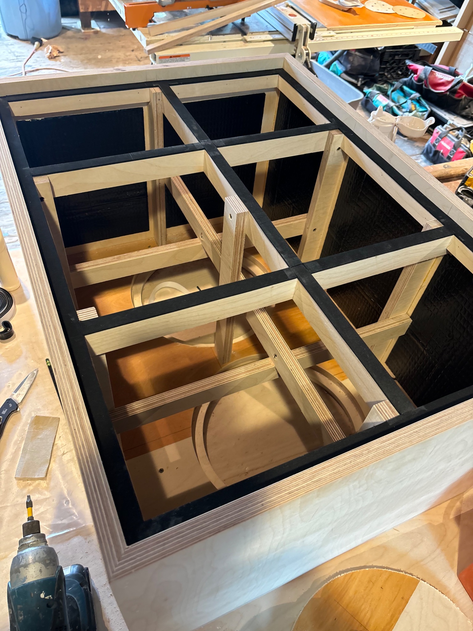

@camrector Care to share how you've attached the woofer to the front baffle ?
I've used threaded inserts before but depending on the length of the insert and thickness of the baffle - that can be an issue. It always forced me to make thicker front baffle than i really needed to.
Doubling up on the front baffle is always a good move.Care to share how you've attached the woofer to the front baffle
So this being 36mm sinking .75in screws is a breeze. Requires a right angle extension in spots to navigate the bracing
