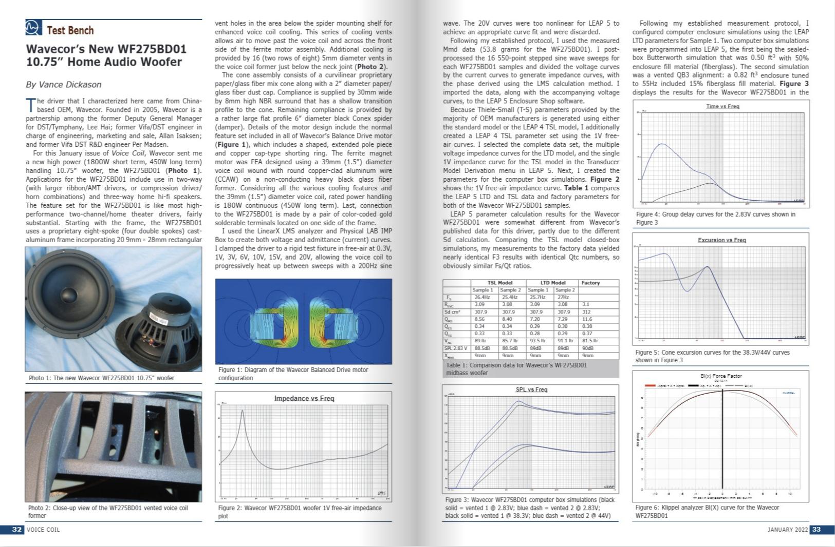

Indeed, that appears to be yet another Audioexpress transcription error. They really need an editor... I read the review in the magazine, didn't notice this. Here's the proper dataWhen checking that Audioxpress review, there obviously is something wrong. That review is not about the WF275BD01 (Sd 72.4 sq cm????)
