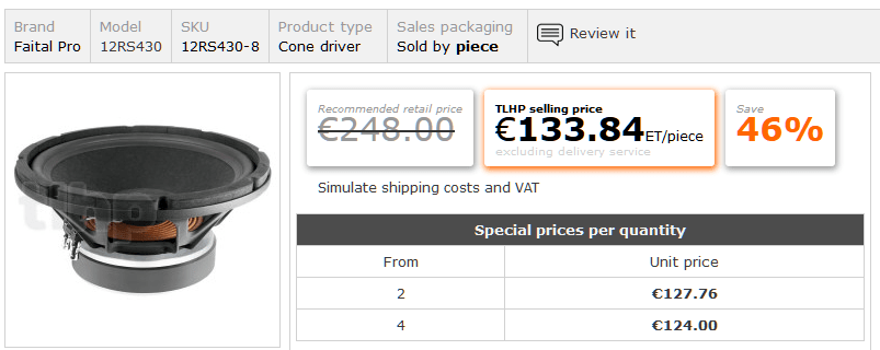

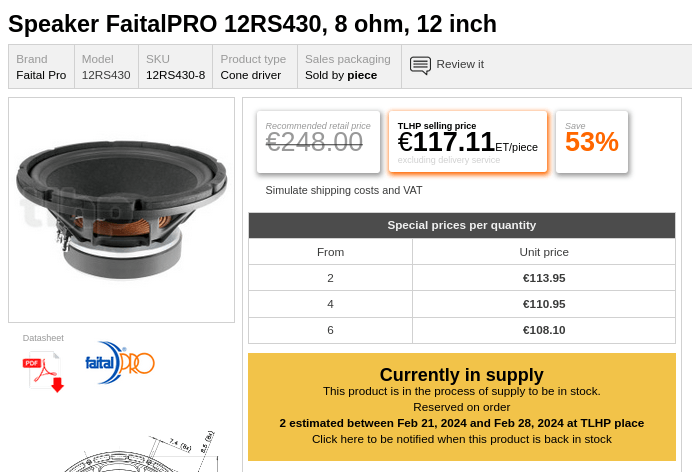

price in Europe (no VAT)
@duvixan: these are prices based on having a commercial account at TLHP, VAT excluded.
I can buy them on this basis, but private customers can not. View attachment 1246986
@daanve I need QTY=8 for my project, and I am definitely not going to pay US$300 each from PE. What are the requirements to get a commercial account? If someone can help me out, feel free to PM me.
