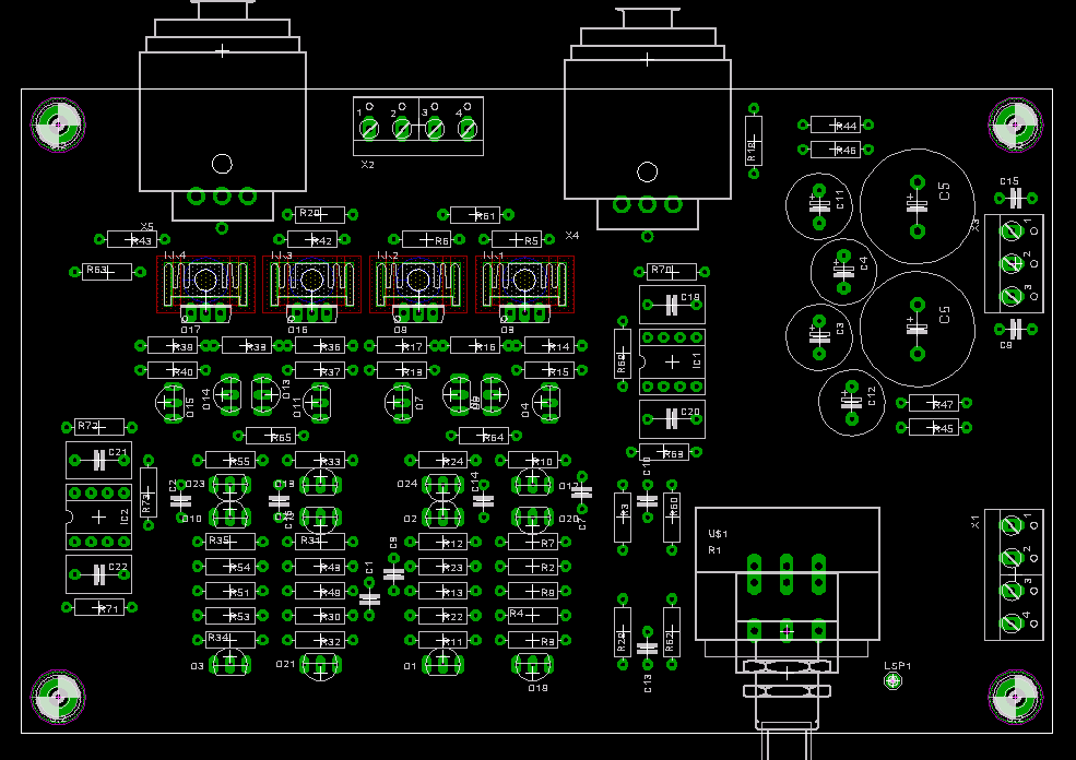

finally i have finished to construc the first dispre. with my own layout.
fisrt i test with my DX Vanilla.😀
I like the sound!
i use 50K pot, because only that value, i can get a GOOD pot. is the value make the pre-amp not stable?
why the pot should 5K or 10K?
tomorrow i will test it with my Symasym and Lynx3.0 too.
Thank's Pavel to share the Schematic.

Stability would not be any issue, but you load it by 10k of R10 and R26:

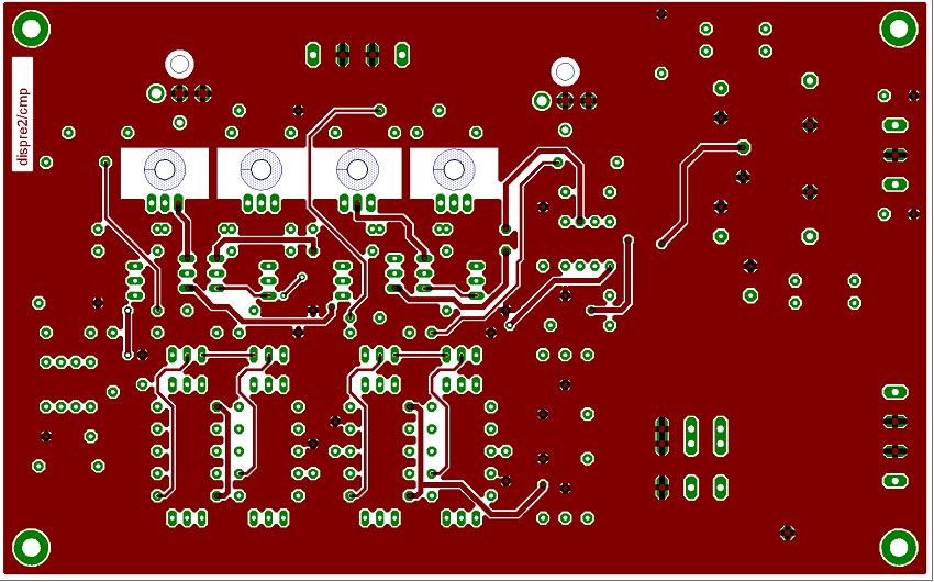

Yes. The produced PCB will be assembled and completely tested about mid June. Then 1st series (already sold out) will follow, and I guess that at the end of July the PCBs should be available.
A possible error in the design and pcb: Shouldn't Q4 and Q7 have emitter resistors? Now the output stage will run in class B or at least have very little bias. The output stage will also be very sensistive against temperature changes. I'll suggest 10-22 ohms and R11, R11 maybe 2.2 ohms.
No, you are wrong. The output stage runs in class A, at some 12mA. Also, the resistor values actually used have never been shown.
Anyway, thank you for your concern.
based on that 12mA of output bias, I agree with Peranders that emitter resistors between 10r to 22r are required for Q4 & Q7.
I just calculated 14r for the output stage to achieve that bias.
What Vbe are necessary on Q4, 6, 7 & 8 to achieve 12mA of ClassA bias without using these extra emitter resistors?
Guys, I have a simulation, I have a working sample built that corresponds to simulation. You are just guessing.
Think about Vbe voltages and their dependence on Ic. No emitter resistors needed for my configuration and transistors.
