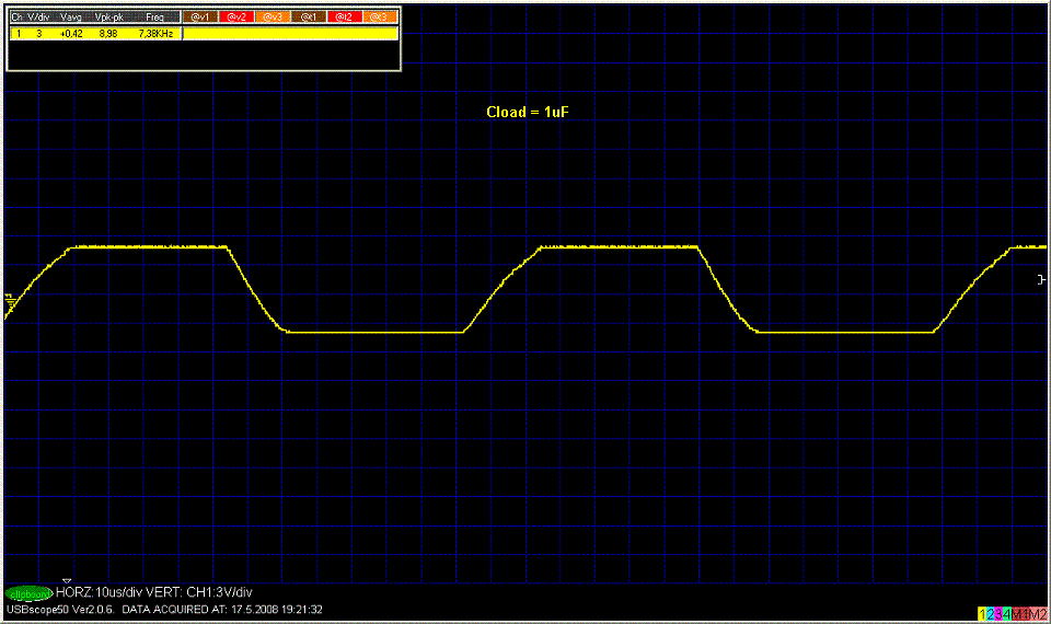

The noise is similar as single AD744. There were different design goals, that go AGAINST noise, unfortunately. These goals were:
- same shape of step response for ALL output amplitudes, i.e. no slew rate limitation
- good behaviour when overdriven, even for high frequencies
- high output current, stability for ANY capacitive load
- very low output impedance, to minimize output cable influence
During years of tests, I found these criteria very important for preamps. To me, the preamp with 1k output impedance is a poor solution, as well as passive "preamps".
Just for the record, step response into 1uF:
