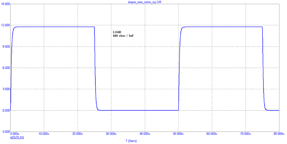

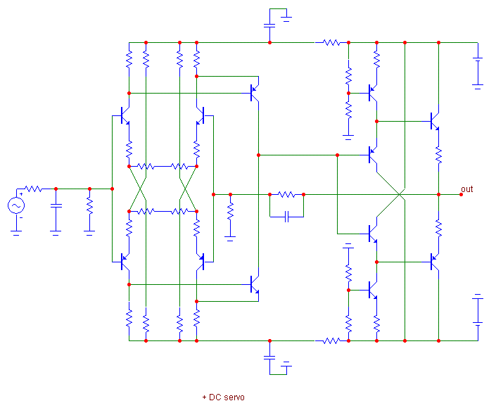

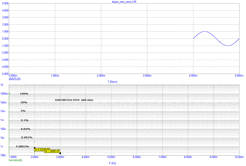

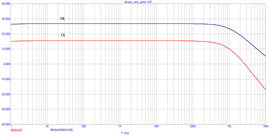

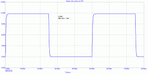

I have decided to come with new, complementary-symmetrical version of Dispre. The new topology results in vanishingly low distortion (less than 0.001%) and uses very small amount of feedback (10dB), just to help to stabilize DC output. Open loop gain is 1MHz! A servo is included, so no output cap any more. Here is the concept:

aparatusonitus said:
Hi PMA,
Is it a wise idea to put a EF buffer between complementary differential and FC BJT's?
I am not sure if I get it well. In case you mean to add EF follower between cascode's output and diamond buffer input, then I think it is not needed. The output diamond buffer has so high input impedance and so low input currents, that it does not need additional emitter follower.
In case you mean to put it in front of cascodes, then I am not sure.
