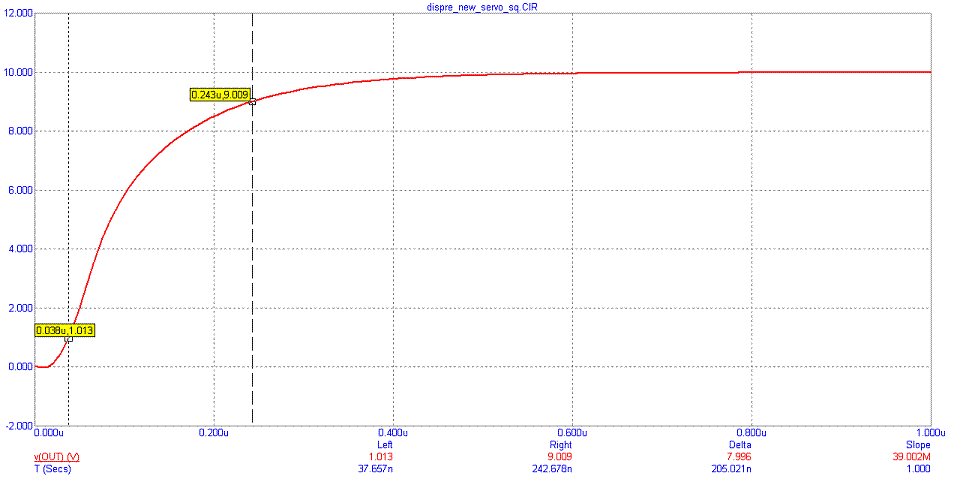

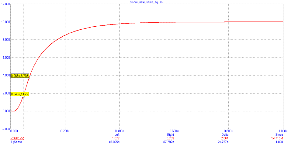

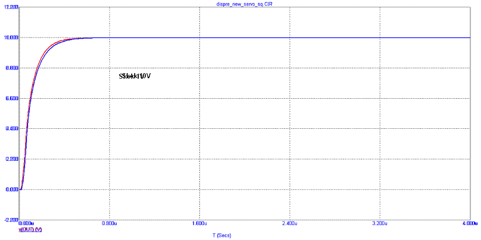

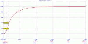

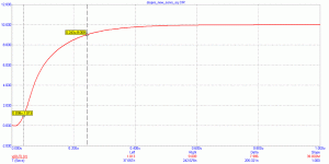

I would like to display what I mean a "consistent step response". The attached image shows step response for 10V and 1V output step, in one image, 1V response 10x magnified. This is WITHOUT input RC filter. As one can see, there is no slew rate limitation visible.
Hi,PMA said:I would like to display what I mean a "consistent step response". The attached image shows step response for 10V and 1V output step, in one image, 1V response 10x magnified. This is WITHOUT input RC filter. As one can see, there is no slew rate limitation visible.
can you confirm that the plot shows about 0.2uS for a rise from 1.5V to 9.5V giving ~40V/uS (for that test signal) and still showing no sign of slew limiting.
