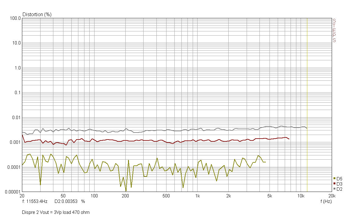

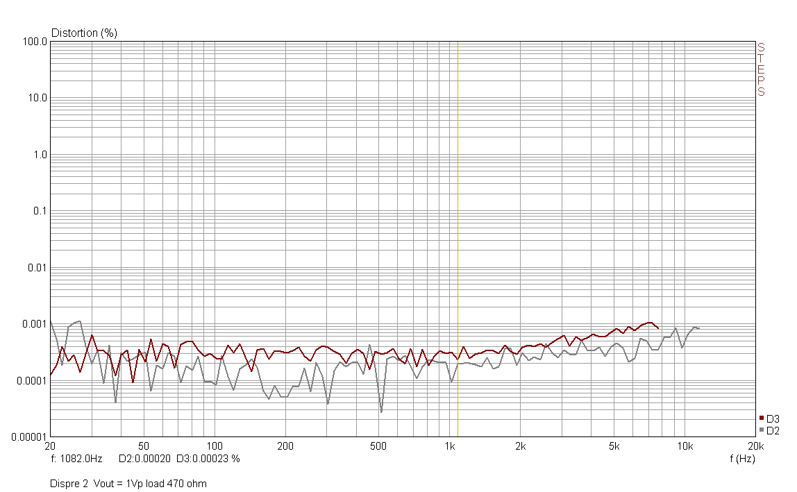

Now is probably high time to say that 2 versions with different loopgain, i.e. different feedback, really do sound different, and the difference can be hardly explained by THD measured as 0.00025% in one case:
That is very interesting. Which was 'subjectively better' to you? Do you have a theory why they sound different?

Bob Cordell sometimes speak about HF THD measurements, like THD30. I have decided to measure the Dispre 2 at 100kHz. However, it is not so easy to get enough resolution. First I would like to show measurement of generator itself at 100kHz:

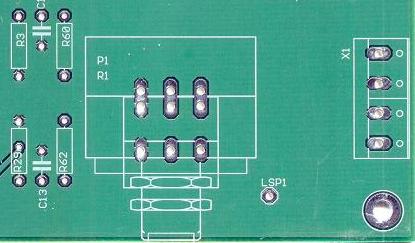

I took a look at your Dispre2 circuit. Is there any reason why you use 2 pots in parallel on the input of your line amp? Is it for reliability? Also, I thought the input z was 20 or 22k, but it looks like 2 10k pots in parallel, so this is 5k per channel. Am I reading it right?
What are your thoughts on the Alps Blue Velvet pot? I am using a 25k on my op-amp based pre-amp - no problems so far.
These 2 pots are only in schematics. They are 2 different library components with different pin distances. Of course you make a choice of only one on PCB.
As a standard, there is a blue Alps. Those who cannot afford this pot can use 16mm cheap one, like Piher, but channel volume matching is poor then.
